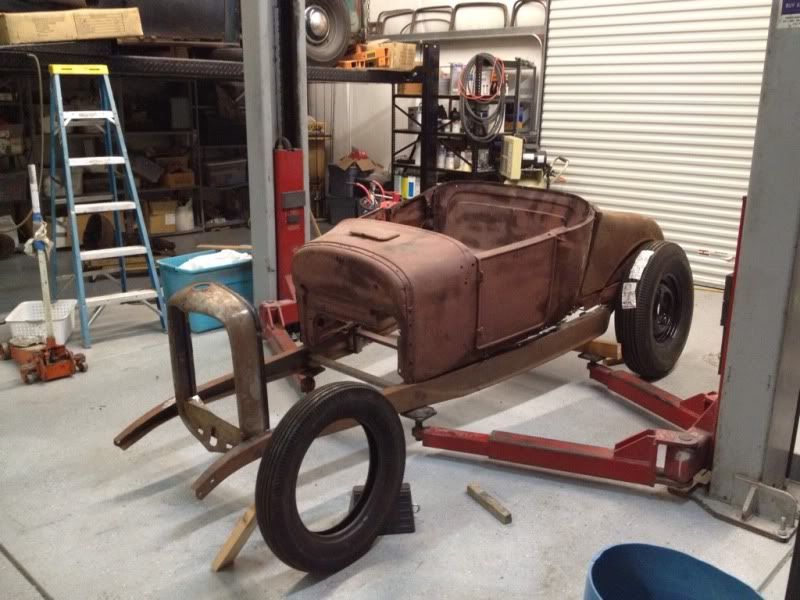

    this is me mocking it up trying to get my bearings on where and what it will look like
    I love mock up stages there is just something about what it can look like that gets me going.

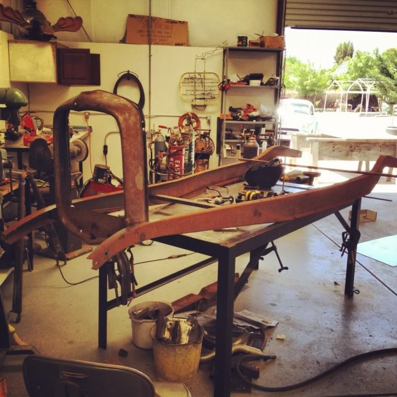

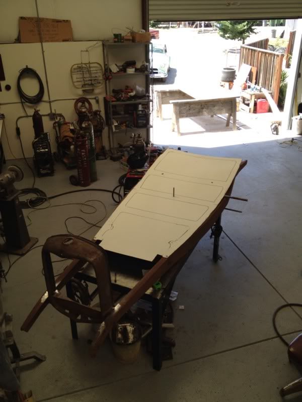

    ok this is where it starts to happen. I put the frame up on are table. its perfect for a jig table so why not. In all honesty I just started from the front and worked my way back to make it fit. My dad and I made a template of the body and cut it out and started fitting it
    and this is my first idea of how it should look. it looked as if it was heading in that direction. so no reason to stop here.

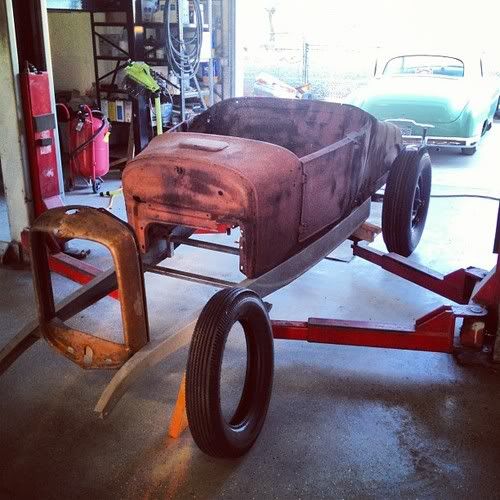

    then I got the body to fit better
    and then my boss Matt gave me a axle and I was able to peace a front end together.
