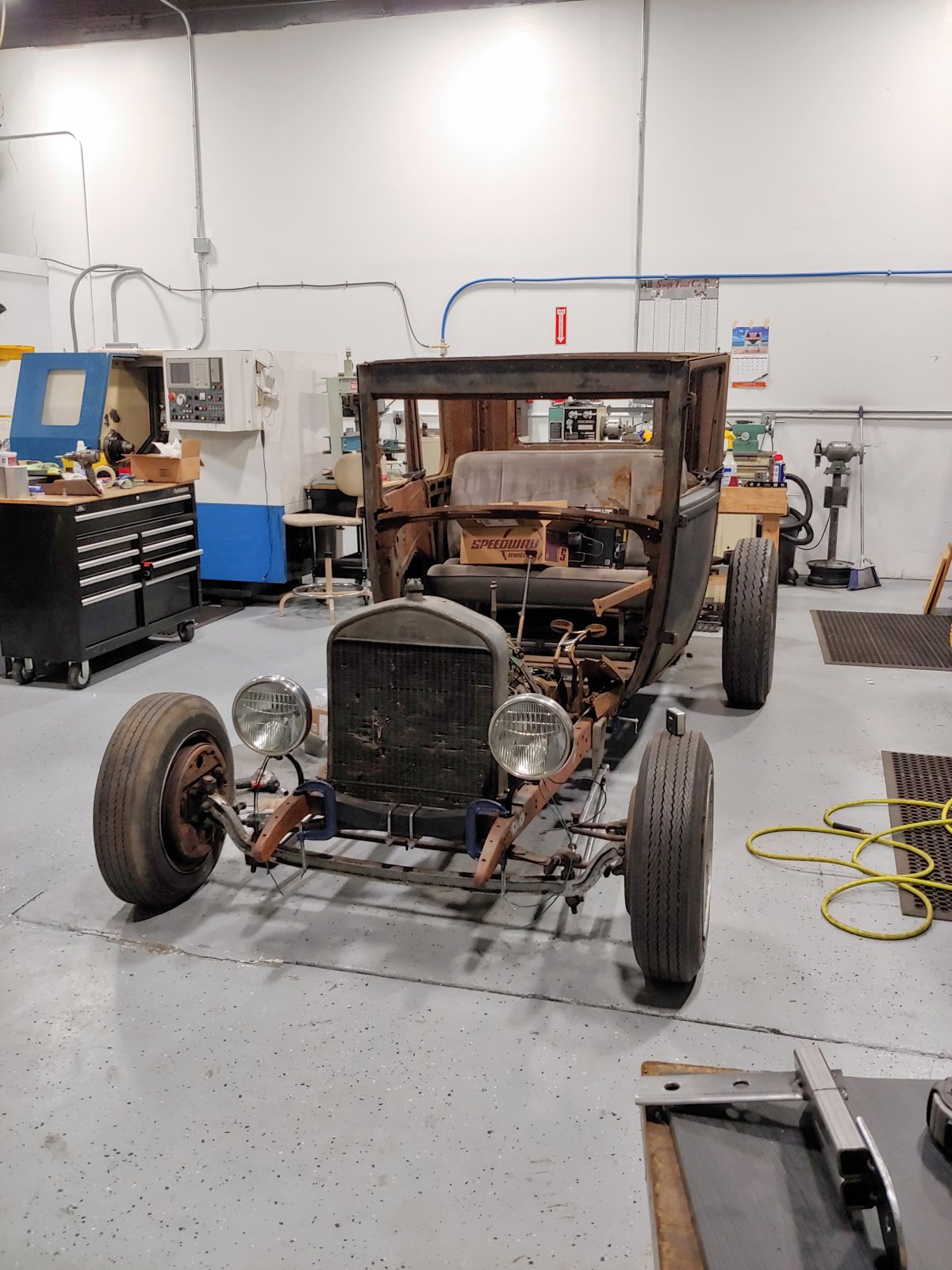

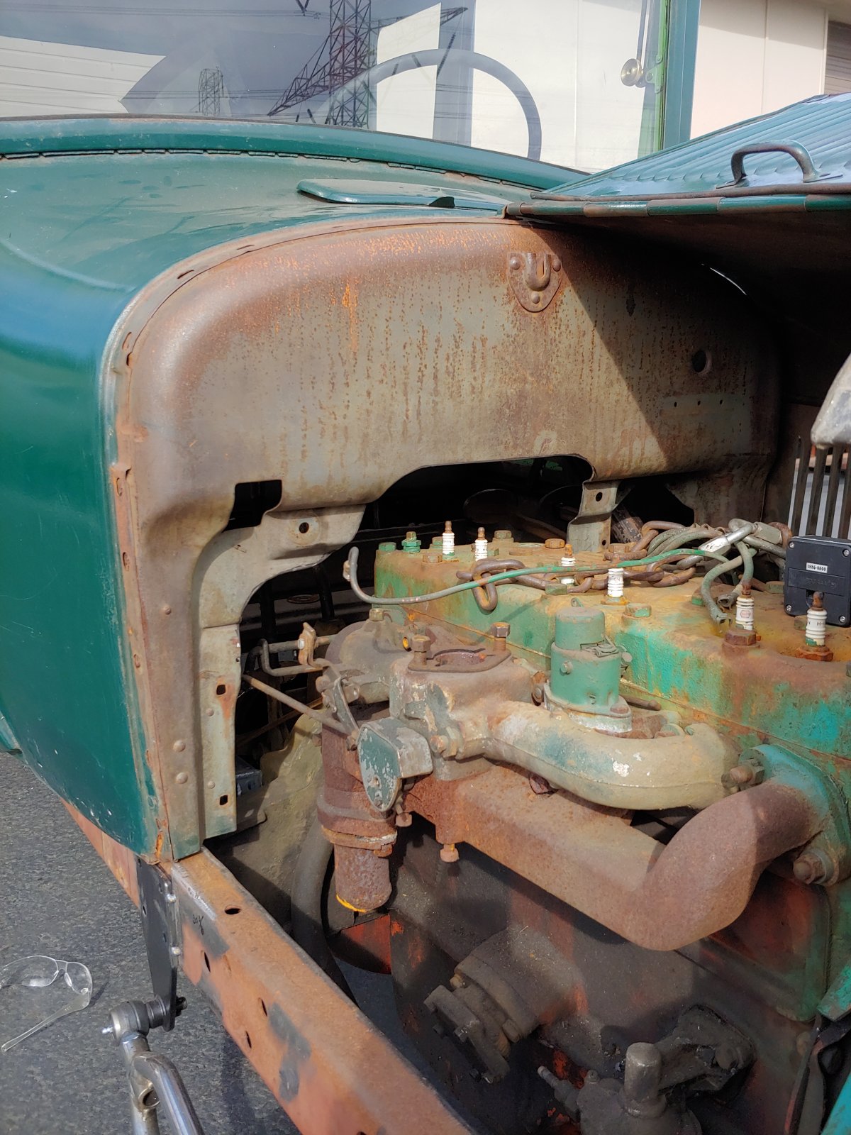

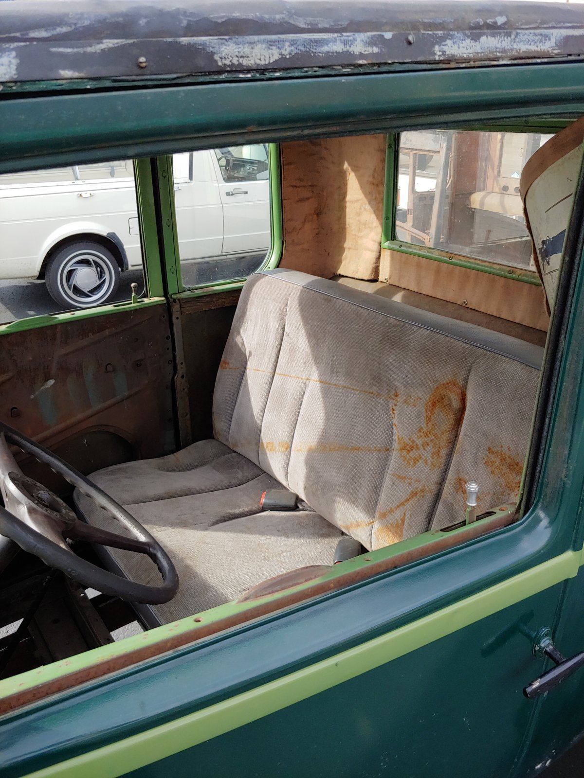

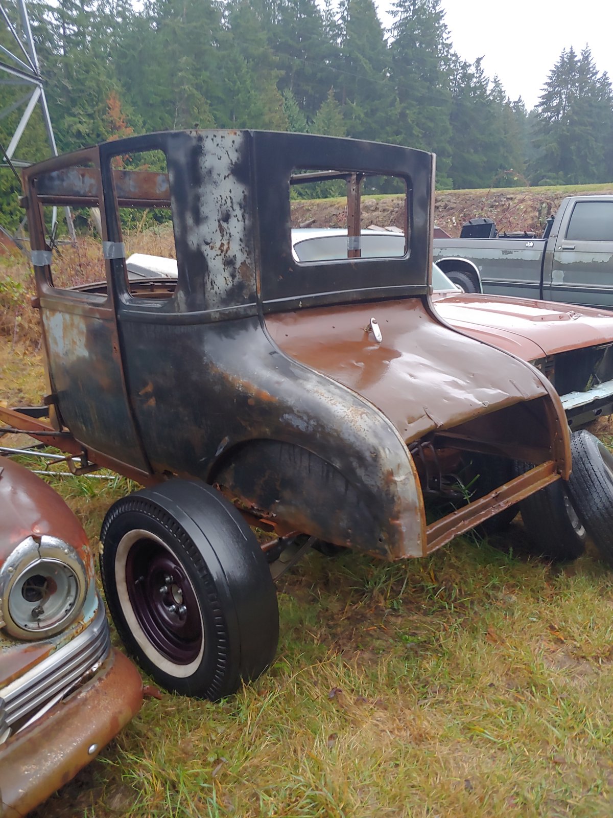

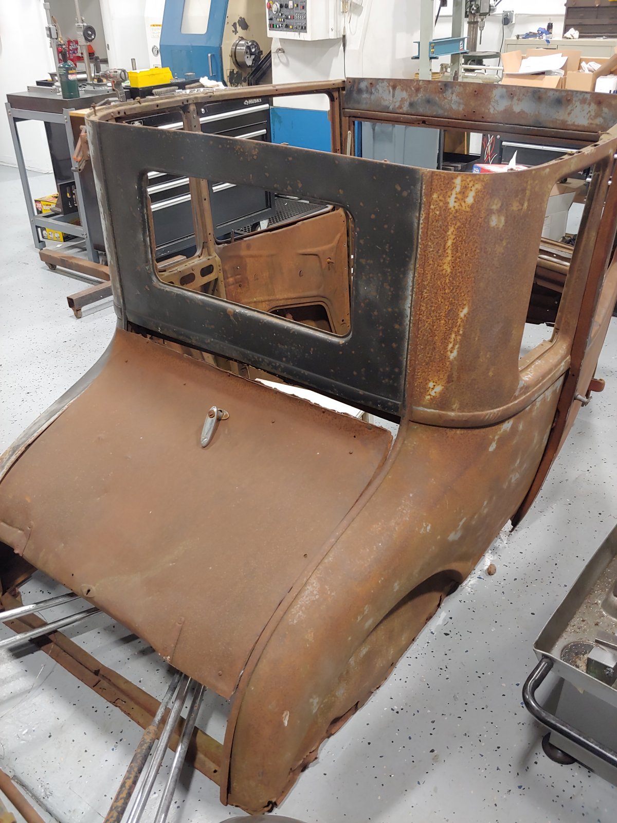

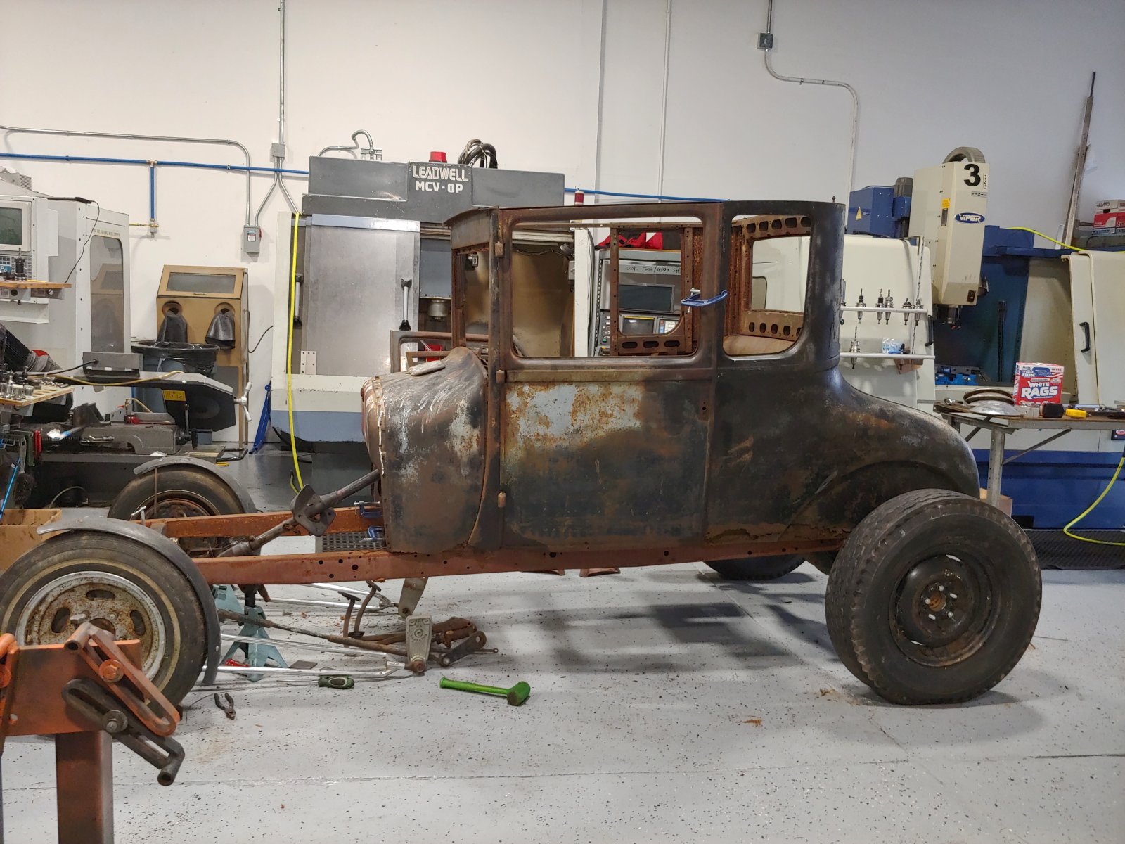

    Hey all. I come to you from the south Puget Sound area in Washington state. Decided I should share my 6 month long build. I'll make posts every few days till I run out of pictures and stories.

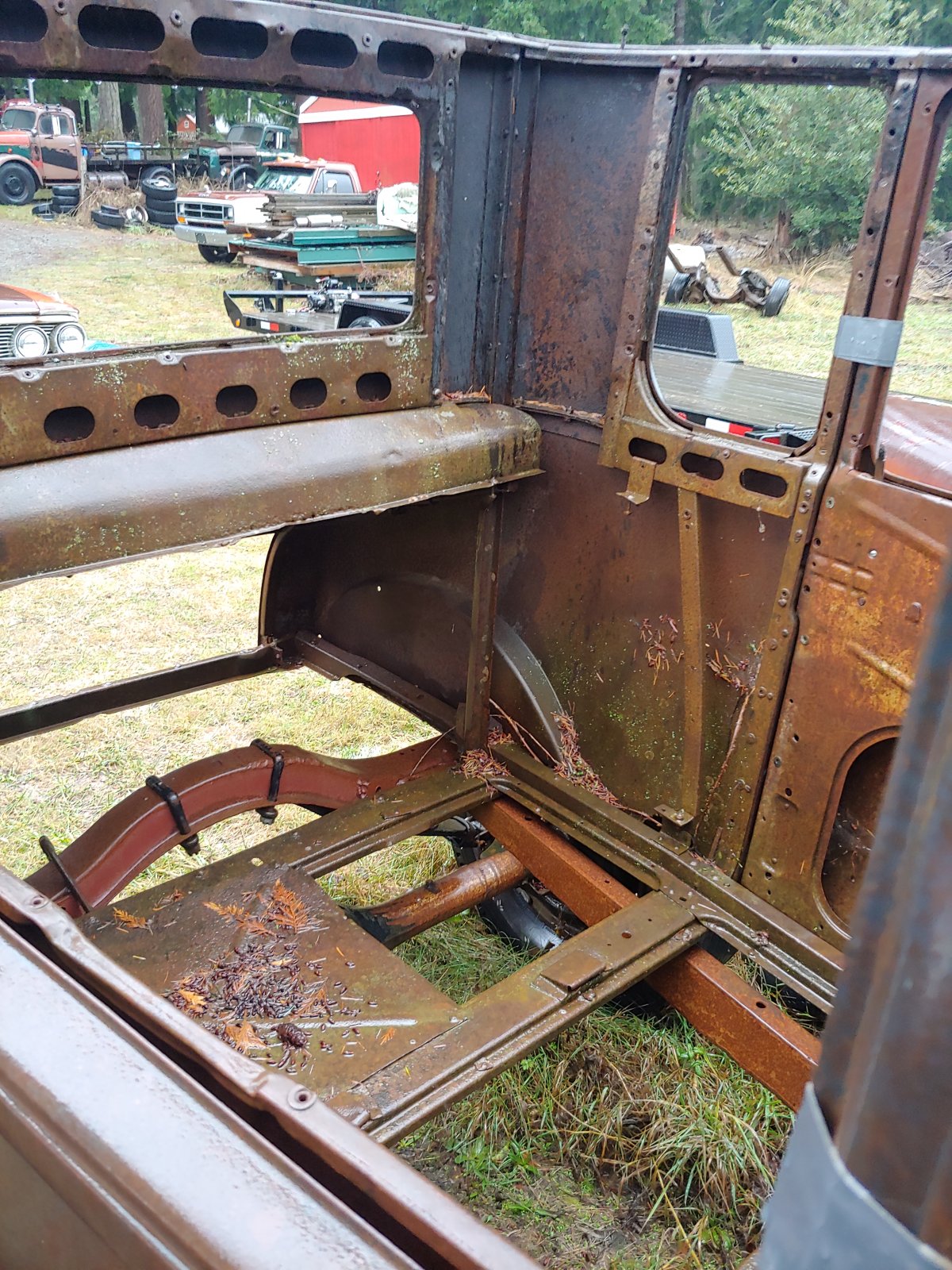

    I purchased a middle of the road 1927 Mode T Coupe body, Model A frame and some suspension in mid January. The frame came with a 55 chevy rear end that came out to be a 3.55 gear set and a nice old 4" dropped front axle. Being an oddball I chose a 23" Mopar 6 cylinder for my power plant and found a good rebuild-able candidate with an overdrive column shift trans for free. Once I had it all at the shop I started mocking everything up. Figured out how much I had to stretch and step the frame to get things where I wanted to put it. 20221224_110621_HDR.jpg 20221224_110634.jpg 20221224_110646_HDR.jpg 20221224_110649_HDR.jpg 20221226_140424.jpg 20230110_074052.jpg 20230110_091239.jpg 20230110_091257.jpg 20230110_091309_HDR.jpg 20230111_144911.jpg 20230120_104149_HDR.jpg 20230124_125234_HDR.jpg 20230124_125254.jpg

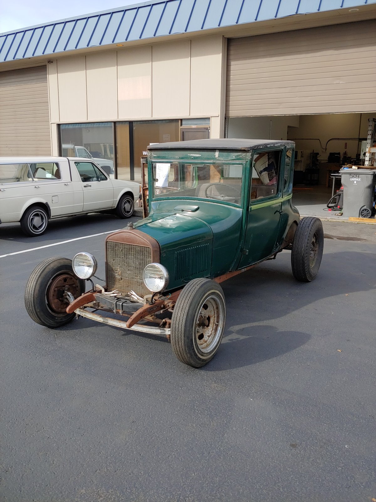

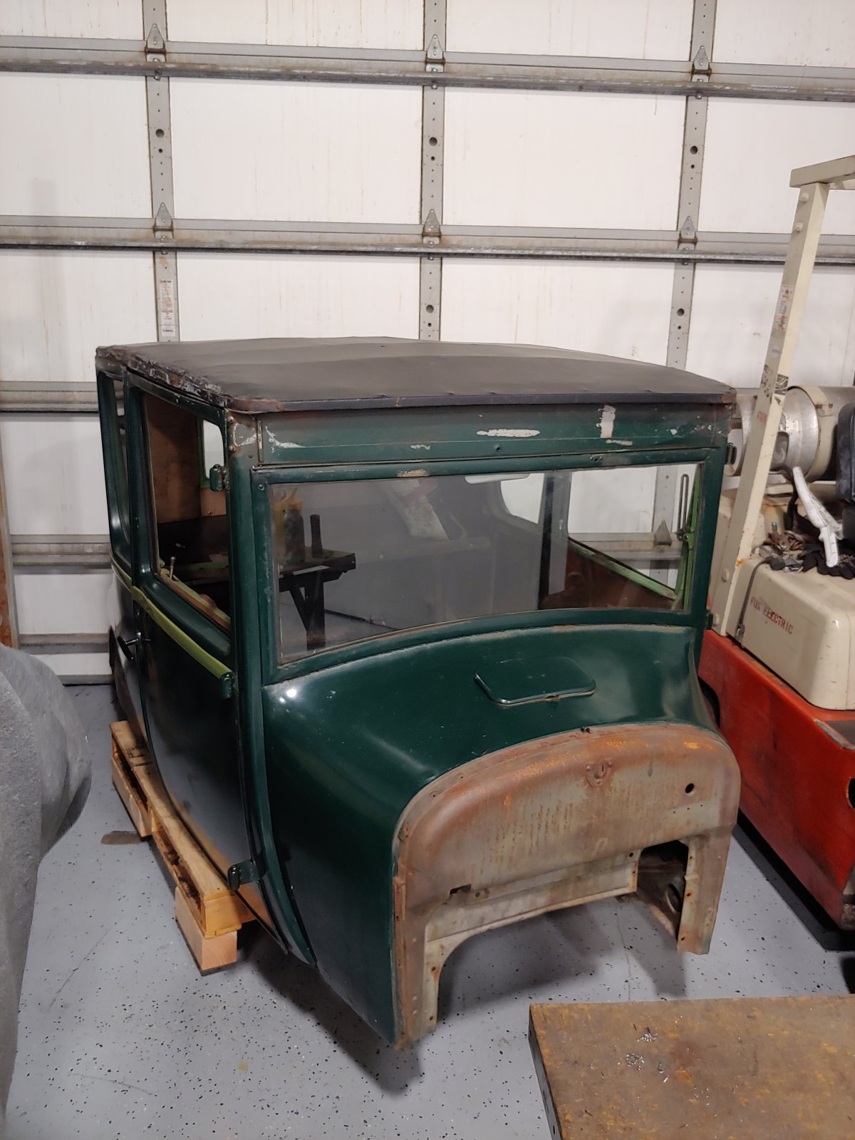

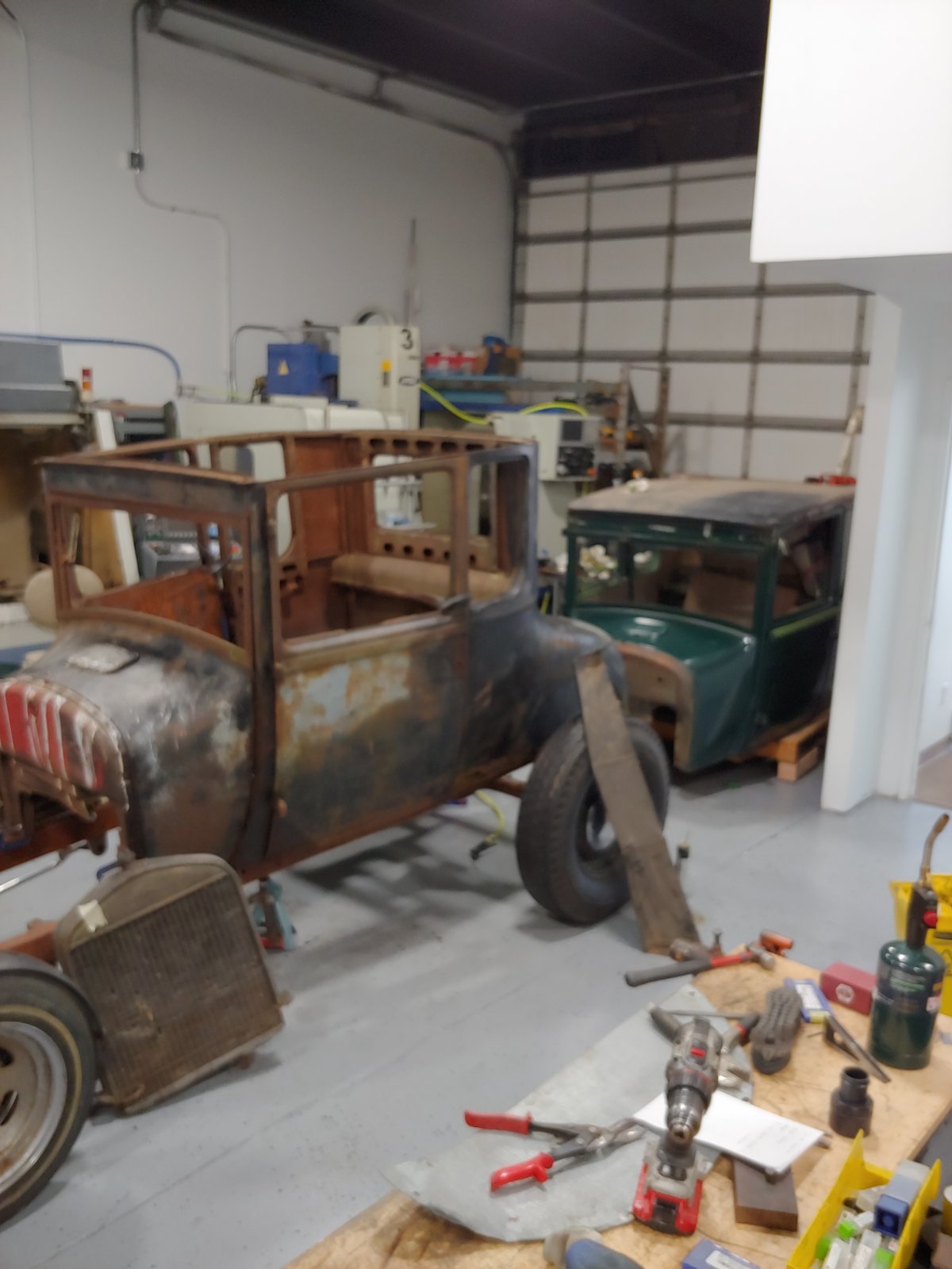

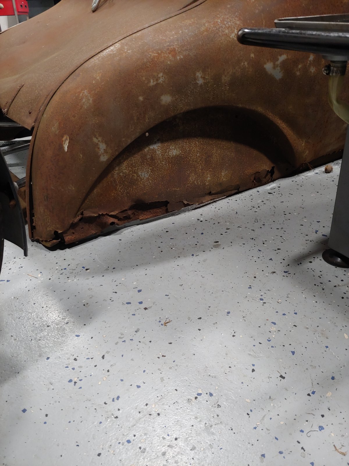

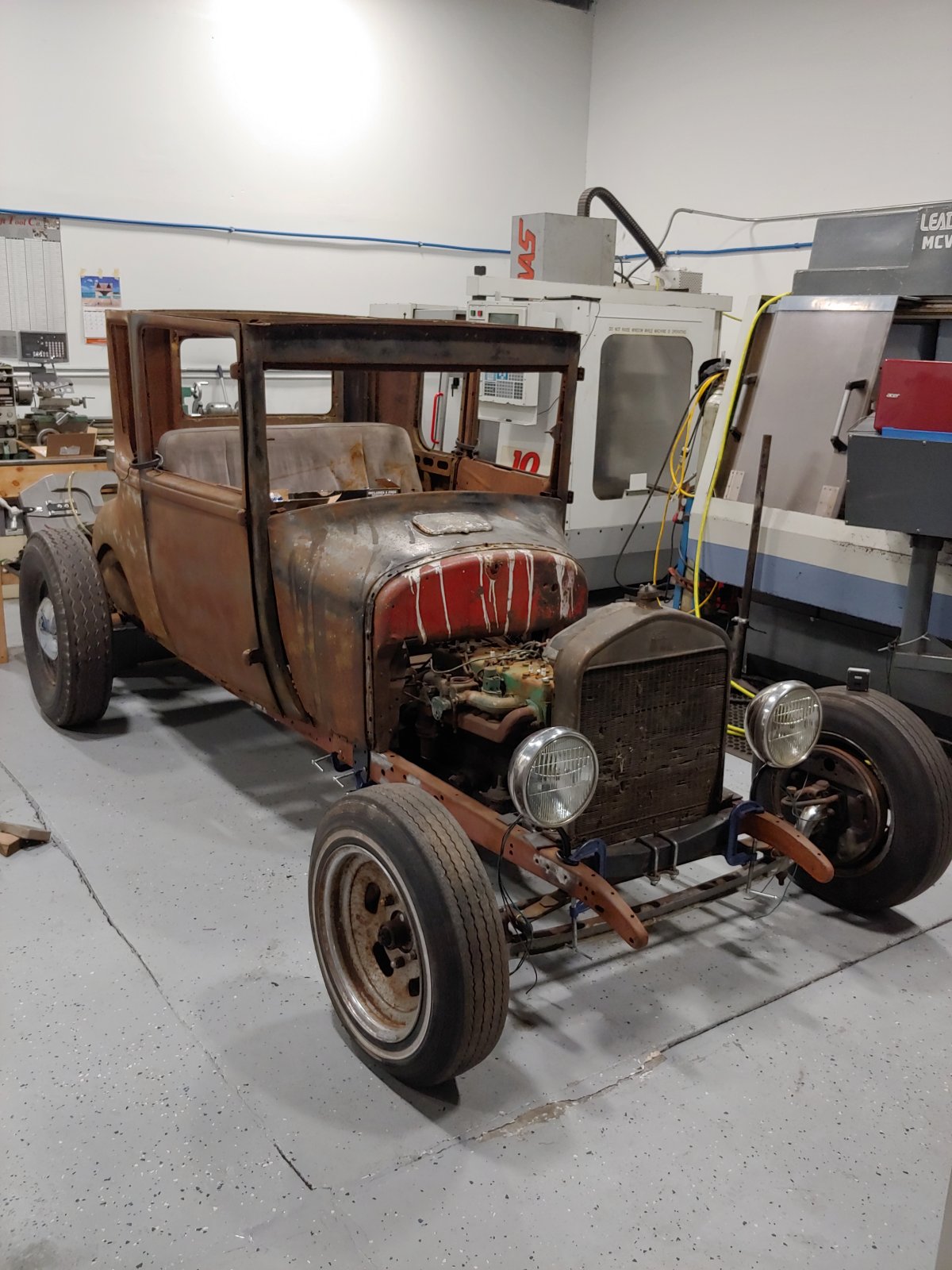

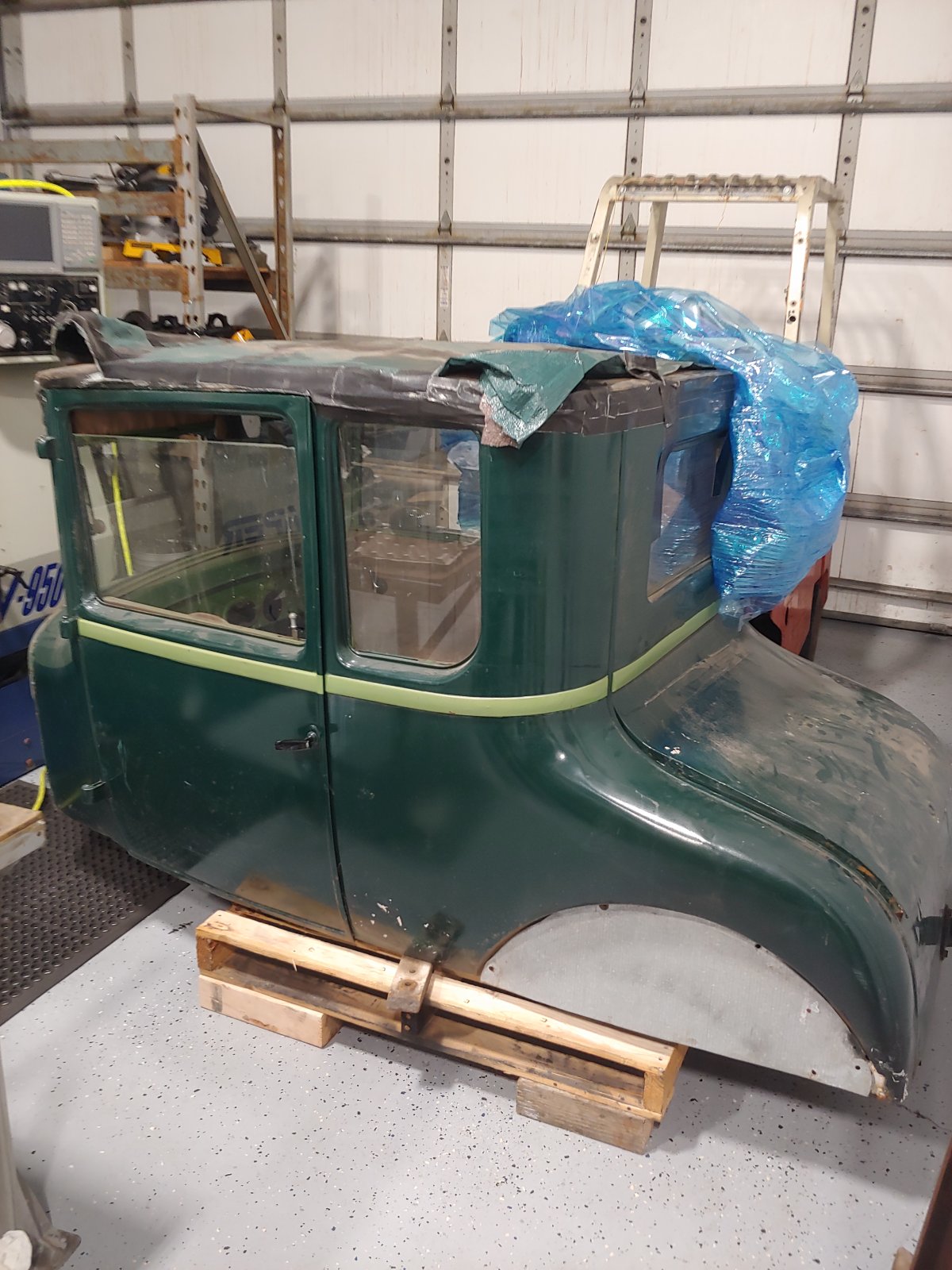

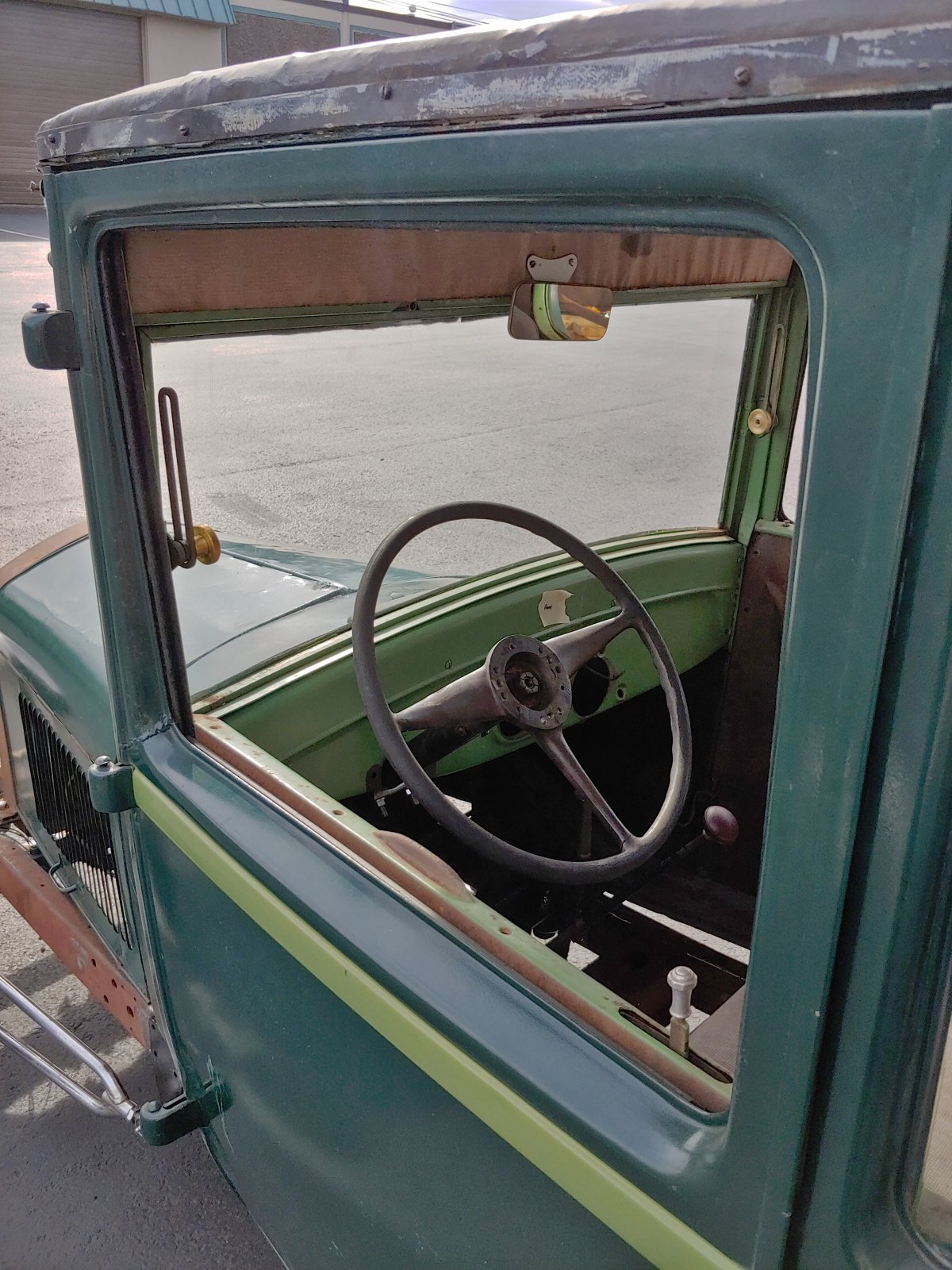

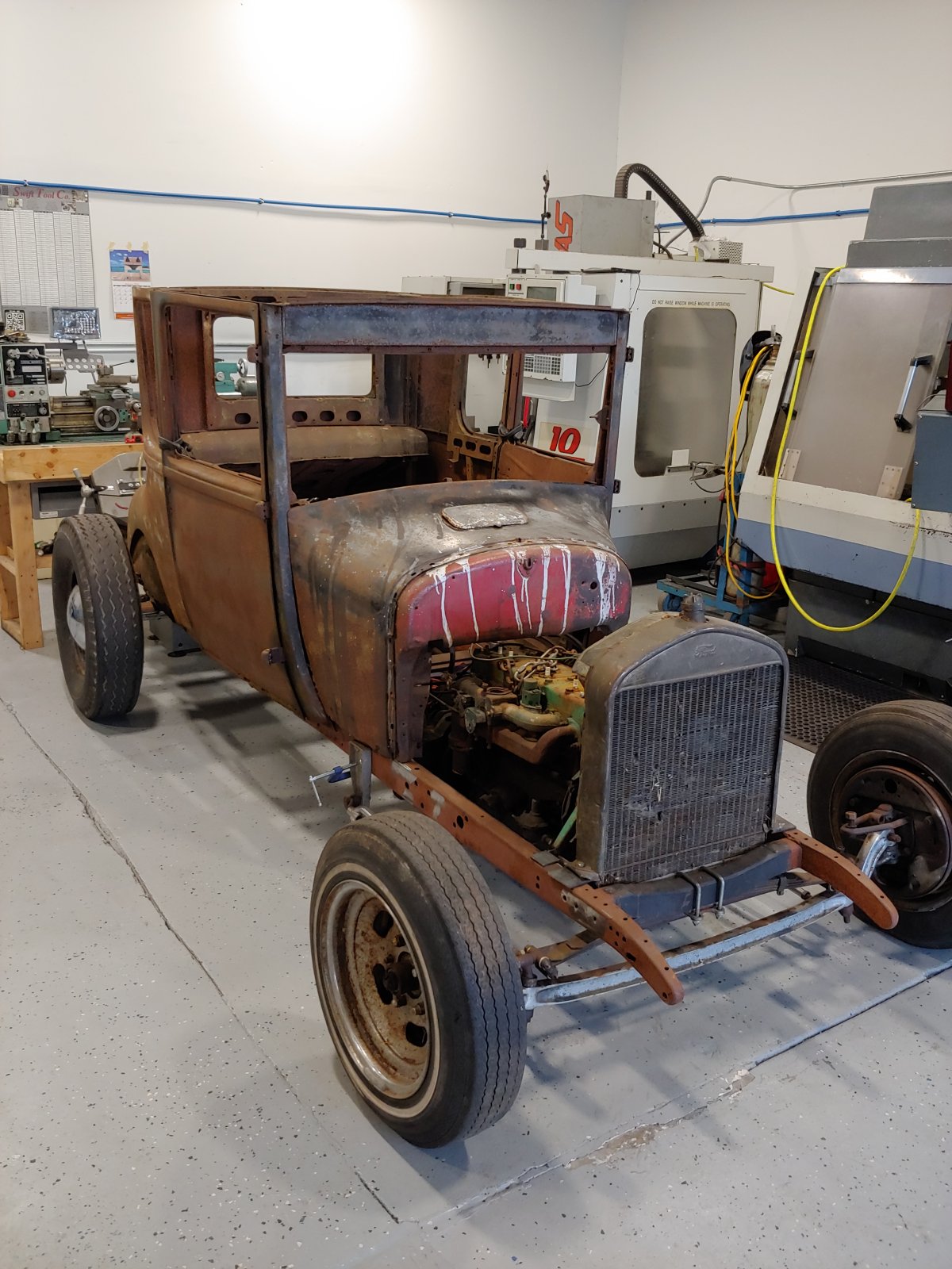

    Ended up 2 weeks after acquiring the first body coming across a complete body with all the bells and whistles for a smoking deal on FB marketplace. All the inferior was there with exception of the seat. All the interior panels, gl***, window garnish moldings, seat pan riser, good window regulators and door latches, the works. Ended up sending my dad and a buddy of mine sight unseen to pick it up for me. I ended up getting not only the body but splash shields, fenders, a hood, grille shell, frame and running boards. needless to say I wash happy when it all showed up at the shop in the dark. 20230118_195607.jpg 20230118_195632.jpg 20230124_125309_HDR.jpg

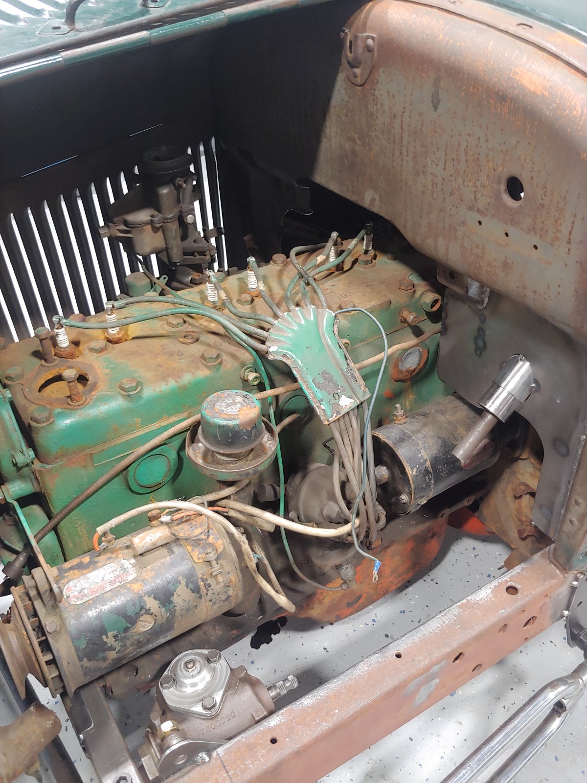

    After the good fortune on the second body I ended up having the opportunity to pick up and second mostly complete 1953 P24 Plymouth engine. This time with a '38 dodge 3 speed truck transmission and bell housing hanging off the back. needless to say I was excited to have a top shift transmission and not have to sort out the column shift linkage. 20230204_144855_HDR.jpg 20230204_144904_HDR.jpg

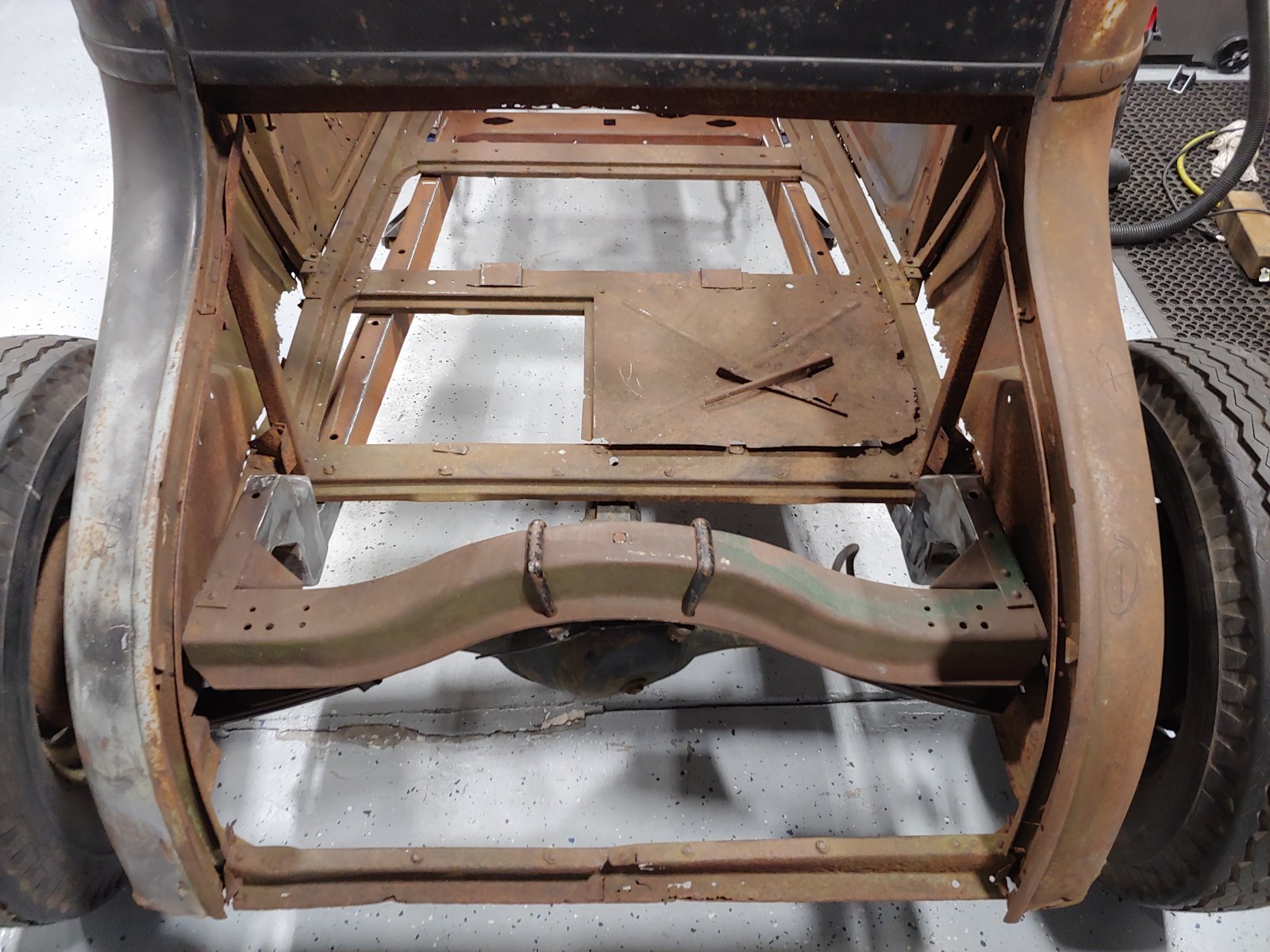

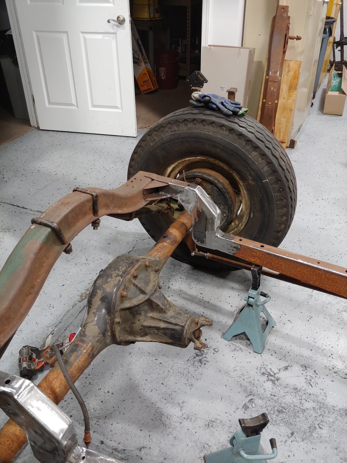

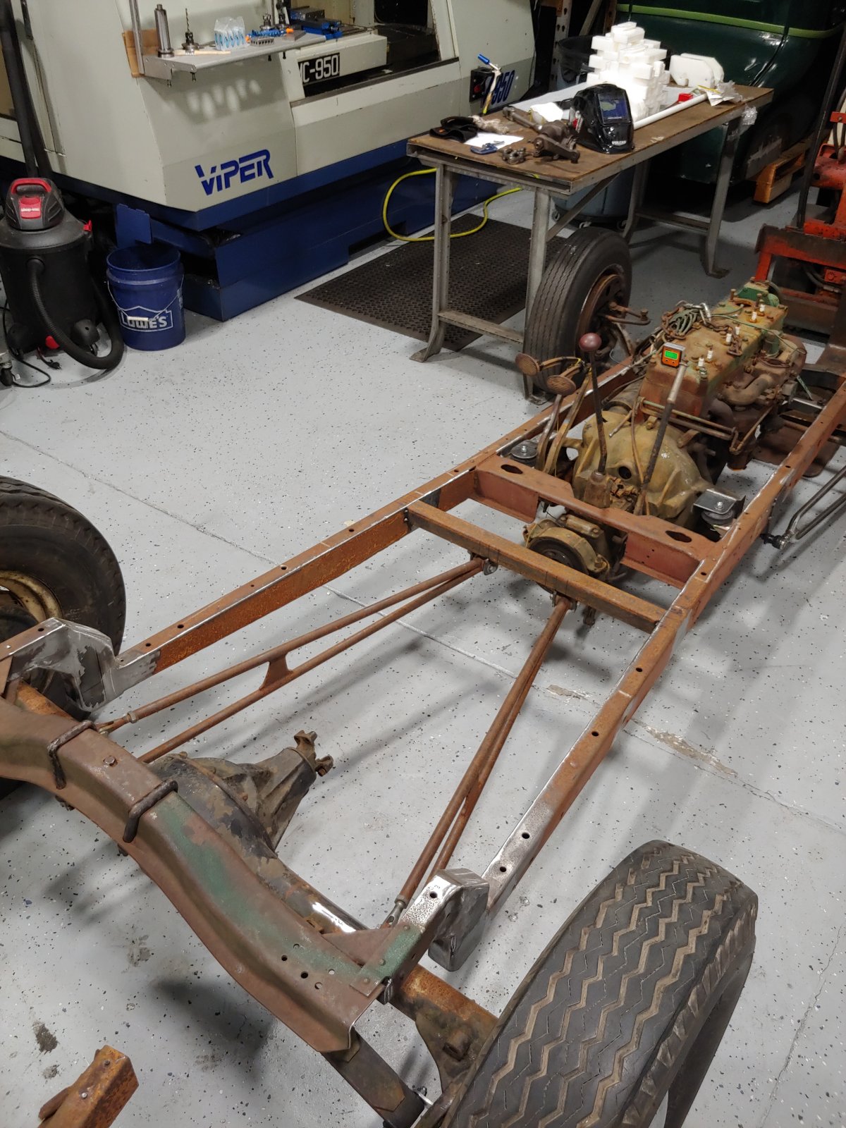

    The rear axle I have is a 1955 Chevrolet out of a PowerGlide car with a 3.55 gear set. Someone had already many, many moons ago, welded ford spring perch's on it and did a nice job of it too. So that said all I had left to do was cut the leaf spring perches off the tubes, clean em up and paint it. I'm using a Model A spring in the rear with ladder bars and lever shocks for the suspension. (you'll see all that shortly when I post more pics)

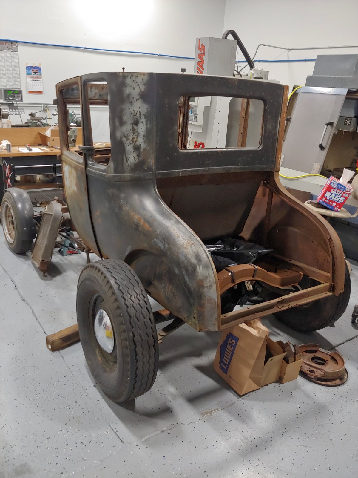

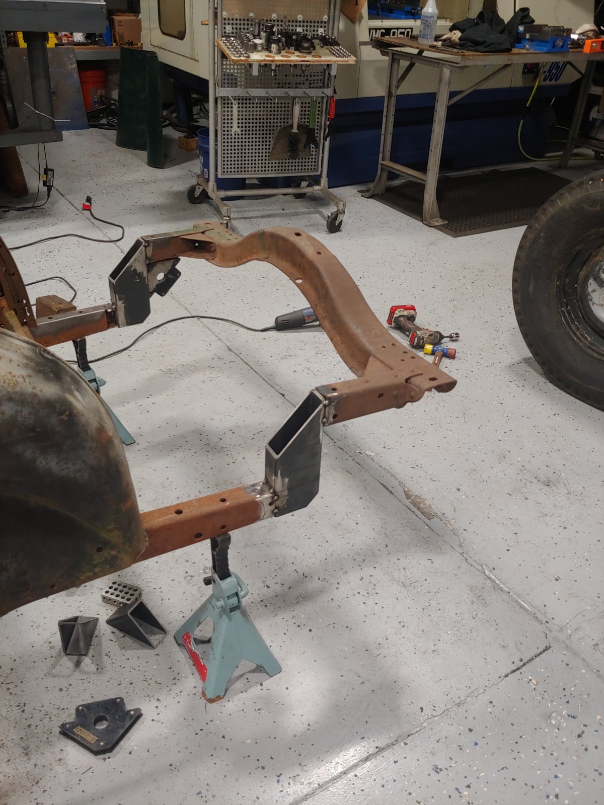

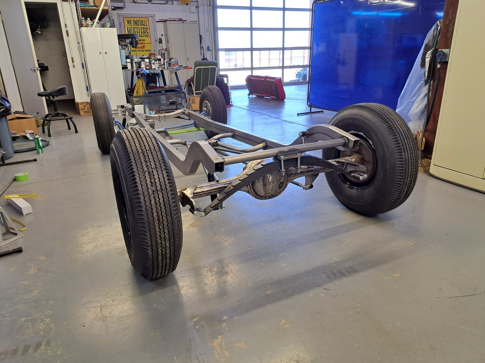

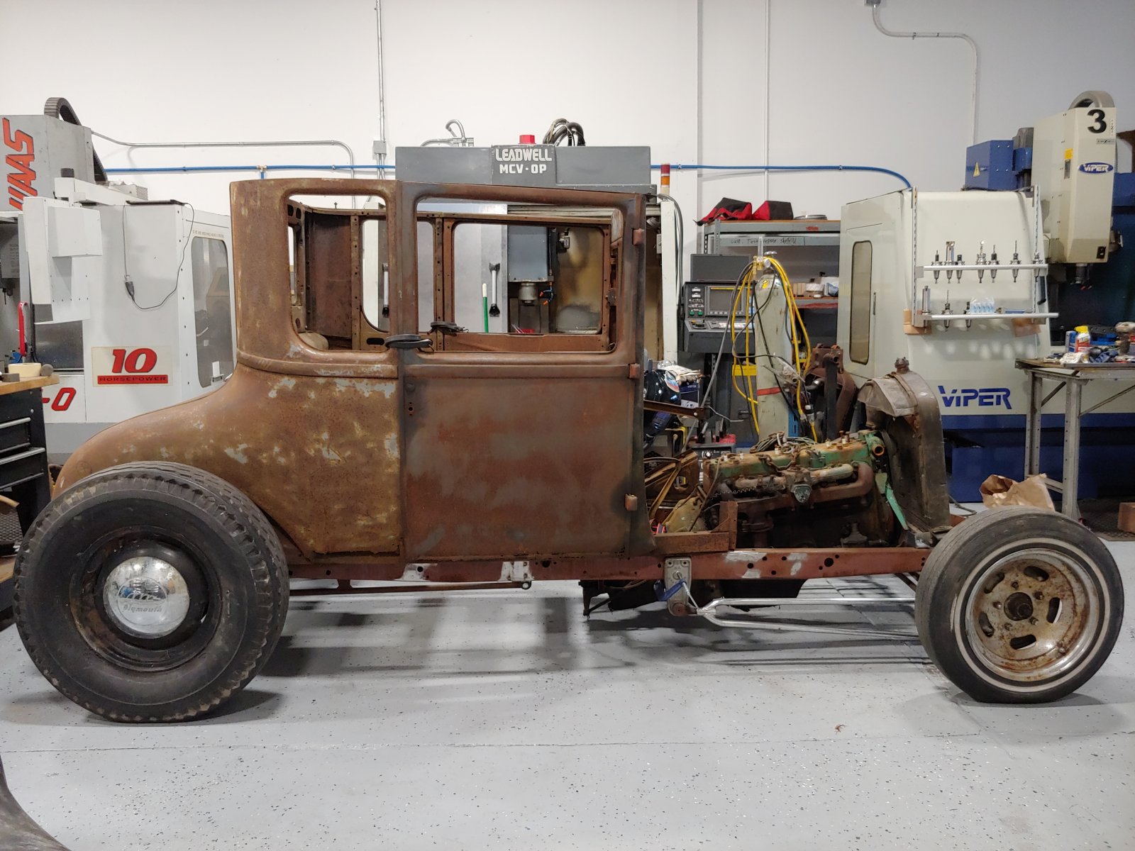

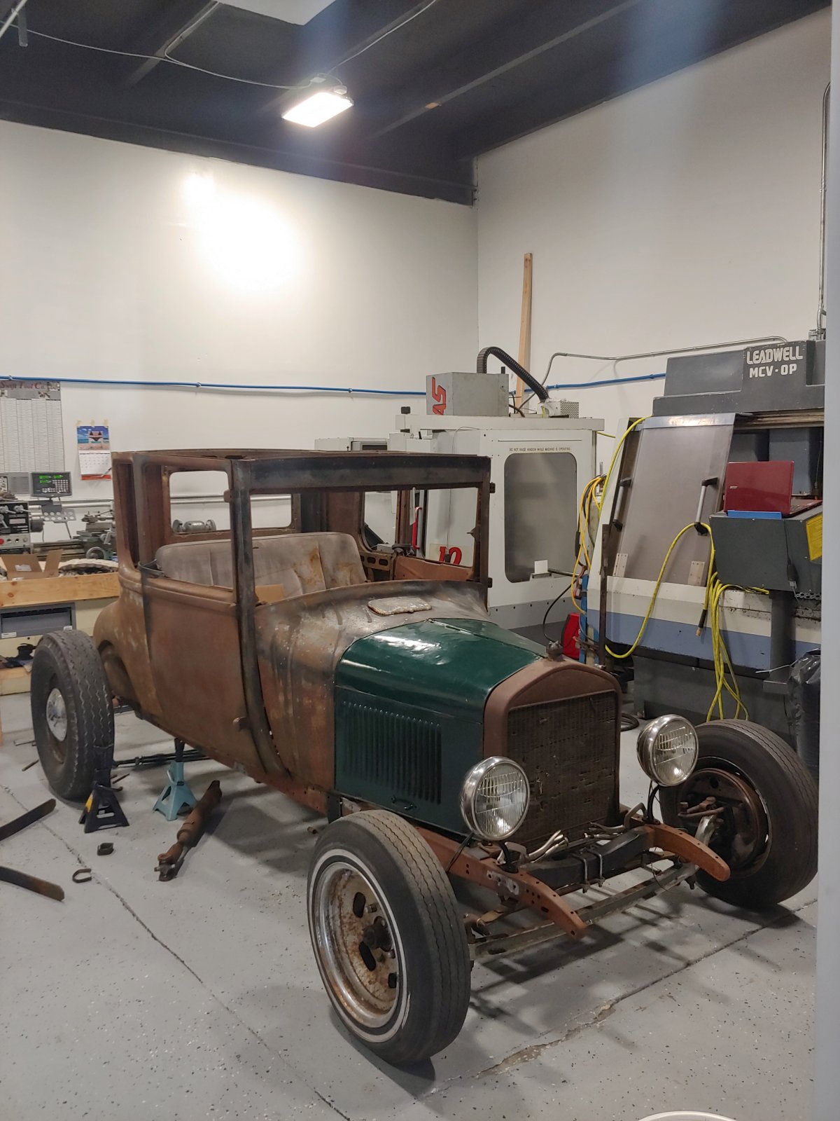

    Once I had all the parts in one place I figured out how and where I wanted to step and stretch the frame to get the right wheel base and rake. Ended up using a rear section my buddy had and some rectangular tubing to do the step and stretch. After that I started getting the suspension setup. was going to use some cool, old Mr Roadster cast aluminum radius rod mounts but someone before me had over tightened the ball joints in them and cracked the tapered bosses. So scratch that. Wound up going with some speedway steel ones instead. Shot from the hip on the rear suspension (you'll see in the pics o_O) toyed with mounting the ladder bars parallel, two different ways. Wised up then did some reading and finally settled on adding a cross member and angling them in toward the center of the car for the most drive ability. Once the rear was mocked up I test fit the engine and trans in an effort to get some weight on the suspension and see where everything was going to sit. Had to excavate quite a bit of the stock center cross member but with the addition of a cross member behind it for the rear suspension I'm not too worried about it.
    20230201_144814.jpg 20230202_172246.jpg 20230202_172257.jpg 20230205_164857.jpg 20230205_164913.jpg 20230205_165004.jpg 20230205_173310_HDR.jpg 20230205_173332_HDR.jpg 20230205_173337_HDR.jpg 20230208_165555_HDR.jpg 20230208_165619_HDR.jpg 20230208_165628_HDR.jpg 20230210_155503_HDR.jpg 20230210_155517_HDR.jpg

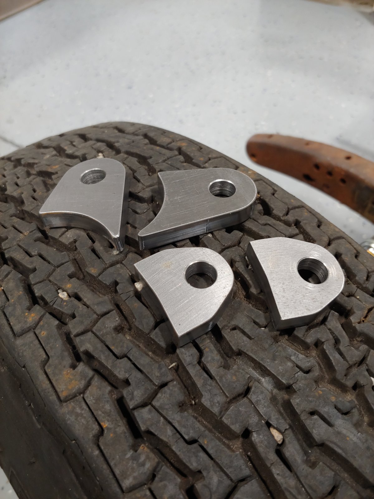

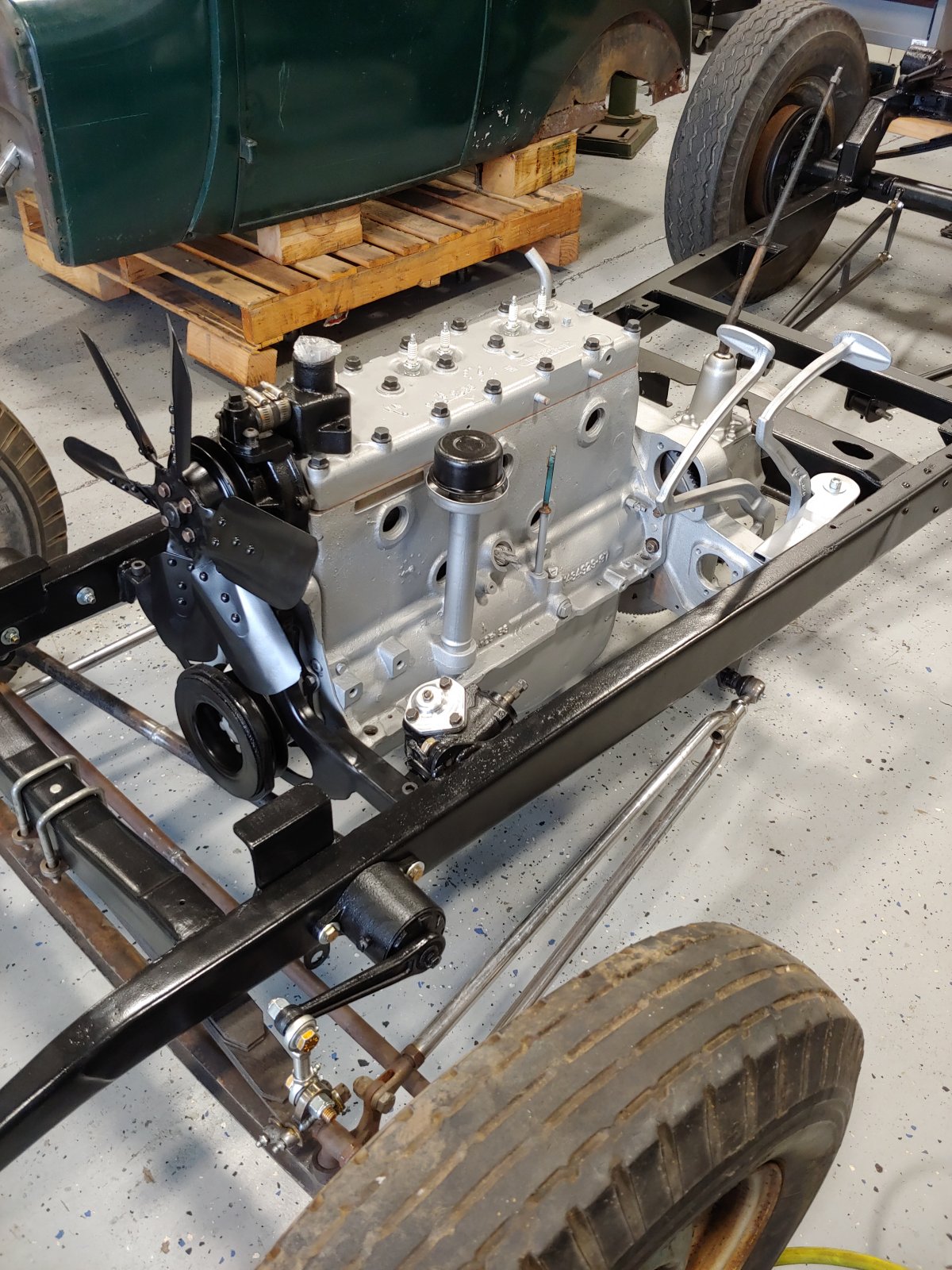

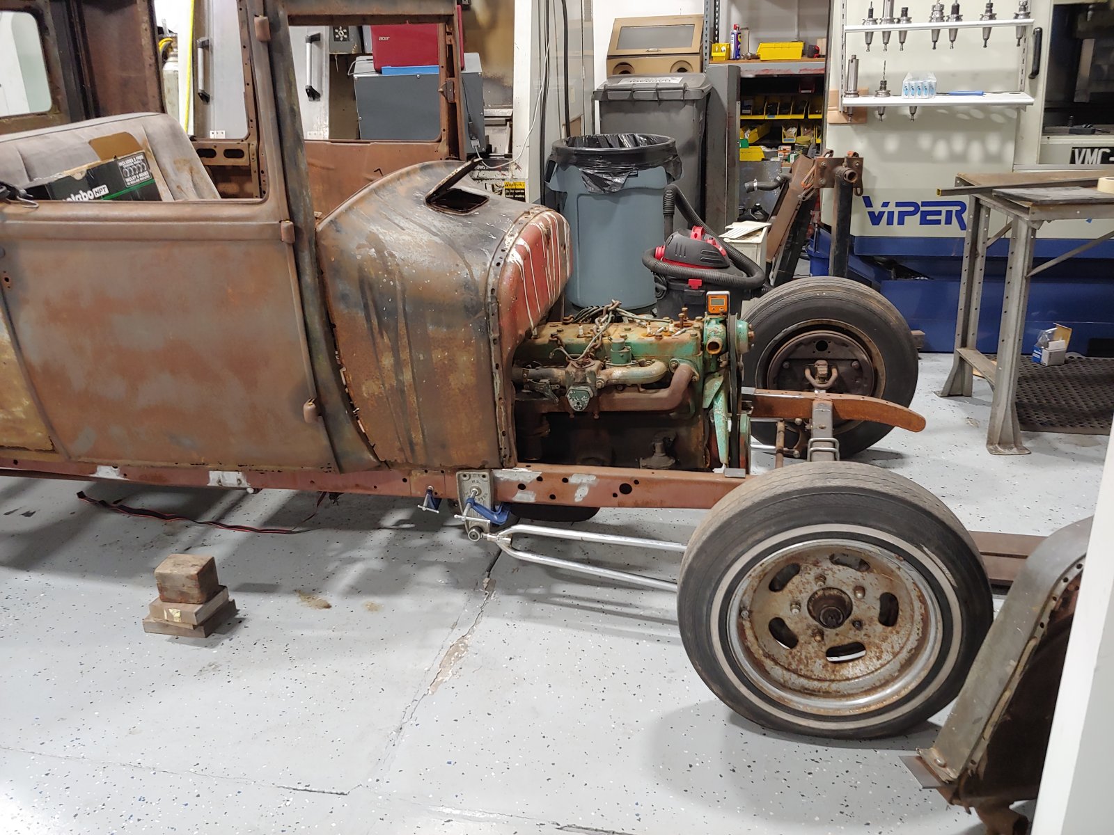

    I did indeed use the Dodge bell housing for the rear engine mounts. To do that I ended up fabricating my own brackets that bolt to the ends of the bell housing ears and then sit on top of Ford flathead style biscuit engine mounts. Started with some Speedway ones but didn't like the quality and their ability to slide from side to side. So I bought some brackets out of Texas that came with the nice biscuits with bands and lower cups. They made all the difference in how things went together. For the front engine mount I took the already butchered "Floating Power" arch and grafter square tube to the sides to interface with some frame standoffs. This build has gone so fast so far that I only have a couple pictures with the mounts in them. Wish I had taken some better shots. The following pics are out of sequence but show the brackets better.
    20230305_111338.jpg 20230608_175911.jpg 20230608_175919.jpg 20230612_172441.jpg

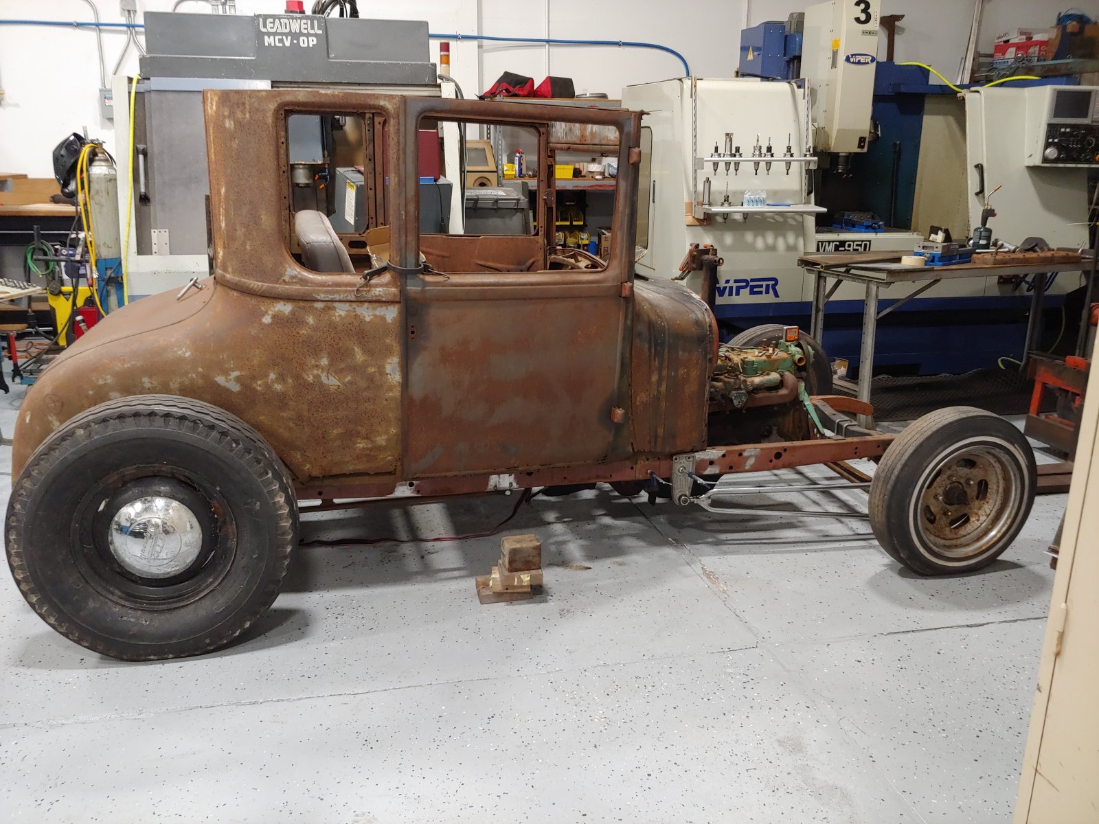

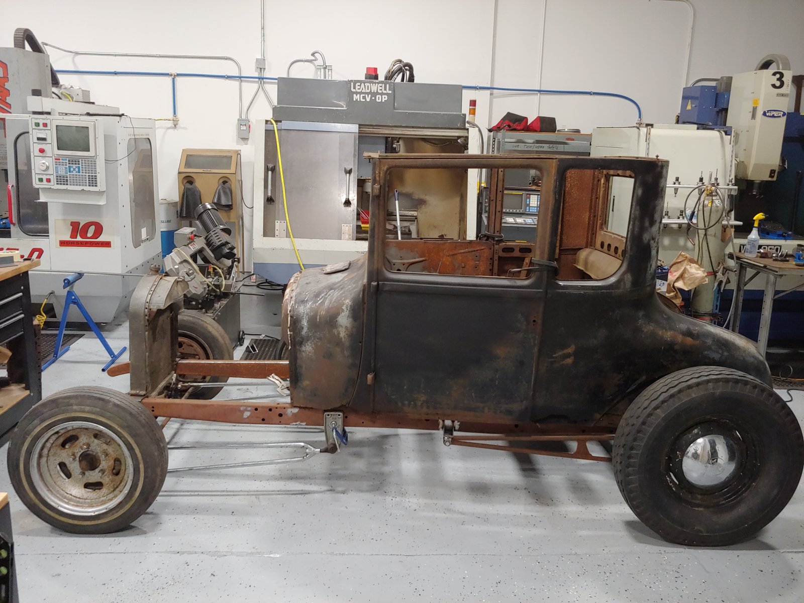

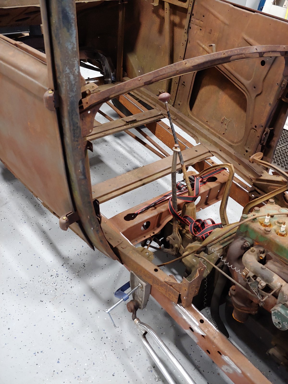

    With the engine Loosely mounted in the frame I started working on figuring out where the body should sit. I also did some test fitting of the seat and steering column for driving position. Figuring out the final engine position was a bit tough but once I had the body where it should be things got easier. Ended up cutting a bunch of clearance in the center cross member for the parking brake and the shifter stand of the transmission so that I could set the engine back as far as possible. Ended up with the rear two cylinders just past the firewall making it look like a 4 cylinder from afar but you see the last 2 cylinders up close.
    20230208_165555_HDR.jpg 20230208_165619_HDR.jpg 20230210_155503_HDR.jpg Message_1676339322930.jpg Message_1676339355723.jpg 20230215_114520_HDR.jpg 20230215_114531.jpg Message_1676563793469.jpg
    20230216_143513.jpg 20230216_143530_HDR.jpg 20230304_180010_HDR.jpg 20230226_133011_HDR.jpg

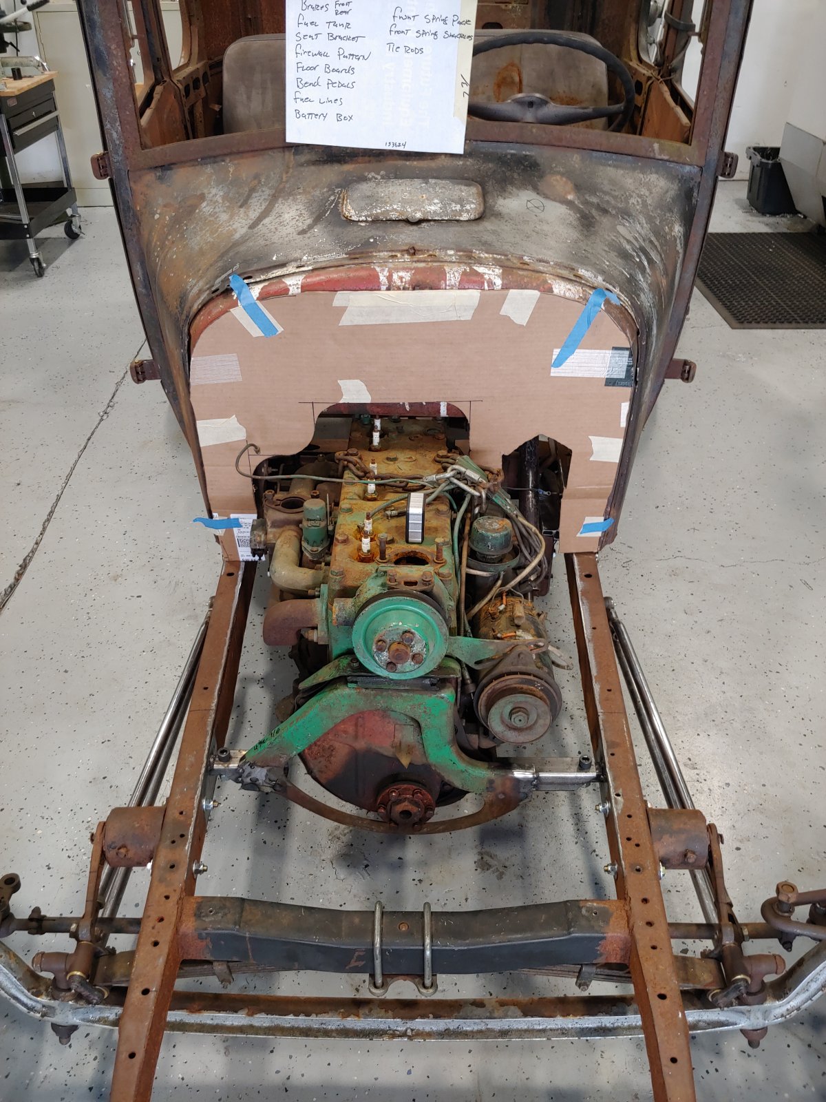

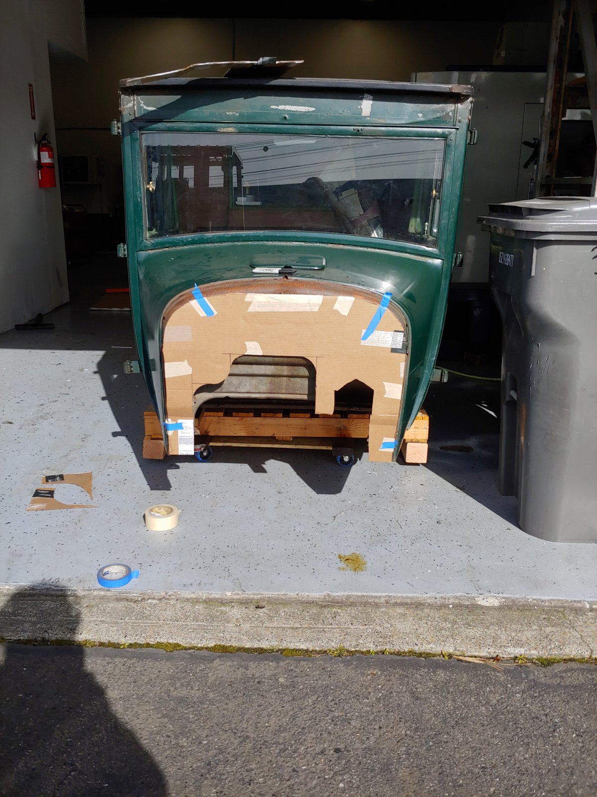

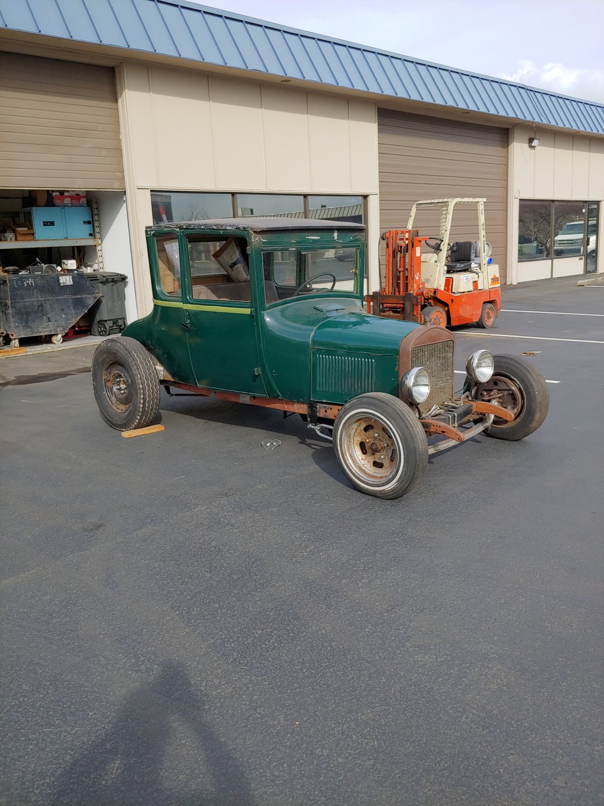

    After I got the body and suspension mocked up where I felt it was in a good spot I decided to pattern the firewall cutout and get the green body on the frame. This was a major milestone in the project. there's nothing quite like when you put some of the final ***embly parts together and see you ideas take shape.
    20230305_111139.jpg 20230305_140905_HDR.jpg 20230305_140923_HDR.jpg 20230305_140946_HDR.jpg 20230305_140953_HDR.jpg 20230305_140957_HDR.jpg 20230305_141113_HDR.jpg Message_1679165003140.jpg

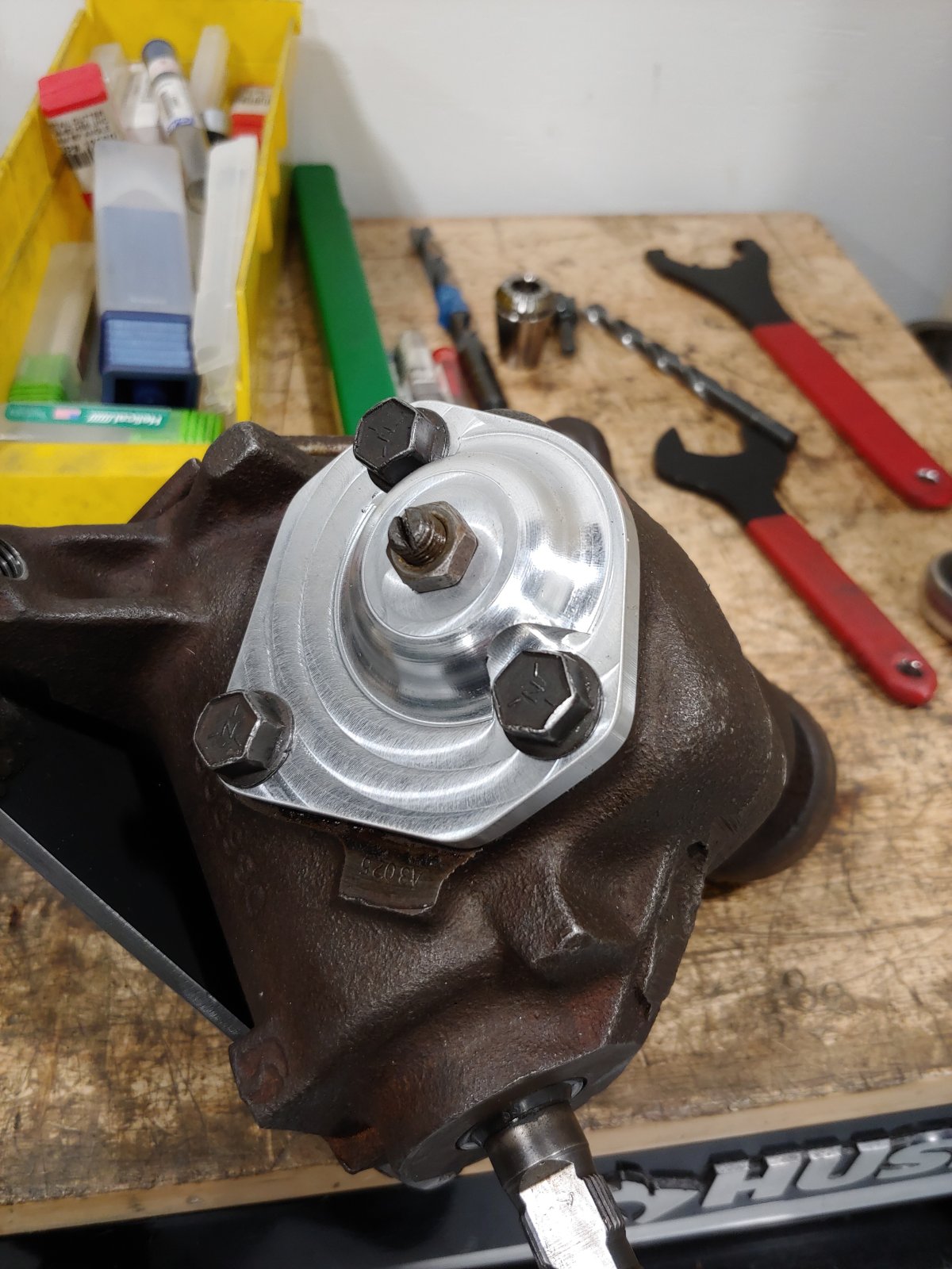

    In my haste and because of lack of tools and patience, I ended up breaking the top cover on the Vega box from hitting the end of the pinion shaft trying to get the pitman arm off. Ended up making a new cover. It was a fun little machining project in the middle of a sea of fabrication. I also Machined up some mounting tabs for the shock links at about the same time.
    20230308_174509.jpg 20230421_115436.jpg 20230421_115727.jpg 20230421_115736_HDR.jpg
