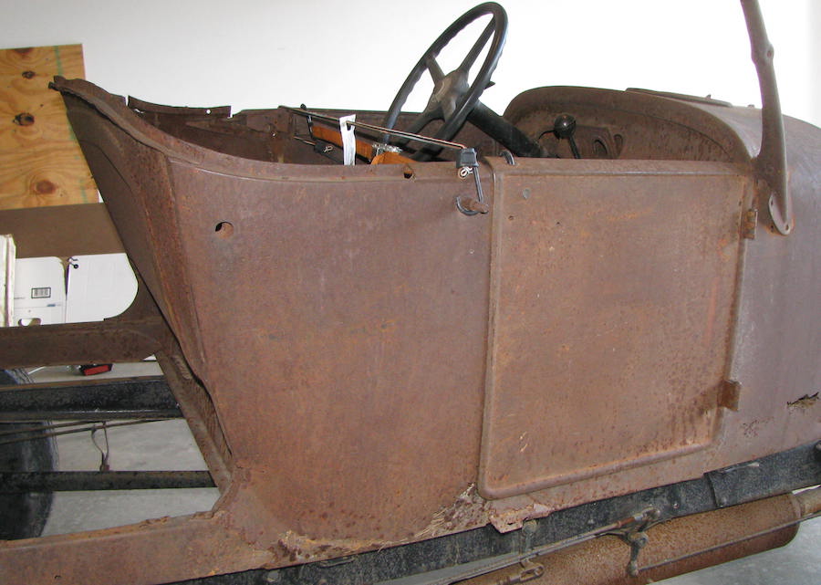

    The other side is in much better condition. More rust on the lower part of the post but aside from the typical rust in the body section the rest is good, considering it's a 92 year old body that was obviously neglected along the way.
    That's a picture from right after I bought the project. Because of how it sits in my shop, the vast majority of recent pics are from the left side.
    While searching through pictures I came across one that shows it had a door latch on it when I bought it, so I should have already known it had the late style latches. Oops. I haven't seen it for years though. No idea where it is now.
    Getting back to the bun panel, there is more info than I put into my last post. I posted early on that I had found an unfinished panel made by a member here. I forget the details but he changed direction on his car before he finished this panel but I got what he had done so far. I haven't done more than held it up to my car when I was tearing things apart and never did even figure out just how much more work it needs. I'll probably investigate that more today.
    Also, I ordered the bun patch panels from Howells (I know, they also made the deck lid that doesn't fit right but they're the only game in town from what I can tell). Anyway, the panels come in pairs so I'll have the lower section from that too. They are supposed to arrive tomorrow according to the notification I got from UPS. I ordered them (and other panels) weeks ago in anticipation of needing them and knowing they could take a while to get here. I'm not sure if the order will be complete, or how well any of it will fit, but it's a start.

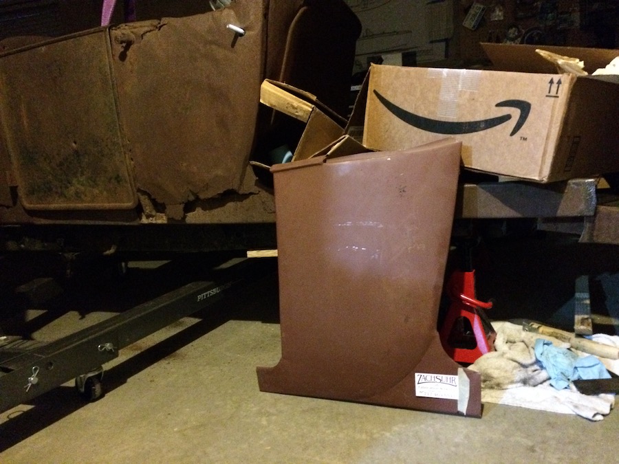

    Yeah I think the panel Zach made will work out. Not sure about the detail at the top of the door I'll have to copy, but I MIGHT be able to weld that part on from the original?
    I knew the panel wouldn't fit with the twisted up door post, but in an optimistic mood I tried to fit it without the post. There's a bracket on the lower front to position it on, and the top of the back to fit that end.
    Ok, not quite the fit I was fantasizing about... so I measured the metal and compared it to the other side. The dimensions were close enough that I figured Zach's panel will work. So then I measured the rear brace the panel bolts to. Starting down low the two sides were as close as couple be expected for the quick measurements I was doing. Moving up... the top sides of various details are off by about an inch which is just about what the gap is between the door and the panel. Looks like a little work will be needed back there too! I'll try to get the turtle deck to fit at the same time I suppose.
    My plan is to rework the door post using measurements from the other side and the fit of the door as a guide. I put an ad up here and on the Fordbarn forum looking for a post or the top bracket on the post but I've never seen one for sale so I'm not expecting to find one. After that, I'll rework the rear mount matching measurements and the fit of the panel. Once everything is fit, I'll move on to rebuilding the front of the subframe on the driver's side. I don't want to remove that brace until everything else is in position and I know there was a good fit before I messed with it.
    I'm ignoring the deck lid fit for now... I can get to a driveable car with no deck lid, but I need the doors to work.
