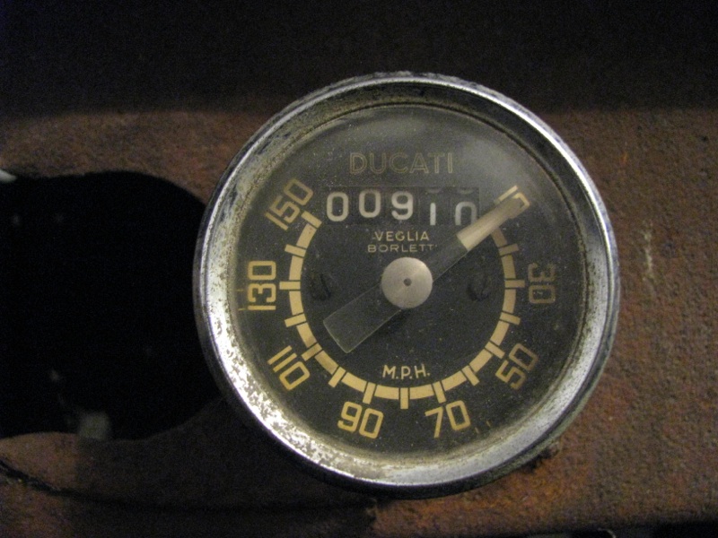

    Apparently you're into Ducati's. I've got a Clymer's Ducati manual from when I had a single cylinder Italian Motorcycle in the 60's when I was in high school. Its complete but the cover is faded. Its yours for media mail postage. PM me if you're interested.

    Thanks! I'm getting out of bikes though, and think I already have that one... I'm thinking someone else out there could put it to better use than me.
