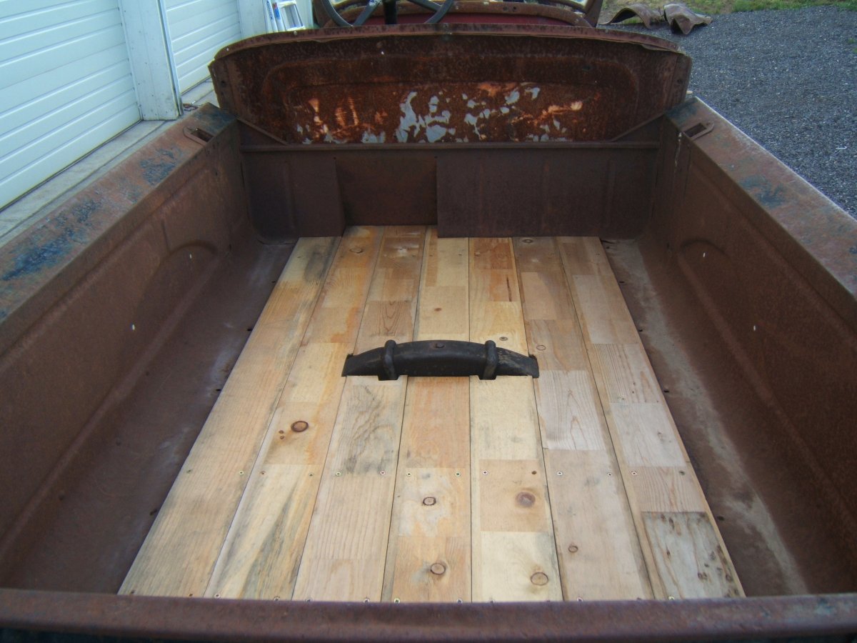

    Hey DesmoDog. Why not make a simple wood pickup box the same length as a stock turtle deck. Sub-frames are the same. That way it looks completed and you get used to the length and it gets you on the road sooner. Heck, varnish the wood and maybe it stays permanent! Or switch them out depending on your mood for the day!
    Dave

    My first one didn't have the rear sub-frame so I used 2x4 wood. Made them a little longer than the stock steel sub-frame. Cheap and easy. I used stock T head light/fender braces w/ the brace cut off for headlight mounts. Even bolted to factory bolt holes in the Model A frame! Here are a few pics of both rigs, but neither were finished when pics were taken. Second car had stock rear sub-frame. Also on 1st one I moved 1 running board support on each side and ran Model TT big truck short running boards. It made it WAY easier for this old guy to get in and out!
    26-30 001.jpg 26-30 006.jpg 26-30 007.jpg 26-30 010.jpg Roadster Pickup 004.jpg

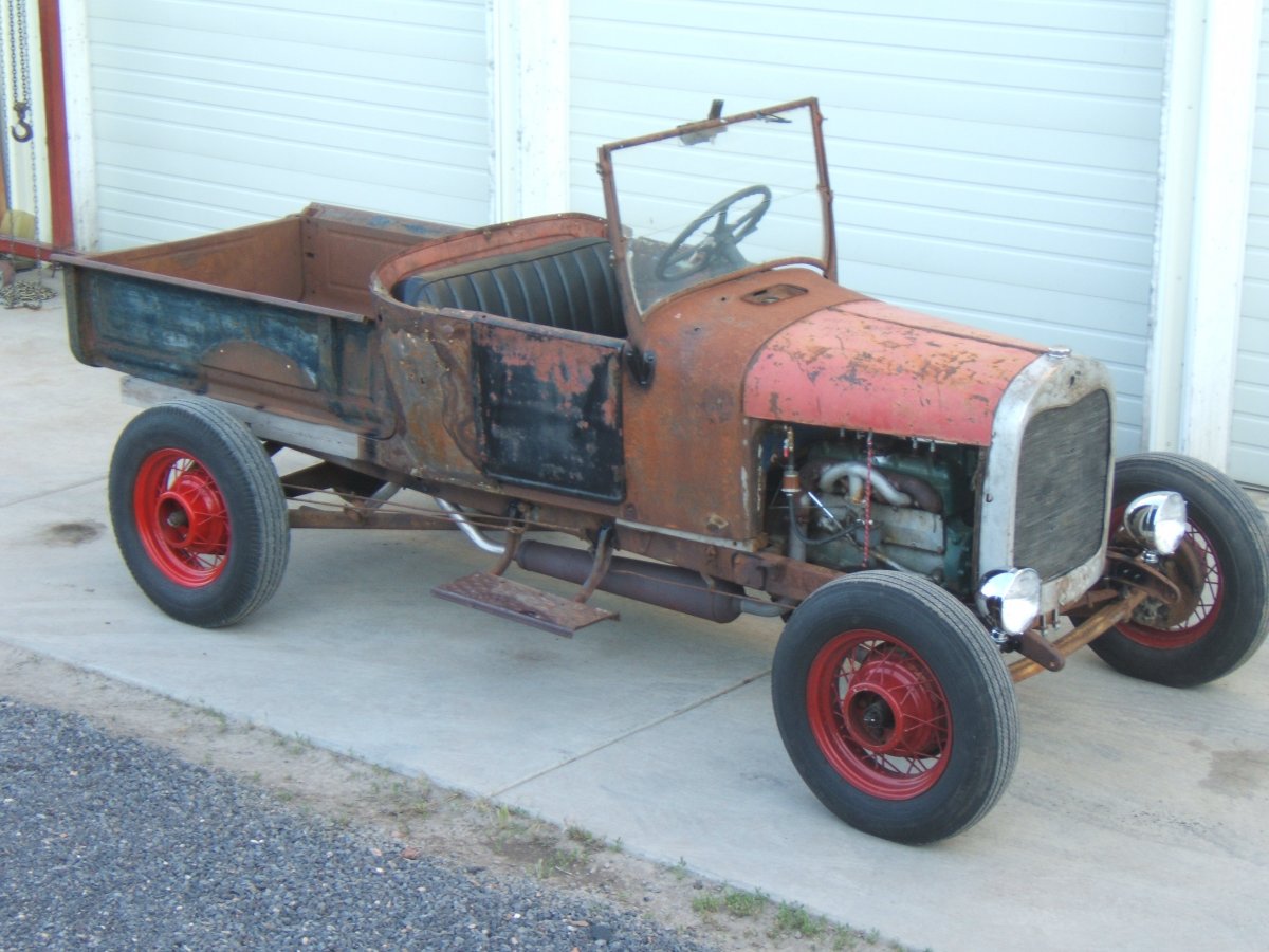

    I've thought about making a pickup box, probably a bit longer than a turtledeck. It's a definite possibility... in fact it's looking more likely lately. I think the money I had set aside for a turtledeck may be spent on something else in the near future. We'll see, more news as it develops.
    I'm planning on chopping the grill, not lifting the body. I won't have to deal with that for a while though.

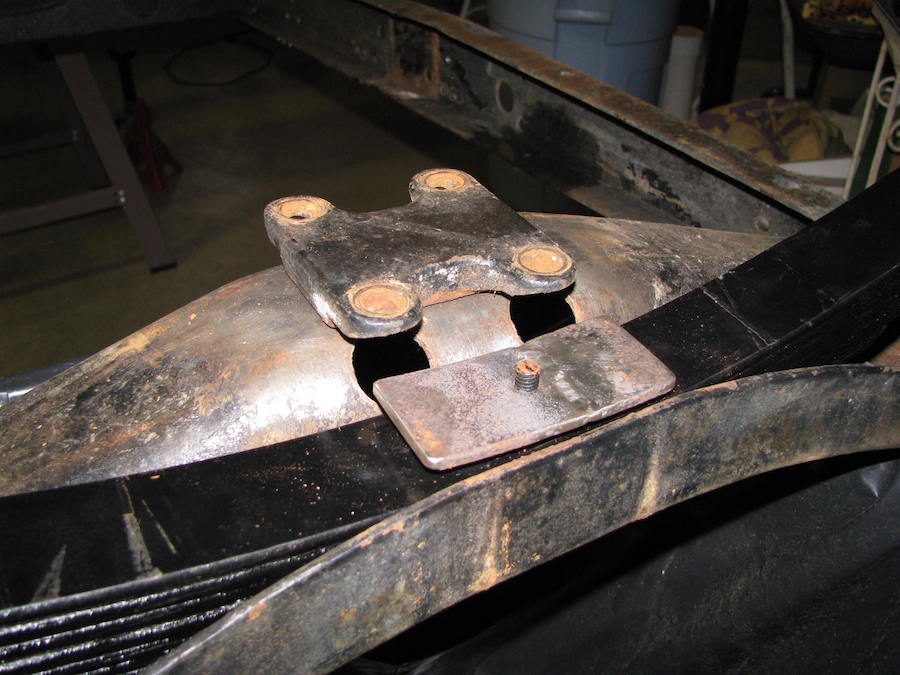

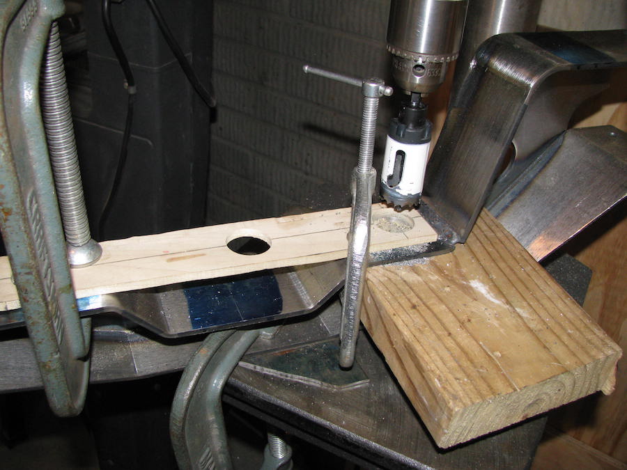

    The holes in the crossmember were too small for the Ch***is Engineering mounts, so I got out the holesaw and some clamps. The board is marked/drilled to held the center of the holes where they needed to be. The center hole is just to make sure the holesaw was the right size for the mounts. IMG_0637.JPG
    Tah dah! Every thing fits. I was a little worried that the bases for the mounts would hit the crossmember but all is good. IMG_0646.JPG

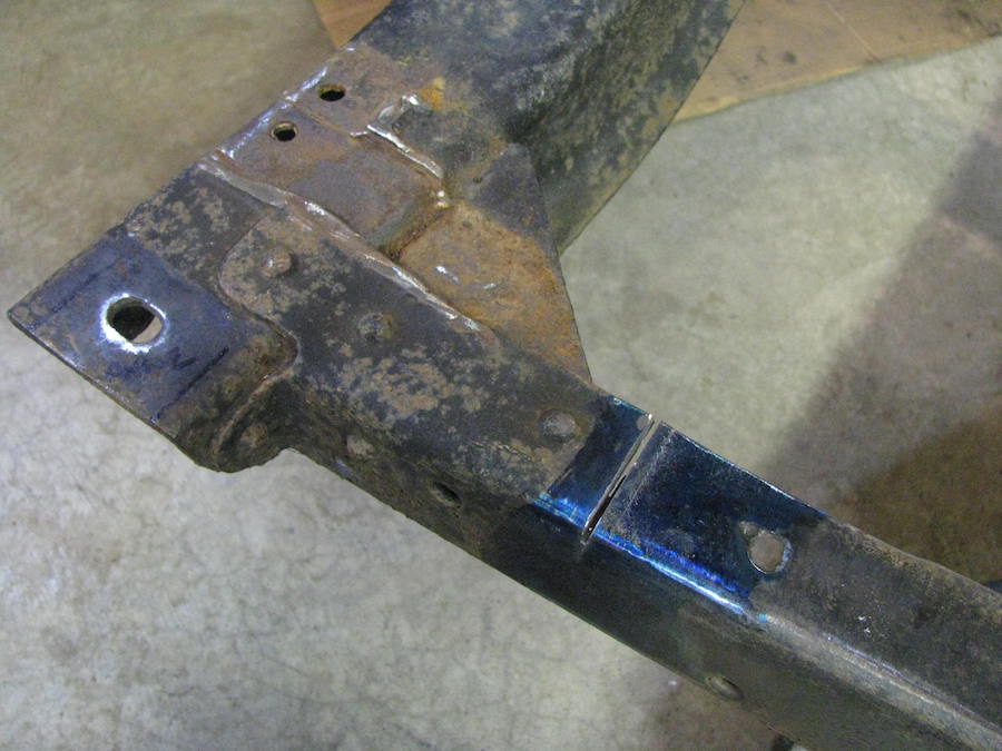

    There were two welds on the crossmember that bothered me, at the corners of the plate the mounts sit on. Probably would have worked out fine but I brought the crossmember to work with me and had them touched up. IMG_0679.JPG
    More better

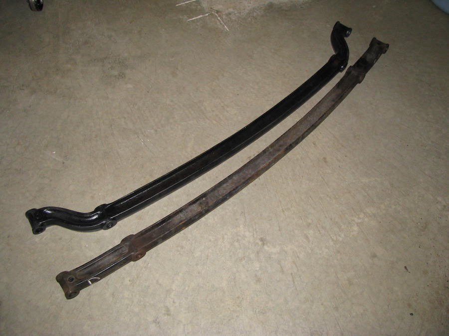

    I also got my front spring ***embeled/painted, awaiting the front axle now. Okie Joe called and it sounds like it will be sent out next week, there were a couple parts he needed before everything could be ****oned up.
    I got to work on the rear spring too. The lower leaf has been shortened to work with the new reverse eye main leaf, and all the corners have been rounded a bit. The bottoms have just been coated with graphite paint. IMG_0828.JPG

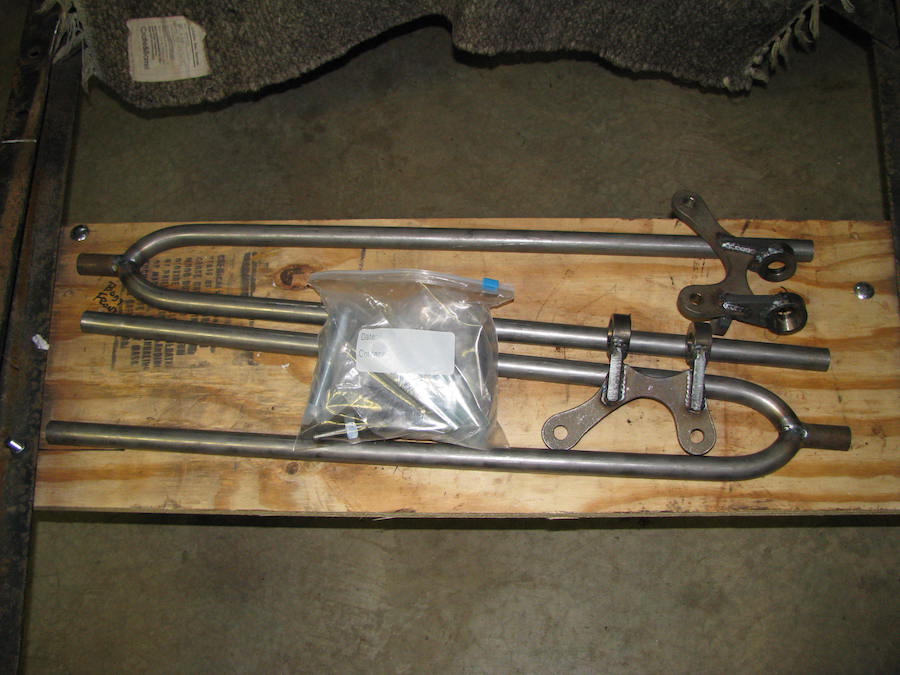

    And I got the hairpins from Rjay's.

    Mini update today. Made a little more progress on the rear spring but while doing misc BS I decided to stop ***** footing around. I've been going back and forth on if/when to step the frame. Finally figured out it's better sooner than later so I laid out the cut lines and with "...the first cut is the deepest" running through my head I fired up the cut off wheel and made the first cut.
    I did the other side too and flipped the frame for the bottom but didn't have time today to finish it up.
    Yeah, I know, it's a freakin cut. Whoopie. But it's all I got for now and it's one less thing I have to keep going over in my head! It will be stepped and it will be stepped before I start mocking everything else up.

    One of the leaves was broken when I pulled the front spring apart. I was going to just leave it out but decided to cut the ends off it and put that under the main leaf to bring it back to stock "stack height" or whatever it's called. I still have to paint it and add it to the stack.
    I also got some bolt on radius rod mounts from RJays to mount the hairpins when the time comes. I'm thinking I might use ****on head bolts on those, and fill in the heads once mounted. Once the frame gets painted they'll look like rivets. That's the thought anyway.
    So to sum it up, I'm kinda bummed I won't be able to finish up the step this weekend but I should be able to make progress in other areas so all is good.
    Forgot to mention - the dropped axle moves the top of the king pin boss up about 3.25". The frame step raises the top of the frame rail (and the crossmember) about 2.25" in case anyone is wondering.
