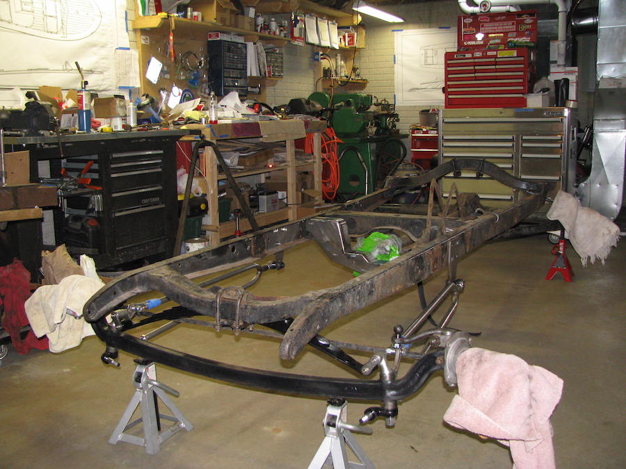

    Since I can't weld anything I started working on figuring the front supension out. I soon discovered the spring perches I got from Speedway don't use the same size bushings as the stock parts. Speedway sells the correct bushings of course but instead of doing that I decided to use some modified rear bushings instead. They were too long and the diameter was a little too big, but after some time spent grinding them down to the right length and honing the perches to a slightly larger ID I was good to go. Added the spacer to the front spring, pieced together one of the hairpins, and here we are.
    I don't have fasteners to bolt the mounts to the frame so I thought it was a good place to stop for the day.

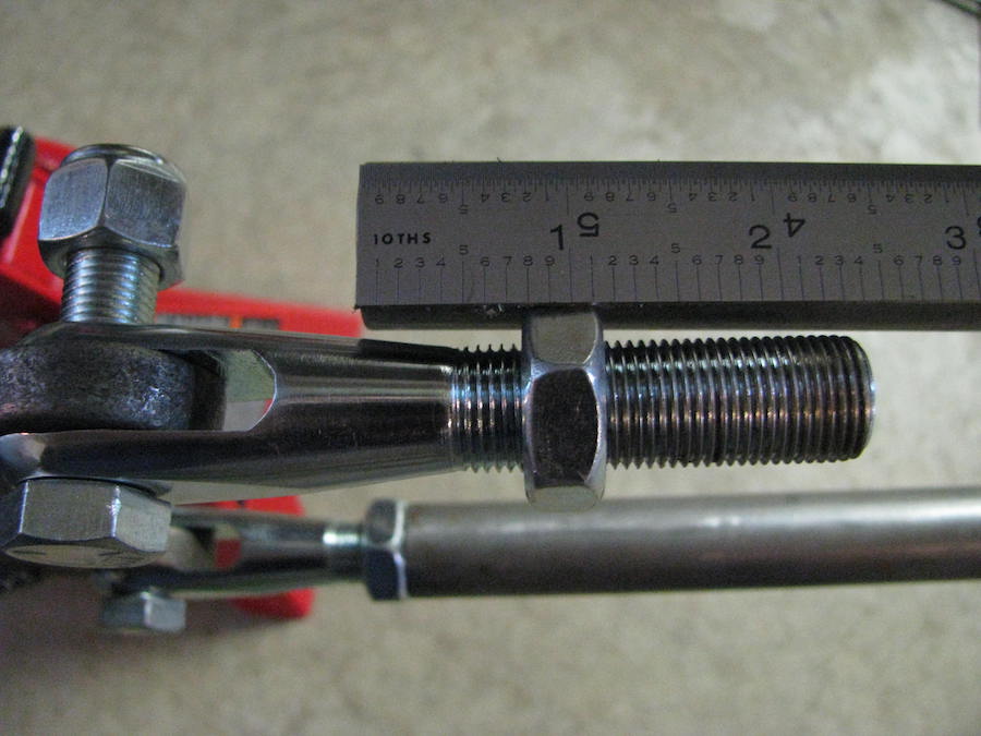

    I tried to set up the hairpins last night. First I figured out what the minimum insertion of the clevis and tie rod end should be (@1.5 times diameter). The remaining threads gave me the adjustment range of the parts. I put them in the middle of that range, so they could screw in just as much as they could screw out while still having minimum insertion. That means about .3” of thread showing on the clevis and about .5” on the tie rod. FWIW the tie rod still has about .3” of threads showing when it’s screwed all the way in so the .5” may sound like more than it should be.
    Then I measured the front axle. Honestly I’m pleasantly surprised by how square everything is. Next I measured the caster of the axle as it sat. I’ve forgotten the exact number but it was around 9 degrees, which made sense since I’ve read the front crossmember is set up with something like 8 degrees of caster built in.
    So far so good. Then I installed the hairpins on the axle. With everything set up at it’s midpoint on the hairpin, the hairpin angles down towards the ground. It needs to angle UP slightly to mount to the frame. The picture in the previous post shows what I'm talking about, though obviously the mount is hanging upside down in that shot. As it sits (no weight on the front end) there is roughly 7-8” from the top of the frame to the top of the mount for the hairpin. I can pull the mount up into place, but the caster angle drops to around zero.
    I get that the engine will lower the front end and change things but not THAT much?
    I thought the batwings might be upside down, but they aren’t. The hairpins don’t have an obvious top/bottom, the tube lengths are within about an 1/8” of each other. I’m not aware of the perch bosses on the axle being at an angle, so aside from the camber settings having to match the appropriate spindle, there is no dedicated driver’s side? (I still haven’t found any marking as made by Joe so I may have it wrong).
    My plan is to leave locating the hairpin mounts until I have an engine sitting in the frame, but this seems like something isn’t right and I’m scratching my head over what it might be… I thought I’d post it up and see if I’m missing something obvious. Or maybe I’m just overthinking it and need to wait until the engine is in before I can expect things to “fit”?

    I did that already. That's what I meant by hairpins set for max camber.
    Sorry for the ****py pics, they wer taking with a cell phone on my way out the door for work. The angle of the axle is distorted here (It doesn't really lean forward) but the set up is shown.

    Check the thread depth on the top and then you may need to shorten it to allow more adjustment. JW

    Adjust the lower clevis out until you get the caster you want and then cut the upper tube on the hairpin to allow the proper adjustment. You may need to tap the upper tube deeper but it will work. The only other option is to extend the rear mount plate down to get the angle you want or modify the batwings.

    Cutting the top tube probably is my best solution... so tonight when I got home from work I unclamped the mounts and disconnected the top tubes, set the axle to 10 degrees caster, and then pulled the mounts up into position. This is really how I should have been doing it all along, I was moving the axle around forcing everything into position.
    When I had everything in place I measured the overlap on the top tube, and it looks like if I set it up so there is still the full range of adjustment top and bottom, I'll need to cut about 1.25" off. I'm guessing that means I'll have to thread it a bit further, which means I'll need to drill it a bit deeper too.

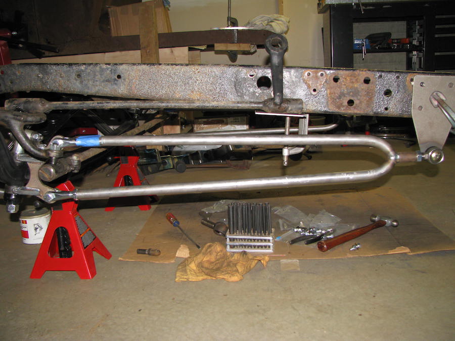

    Then I started screwing with the front end again. I wanted to see what sort of issues I'll be looking at trying to get the steering to work. The good news is, I think I'm sitting pretty good. I'll have to bend the steering arms down a touch, but nothing too extensive.
    I saw a thread here about using a VW part to mount the steering box on top of the frame. I liked the adjustability that offered and it's looking like it'll work for me just fine. I'm not sure how the stock location would work with these hairpins. The pitman arm is probably a bit high in this shot but this is the general idea. I have a couple F1 steering boxes to work with, I would have set one of them on here to get an idea of how close I am, but, um, well.. I can't exactly remember where I put them. I really need to clean things up around here.
    Two things I'm wondering about:
    1) Since I didn't get the axle stretched when it was dropped, the tie rod is too long. I'm ***uming I can cut it to length and clean it up, then run a die down it to add more threads?
    2) The drag link now mounts on top of the spindle, which puts the pitman arm attachment on the wrong side. I'm sure I've read on here how guys deal with that but I've forgotten. Time to do a search I guess.

    I have an F-1 steering box on mine and here is how mine was mounted, could be done many ways but this was done many years ago so that's how its staying.
    And yes to the tie rod.JW

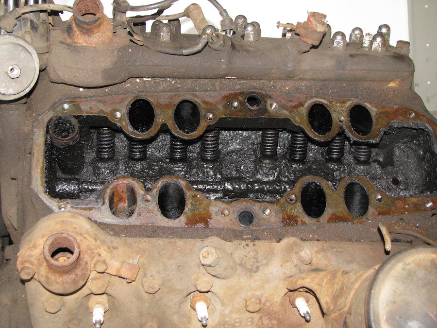

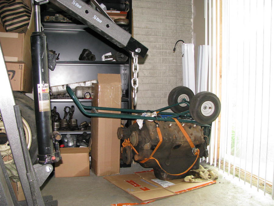

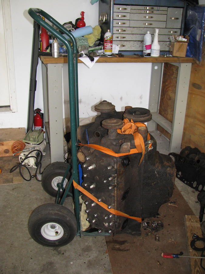

    When I got home from picking that up, I decided today was the day. The flathead needs to get moved from my garage to my walkout ba*****t/shop. That entails going downhill, then across the hill, then back up it. I was NOT looking forward to doing this since I wasn't exactly sure how I was going to make it work.
    I decided to start simple and use what I had on hand. A two wheeled dolly that I've abused greatly over the years. It seemed the only way to get it to remotely fit was to put the dolly over the intake area of the engine and strap everything down. So I started pulling parts off the engine. Here's what it looked like under the intake manifold.
    I didn't realize Ford cast these blocks out of lava...

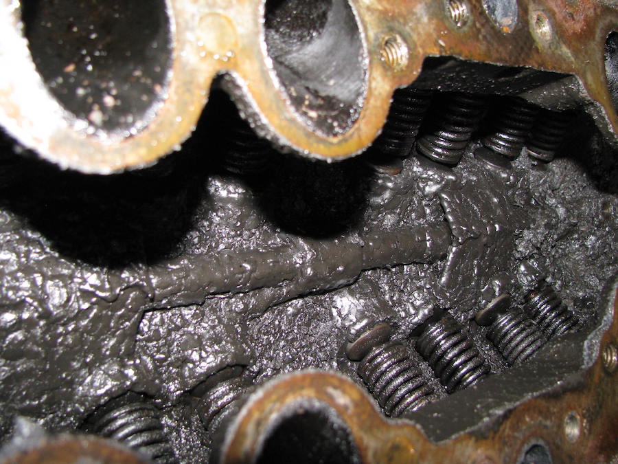

    Yikes. In other news there were no thermostats under the housings, and there is definitely rust in there.
    So... you know those times when you're going down a path with something, and you're thinking "there is no way this is going to work..."? This is one of those times/plans. I figure worst case I'd get it onto the hill, everything would go south, and I'd end up dragging it through the yard with a come-along. So what, today's the day, it's getting moved one way or another.
    The first 90% of the move went much better than I expected. Zero issues. Ok, there were a couple times the engine almost took over and shoved me down the hill instead of me guiding IT down, but you have to expect that. The last 10%? The back up the hill part? I used to be much stronger... it took several steps. Stopping to rest and ***** about gravity. Finding a lever and some wheel chocks. Contemplating hiring a Bobcat, that sort of thing. But in the end I finally got it to the threshold. And couldn't get the wheels of the dolly over said theshold, so I dumped it onto it's already much flattend pan. Done! When I go back down there, Mr. Engine Hoist can take car of the heavy lifting from now on. And my plan of bulding the engine in my ba*****t over the winter, then making a dolly specifically to move it back up the hill? Screw that. This engine will be built in the summer, in my garage, where it will stay until the car is rebuilt in the garage. Once that block leaves the ba*****t for cleaning machining and whatnot, it's not coming back down.

  21. 26 T Ford RPU
    Joined: Jun 9, 2012
    Posts: 12,618
    26 T Ford RPU
    Good bit of progress and I bet the tires on the trolley nearly cried enough with that load !! JW

    I had to add some air before I took off, and there was definitely some creaking going on, but it made it ok.
    I spent a lot of time downstairs this father's day weekend, I think he'd approve. He'd probably encourage me to up my plans on the engine though. Sorry dad, no Mercury crank or 3/4 cam... for now anyway...
