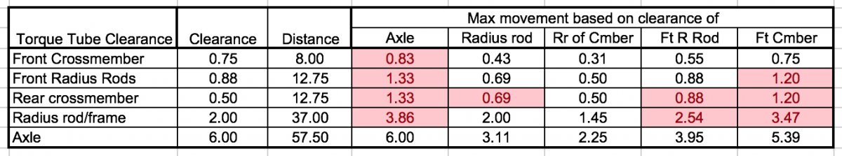

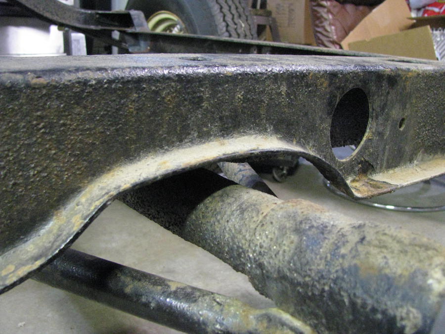

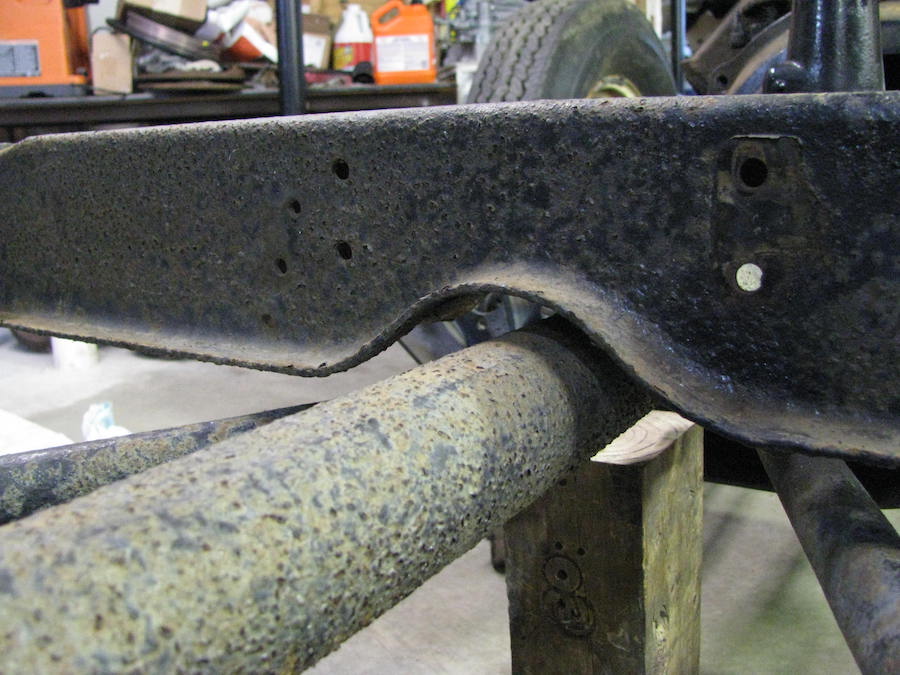

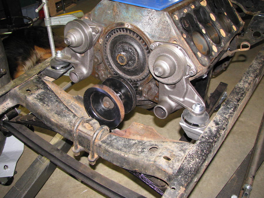

    I played around with the engine mounts/positioning more today. Here's the direction I'm going now, with the rubber mounts in positon the crank pulley is about an inch higher than I had it before.
    I checked the clearances between the torque tube and the cross member again too.
    That's about .5" at the front and .75" at the back. Somewhere I mentioned I had slid the crossmember back from it's stock location. Right now the rivet holes from the front are lined up with the old rivet holes from the back. I think this is about where it will end up but I can still move it around if I have to. Anyway I got to wondering just how much suspension travel I'd have with this set up, and what would bottom out first. I took some measurements and laid it out, maybe this spreadsheet will make sense. Granted I listed things from front to back on the left and then back to front going across but that's life, deal with it.
    The red cells show where intereference would be, based on the listed part being the limiting factor. So this tells me with the crossmember in the current position, the torque tube will hit the back flange of the crossmember first.
    No biggie, I can mod that. What I can't mod (easily anyway) are the radius rods hitting the frame. So those will be the limit. That gives me a whopping 3 inches of suspension travel, not counting how much it will drop when the body is back on. On the other hand, when I had the body on and jumped on the back end, it didn't move much so maybe that's not an issue.
    As for the crossmember hitting the torque tube before the radius rods bottom out, I'm wondering if I can't just reverse the crossmember, flip it around so the back is in the front. The numbers say it should work so I'll try that before modding anything. I'll also finalize the location (based on mounting the body to it) before I mod anything.
    Also... with the engine in place I was able to slip a belt on the pulley. AND... I think there is some room to be gained if I work with the U-bolts hoding the spring on, so I'm still good to go with this.
    Next step is to mock up the fan/radiator placement. The nuclear option is to move the engine back and shorten the driveshaft. That would mean a later rear axle (why not if I'm already shortening a driveshaft?) and confirming the body would still fit without major firewall mods.
