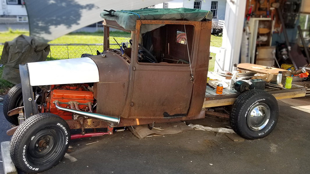

    Thought I’d post some pics of my 27 T roadster build. I bought the car with the body sort of bolted down to a 30-31 model A frame with drivetrain. I’m going to get it running with the Model A drivetrain for the meantime. I have a Mercury 255, 39 3 speed and V8 rear to go in the car eventually. IMG_1763.JPG IMG_1762.JPG IMG_5194.JPG IMG_5196.JPG

    I was also able to find a 28-29 model A radiator for it. I think the lower profile of the 28-29 rad better matches the lower profile of the T body

    The frame was a lot worse than it looks on the pictures. I did keep a couple of the frame parts but a good chunk went in the s**** metal bin. I kept all the mechanical parts off it, steering column, pedals, wishbones etc. I’ve also got a 32 Ford K member to put into the car.
    I’m going for a prewar look at the moment. That will have to change if I put the 8ba in it as that’s a 49-53. So I’ll have to either find an earlier motor to keep it prewar or just go for a early 50s look. I’ve done a lot of the work already and the car is about 95% road ready at the moment. I’ve just been going through my photos and decided to post some of them here.

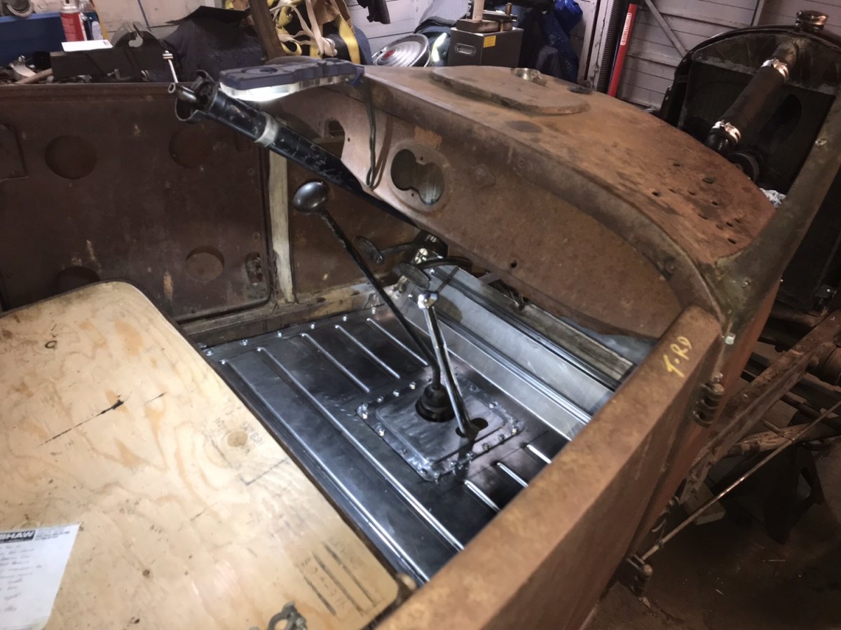

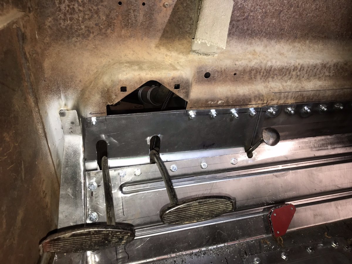

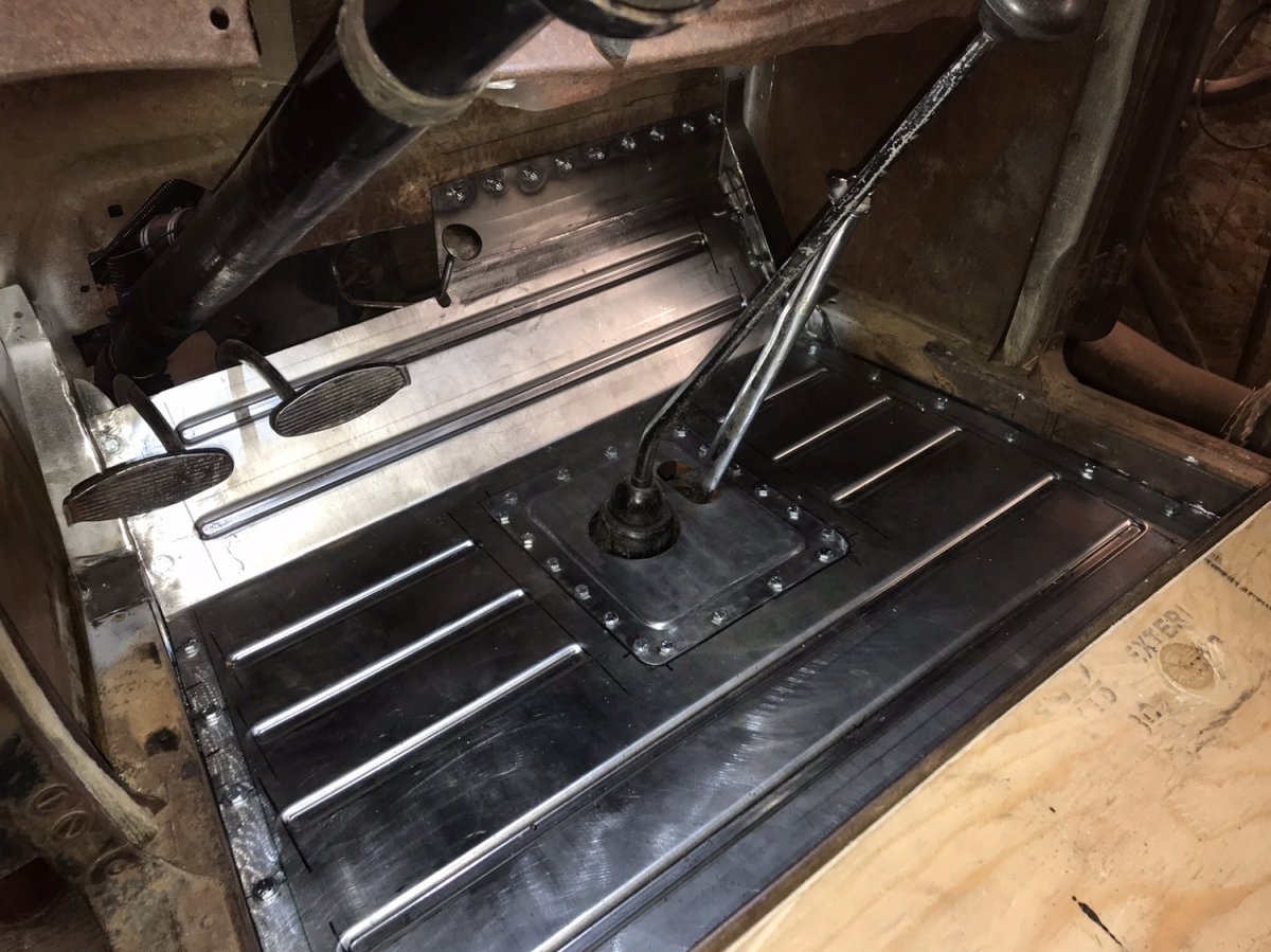

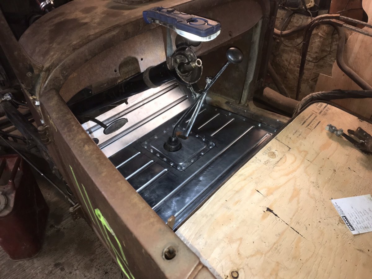

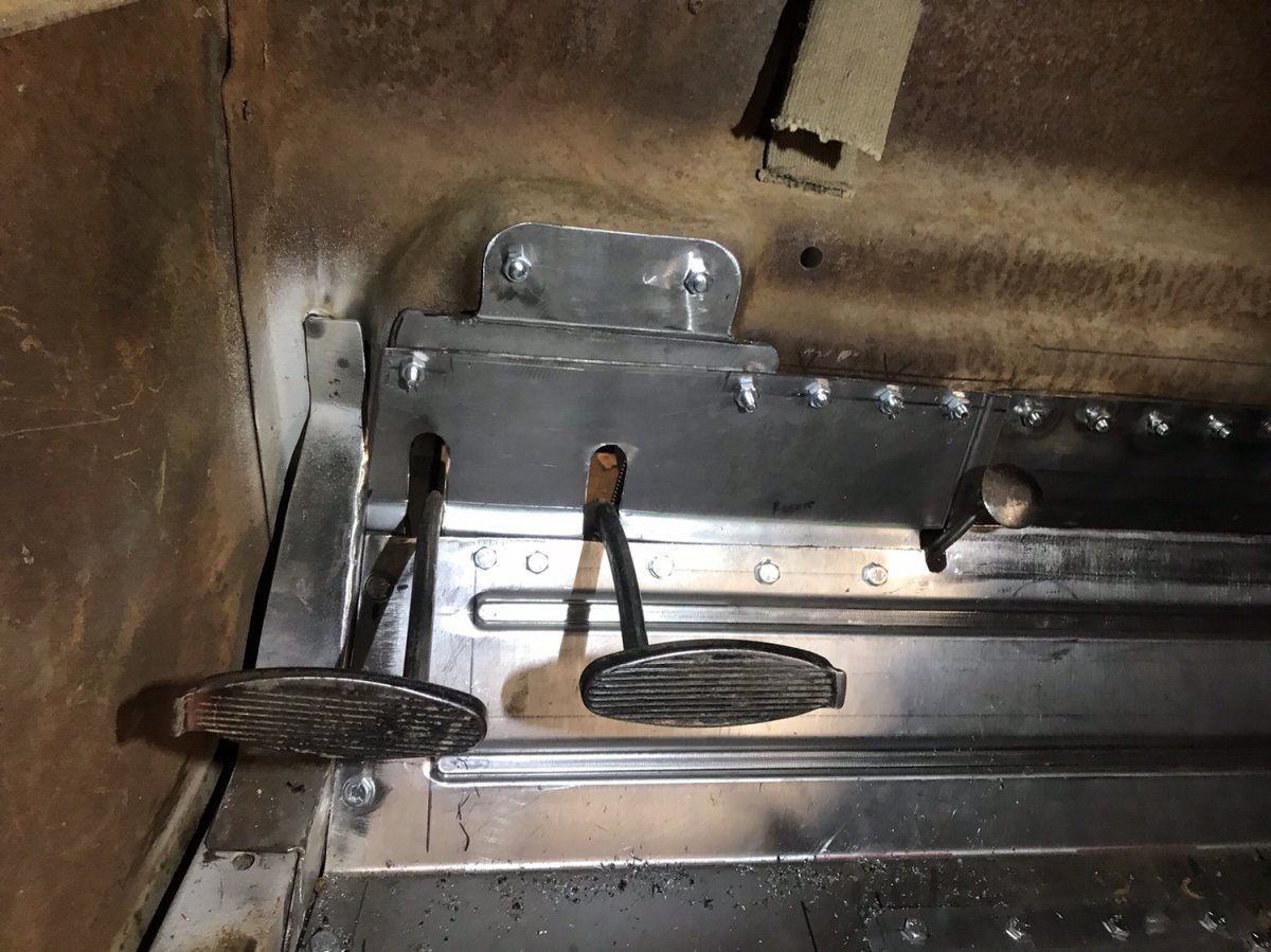

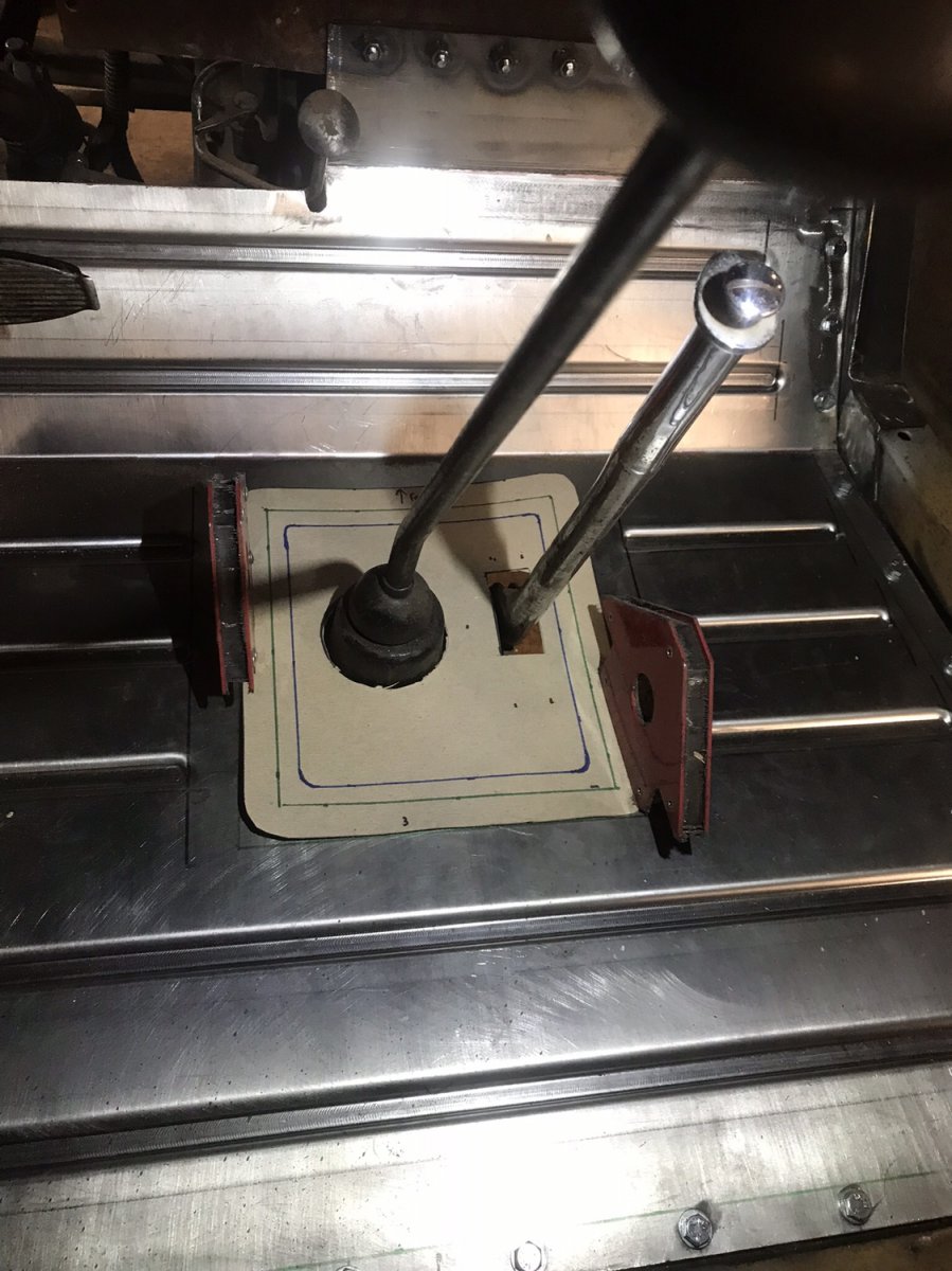

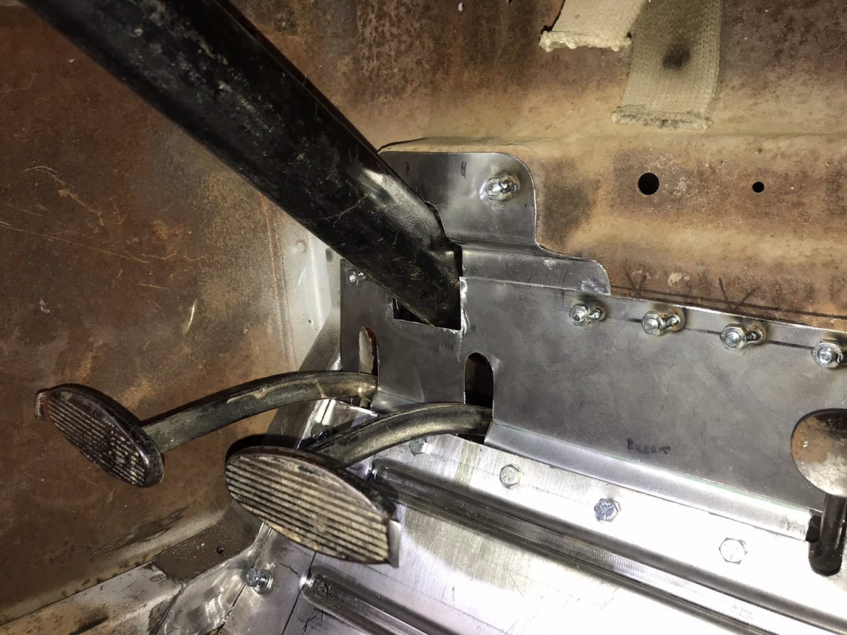

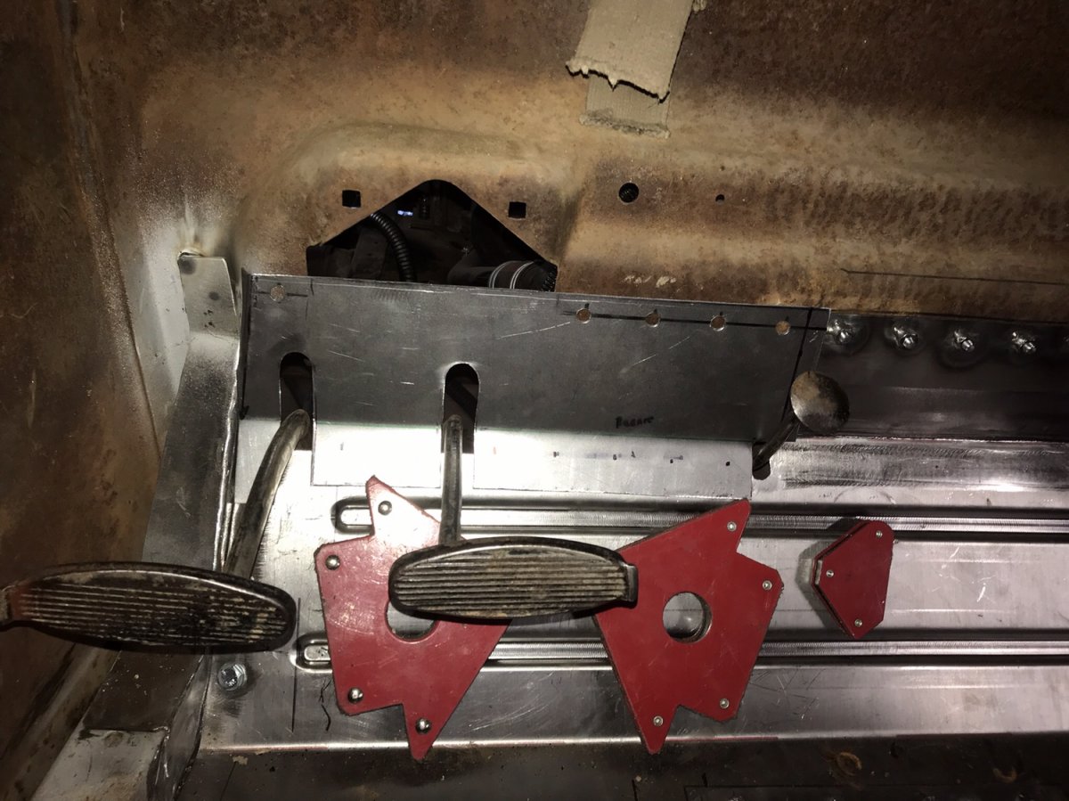

    Pedal clearance for the Model A pedals is an issue in the already tight confines of a model T ****pit. I removed the factory floor brace to allow more room for the pedals and the floor. I laid out some templates and tried some designs for the beads in the floor until I found something that worked. I cut the floor out of steel, laid out the bead designs and built a structure for the floor to rest on. The puny Chinese bead roller I have was not going to give the results I wanted in the floor so I had to send the floor to Rods and Restos in Strathmore, Alberta to get the beads done on a pullmax. I was very happy with the results, I had to alter the initial design slightly but came out with a better end product. I welded all the braces into the Model T and installed the floor. The floor panel must have been in and out of that car well over a hundred times during the build.
    You can see how much more room the braces gave over the factory ones

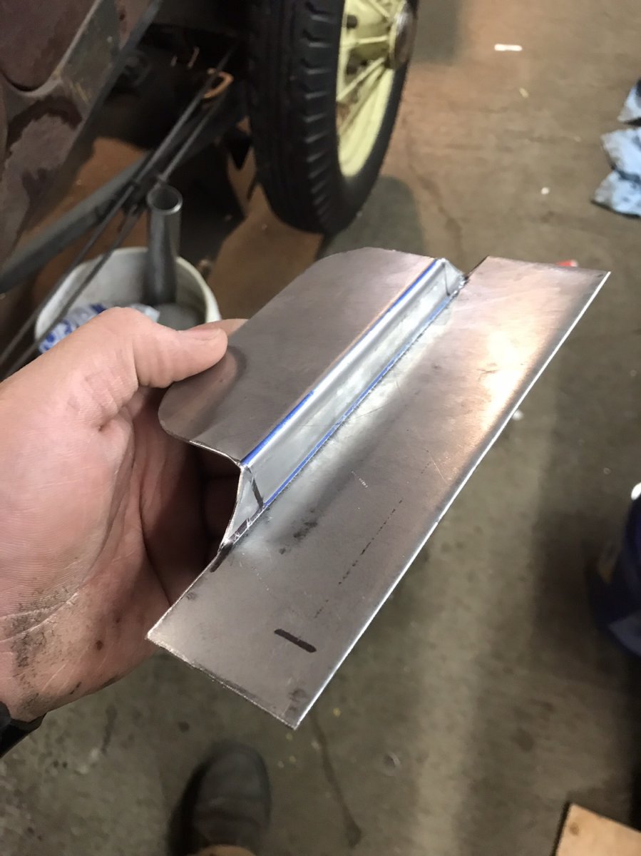

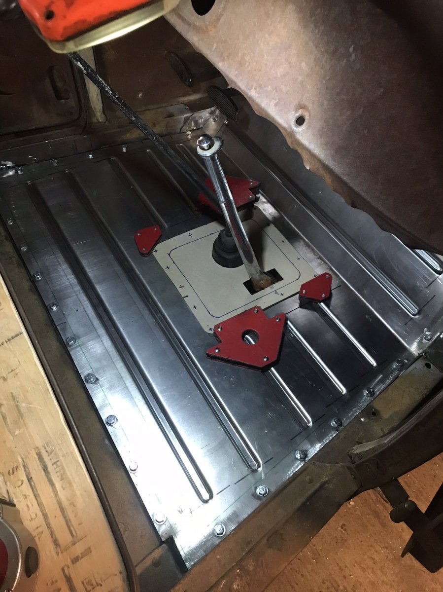

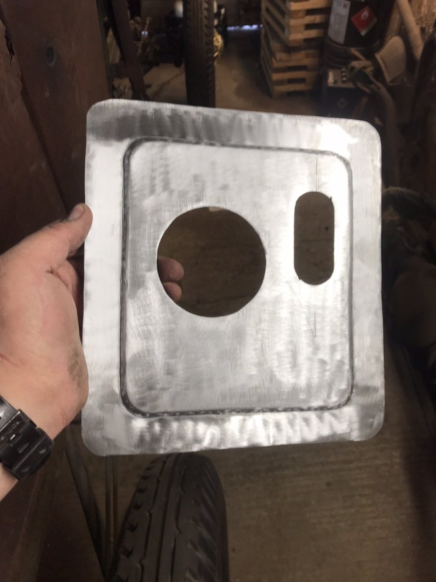

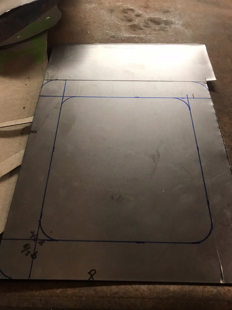

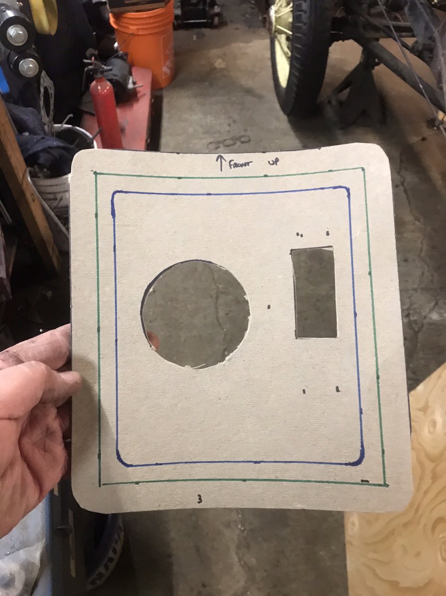

    Some pictures of making the trans cover and the pedal and steering column surrounds

    Wow, I REALLY like what you've done with this floor and interior space in general! Is it all held in with rivnuts and 1/4-20's?
  26. Joe Coughlin
    Joined: Jun 20, 2016
    Posts: 118
    Joe Coughlin
    Thanks, yeah its all rivnuts and 1/4 x 20 bolts for now. eventually I'm gonna swap them out for stovebolt screws to give it more of a riveted aircraft style look

    Wow, amazing job on your roadster, you just created a lot more leg room with your new floors. I want to do the same with my T, but I lack your skills. I'm subscribed to get more ideas from your build.
    Joe Coughlin likes this.
  28. Limey Kid
    Joined: Mar 5, 2006
    Posts: 1,024
    Limey Kid
    Great work. Every inch counts in a T roadster if you want to sit "in" it not "on" it.
