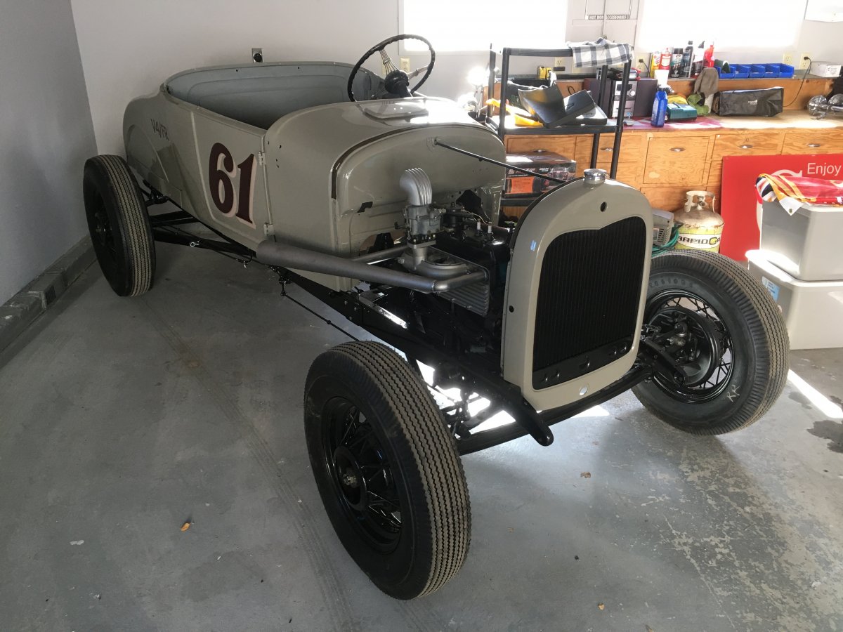

    IMG_2963.JPG Here's one I put together last year in Calgary. It's not 100% finished but it's close

    That’s a good looking car. What area of Calgary are you in?

    The car is in the SW , most of the work was done at Highwood R&C by myself. That body was in pretty bad shape too
