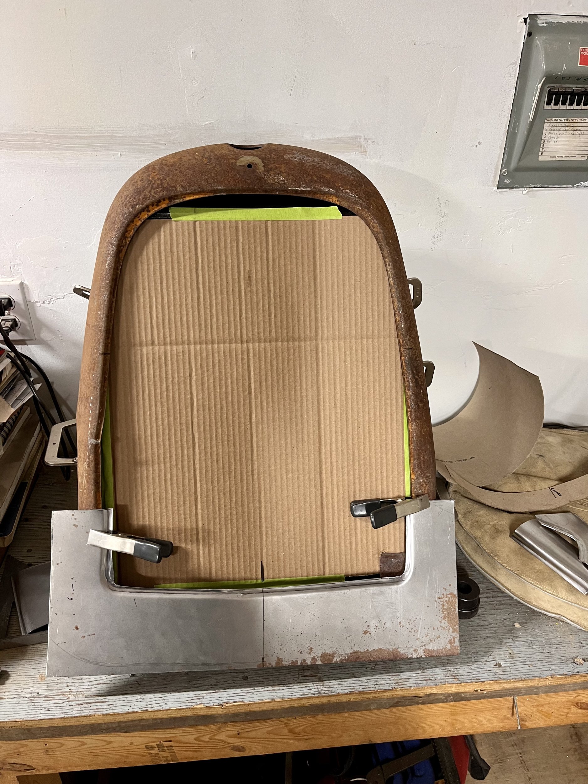

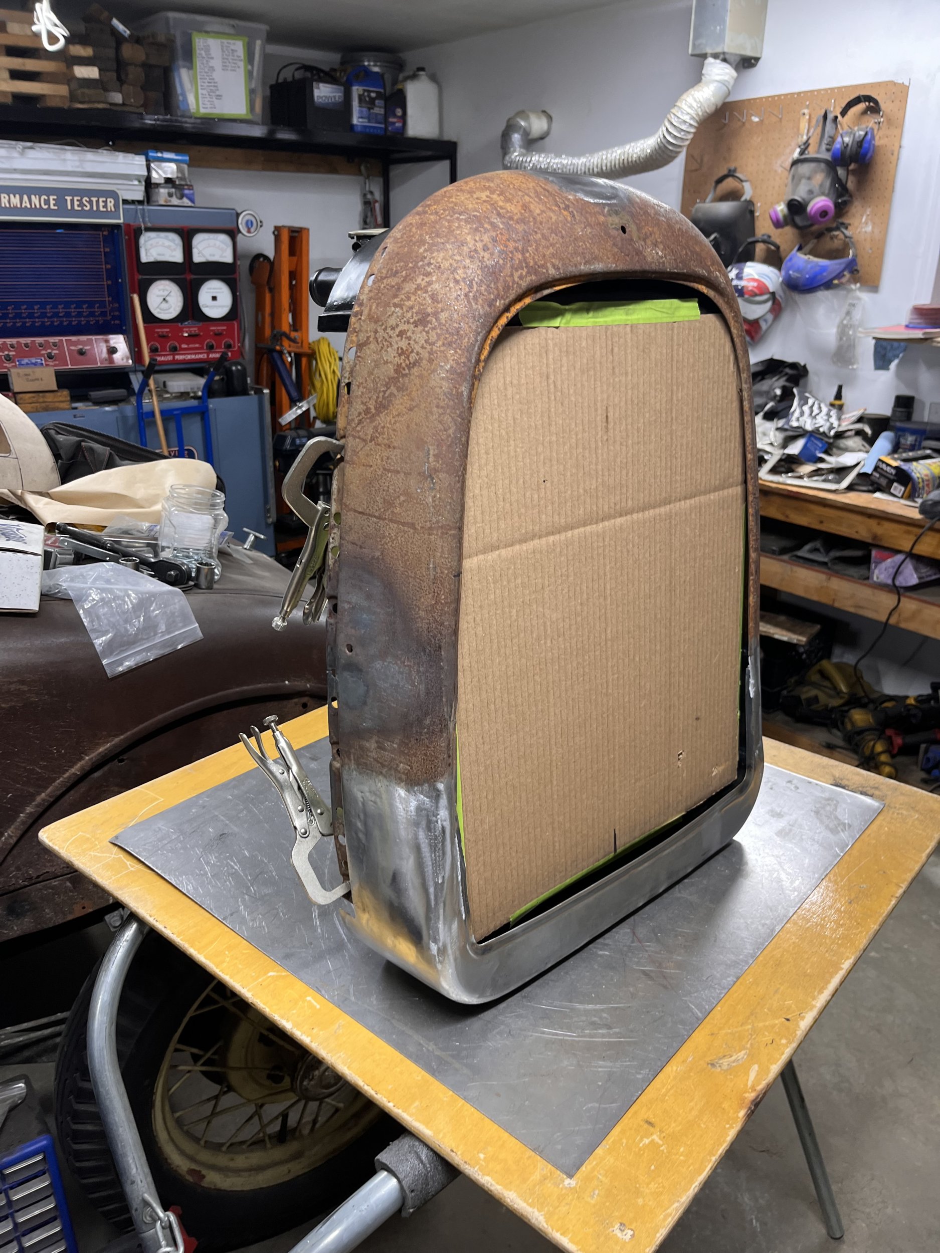

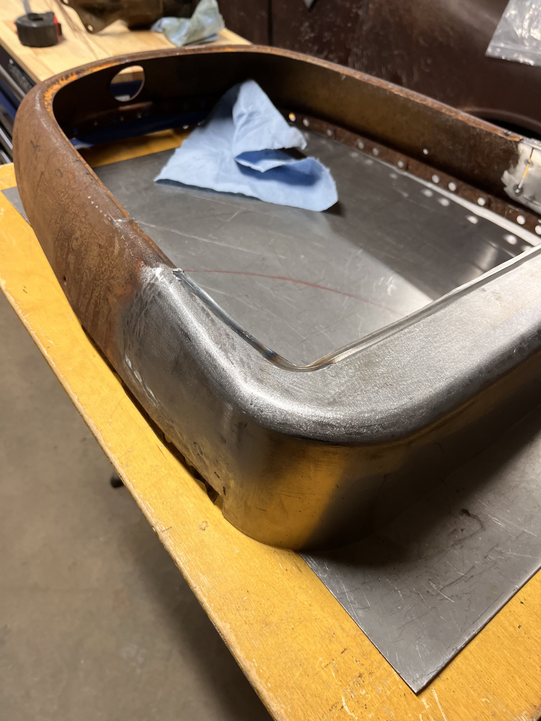

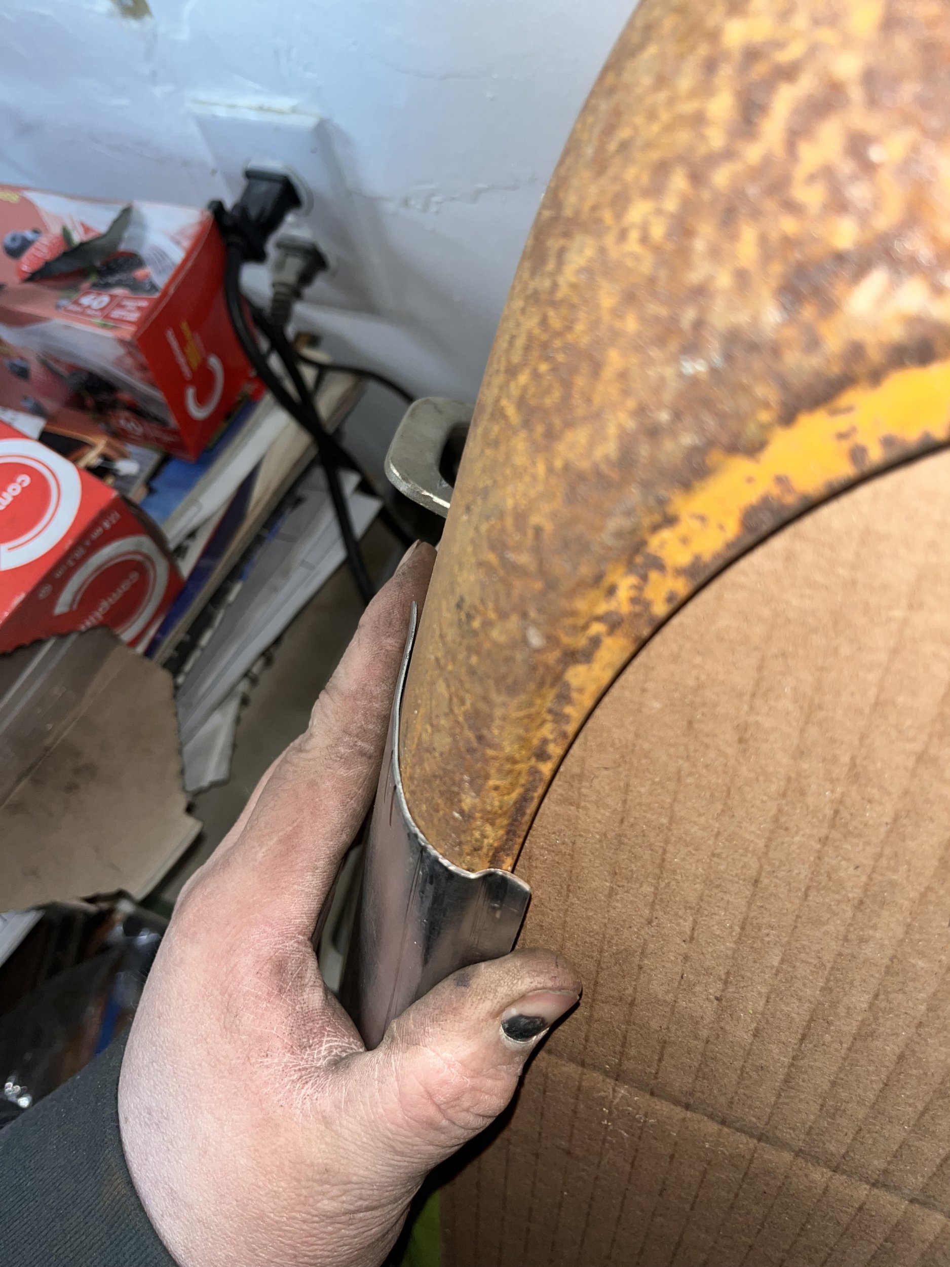

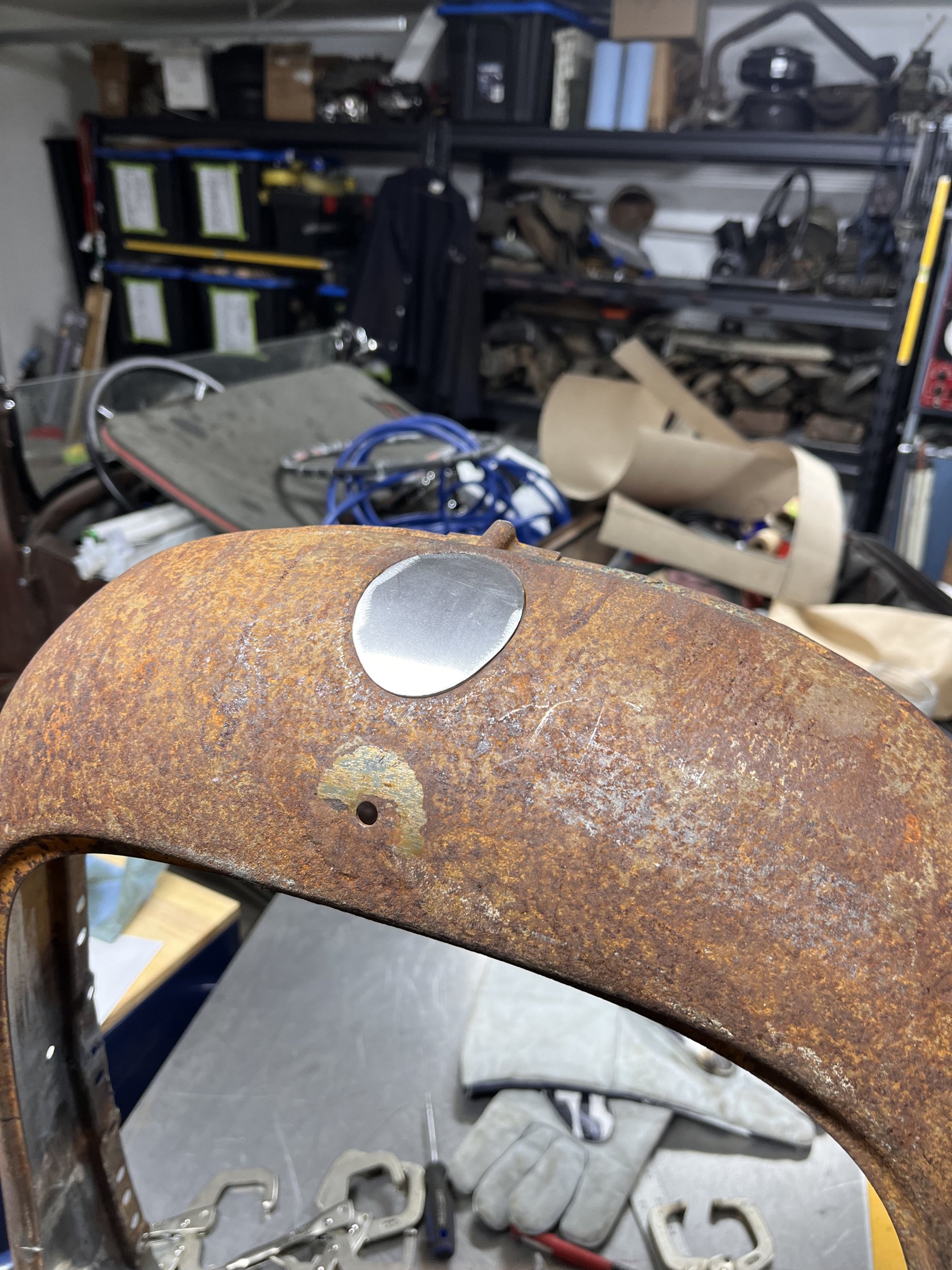

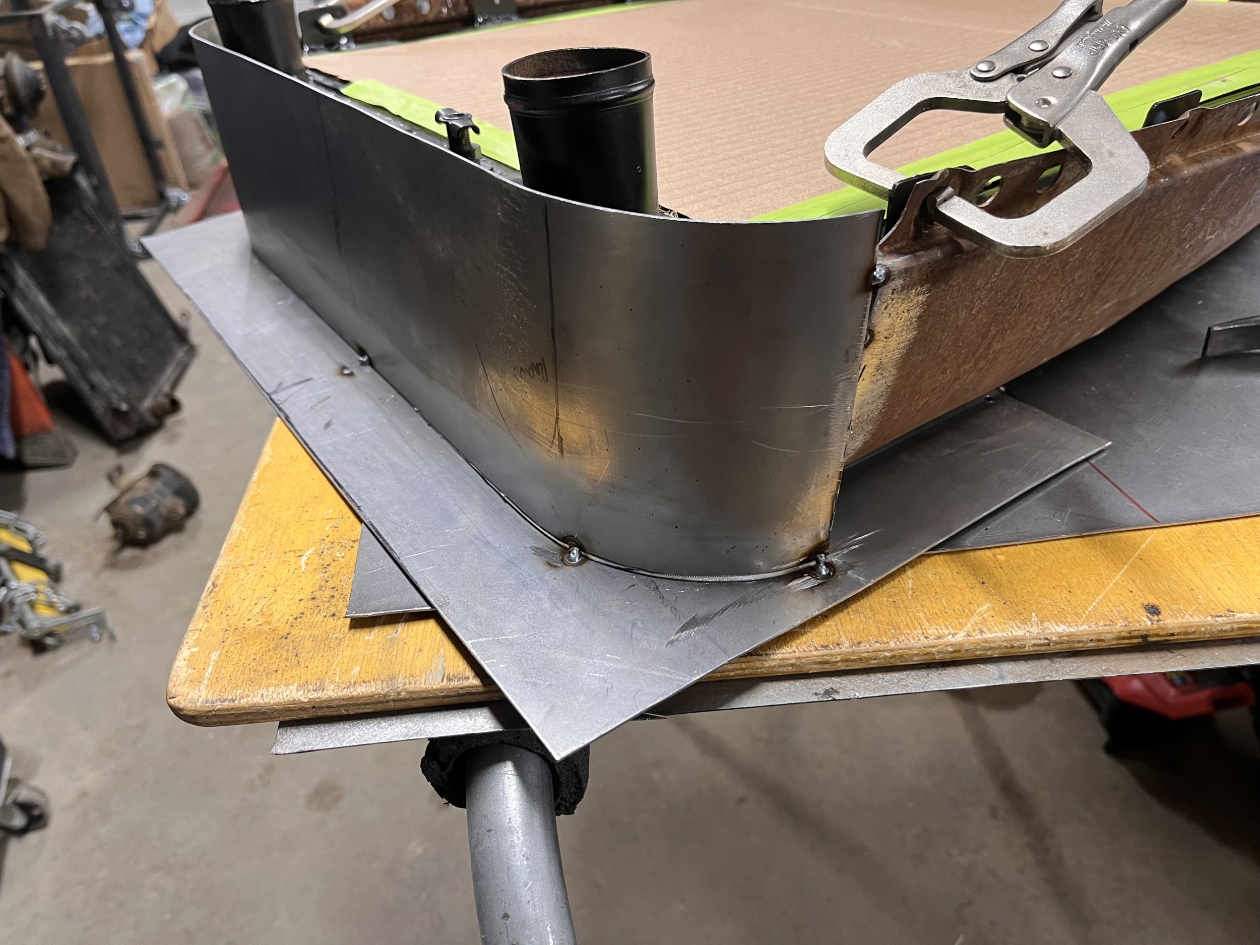

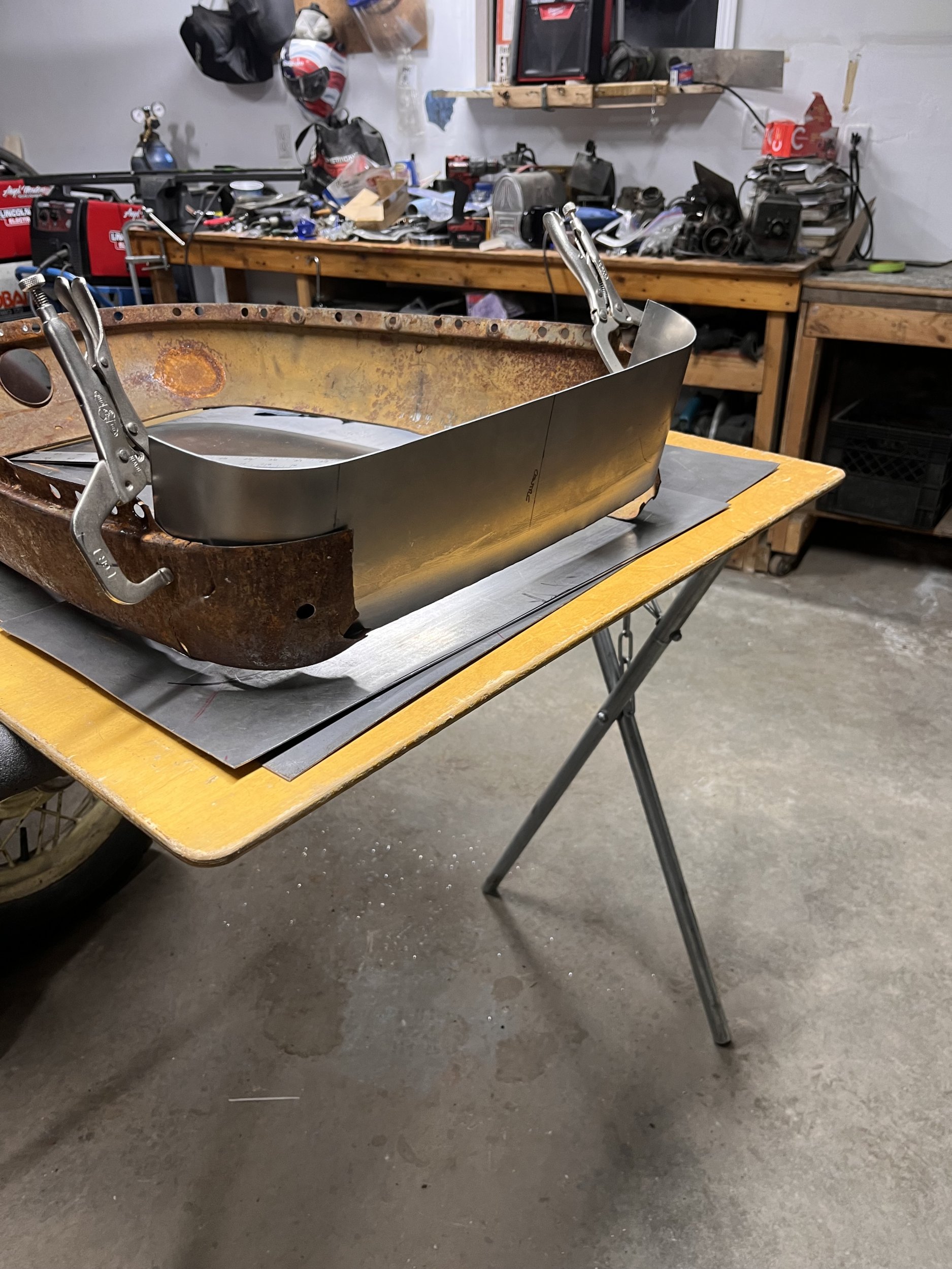

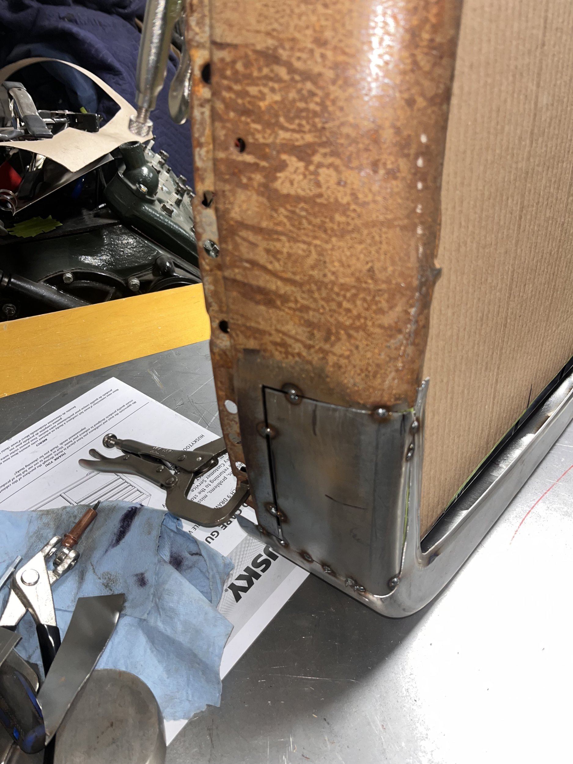

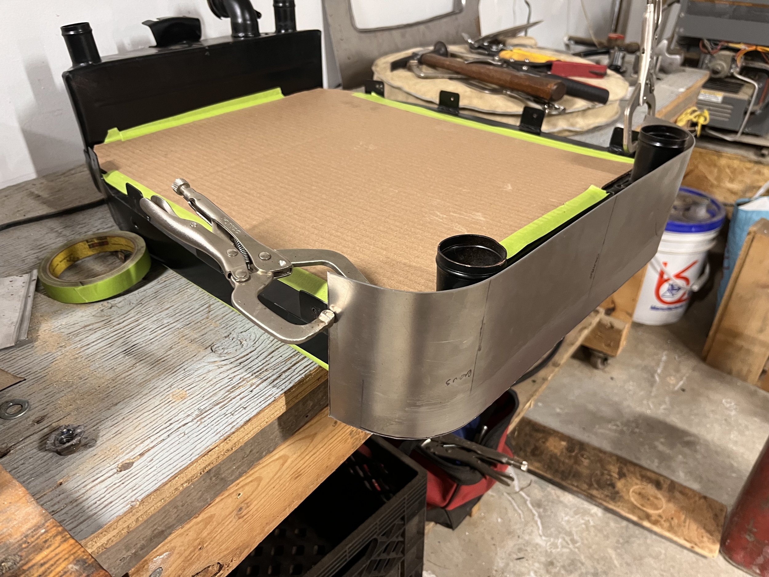

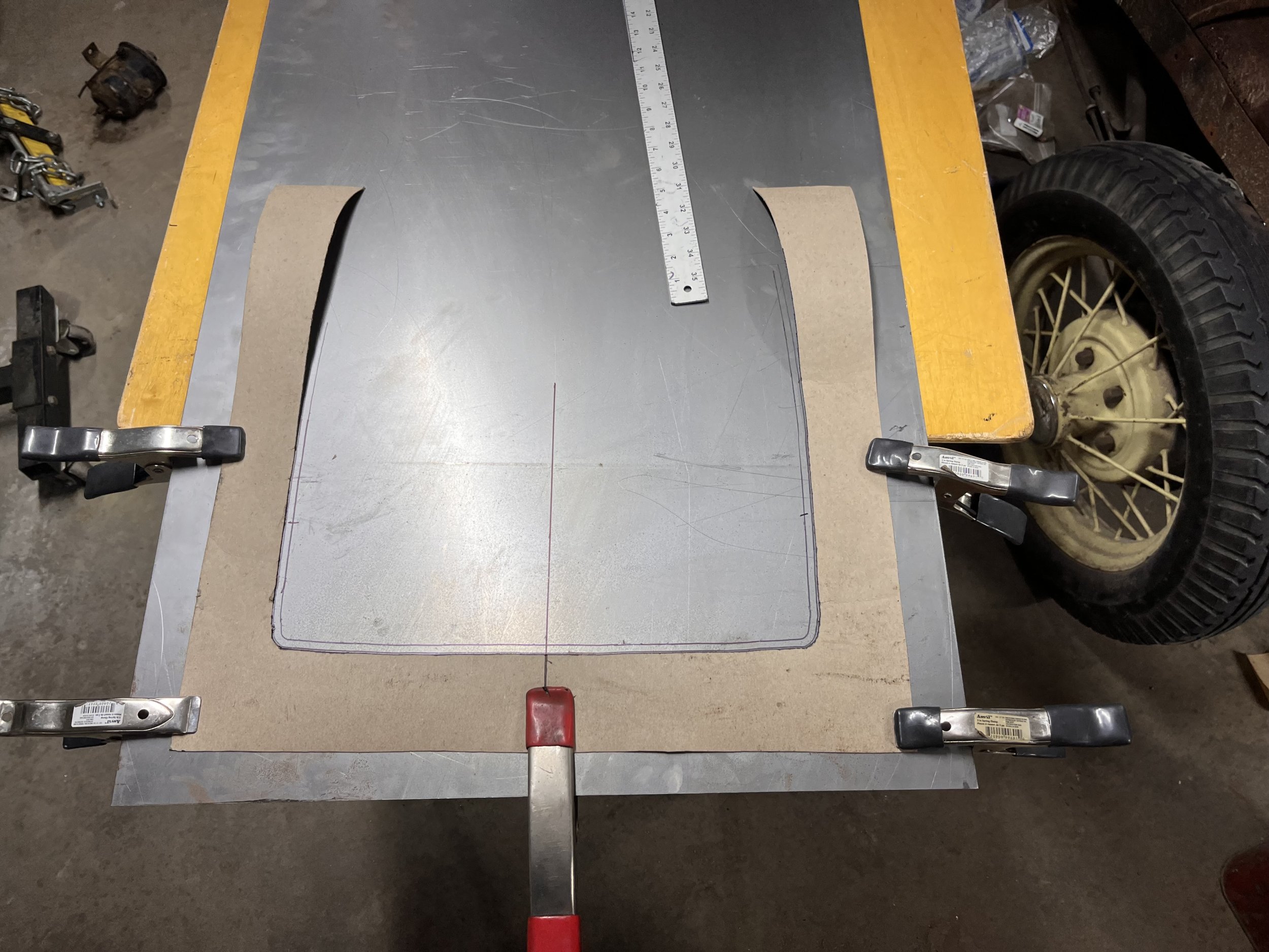

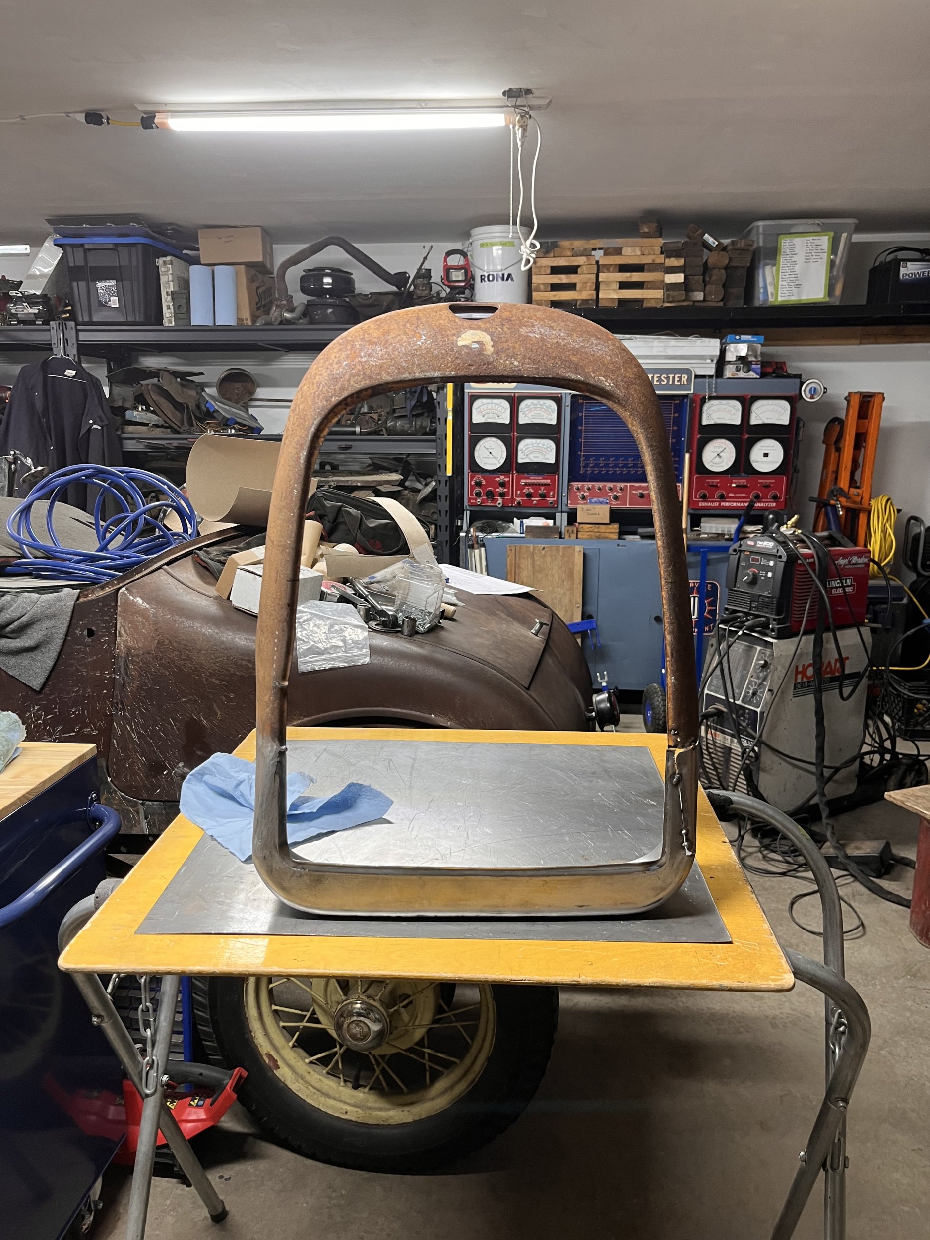

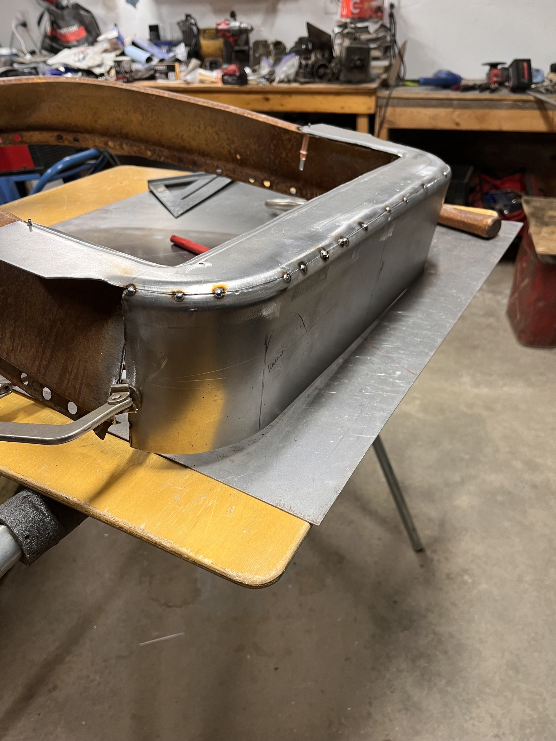

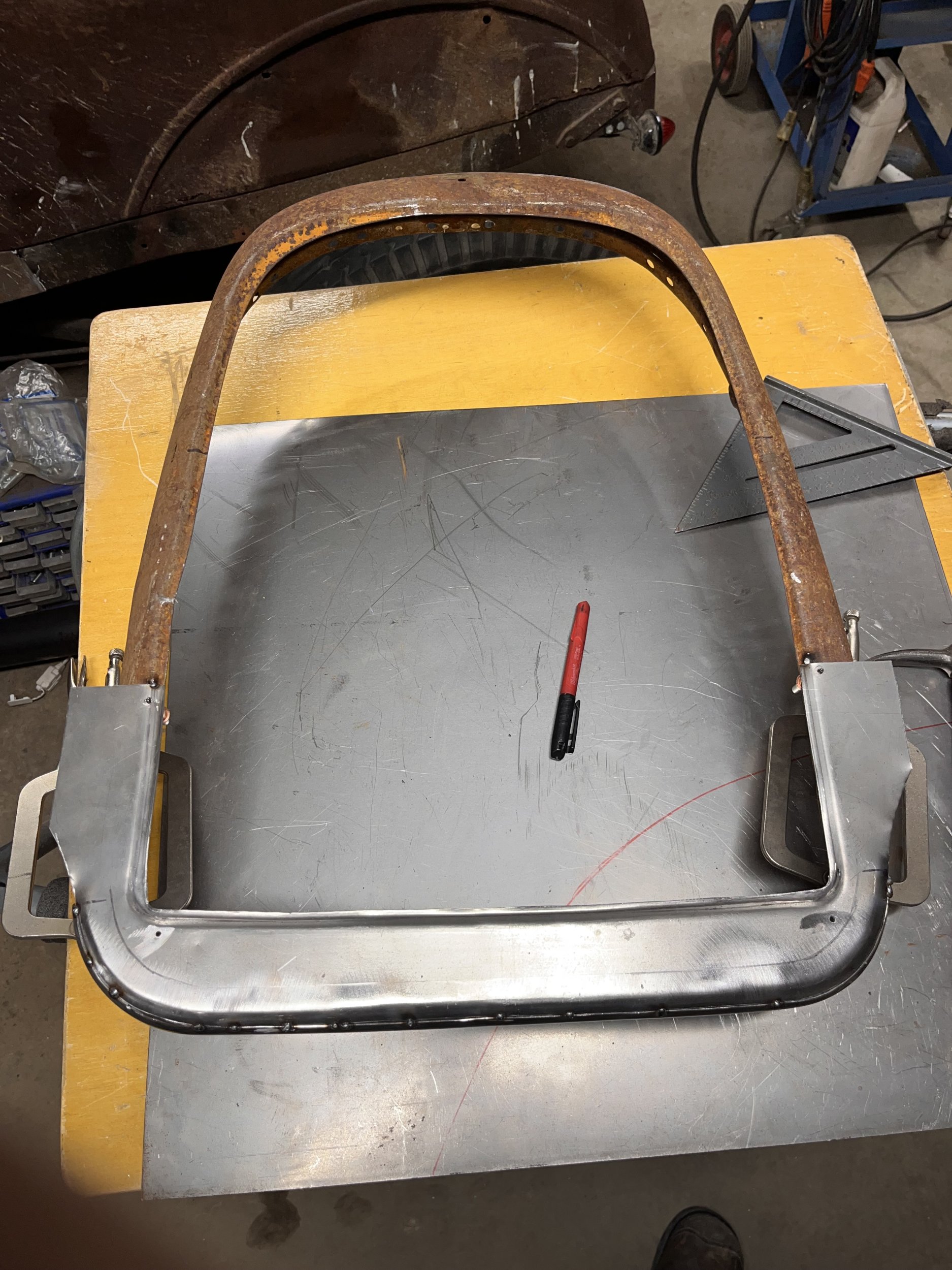

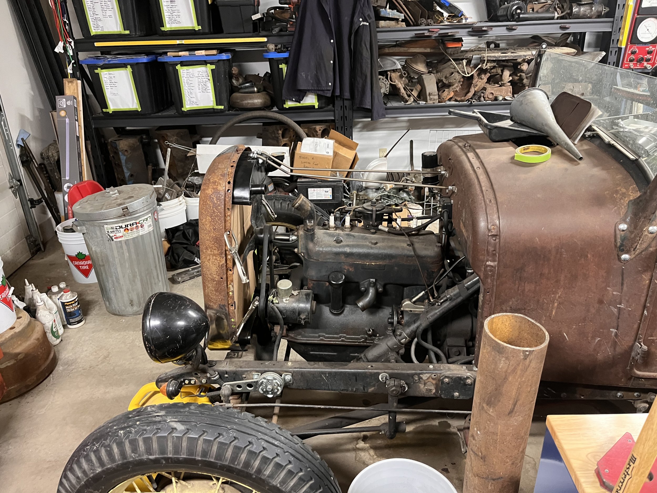

    IMG_7139.jpeg IMG_7158.jpeg IMG_7142.jpeg IMG_7140.jpeg IMG_7138.jpeg I thought I’d share some updates on the model T. I got the V8 swap finished in summer of last year. It’s been nice driving it around with the V8. Attended a few shows etc. I’ll post some more of the build pics from last year though.
    So in a swap meet a few years ago I found the remains of a Willy’s Whippet radiator surround that I wanted to use. It was quite manglers and the bottom section of the surround was missing. I visited Dons Radiator in Lethbridge who had built some Willy’s radiators. I was able to get some measurements off one of his radiators and surrounds and asked him to build a radiator for the car. I then rebuilt the bottom section of the surround to fit the new radiator
