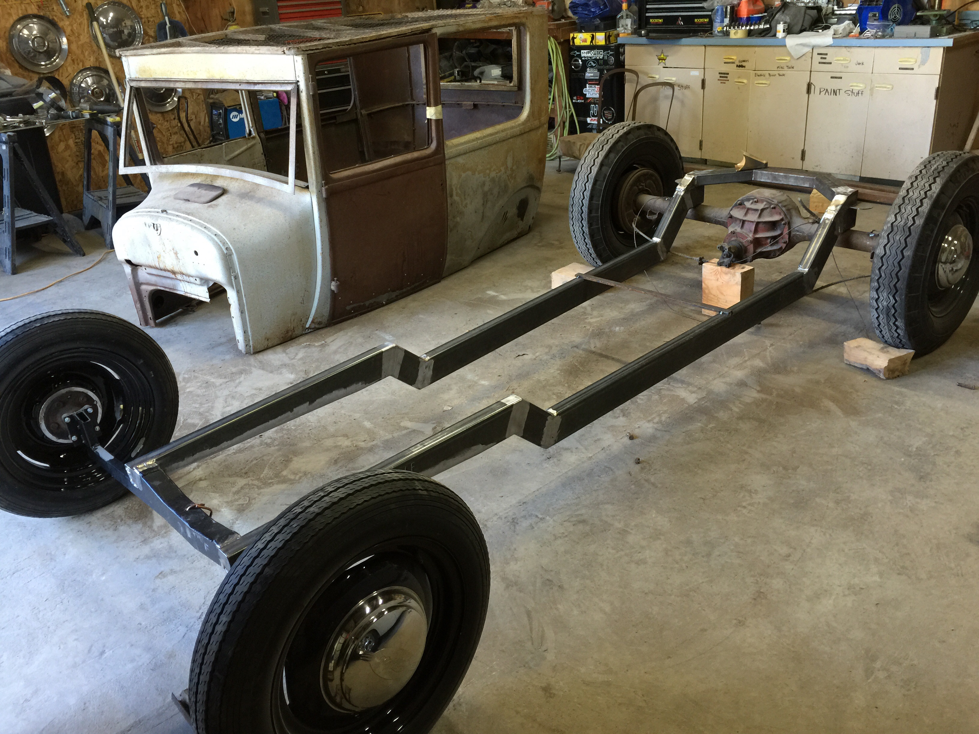

    Hey everyone 2 weeks ago I bought me a very nice model t tudor sedan. I almost didn't want to chop it all up but I don't care for them in stock trim. Sorry. Anyways I started off deciding how I wanted to build my frame. Got that all figured out and worked on it after work for 5 days and got the perimeter all welded up and the body on it. This week I waited for parts and when they showed up I got the front end under it. Need new wheels in the front because the adapters make them stick out too far and look dumb. I have never done a car like this before and I'm having lots of fun! Getting my Chevy 350 and 2 speed powerglide next week so I can start finalizing all of my suspension. image.jpg image.jpg

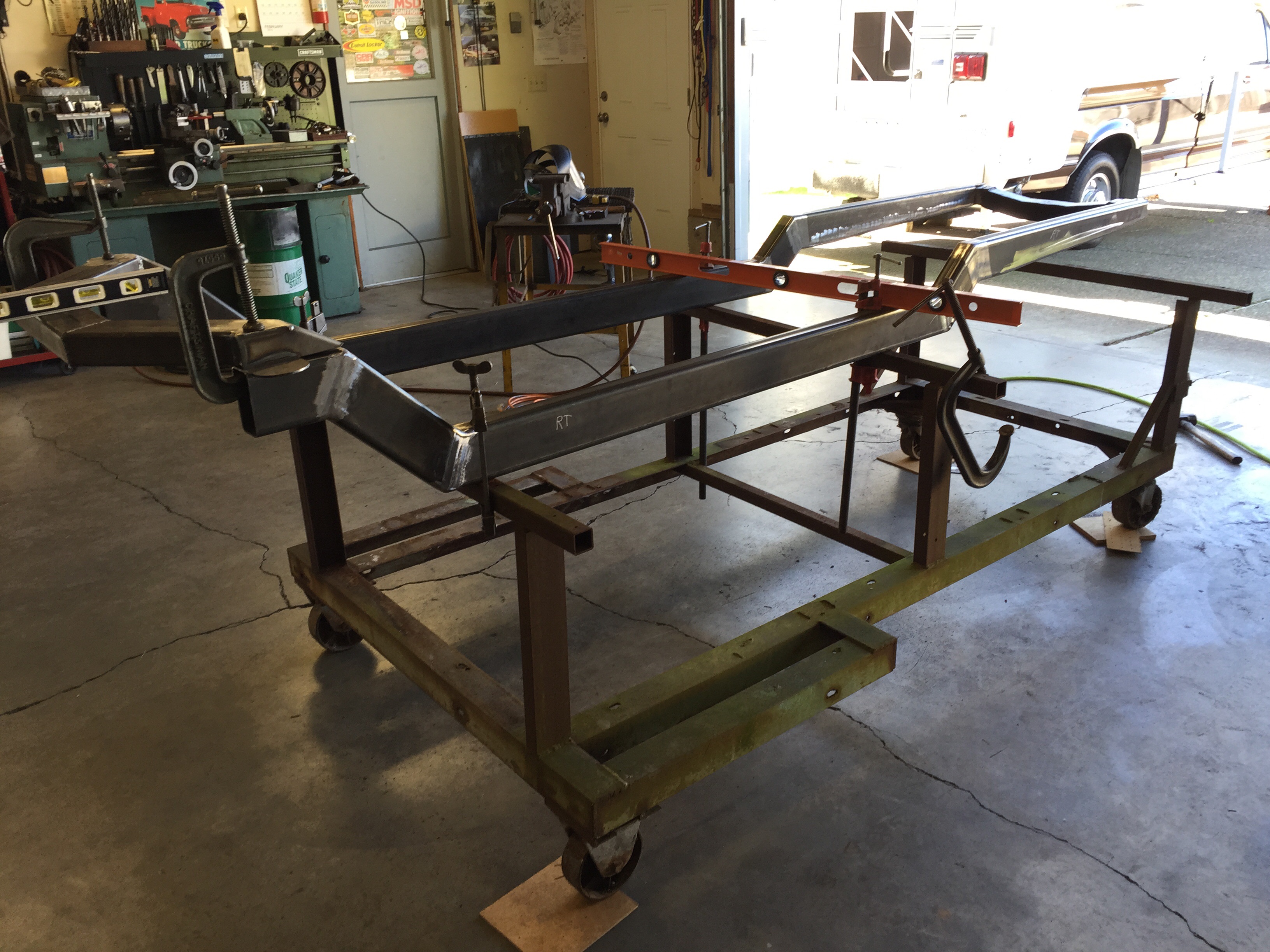

    image.jpg image.jpg Frame is all internally gusseted also

    image.jpg So what are all the channeled guys doing for a brake and gas pedal setup. Not a lot of room for both. The engine and trans needs to go up still but My subframe is in the way of the trans and I don't feel like fixing that tonight. Pretty tight in there. I was thinking about just moving the toe board back a few inches and moving the seats back further.

    Yeah,I have saw lots of cars run it this way and they are still driving around... Also nothing suspension wise is finalized at all hence the big vice grip holding the brackets. The rear end is tack welded in on 3" solid blocks so of course that's not the right way. I honestly looked and I don't see any reason not to run it the way I have it with a panhardbar bar.
