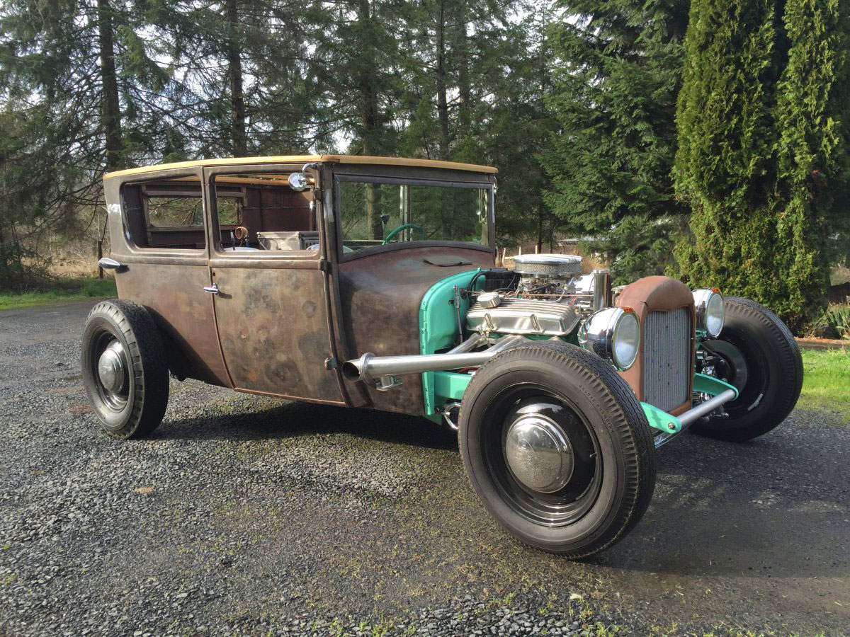

    Here's my radiator redemption... Although I was thinking about mounting it on 2" blocks. image.jpeg image.jpeg image.jpeg image.jpeg

    DUSTAN !!!!! GOSH DAMMIT !!!!!
    THE TAPE GOES FROM THE COWL TO THE HIGHEST LEVEL OF THE GRILLE SHELL,
    YOUR GONNA FU-K UP AGAIN, IF YOU DO IT THE WAY IT SHOWS, NOW GET IT CORRECT THIS TIME. and raise the body of that T about 3 inches between frame and body..
    And drop the mount for the wishbone down Under the frame, so it is somewhat parallel with ground, like the other kids cars.>>>>
    damn, buy ya books send ya to school, and ya still learnin'
    Blue One likes this.

    I like them in the frame better. They looked stupid under. And that picture the shell was just sitting there on top of the radiator so the tape was there to hold the radiator strait.

    Thanks a lot and that's sweet photochop wish I could do that. Looks much better but at this point the radiator is where it's going to be. Originally I was going to take 3" out of the header and only 2" out of the shield. It does look much better that way,I should have done that. But I do plan to chop up a model A visor and put that on so you won't see the header anyways. Thanks for the kind words ;)

    image.jpeg image.jpeg Cut up a model A visor and put it on. I like how it hides most of that header.

    I want to see one of you know it alls come over and do something with that radiator that doesn't **** up a already painted ch***is... Sure I could make brackets to drop it in front of the crossmember but then it sits way too far away from the engine and looks just as ridiculous. And where does that put my bottom radiator hose? Between the spring and axel that's where.

    ( I guess you would call me a know it all,) As far as costs for a different radiator, you can use your talent to produce $$$$$$.
    Have you ever noticed the radiator on Grabowski's Model T. "the Kookie Car?"
    It is half the height of yours,
    but, you have takin' yer stand, and now feel the need to defend it, I have a very stubborn daughter exactly like that, doesn't mean I don't love her. It's just her way. and that's OK.

    Car already has cooling issues idk if a smaller radiator would be the answer. If I could buy one and it was guaranteed to cool enough then I would buy it in a heartbeat. I actually drive my cars though and don't need to be on the side of he road boiling over

    you say it has cooling problems, what size thermostat are you using? How many rows of tubes in the radiator, You said you bot radiator at a swap meet cheep, I bet last guy had problems also. Where did you get water pump? You might consider a marine small block water pump? Maybe water is going thru engine too fast and doesn't let it stay in Radiator long enuff to cool? Do you have a temp gauge, you worry over? Or does it puke.. If it sits there and idle, does it boil? Have you tried any cooling additives, like they use at NASCAR.?
    Do both heads get hot? Or just one? Use a heat sensor gun and find hot spot (s). Check compression with all spark plugs out, big differences?

    Thanks,I don't remember what t stat is in it right now but I have tried like 3. Radiator was brand new but I bought it at the swapmeet from a vendor,waterpump is just a short pump from the parts store,i do have a gauge,I have used a temp gun because I thought the gauge was lying. It wasn't lying. Compression was great. What would be the benefits of a marine pump? Never knew there was a different one. I havent really tried additives but I messed with timing and a bunch of other things like built a shroud and I have it where I can drive it and not worry too much unless it's a really hot day and I get stuck for a while. But yes it will puke.

    tomorrow pick up 210 degree at work, and put it in and, put some tape over temp gauge, and drive.
    And don't be to quick to get a 3 tube radiator, if the tubes are not staggered it can cause heating problems..
