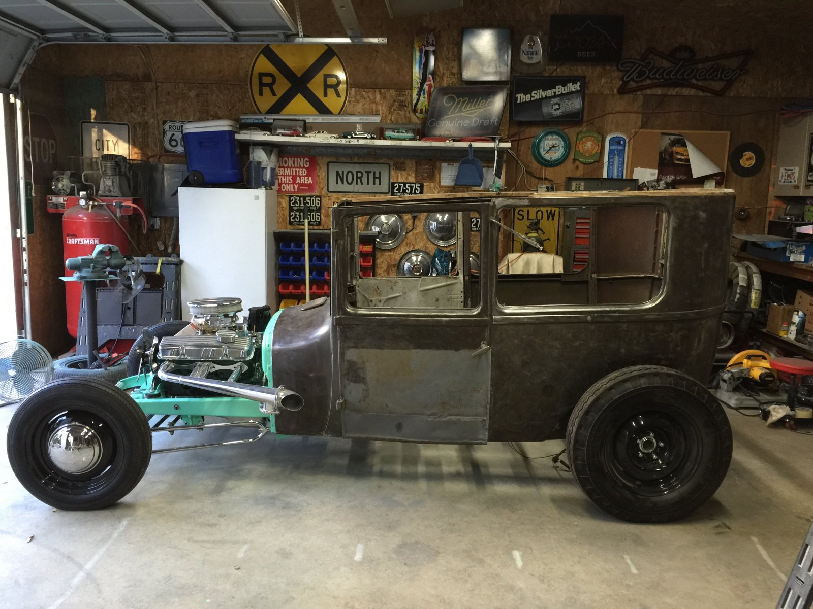

    So how much did you actually chop this tudor? You said you were planning 4 inches, but I didn't know if that's what you did. The car has great proportions.
  23. Dustan
    Joined: Oct 19, 2014
    Posts: 262
    Dustan
    from PNW
    I took 4.75 out of this T and I took 3.75 out of the A Tudor we are building now.
