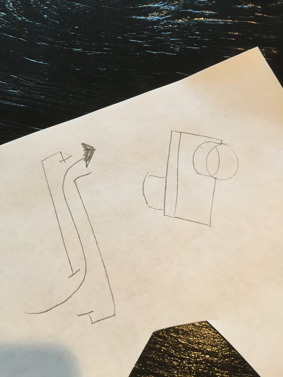

    image.jpeg Crude drawing of a riser. I've seen them machined, one piece, two piece, welded. Doesn't seem to matter how it's made.
    On the rad being tall you could always just tell people it's set up to race hill climb events ;)

    I might look into making something like this if I keep the car long enough. The fan is low on the radiator so that sure doesn't help. I appreciate your thoughts.
