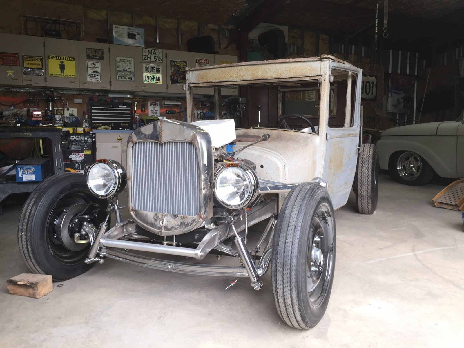

    Worked on the radiator shell for a while tonight. Sectioned and pie cut everywhere and I'm still not really satisfied with it. I might buy another and start over. image.jpg

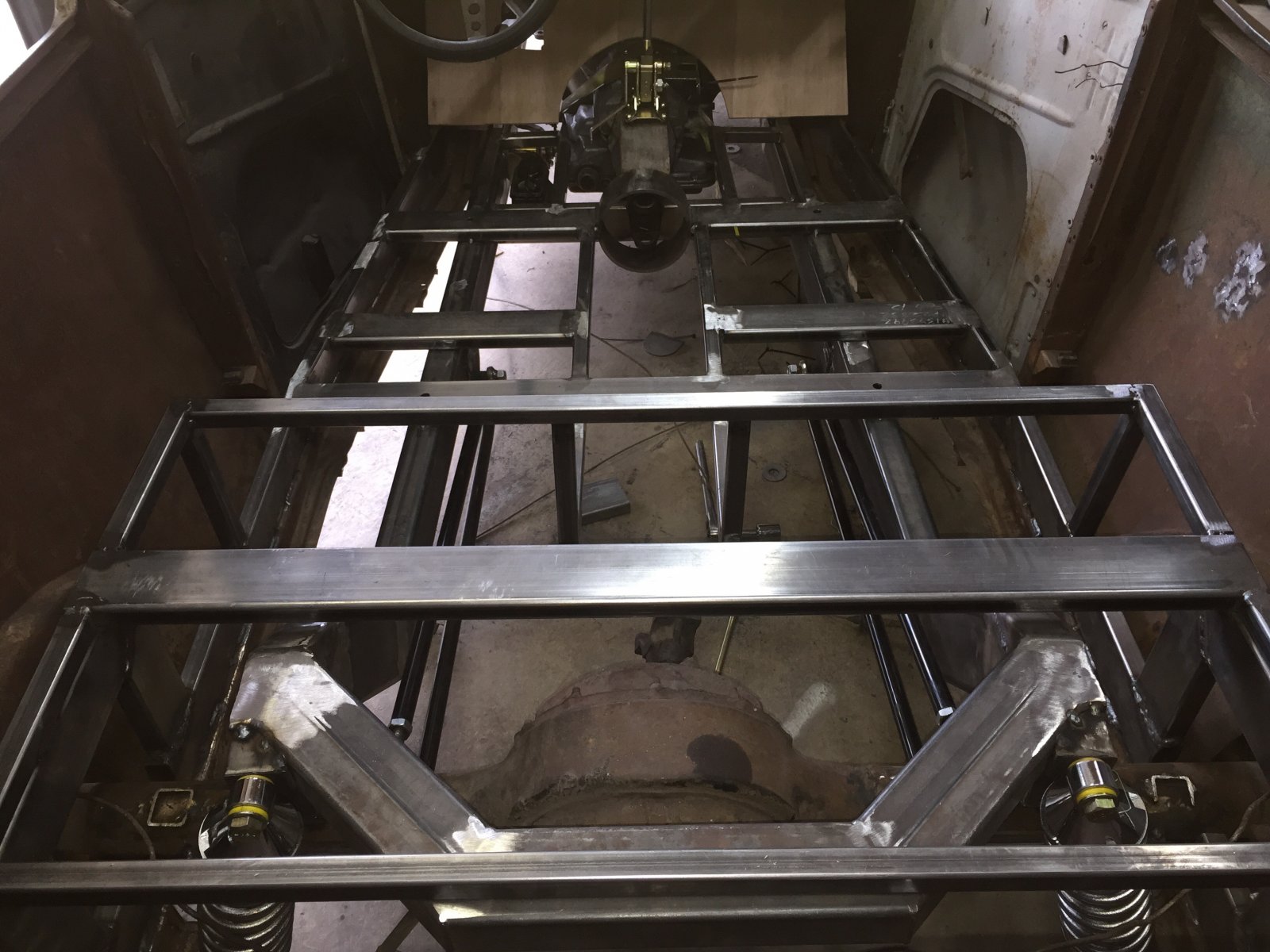

    Started doing my floor bracing image.jpg image.jpg image.jpg image.jpg image.jpg image.jpg

  13. Dustan
    Joined: Oct 19, 2014
    Posts: 262
    Dustan
    from PNW
    Finally sitting on the springs all the way around. About all of the floor supports are done too. image.jpg image.jpg image.jpg image.jpg
  14. earlymopar
    Joined: Feb 26, 2007
    Posts: 1,789
    earlymopar
    You're doing a fine job of fabrication and you're one heck of a lot faster than me! The one thing I see that strikes me as out of place (literally), is the grill shell. I've never cared much for chopped or sectioned shells on anything because it changes the proportions too much. Yours is also mounted higher than normal (or at least appears to be) which really conflicts with the body being channeled and much lower than the shell.

  15. Dustan
    Posts: 262
    Dustan
    from PNW
    Thank you and I am a body technician by trade so that contributes to being a little faster I think. But still I have never done a car like this yet. But I'm only 25 so I have many more to build in the future and they will only get better. I don't like th grille shell that high either but I honestly don't know what else to do with it... I would like to lower it but I don't want the bottom hose between the spring and axel. Next time I make one i will do spring behind and not z the front of the frame 4". That is what is messing me all up proportion wise.

  17. Dick Stevens
    Joined: Aug 7, 2012
    Posts: 4,127
    Dick Stevens
    Time to figure out how you are going to handle getting the grille shell much lower, it needs to be no higher than the cowl or it will not look good. Do your research now while it easier to make it happen. You will regret it if you ignore it until later.

  19. Dick Stevens
    Joined: Aug 7, 2012
    Posts: 4,127
    Dick Stevens
    You do have some choices to make, 3 possibilities are, you could opt to not channel it as much, redo the frame, or look into doing something different with the radiator. Now it is up to you what you choose to do, it is easier and cheaper to make changes early in the build than later.
  20. Blue One
    Joined: Feb 6, 2010
    Posts: 11,512
    Blue One
    from Alberta
    I agree. that radiator looks really funny sitting way up there like that.
  21. verde742
    Joined: Aug 11, 2010
    Posts: 6,588
    verde742
    with THAT grille/radiator that high, I am outta here,, maybe check back later.....
    just kills it... IMO

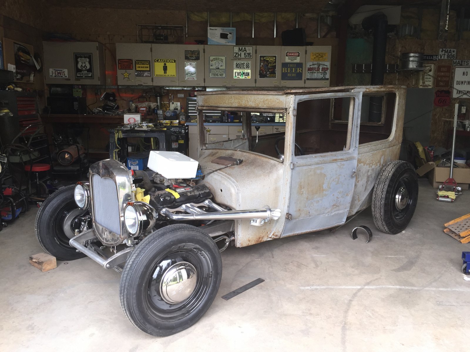

  22. Dustan
    Posts: 262
    Dustan
    from PNW
    This is really the only option and I don't really want the hose between the spring and axel... But it does look better for sure. image.jpg image.jpg
  23. Mr. Mac
    Joined: May 16, 2005
    Posts: 1,972
    Mr. Mac
    Un channel the body some and you might solve your problem. Just sayin
  24. Dustan
    Posts: 262
    Dustan
    from PNW
    Body is only 4" and the problem is the frame has a 4" z also. The radiator is chopped but only like 4-5" not 8
  25. volvobrynk
    Joined: Jan 30, 2011
    Posts: 3,587
    volvobrynk
    from Denmark
    I know this sound stupid, but if you un-section the cowl, i know it ain't sectioned. But please try to follow my though for a moment, sleep on it as then forget it if you don't like it.
    The firewall is very small, and the cowl makes a
    M***ive drop, that makes the engine look giant, and the grill look big and tall. And if you channel the car it gets worth.
    But if you modify the cowl, cuts it in half and lift it a couple of inches, and do a 28-29 style top on it.
    Maybe post some pictures of it on the "to end all photoshop" thread, you might get some Ideas of how it looks?
    Because the model a grill looks almost taller then a stock model t cowl, and it takes a lot of butchering to get them to line up.
    Just a thought. Or just my two cents.
  26. Dustan
    Posts: 262
    Dustan
    from PNW
    Yeah I will figure something out. I do want to get the other style grille shell. That will help a bit. If I end up putting the rad out front I honestly don't ever see the axel coming up high enough to hit the neck. But idk.
  27. Blue One
    Joined: Feb 6, 2010
    Posts: 11,512
    Blue One
    from Alberta
    What it comes down to is that the body is channelled way too low.
    When you consider that the distributor sits up taller than the cowl, it starts looking ridiculous and leads to problems you are experiencing like the rad issue.
    Interior space will be less than desirable as well.
  28. manyolcars
    Joined: Mar 30, 2001
    Posts: 9,609
    manyolcars
    Blue one is exactly correct. Bringing the body up to traditional levels will look better, the radiator will look better and the rear tires can fit the wheel well properly. I admire your work, skills, ability and your eagerness. If you are building to sell, build to fit a wider audience, not so extreme.
  29. brad2v
    Joined: Jun 29, 2009
    Posts: 1,658
    brad2v
    The above advice is good. You should take it. You have excellent skills, unchanneling it some would not be a huge undertaking for you. Plus, it would go a long way toward improving it's proportions, in addition to allowing a potential buyer to actually fit in and drive it.
  30. Dustan
    Posts: 262
