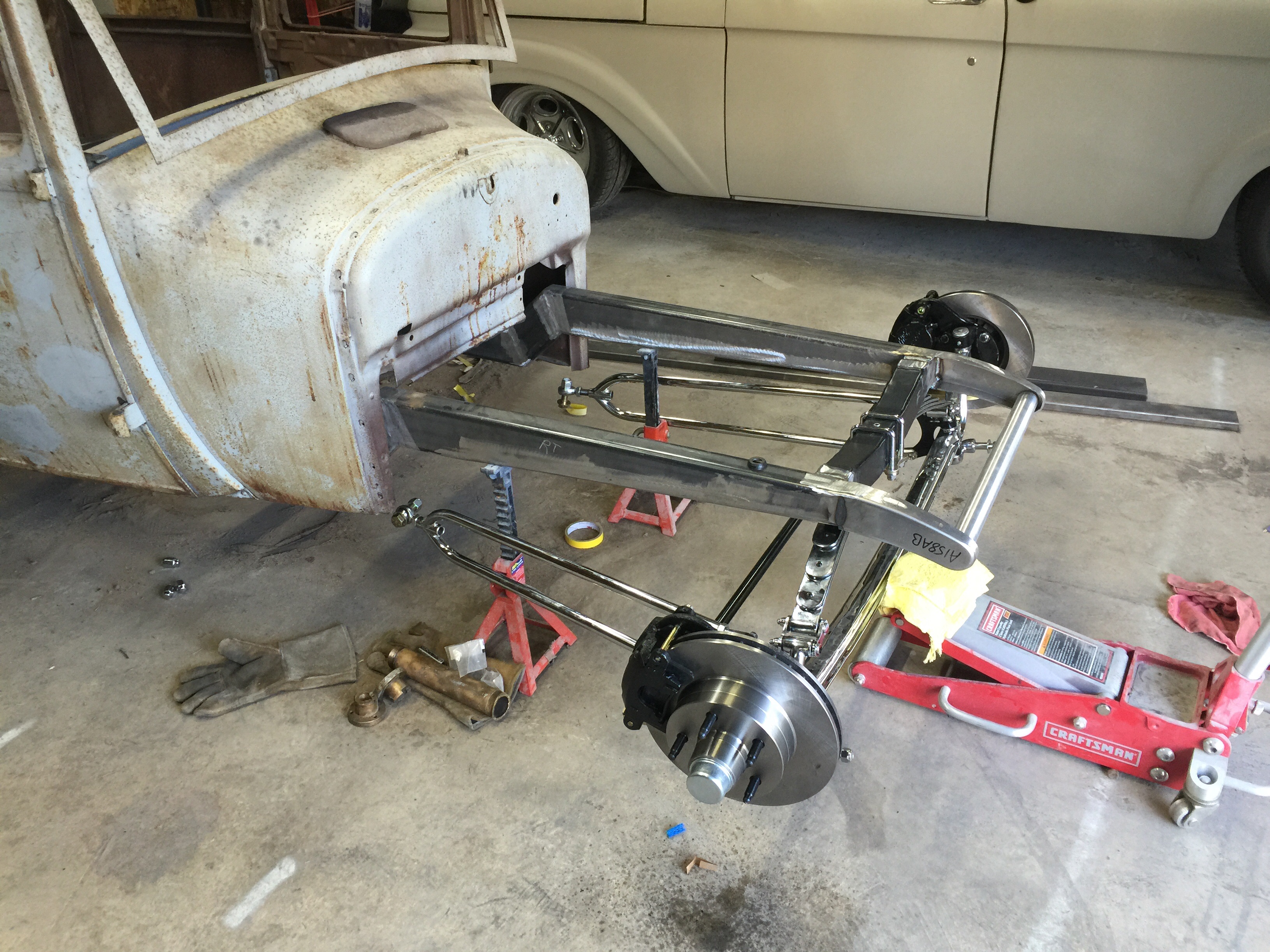

    Got some stuff done. image.jpg image.jpg image.jpg image.jpg image.jpg image.jpg

    beautiful work, stay on the course..
    tho it
    needs second leaf removed in the front and main leaf flipped over
    or maybe shorter reversed eye spring.

    Thank you. Problem is when you remove a leaf on the chrome stuff it looks terrible because they put the spring together then chrome it. So when you pull it a part that isn't chrome shows.

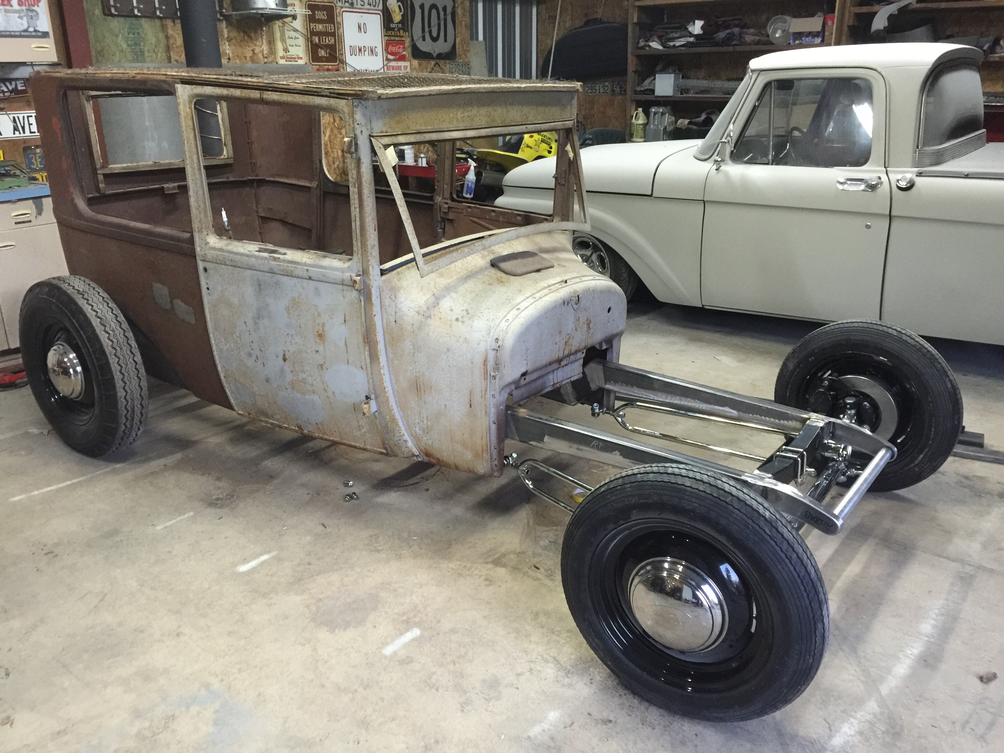

    Got the steering all buttoned up. Made baffles today. Hope to get fuel lines and wiring finished by the end I of the month. Girlfriend likes it. image.jpg image.jpg image.jpg

    TOO bad about the height of radiator,, Who made it?

    Didn't go to woodland today. Just worked on the car a little. Idk who made it I bought it at the swapmeet in Portland this year. It was the smallest I could find. If I keep it long enough I'm going to look into getting one chopped a few more inches.

    That radiator is BEAUTIFUL, But for wrong application.

    It's raised on 2" blocks right now. Is channeled about 3" now. It shows about 1" of frame along the body

    Dustin, Take off air cleaner, take out distributor. Put a carpenter level on radiator, look at level, measure down to cowl, and report what it measures..
    IMO, radiator should be about 1 inch below cowl... But you decide.. and we will critique...
    Ready, GO.......
    .p.s. in the picture, it appears, at cowl, body is well below bottom of frame...

    It appears lower because it has a 4" z tucked right behind the toe board. I would say it's channeled 3" on top of that.

    yes I am aware you "stepped" frame..
    and I like how you did it..At the "toe board" the only way IMO...
