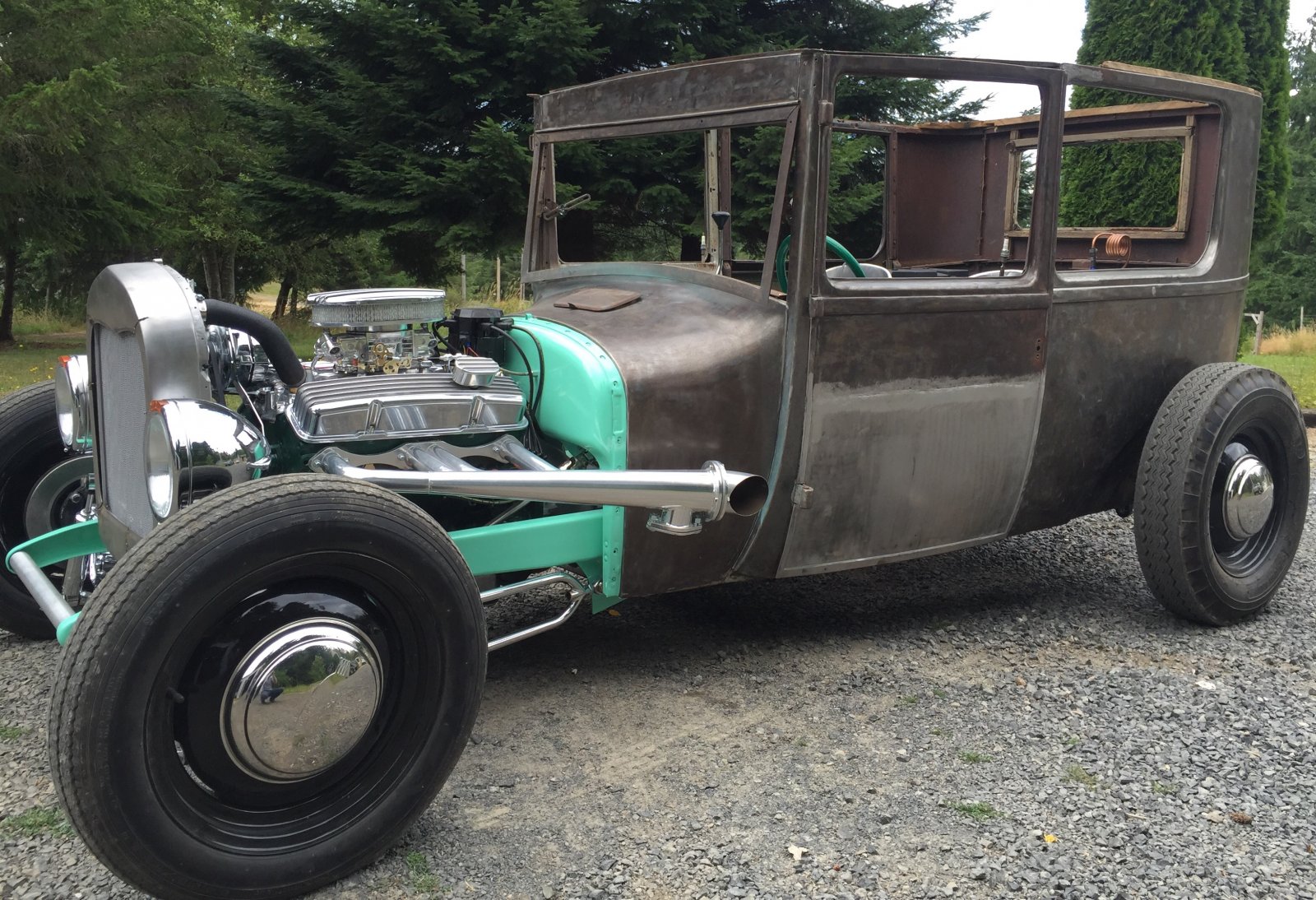

    Dustan I think you may have front end problems because of what appears to be a flat crossmember, you need to have at least 7 degrees on the cross member for proper axel caster, you've got to lay those king pins back for the car to handle right.. I read that you don't want to cut it, the crossmember, so you could buy adjustable spring pearches, then you can add caster as needed...Good Luck..
  6. Dustan
    Joined: Oct 19, 2014
    Posts: 262
    Dustan
    from PNW
    Thanks but it is welded in at 7 degrees

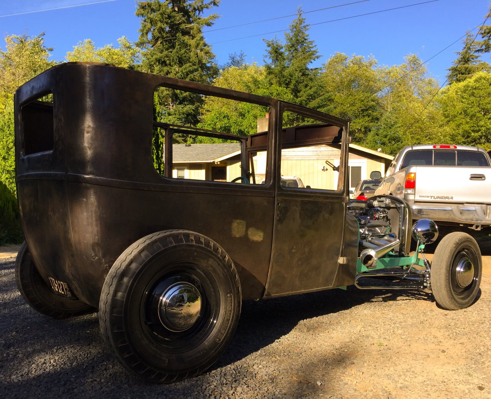

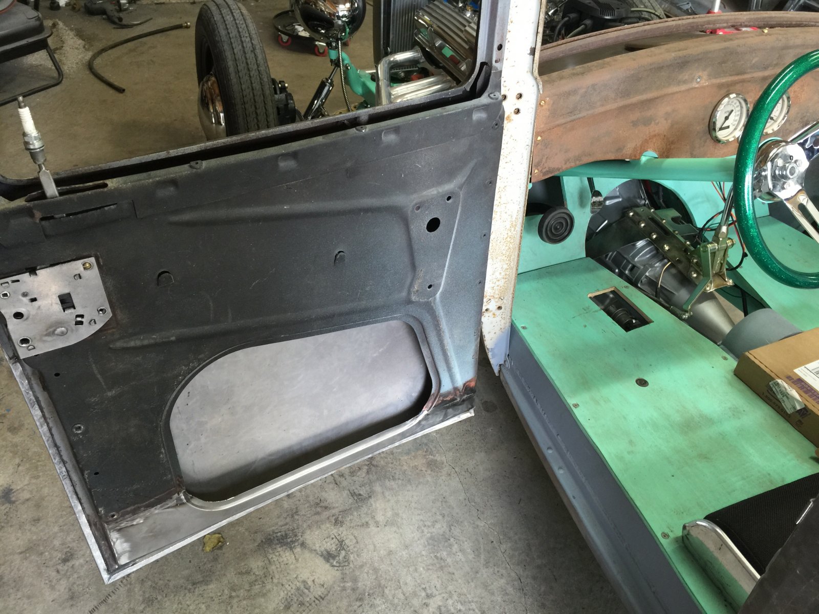

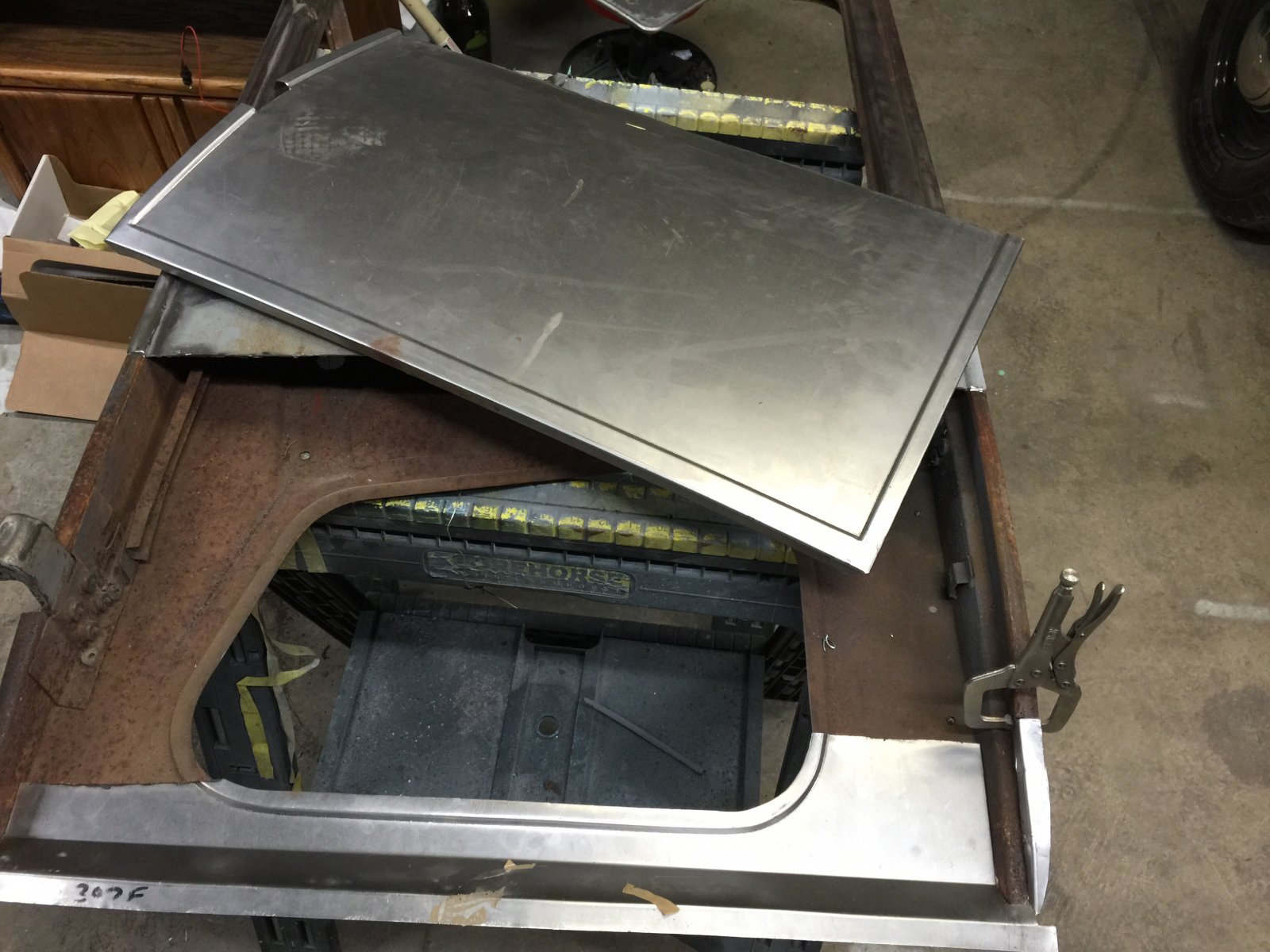

    volvobrynk likes this.

  19. Nice work on the door Dustan! Wish I had some of your welding skills

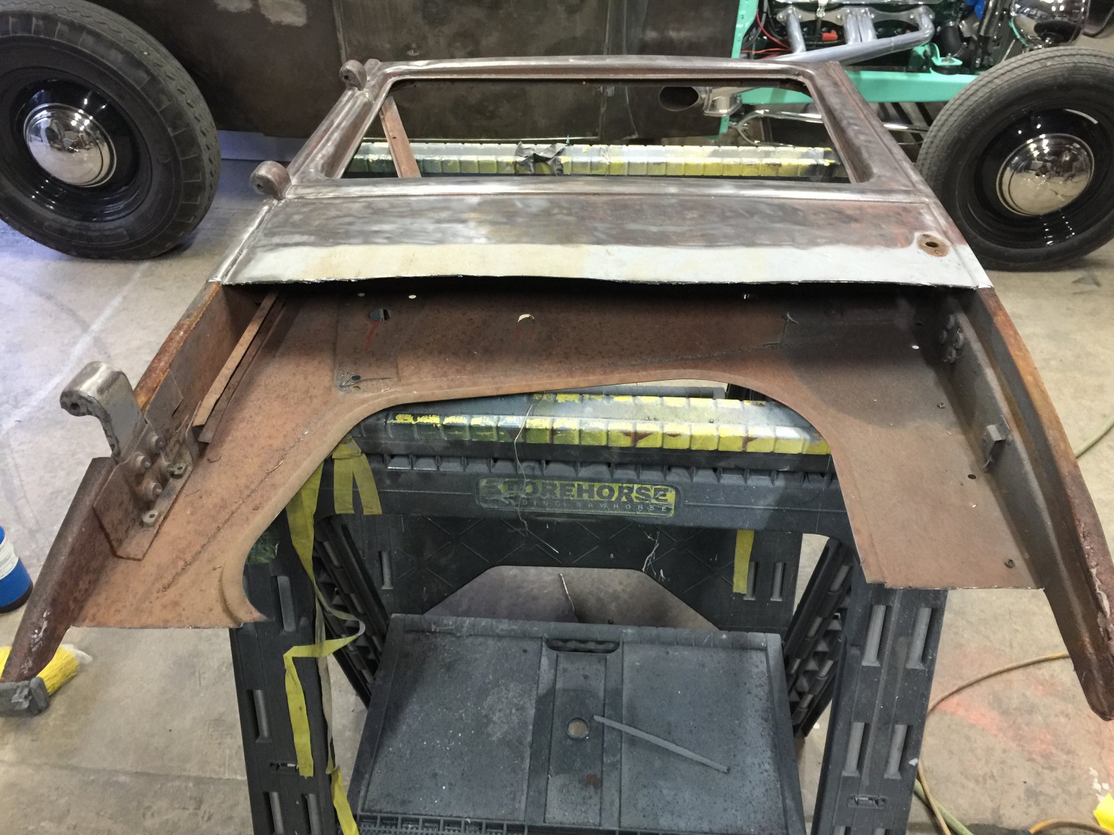

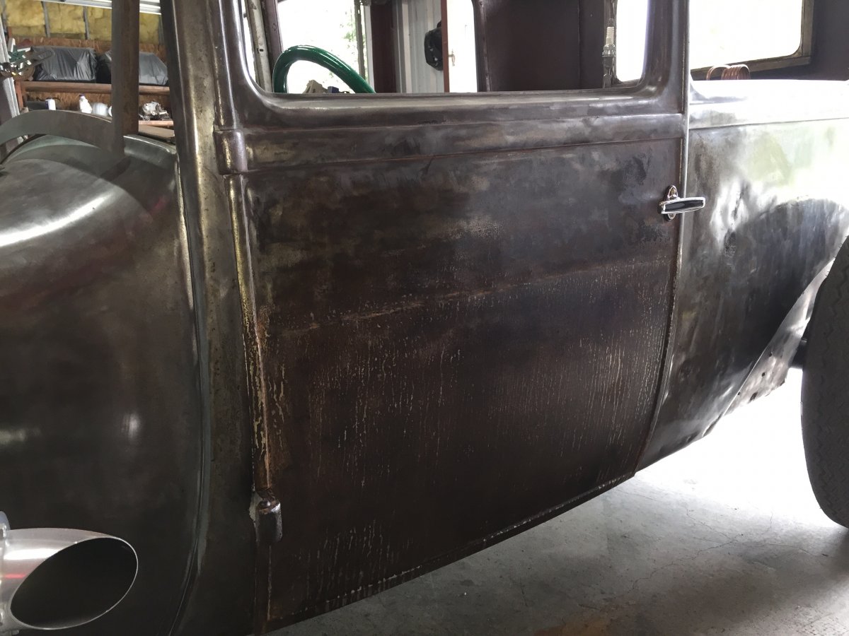

    Got my new door skin looking nice and crappy :) image.jpg
  23. verde742
    Joined: Aug 11, 2010
    Posts: 6,565
    verde742
    yepper !! matches...

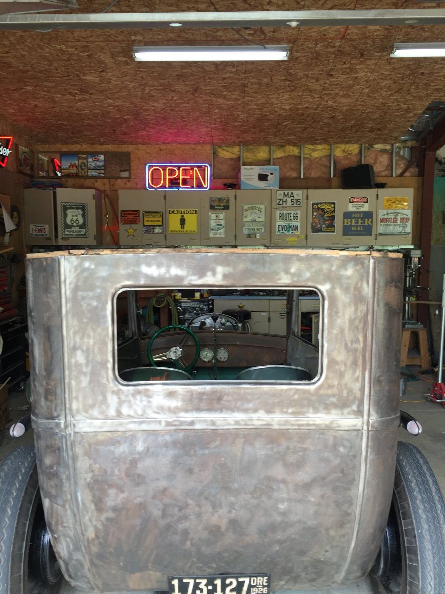

    Got my tail lights/turn signals installed. Got them when I was going through some of my grandpas stuff. I'm pretty sure they are fender lights off of either his 1938-1939 Chevy. They worked out well. image.jpg image.jpg

    My first thought on the lights, I don't like them but totally understand you wanting to use them if they came out of your grandpa's stash, so I will reserve judgment until I can get used to them. Just my .02 and please don't take offense, I am trying to not be too critical and voicing my thoughts, for what they are worth. :rolleyes:

    Yeah at first I was like they will look really cool but after I put them on I was like meh...haha too late now but I'm sure he would be happy I used em for something.

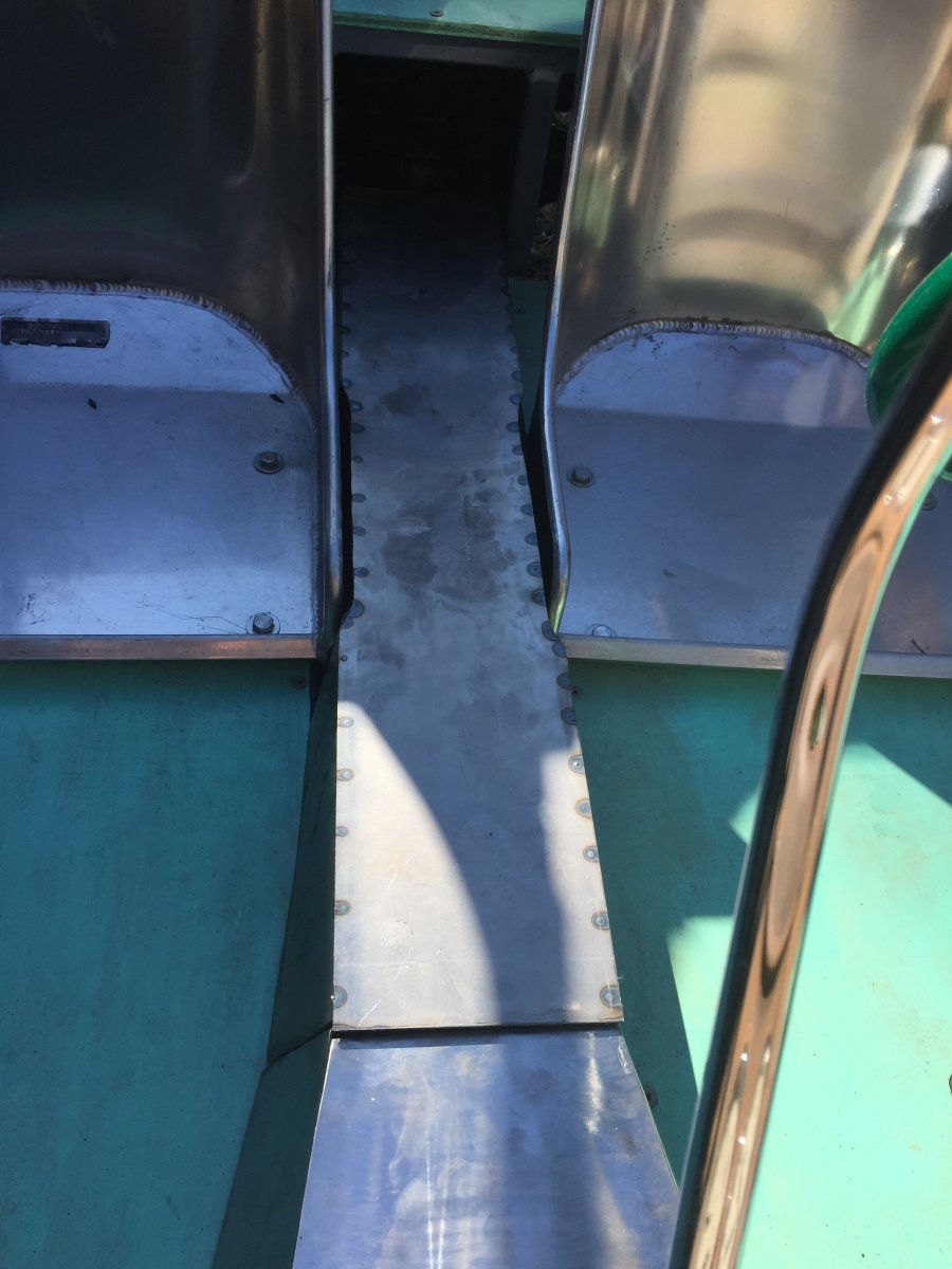

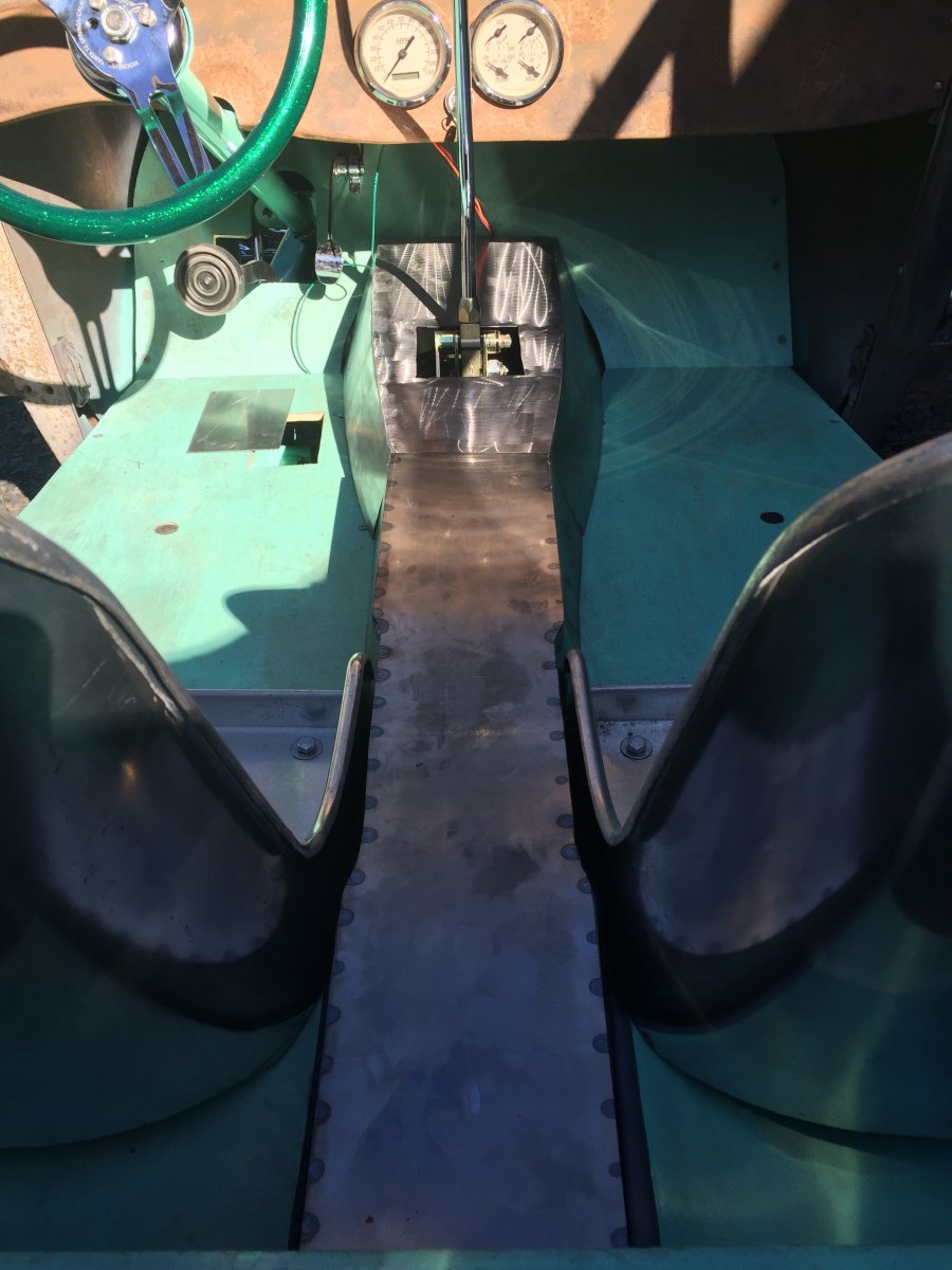

    image.jpg Started my transmission and driveline tunnel tonight. Need to make mounting flanges around it and maybe some type of upholder and consol. image.jpg image.jpg
  28. Dick Stevens
    Joined: Aug 7, 2012
    Posts: 4,048
    Dick Stevens
    Cupholder? It's supposed to be a hot rod not a cruiser! :eek::rolleyes:
    Dustan likes this.
