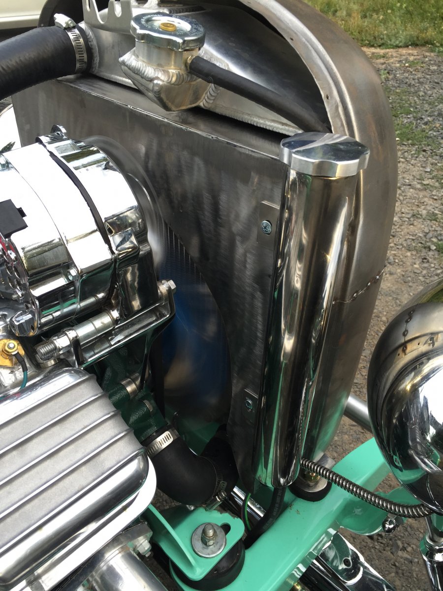

    Put about 160 miles on the T. Have been working out all of the little bugs. Main problem has been heating up while driving slow. Took out the 180 t stat and put in a 160. Built this shroud tonight. Seems to work pretty good now. I will have to drive it some more and see.having fun with it now but I have a lot left to do still. image.jpg

    Fenders, no fenders, it all looks good. An electric fan cured my slow speed cruise issues

    by putting in 160 degree thermostat, the water is going be in radiator LESS time.
    You want it to be in Radiator LONGER, so the breeze can cool it. IMO
