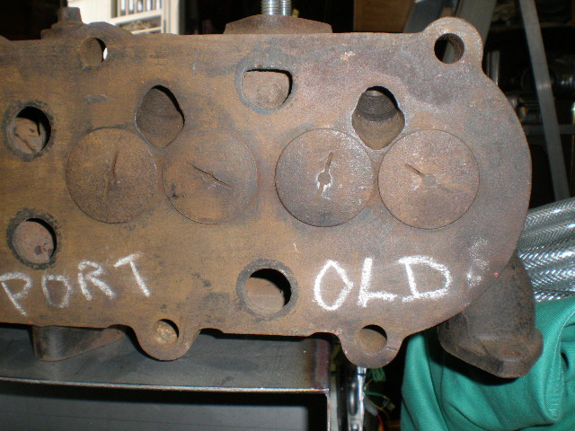

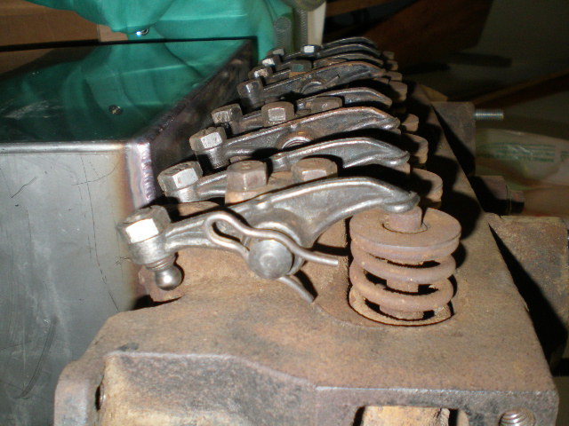

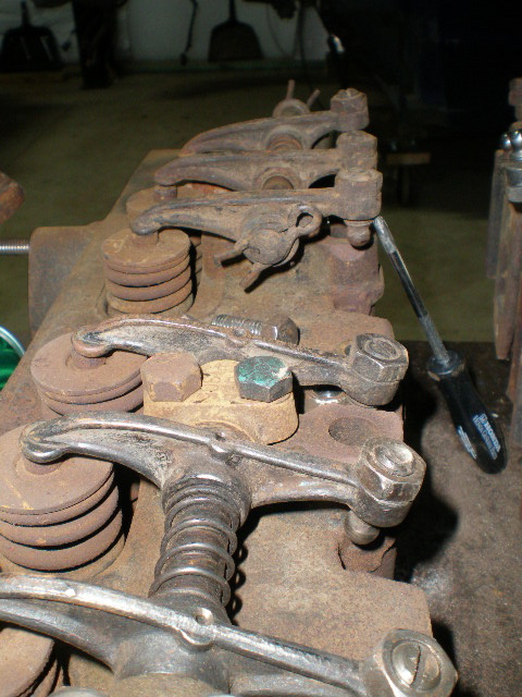

    I'm going to try posting my first pictures. Wish me luck. I purchased a three port head a short time ago. It turns out it's not exactly a virgin. It was off a racer at some point. The valves are way big and longer than stock. Stems are oversize too. Big springs and a long notch for the keeper. A set of 50/50 rockers were included, but I don't know if they were ever used with this head. The push rod hole in the head was butchered with a grinder. It may have been done to make clearance for the rocker adjustment nuts. In their stock location the 50/50 rocker assemblies would have to operate at a rather severe angle. I took an extra top cap and placed it under the shaft. This made the rocker angle ok but longer pushrods will be needed. Someone earlier in this thread suggested milling the stands down to the head surface. My thought is to just a light cut to true the surface. Make new stands out of 1.20 in. thick aluminum and use the head bolt and one rocker stand bolt to mount it to the head. The rocker shaft could then be located for the '28 rockers (or others) and the longer stem valves and a more standard spring could be used. The stands could be drilled for pressure oiling, etc. etc.
    The pictures I'm going to attempt attach show most of what I'm trying to do. Any imput to improve on this idea are welcome.

    I'm the one that you refer to, about milling th rocker stands off. You are correct about the rocker angle in your photos- at the midway point in the valve lift, the rocker should be at right angles to the valve stem. Using one of the rocker stand bolts and a head bolt to hold the new stand down is OK, and is what I have done, but I wouldn't use aluminum under a head bolt. Also, if you do it the way you described BE AWARE that the head bolts are 1/2-12 (12 threads per inch), whereas any coarse thread 1/2" bolts since the first world war are 1/2-13. Not likely that you will find 1/2-12 bolts that are longer--they will have to be made. More brilliant GM engineering! I would not put oil pressure to the rockers, you will never be able to seal up the top end enough to keep the oil in, and what leaks from the rockers will be lost--just to make a mess. I could say more brilliant engineering, but the oiling by felt pad over the rockers was common in that era, and believe it or not, works quite satisfactorily.
    One other comment- I have seen MANY '28 rockers that were severely bent just by over-reving a stock engine. Stock valve spring pressure is 40# seated, as I recall. With stiffer springs '28 rockers don't stand a chance--hence the search by Mac the Yankee, and others for better 1 1/2 to 1 rockers.

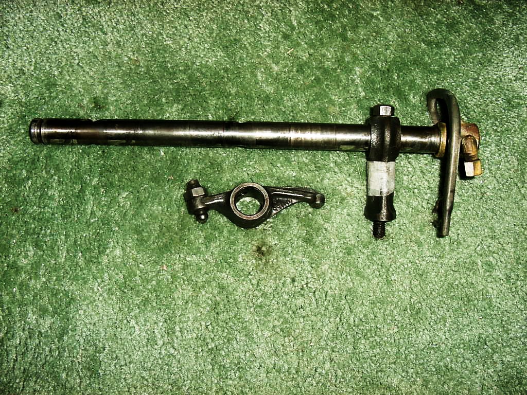

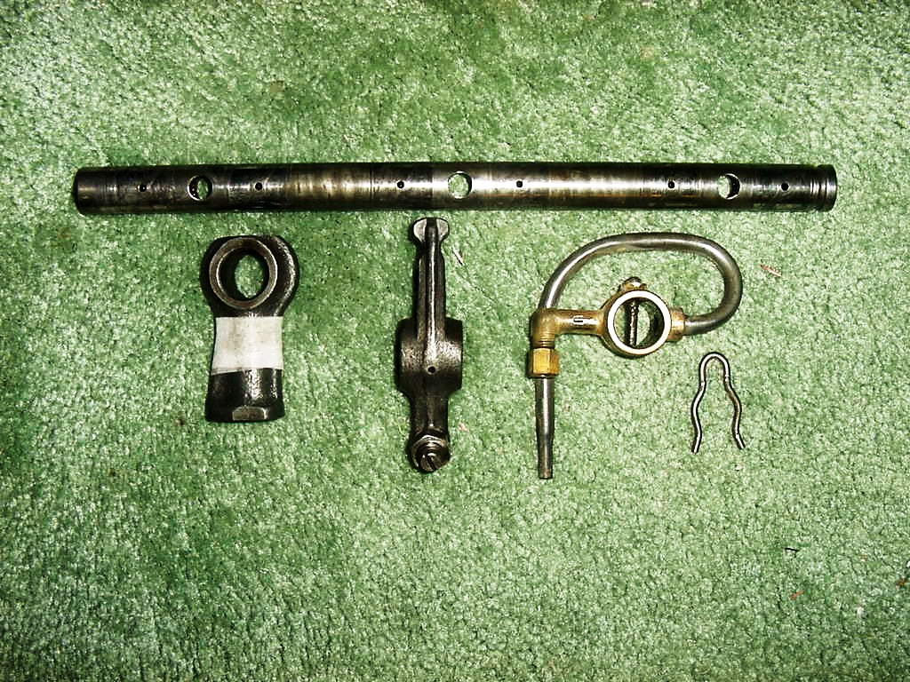

    Norsonauto,
    I suggested milling the stands down so that a Chevy 216 standoff could be installed.
    I am going to cut the bottom of the 216 standoff and use it to adapt to a shortened 216 rocker shaft.
    By milling the stands down to flat it will allow me to drill and tap a hole to bolt the extreemly shortened 216 standoff to the head.
    The advantages are great in using the 216 Chevy 6 rocker arm setup.
    The 216 rocker arm shaft is hollow allowing pressure oiling.
    This set up also has the advantage of the 1.5 to 1 rocker arms.
    The 216 comes with 6 more or less straight rocker arms, 3 right offset arms and 3 left offset arms.
    This means that it takes 2 216 rocker arm assemblies to get enough straight arms to provide the 8 that are needed. The springs, washers and oiler tubes can be judiciously adapted to work on either the Olds or the Chevy heads.
    Today I noticed that the existing holes in the 216 shaft don't line up with the Chevy rocker stands but 2 of the three are close enough that by milling them each a little closer together they will work. The 216 standoffs will cover the out of round holes and everything else is just a matter of aligning the rocker arms with the valve stems.
    The picture below shows the 216 standoff with tape at about the cut off point. This can be determined after the original stands have been milled flat and pushrods have been selected.
    In the second picture I show the shaft with the standoff in position and the oiler in the position that it would go in the 216 Chevy 6. It would have the other half of the complete 216 rocker arm assembly on the other side of the oiler tube.
    I will remove the pins from the oiler assemblies and install them in the middle of each rocker arm shaft using a set screw thru a hold drilled in the appropriate location on the shaft.
    :) :) :) Dick :) :) :)

    Herb- I was wondering if the shaft oiler from the 6 would be a help or a hinderance... any chance of making it work?

    No problem with getting oil to the rockers-- Just one h##l of a job to keep it from leaking out of the rockerbox by draining down the pushrod holes, and the irregular head to rocker box surface. And don't think for one minute that those tin covers over the pushrods on a '28 are going to do anything more than keep the local aardvarks out. They were specifically designed to allow dirt in and let oil out, I think.
