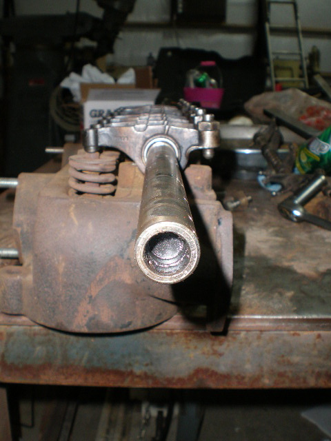

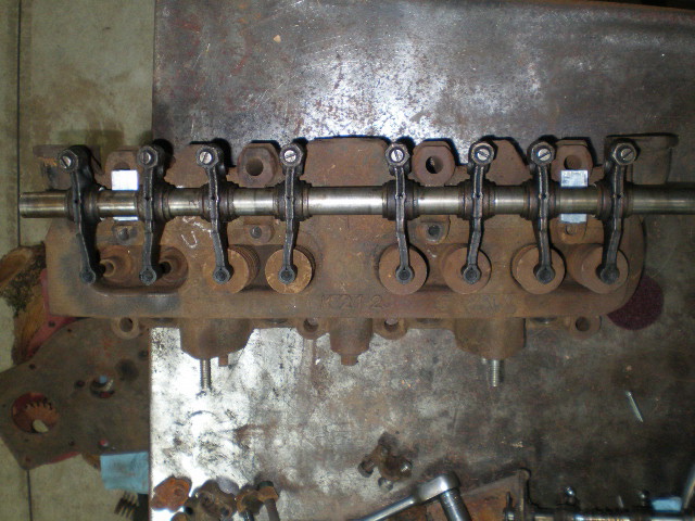

    There has been a lot talk about rocker arms for this motor. The Nash rockers are the ones that were used in the past, but they seem to be "out of stock". I chased down several of the "candidates" and I'm not sure I'm satisfied with anyone of them. The following pictures show the 28 Chev at the top, the GMC, and the 216 Chev last. I prefer the GMC because all of the rockers are right and left handed and align well on the head. You will notice that the ratio of the GMC and the 216 are not quite the same as the 28. I've checked Pugeot??, Slant six Dodge, Volvo, Luv pu, and any other thing with the head up. I finally found a Saturn 4 cyl. They are aluminum and have a roller shaft, but no adjustment. So if I can't find Nash rockers, I'll try the 28's until they bend and then the GMC's. I think Herb's approach is right, make them out of aluminum.
    The final two pictures are of the GMC rockers on a three port head.

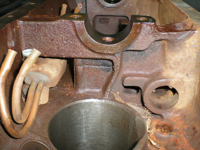

    There has been discussion on which block was the best choise for hop-up. It's been said that the years "26 thru '28 were weaker due to the holes made for the distributor. I have both and have been comparing them. I want to use the '28 so my judgement might be clouded, but I see a lot of reinforcement that was added when they made the change. I've included pictures of the center main of both blocks. Is there any history of the later block failing??
    The distributor/oil pump drive on the cam looks much weaker than the model A. I'm thinking of drive the pump off the front of the motor and only the distributor in the stock location.
  20. Norson,
    Which GMC engine did those come from?
    Walking around Charlotte this weekend with all those "barely used" roller rockers for sale made me think about making my own again. Just make new rockers to the correct length and use the parts off of the donors.
  21. NORSON
    Joined: Jan 19, 2009
    Posts: 469
    NORSON
    Mac the yankee
    Sorry, my head was on vacation. the rockers were '40s & 50s GMC. I think they must all be the same. The Old Parts Store must have had 40 sets still on the shafts and they all looked the same.
