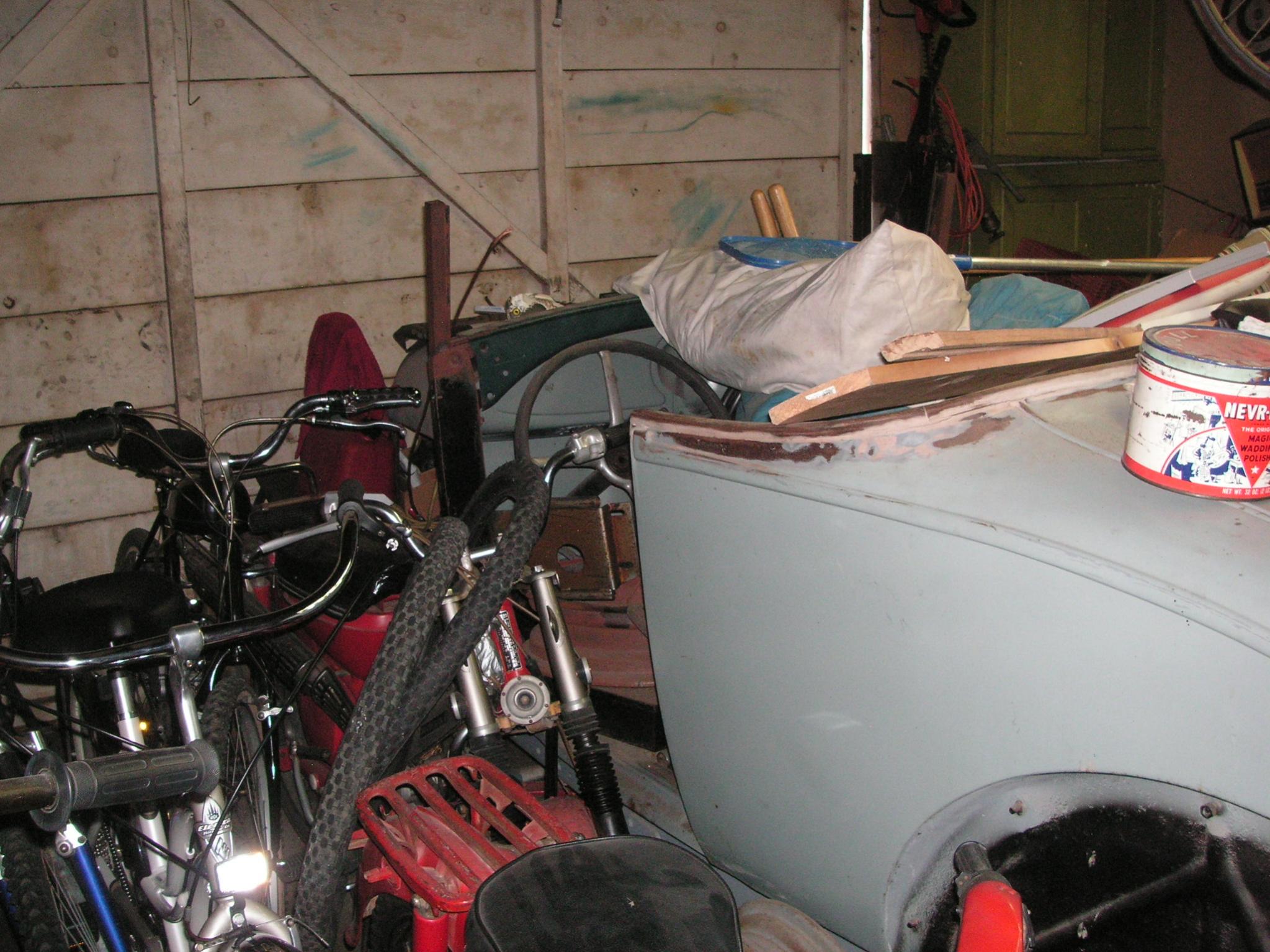

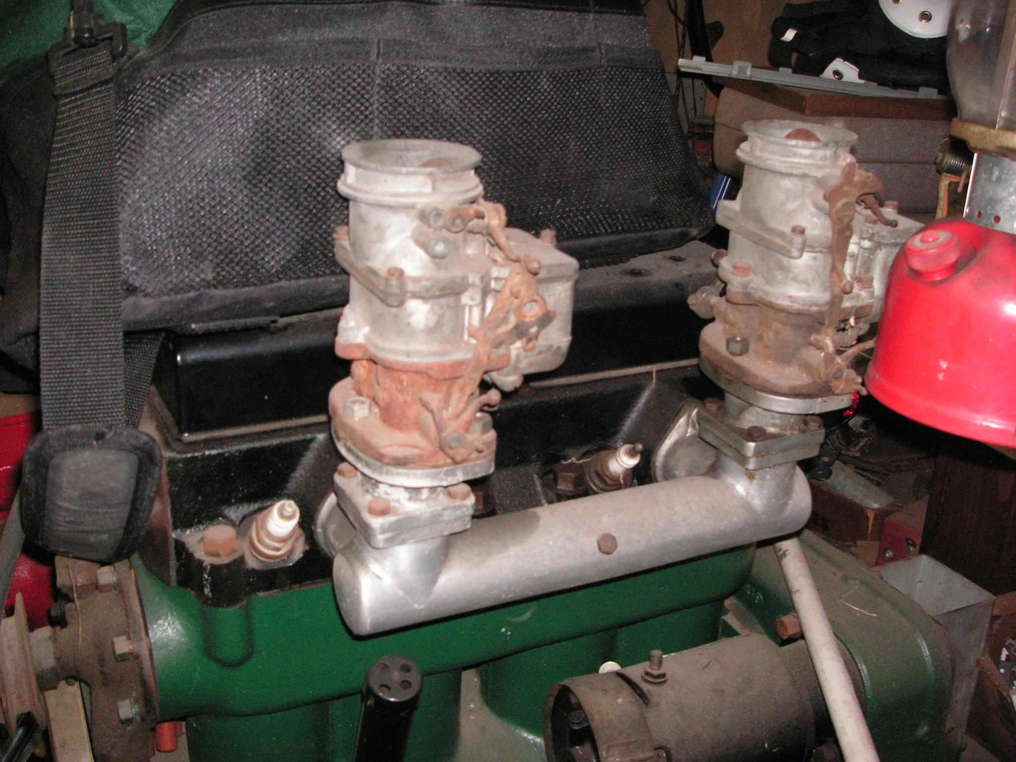

    This engine is buried in the garage in pieces. I have had a lifetime of trying to get it done, unfortunately I am at another hiccup. I have to admit the parts are all over the place and I need to get them together again. I will get pic's of the stuff I can find now. I think there would be some hear that would like the article about Rufi also. I need to find that also and figure a way to post it, lots of cool pic's of his car and the engine apart. Did you know he made the frame out of CONDUIT. Mine does not have the bridge mains, or the counterweight crank but it was balanced. Any way this is fun, and I always loved the sound of the Chevy 4's. I have lots of stock parts also. 3, 28 heads that I was told worked just as good as the Olds. I have 2, 25 engines and 2 27's. a complete 27 rolling chassis with the 29 Ford body on it, and I was going to run a Chevy grill shell out front, I have a good one. Have fun, Dave
  2. Egor
    Joined: Sep 1, 2010
    Posts: 74
    Egor
    Everything is a mess, I had to hold the camera in there just to get some of the pic's. I hope you don't mind the mess, but look at those pistons they left the extra oil ring out, and you can see the timing back under one, if you look you will see the oblong hole, that was caused from adding from another plate to move the mount over to use a larger gear to run the mag at crank speed. One is looking through the grill shell at the 27 with single down. The other is the dual Winfield or Stromburgs. the cover with the oil pump. I need to clean this up. Some of the kids from the church said they would help. LOL they haven't seen it yet. Have fun, Dave

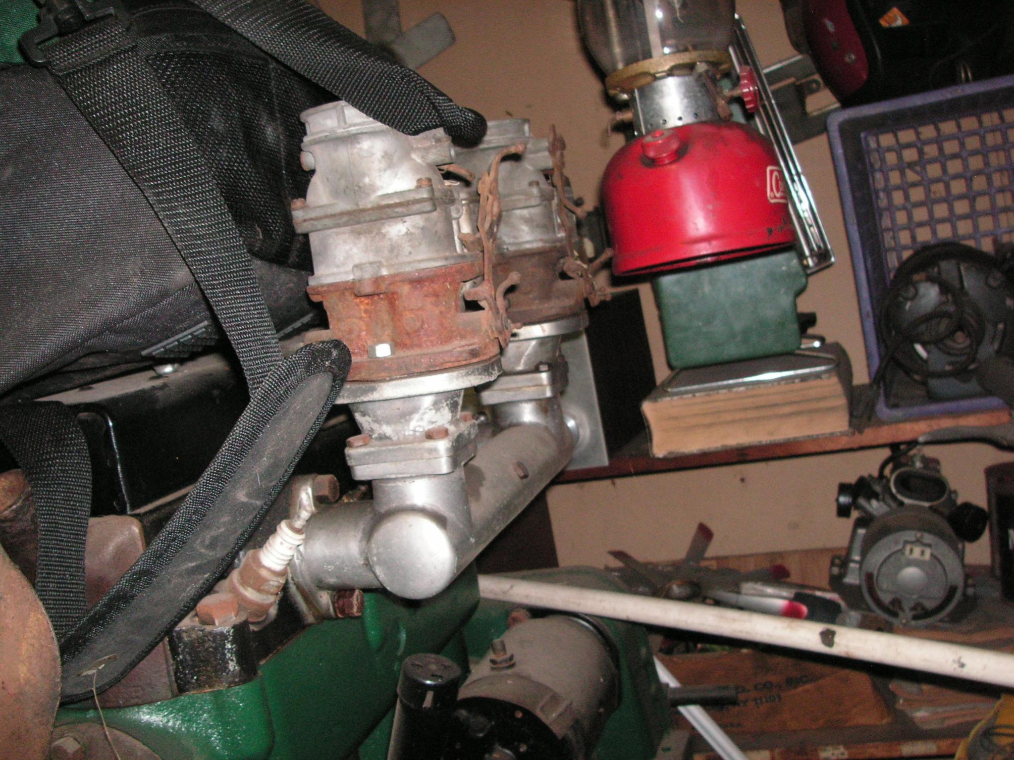

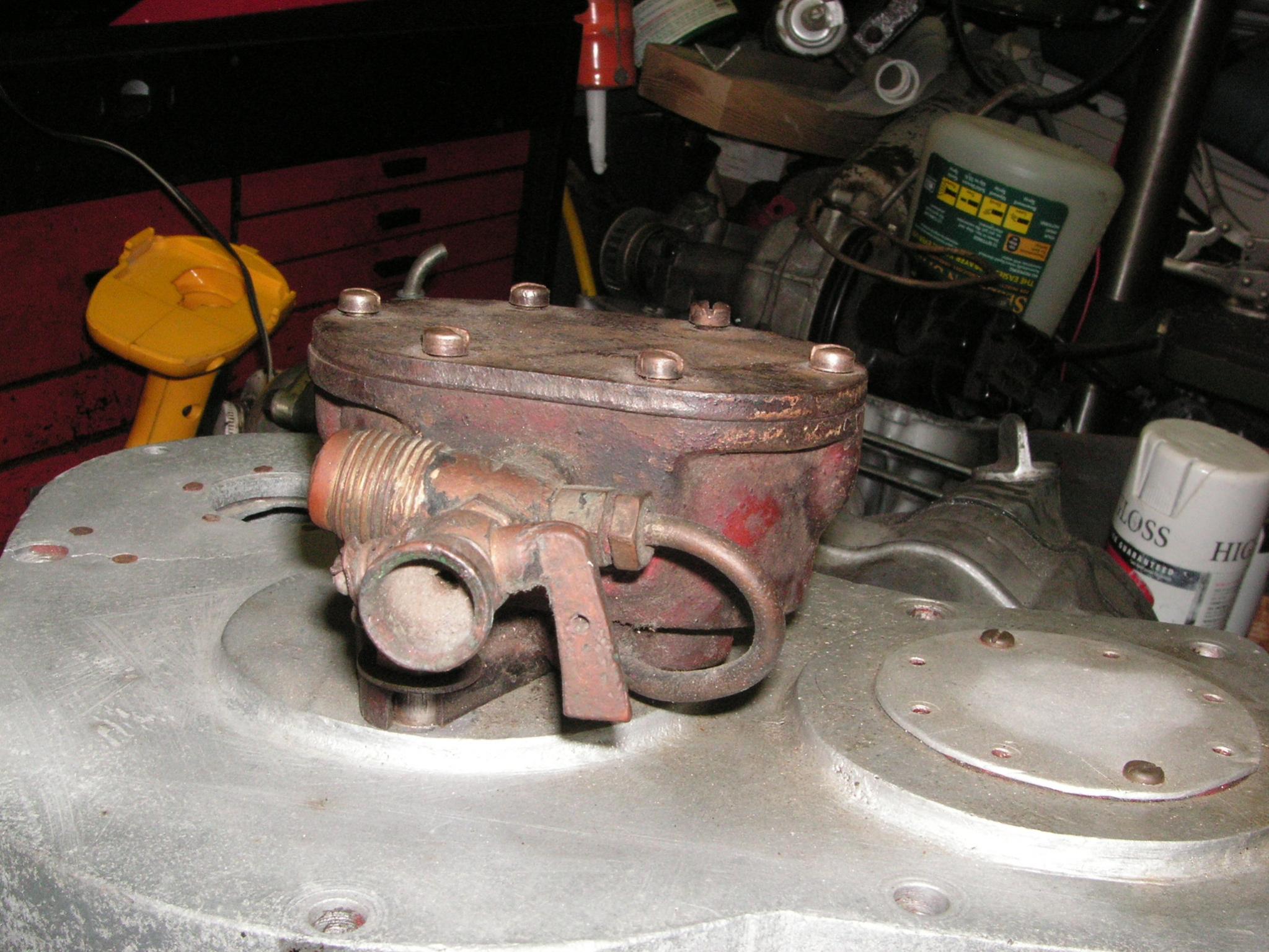

  3. Great stuff Dave, nice collection. Could you take a couple more pics of the front mounted oil pump. So which engine do you think is Rufi's? Could you post more pics of it? it would be much appreciated.
    If you come across another of those oil pumps or if you ever want to sell that one please let me know as I'd be interested.

  4. Egor
    Joined: Sep 1, 2010
    Posts: 74
    Egor
    It's the red one in the pic of the front drive cover. You can see it has a pluged water pump. The lifters look like a top hat something like an old Ford Y blocks. I haven't seen the mag for a long time, but I know its in there . Have fun

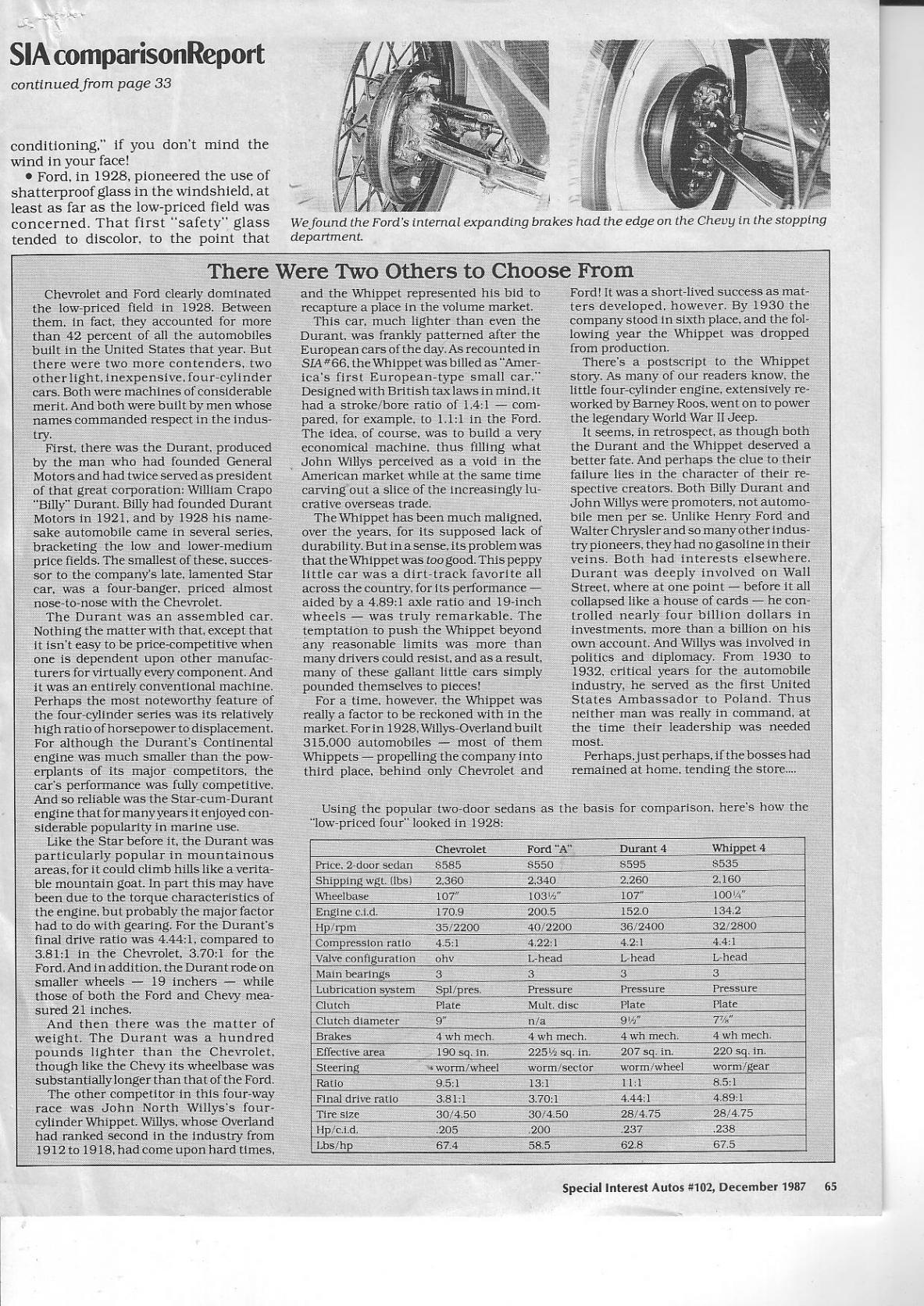

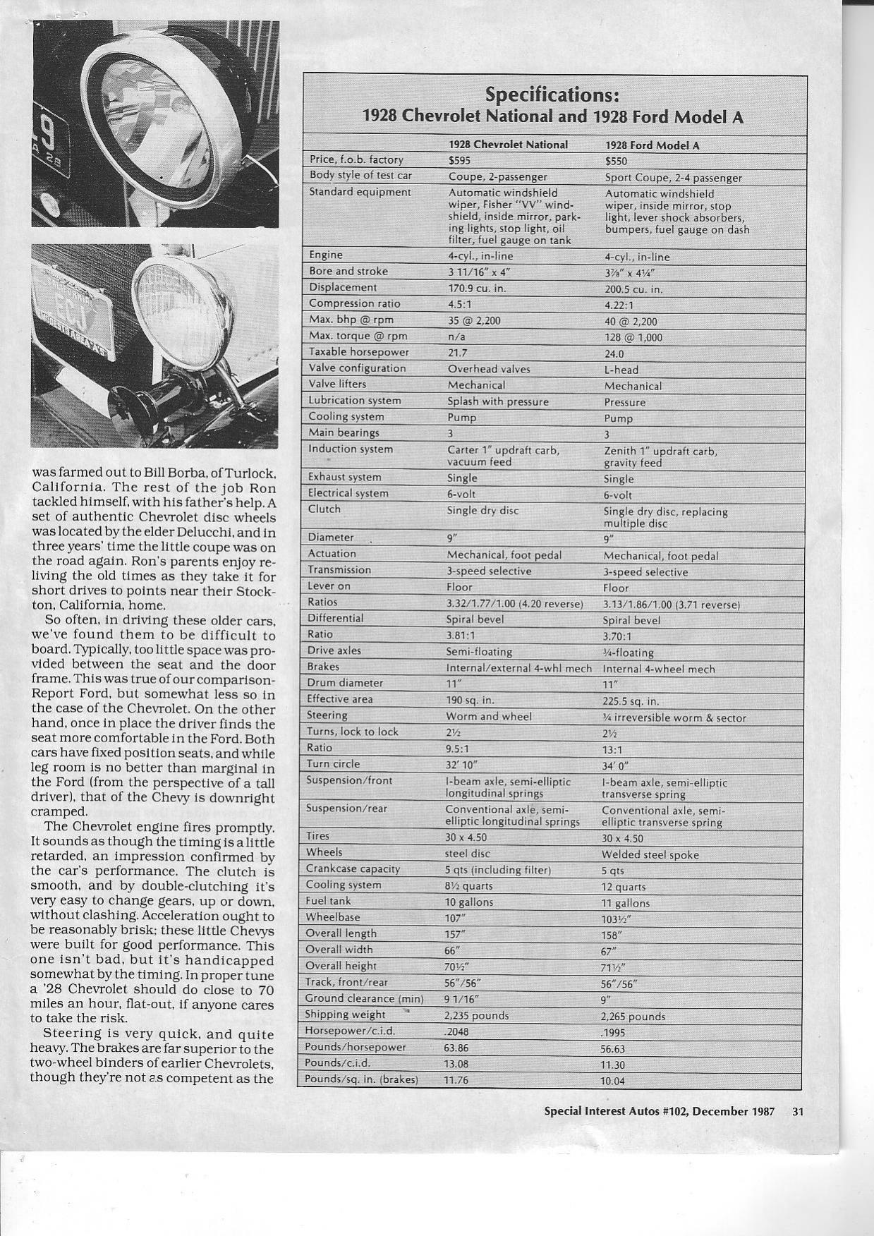

    Came across this article comparing 1928 Chevrolet with 1928 Model A Ford. Mainly of interest to a restorer but some interesting stats just the same. Also a brief Whippet & Durant Comparison. Have attached 2 pages of 10 page article.

  12. Egor
    Joined: Sep 1, 2010
    Posts: 74
    Egor
    I put the article about the Forever Four on Jimmy B's build page! I think it was a good article. I am thinking of putting all my stuff up for sale. Too much for me now. If I do let it go it will be everything and there is a lot of stuff in there. 6 engines and piles of parts. There is no way it could be shipped, so I think it could only be sold out here. Have fun, Dave

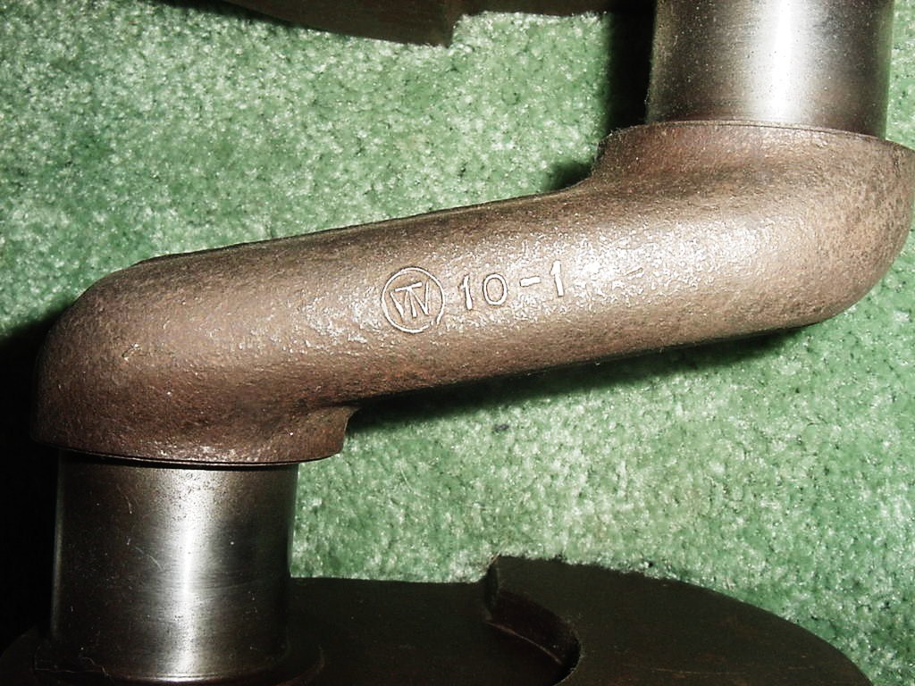

  16. NORSON
    Joined: Jan 19, 2009
    Posts: 469
    NORSON
    Would 6061 T6 be the choice for rockers? Its been said that Model C cranks were used. What is the differance between the "C" and "B" cranks. I ask because I just bought two "B" cranks.

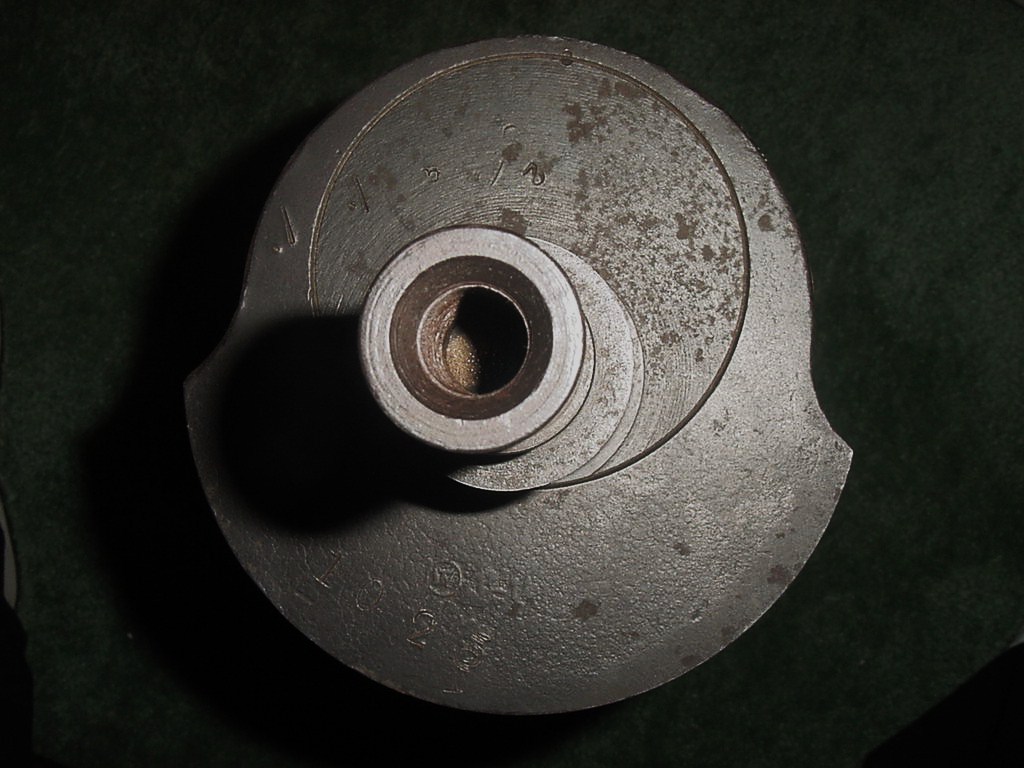

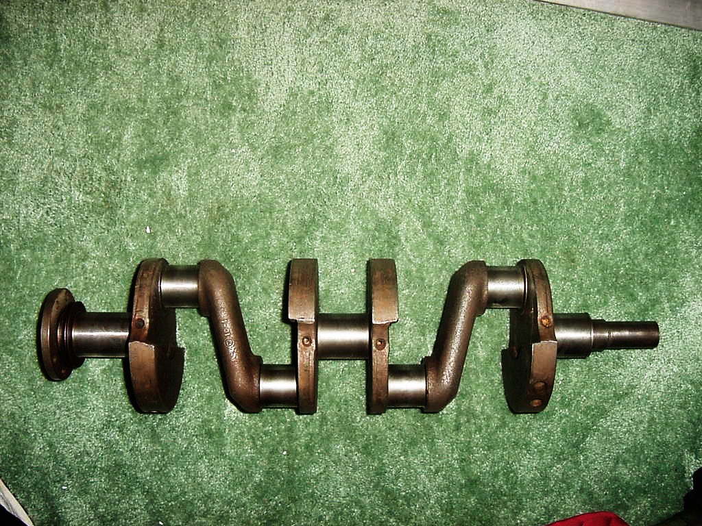

    Joined: Apr 25, 2010
    Posts: 498
    dawford
    The Model A Ford experts will tell you that ford did not build a model C engine and they are right acording to Ford records and those who worked at the Ford engine works.
    The first Model B crank shafts built in 1932 didn't have counter weights like the later Model B cranks.
    Since the first original Model B engines didn't have counter balanced cranks it was probably a natural to call the later Counter balanced cranks C cranks.
    I think that some of the confusion may also come from the Model B high compression head Marked with a large C cast into its top probably to signify a compression head.
    To add to the confusion the Model A high compression heads called the "Police Heads" had a large B cast into the top of them but had still the 4 bolt Model A water pump mount.
    Even though the Model B head had a 3 bolt water pump unlike the Model A's 4 bolt pump they probably cast the large C on the B head to differenciate the two.
    Ford Made Model T, Model A and Model B replacement engines into the 1940s.
    After the Ford V8 was introduced Ford sold the tooling for the Model A cars and trucks to the Russia who produced cars, trucks and engines into the 50s.
    Russian military trucks during WWII were mostly Model AA trucks.
    Years ago a few Russian Model A and maybe Model B parts somehow showed up in the U.S.
    All of this to say that I think that what they mean by a Model C crank shaft is a late Model B cranks.
    I have a model B engine in my barn that is an early B block with the large main and rod bearings but the round counter weights.
    I also have a later Model B crank that has heated and shrunk on counter weights.
    The even later Model B cranks may be one piece with cast on weights.
    At any rate during the 40s and 50s somehow talk of the Model C Ford engine surfaced and became a sort of erbin myth of early Ford engines.
    Here are some pictures of a Model B crank with heated on weights.

  19. The only clearance issues I'm aware of is the OX-5 rods (maybe Ford rods too) would foul the block side walls so recesses are ground into the block.
  20. ebtm3
    Joined: May 23, 2007
    Posts: 837
    ebtm3
    "I thought somebody earlier said that there really isn’t sufficient room in the crankcase of the Chevrolet block for counterweights, so if the “B” cranks aren’t counterweighted, maybe that makes them a better choice (or is it just that they use bolted on counterweights instead of forged?)."
    It isn't so much the counterweights that are the problem, it is the fact that the journal end of a B rod is larger, requiring the notching of the block. There may also be an issue with the rod to cam clearance--see my post #440. The end counterweights will have to be ground down some to clear the radius in the block at the pan joint, shown at the top of Jimmy's second picture above.
    I am running a Chevy crank with welded on counterweights in the car in my avatar
