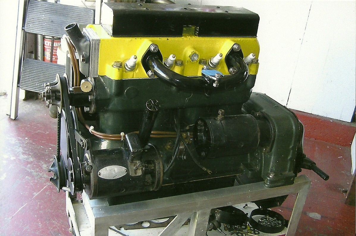

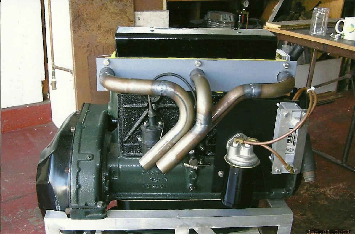

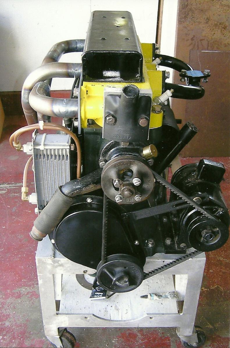

  2. Bill, it is Spurgin. Think Spurgin like Gin & Tonic!
    Photos sent to me by Ernie
    Outback likes this.

    Wow!! I'm sure glad Stumbled on those old motors, the HAMB and this thread. I am having fun. Thanks for the photos Jimmy B.
