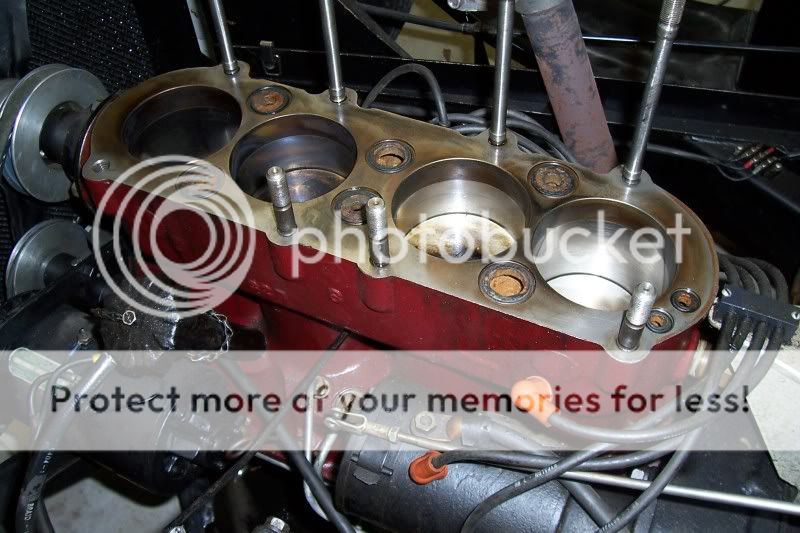

    I started to pul my engine down, to change to higher compression pistons. One of my homemade pistons on the left, a used piston from a 270cid GMC straight 6 on right. If the wrist pin holes are lined up, the flat area on the piston crowns line up.
    The GMC pistons are 3 25/32", and the wrist pin hole is .010" under 1". The Ford A wrist pin is 1" and I am using Ford rods, so I will have to hone the pin hole on the 270 pistons. Also, the hump on the 270's is inconveniently located on the same side as the skirt slit, which either the split would be on the thrust side (not good!)or the hump would be right in front of the sparkplug (almost as bad). The plan is to heli-arc the split, then refinish the pistons to 3 3/4", turning them into solid skirt.
    View before starting on job-
    shot of homemade rockers, and rocker stands. Note that these use the inner origional shaft bolts, the outer end is held by a head stud.
    Studs made from 1/2-20 grade 8 bolts, threaded 1/2-12 to fit hole in block. D**n GM!
    Since I don't use a head gasket, here you can see the O ring grooves that I cut into the deck around the water holes. The hole on the far left has a large O ring, because the head hole is large. If your block and/or head does not have the two little holes at the top of the picture, be sure to drill them- they can be located with a head gasket. The holes only go in the rear.

  18. Man I love your work Herb- great to see what the O Ring cuts look like!
    Any idea waht your compression will be with the 270 pistons?
    Oh, you wouldn't happen to have a "spare" water outlet for the Olds head kicking around, would you?

    Herb - what will happen if the head/block doesnt have the two holes you mentioned?
    Thanks,
    Mike
  21. ebtm3
    Joined: May 23, 2007
    Posts: 837
    ebtm3
    Michael-
    Nothing catastrophic -- I think that the factory came to the conclusion that the rear cylinder was running hotter than the others. Easy enough to do if every thing is apart.
