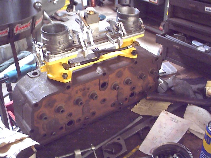

  3. RichFox,
    Was looking at your Ford 4.6l SOHC throttle body setup again (of course, I just walked past a half dozen of these at the salvage yard the other day, duh).
    What parts are necessary to put a system together to run a pair of these? I heartily admit my total ignorance in this area- please help!!!
  4. RichFox
    Joined: Dec 3, 2006
    Posts: 10,020
    RichFox
    Mine uses a Hilborn metering block, nozzles, hoses and pump. I made my own linkage and mount stuff and bypass that uses Holly jets. Or what ever you want
