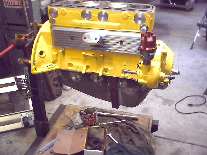

    Was out in the garage today working on the wife's car, new rotors. Anyway, was taking the crank pully off the 28 chevy motor and got to wondering if anyone ever made a DO conversion for a early chevy motor? Was there ever a DO HAL for a Chevy? Maybe a single OHC? I just don't ever remember seeing any pics of one, but then again, i don't remember what i had for breakfast.:rolleyes:
  3. Michael, you really need to read Gerber's book. He did a redesign of an existing head that he felt flowed worse than factory, then came up with his own OHC design. By the time he was done, there weren't many Chevy parts left. He designed his own patterns and had a foundry cast them, then he machined them. Really an inspiring book.
    MAC, what is the complete title?
  4. Outlaw Sprint Car Racer, by John Gerber- absolutely worth the money!!!
    Michael, a DOHC would be nice, now wouldn't it!
    Pat, I haven't thought the oiling issue through completely- one idea that's been bounced around is using the shaft oiler from the Stovebolt 6. Nice thing with the '28 is that it does have the cover plates, but better sealing (maybe coming up with an aluminum replacement) is necessary.

    the pressure side of the two filter bungs in my block has a T in it. it points between the gap in the barrels ...it is pinched off at the moment...........would that be for the guage?just wondering if i'm missing an oil line to something critical.?

    bct--
    Sorry, but I thought that I had answered your question the first time that you posted it--but I see that I didn't--SO
    There are two hex fittings on the block ahead of the oil fill pipe. Inside the block is a piece which Chevy calls the "oil distributer". Oil from the pump comes up to this (internally) and goes to a spring loaded valve. Once the pressure ( a couple pounds is enough) opens the valve, then the oil goes to the troughs that the rods dip into. This valve is under the larger hex nut, and has a T fitting screwed into it.
    Top of fitting goes to dash gage, side of fitting goes to oil filter through hole in middle of block. Oil from filter goes back through block to smaller hex fitting on oil distributer. If all lines are crimped off, system will still work, but more flow will be had if lines that did go the the filter are connected to one another, because the oil then does not have to go through the spring loaded valve. If you have no pressure, the oil pump is a simple thing with two spring loaded vanes. I have had a pump that didn't work because the vanes were stuck from sitting, and also had one that would only pump under high RPM--the light spring that is supposed to push the vanes out was rusted away but the RPM would throw the vanes out from centrifugal force.
    This applies to '27 and '28 engines-
    Don't worry about low oil pressure- as long as you have some the system is working. Also 10-30 oil is recommended, as flow is more important than pressure with these engines.

    awesome ebtm3......... thanks for all the info and your time...before i started it i loosened both bungs off and after a few cranks the oil ran out of the front....so i figured it was the pressure side , some of the earlier engines seem to have had oil feed lines outside the block so i figured i had better ask. , i am useing diesel oil
    here are some more questions,
    how much oil can sit in the head?
    how much oil should be in the sponge/mat? soaked ? light? is it meant to sqeeze the oil out between the cover and rocker?
    what gap should i be useing in the spark plugs?
    could i run a small modern motorcycle oil filter ? too restrictive?
    tia.....i love this old engine, esp. the sound, and i can't wait to run it ....

    bct
    The only place that oil can sit in the head is the pockets where the valve springs sit. If the oil level gets too high in these from what drips off the felt pad, it will leak down the guides and cause a little smoke- no big deal. Since my engine is only used occasionally, I take the cover off before starting, and put 3-4 tablespoons of oil on the pad.
    Spark plugs .030", points .022"-,025"
    I would think that a motorcycle filter would be better than non at all, and since the system works with the lines blocked restriction isn't a big issue--only a portion of the oil goes through the filter, unlike a modern full flow system where every drop that the pump moves, goes through the filter before going to the bearings. Incidentally, the main bearings get their oil from what splashes around inside. This oil fills a little pocket in the block casting above each bearing and flows to the bearing by gravity. It is recommended by most people who run stock Chevy 4's that you fill the crankcase one quart over the full mark on the dipstick, since the speeds that you will be running will be faster than the speeds in '28. Oil picks up engine heat and an extra quart gives the oil more time to shed the heat.
