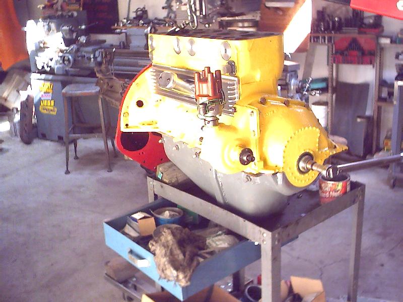

    After "mucking about", as our friends across the Atlantic put it, with C4 engines for 23 years, every once and a while the dang things come up with a new ailment, usually announcing the fact with a previously unheard noise. To save others from having the same ailments possibly appear I thought that it might be a good idea to do***ent the fixes. The first time that this happened was after the engine had been in my avatar car for about a year, and a strange, low pitched knock started coming from the lower rear of the engine. It sounded like a loose main, but usually a main won't make noise at low speed, and this was most prominent at idle. turned out that the six bolts that hold the flywheel to the crank had started to elongate their holes, and the flywheel was shifting diametrically with each cylinder firing. Not a whole lot of option for increasing the bolt size, but I did go with grade 8 bolts, and self locking nuts.
    To take the torque load off the bolts, I drilled and reamed for 6 3/8" dowel pins between the bolt holes, and so far, that has solved the problem.
    I have never (well, not for a long time anyway) been one to "drop" the clutch to see how much tread can be removed from the rear tires--but once the clutch is fully engaged, I have been known to show no mercy.
    Over a year ago I stopped at a fellow's house, where Model A Ford owners meet one night a week, and on leaving wound out first and second gears, knowing that none of their engines could match the revs. When I got home, and was putting the car in the garage, I realized that there was a knocking noise at idle. Since it had been a number of years since the flywheel incident, the noise didn't seem quite the same, but I ***umed that the same thing had happened again. I put the car away for the winter, and got busy with my '28 Chevy coupe, putting an Eaton blower on the diesel engine that I had installed earlier.
    Finally, when I couldn't think of any other excuses to use, I drug the roadster out of storage and started checking things. Holding the flywheel from turning, and rocking the crankshaft back and forth, revealed no play, so the engine was torn into, since i intended to put a set of higher compression pistons in anyway. In the process of all this, I could find nothing that I could blame the noise on.Finally, just before I was going to put the pan back up, I grabbed the cam, to see if there was excess play in the timing gears. There wasn't, but the cam would move back and forth about 3/16"--there was the noise.
    The end play in the C4 cams is controlled by a bronze plate that is trapped between the rear of the timing gear, and the front cam bearing.
    Nothing holds the gear on the cam but a Woodruf key and a press fit, and the right amount of play has to be created by pressing the gear on just far enough so that the bronze plate is free to move, without slop. The GM "engineers" cleverly designed things so that the helix angle of the gears tries to force the cam gear off the cam--these guys were absolutely brilliant--NOT! I pulled the gear the rest of the way off--it was tight--cleaned things up, and pressed it back on with Loc***e. Evidently the combination of a 50# oil pump, much stiffer valve springs, and high revs, caused the gear to work its way off.
    I considered several other mechanical ways of better securing the gear, but lack of room, and the cam being hard cause these to be impractical. I used the strongest Loc***e available, and if the problem reoccurs I will only have to take the front of the timing case apart. Picture of how the gear has to be pressed on--it can't be driven on, as there is nothing decent to resist hammer blows, is below.
    Like the gal said when her nose started to bleed "If it ain't one damned thing, it's another"

    I have not done the Chevy yet. But I have mated a Plymouth four and a Dodge Bros Four as well as a Lotus 907 to a Ford gearbok that came with the 2 liter four. Worked well. I have also bolted a Ford top loader to a Chrysler 392 as well as a Packard V8 and a Pontiac. Swaping gear boxes isn't hard but a mill is very handy. The stock steel bellhousing is a big help as it's so easy to adapt to another bolt pattern. If you want to PM with any questions that I can maybe answer, feel free.

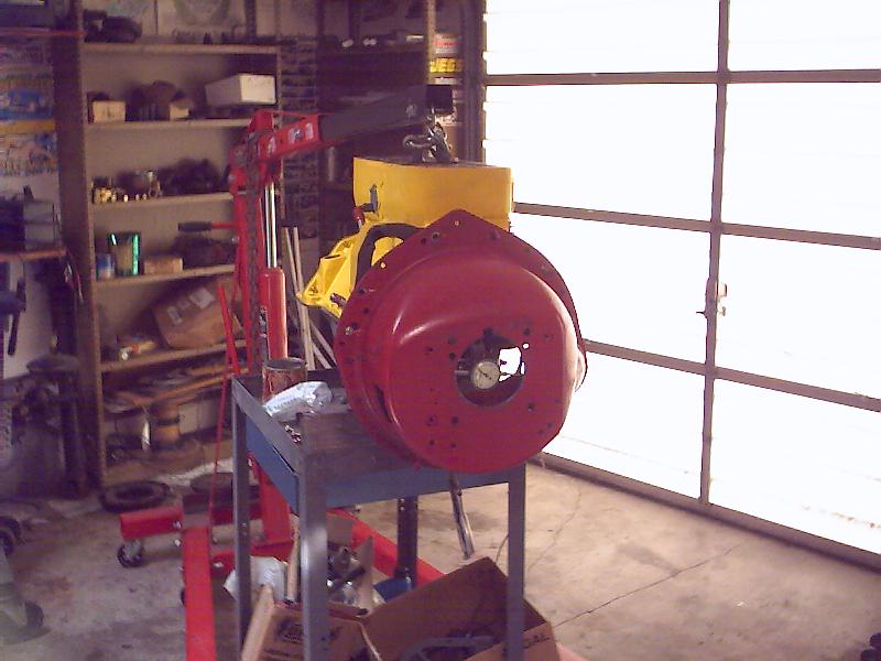

    Since the C4 bell housing is pressed from approximately 3/16 sheet steel, it is relatively easy to modify it to take other transmissions, by removing the existing rear wall and subs***uting one that matches the front pattern of the "new" transmission". Important points are that the finished front and rear surfaces of the finished housing be parallel within about .005", and that the central hole that locates the transmission is in line with the center of the crankshaft within about .002" This is best done with machine shop equipment, by a decent machinist, although there was a series here on HAMB where a cast bell housing was modified with only a drill press and a hand held grinder, as I recall. Certainly, because of the pressed steel construction, it is an easier job than a housing that is cast iron, due to the ease of welding.
    As for shortening the torque tube--since this has been asked a couple times, and my only answer is to say that the rears are a POS let me explain what would be involved in shortening one, The drive shaft itself would pose no particular problem,and anyone who could do a Ford shaft, could do a Chevy. The best method would be to cut off the front end and machine a new spline for the U joint, but there were plenty of Ford shafts done by cutting some out of the middle and welding back together.
    On the Ford rear the drive shaft tube, and the axle tubes both unbolt from the centersection of the rear, so shortening the drive shaft tube is usually done by removing the excess length from the tube a short distance in front of the rear flange, then rewelding after checking that the pieces are in line in a lathe. The Chevy rear has the torque tube and axle shaft housings riveted to the center section, making it impractical to take apart. The best place to shorten in this case would be right behind the front of the tube where the bell shape containing the U joint is. Since lining up in this case would strictly have to be by eye, the inevitable misalignment would cause the least trouble.
    I have said it before, and I'm getting tired of saying it, but why use a rear that has WW1 style brakes, axle shafts and drive shafts that were constantly breaking with a stock 27 or 36 HP engine?? The material of the shafts is , like so much else on the car, the cheapest **** that GM could get away with.
    By going with a modern transmission, you will not only have a much stronger transmission, but also one that shifts much, much quicker--and is quieter to boot.
    Herb Kephart

    The only blocks that have the pushrods hidden are 1928. If the blocks have the push rods exposed, and the distributer is in between cylinders 2 and 3 they are 1926 or 1927.
    Earlier than 1926, the distributer was driven from the rear of the generator, which was driven from the timing gears at the front of the motor.
    All heads interchange, but the early ones with the single exhaust port are prone to cracking if overheated.
    Rich-- you are quite right- perhaps I didn't put enough emphasis on the fact that it should be done in a machine shop. However, the bell housing ends up too long for most modern transmission input shafts--hence the need to cut at the rear.
    What I did was to locate the bellhousing on a plate with a couple of (added) dowel pins, then put the ***embly up in a lathe and get the transmission mounting hole true in both planes. Left the plate in the lathe, but removed the BH and did my evil work on it. remounted it on the plate, and faced and bored the new rear area.
    After mounting the modified BH on the engine, I indicated the hole relative to the crank and found that by opening up the mounting (bolt) holes 1/64" I could get it near perfect. I then transfered the dowel pin hole locations to the flywheel housing to keep things in line.
    I guess that I made it sound too easy the first time around.
    Herb
