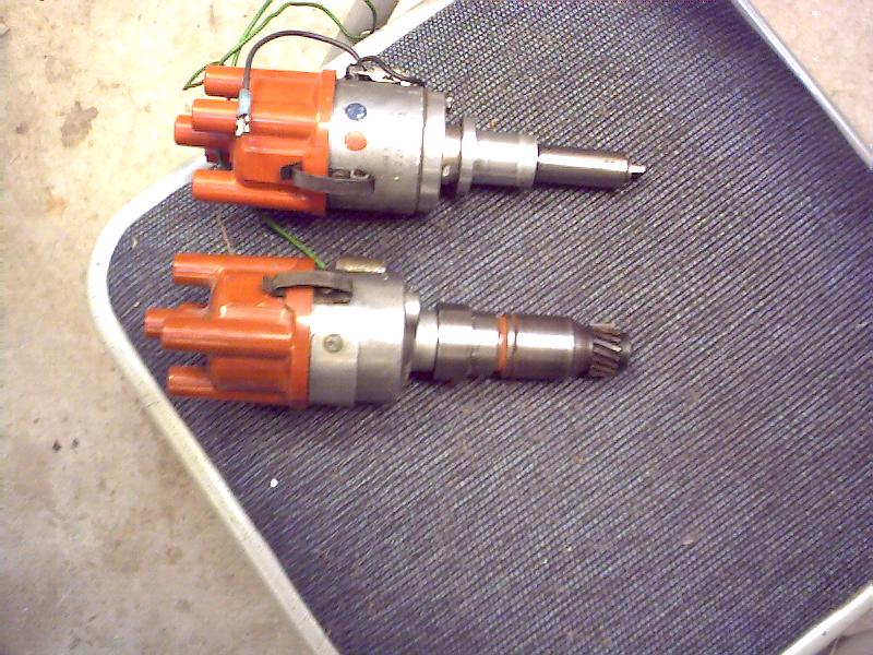

    I am referring to the distributer that came in Ford Pinto 2000cc cars. The points and such are the same as VW. I am told. Here are some on a Plymouth. And One from a Pinto set up for a Plymouth and one from a VW set up for a Dodge Bros. Dodge has gear, Plymouth has blade drive.

    Yes the Bosch is the 009, although most of the ones that I have come across seem to have a letter code. They come both rotations, for a Chevy you want one that turns clockwise looking down on the rotor. Ford A&B turn counterclock. They come with different amounts of centrifugal advance also.

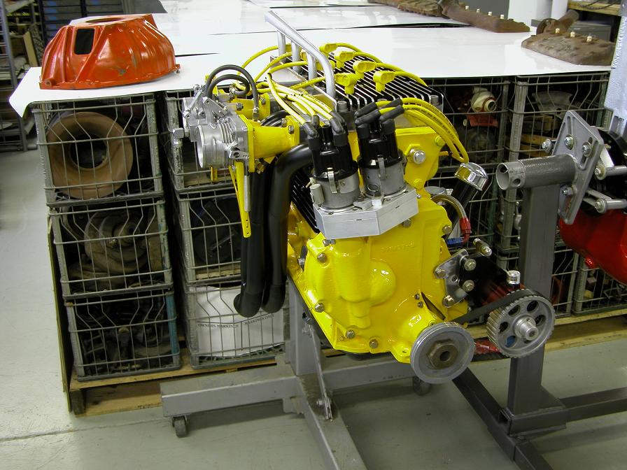

    Wish this were mine, but it's the Spurgin/Giovanine roadster :)
    Outback and volvobrynk like this.

    You're looking for the stock color, Mac? This is probably a good time to have a VCCA Chat account.
    I almost didn't see your statement that we were looking at the S&G roadster. Man, that's breathtaking.

    What I wouldn't give for one of those valve covers!!
