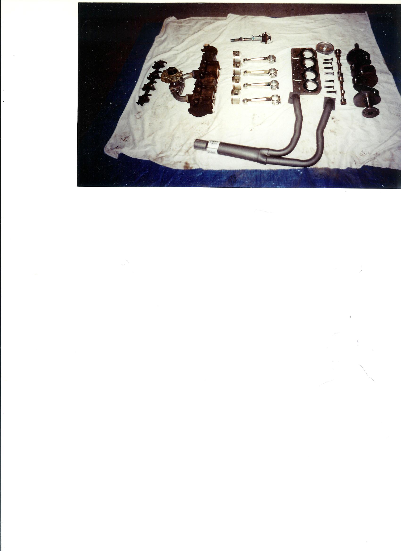

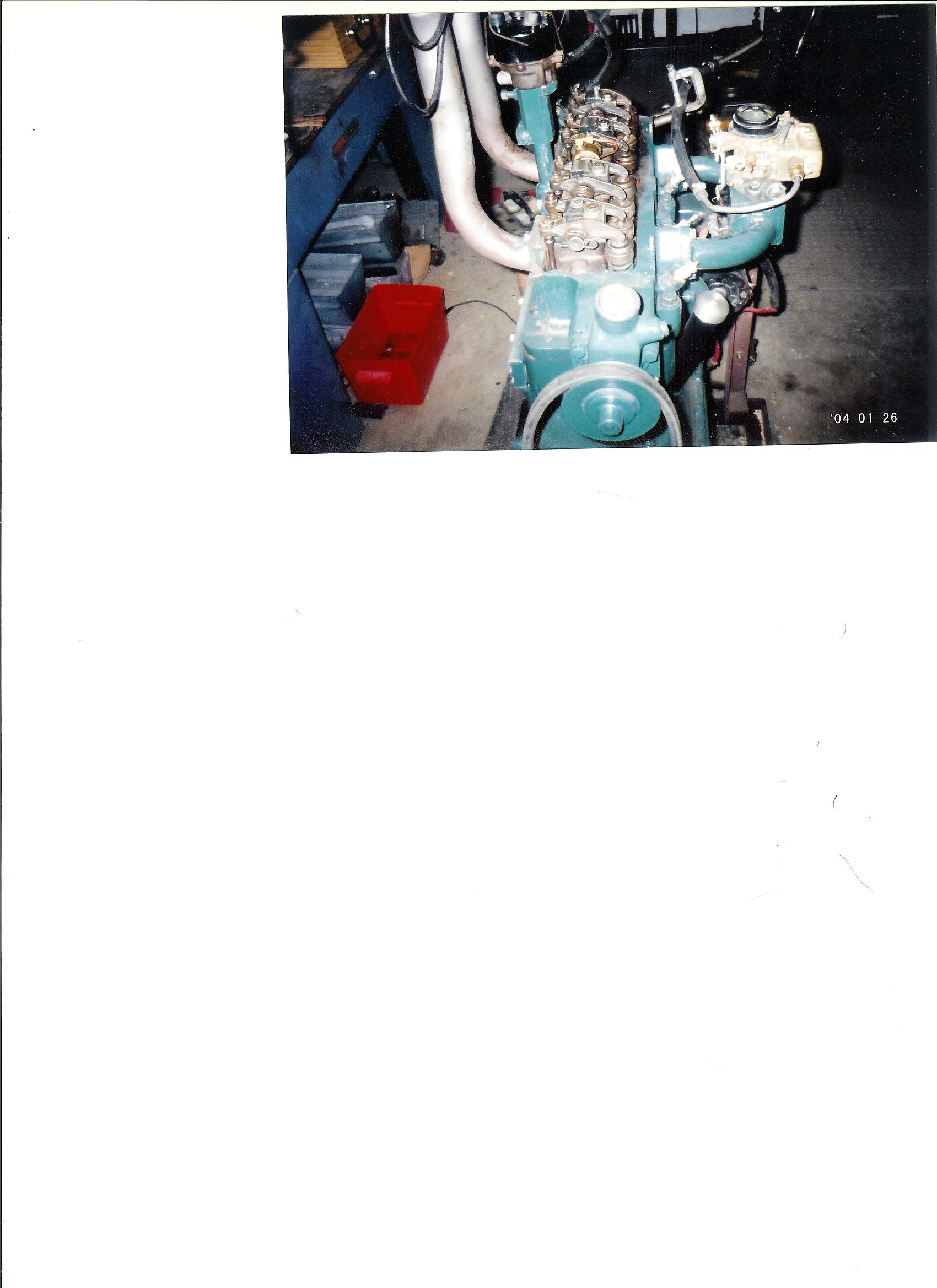

    You asked a while back what compression I expected to get with the GMC 270 pistons. Now that the rings have seated a little bit, I took a compression test and it is twelve and one half to one. Spark knocks like a bitch unless you stay right on the manual advance/retard lever. Guess that it's flat top piston time again. Man, I'm gettin tired pulling this thing apart. Anybody want to make a reasonable offer(avatar car)? I'd rather work on the 224 FB engine.

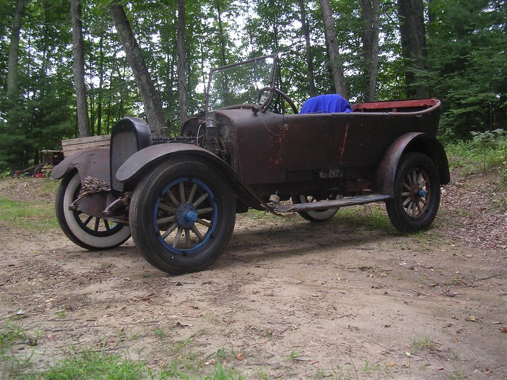

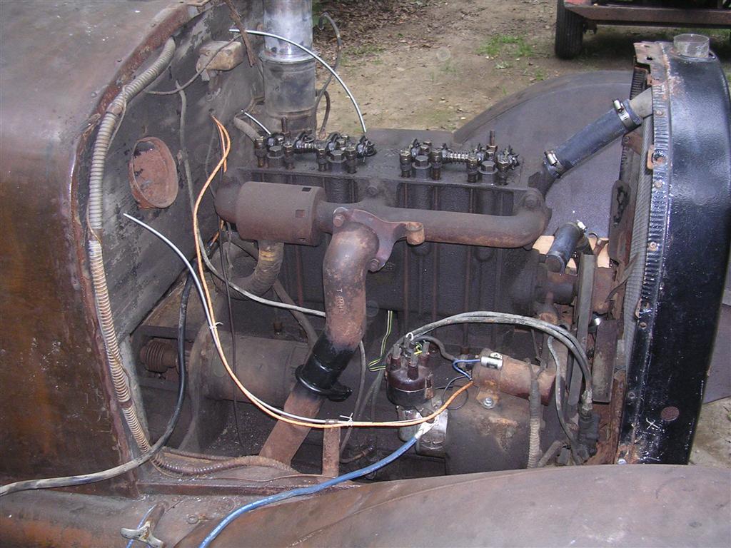

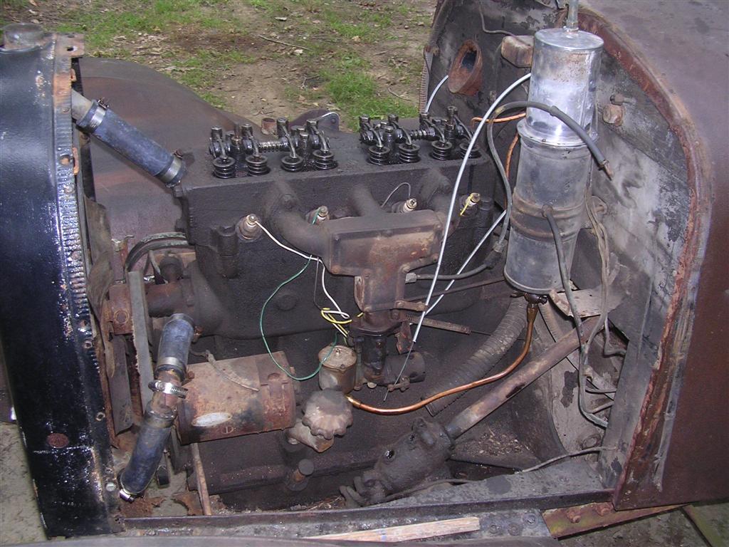

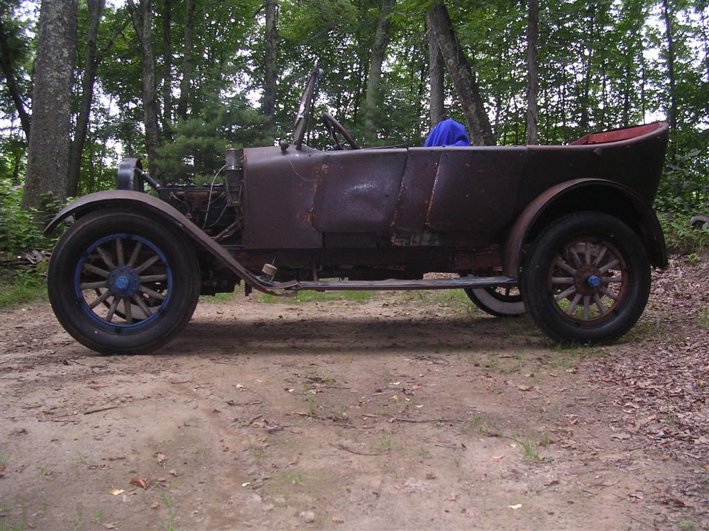

    I just got this one in for some work. Last inspection sticker on windshield is 1958. It was used many decades ago in front of a Chevy Dealer for yard art.
    Got it to run a few days ago. they parked it due to a broken distributor mount, which tore up the brass dist gear.
    The owner wanted to get it to run, drive, and stop, and fix the broken off exh manifold. I just finished putting on the tires and drove it out to see if it could move and stop. :)
    I still need to finish the vacuum fuel pump tank work..and a few other things...like find cloth spark plug wires. For now, I used trailer wiring :rolleyes:..hey, it's color coded..
    It's a 22 Chevy Baby Grand

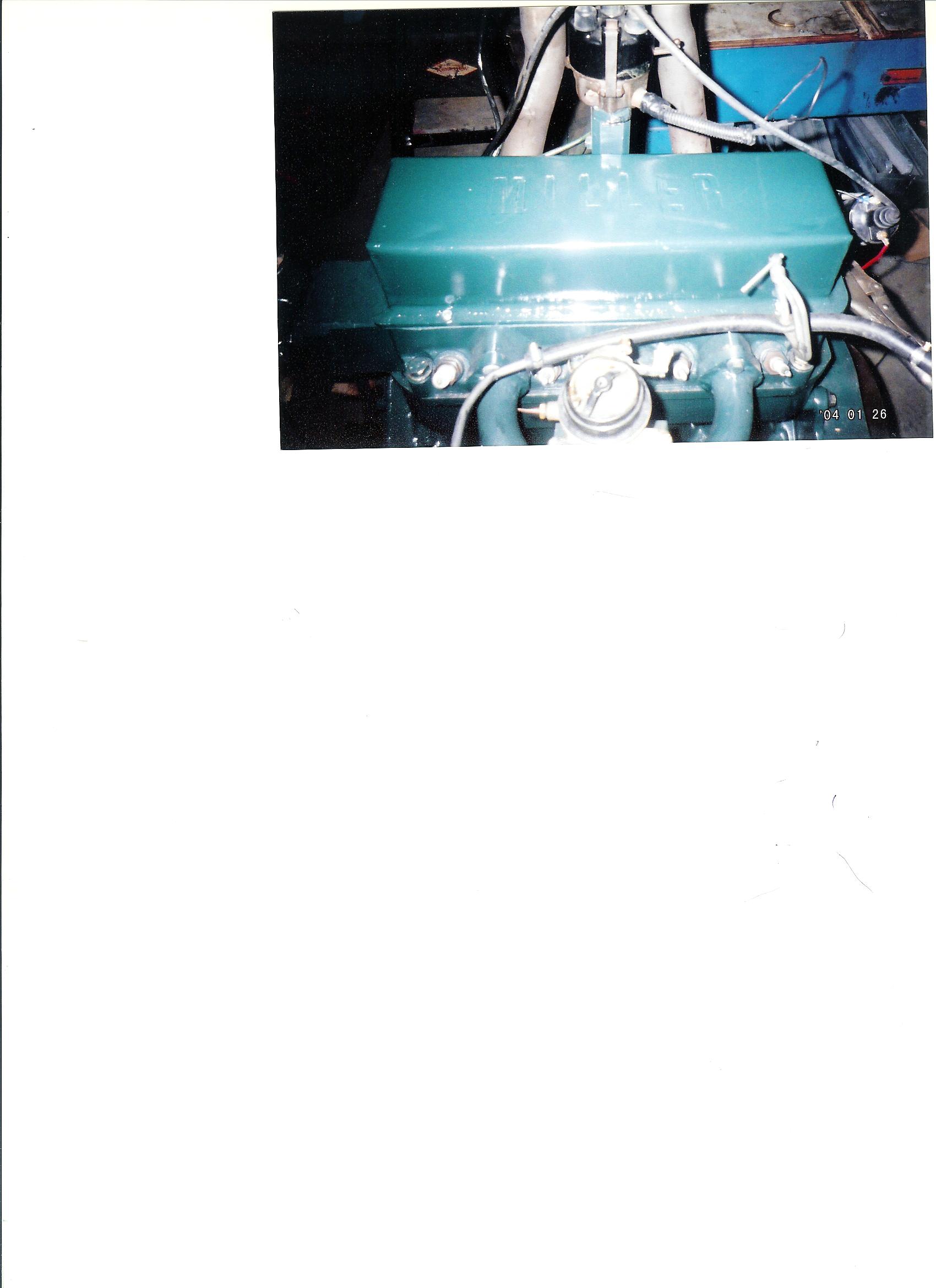

  24. George Miller
    Joined: Dec 26, 2008
    Posts: 413
    George Miller
    from NC usa
    @8 chev Head on Model A engine 001.jpg I was ask to share this picture. This is a 28 Chev head with the other parts I used in the engine, which is a Model A.
    The head has Chev v8 valves, 216 rocker arms, Ford 6 carb home built intake.The adapter plate has a combustion camber machined in it.
    The rods are home built from 7075 alum, pistons are from a NASCAR chev engine. Camshaft was made by Bill Stipe. Crankshaft was counter weighted by me. I also used inserts in the mains.

  27. George,
    Thanks for posting the pics and info- I didn't realize that the Olds 455 head was modified for an A block (just didn't look/read close enough), but I would guess that the conversion would work for the Chevrolet block as well?
