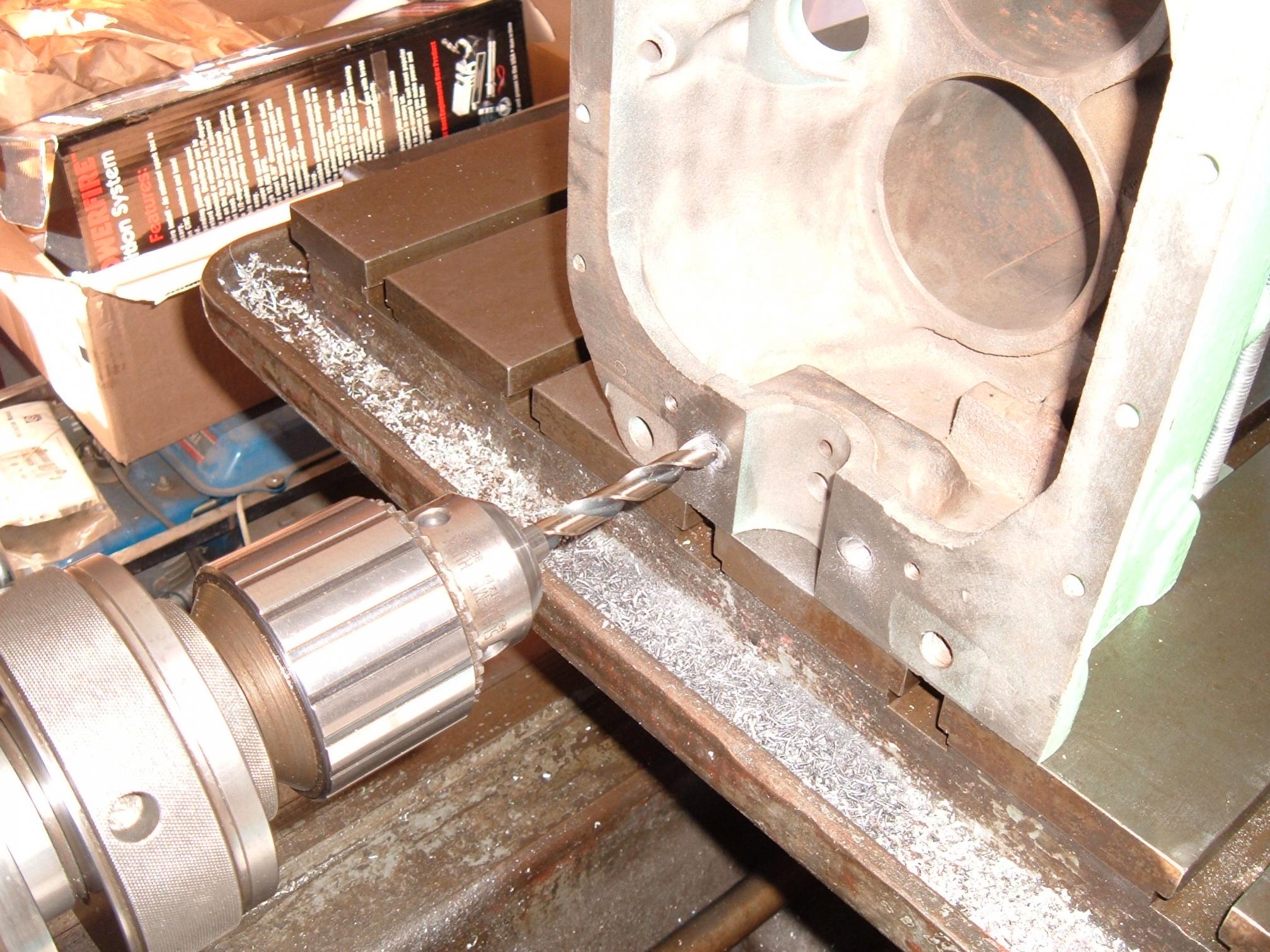

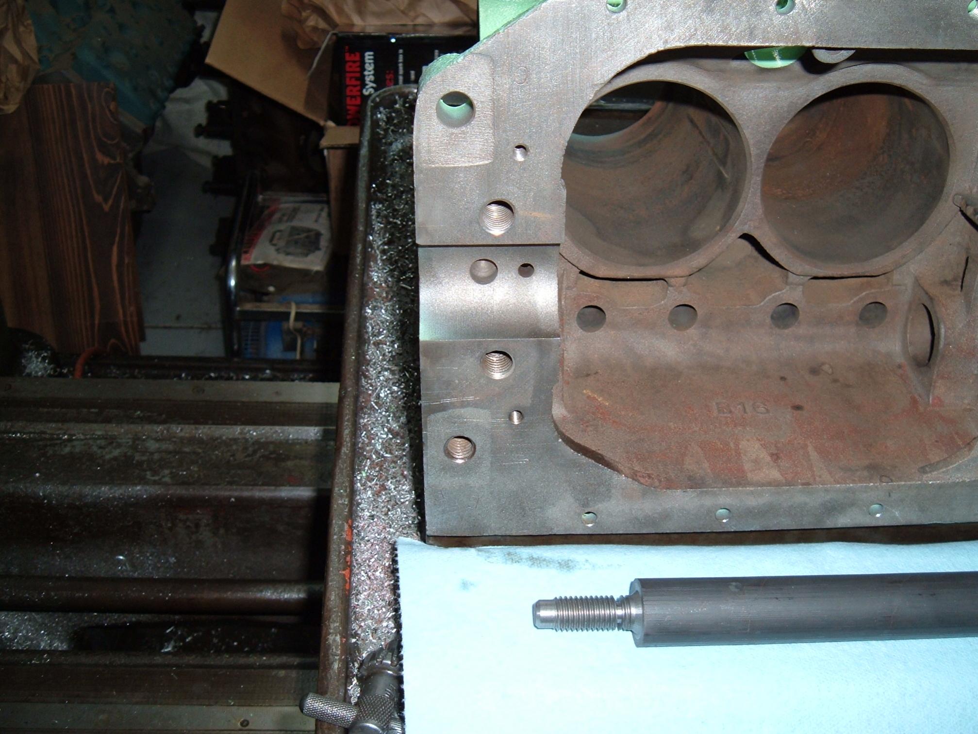

    Mac, the paint was custom mixed @ true value hardware using ExoRust base. I can get the formula if you want. In the real world the paint is darker than in the picture, maybe because of the flash. Here's a picture of moving the bolts over & the engine installed in the roadster where you can see the color more like it is. Pat (PS, we mixed paint 3 times to get close to the original color on the '48 era race engine )

    Mac, I bored the block to 1.468, the cam journals were 1.370. In a later dwg of one of the cams used way back the journals were 1.392 dia. If my memory is correct, an earlier than '25 cam had a larger heel dia. but I can't recall what year that was. Maybe '14-'18? P

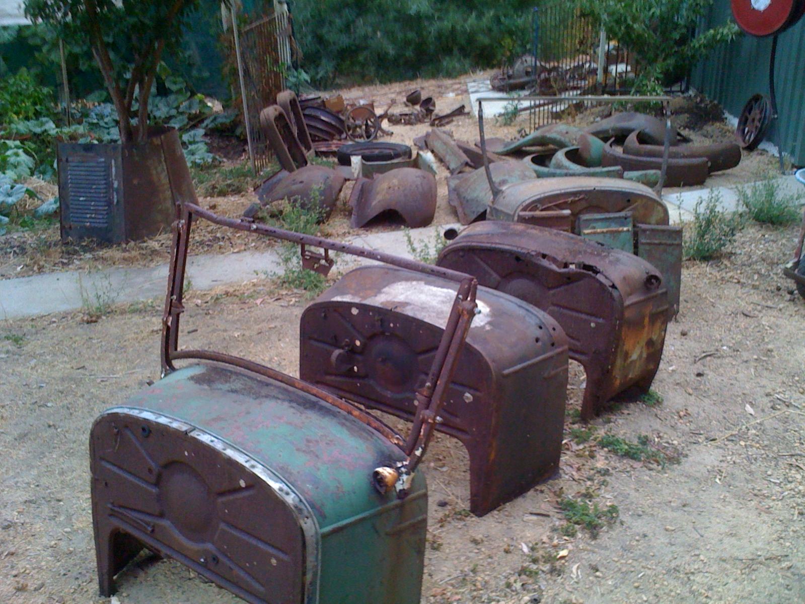

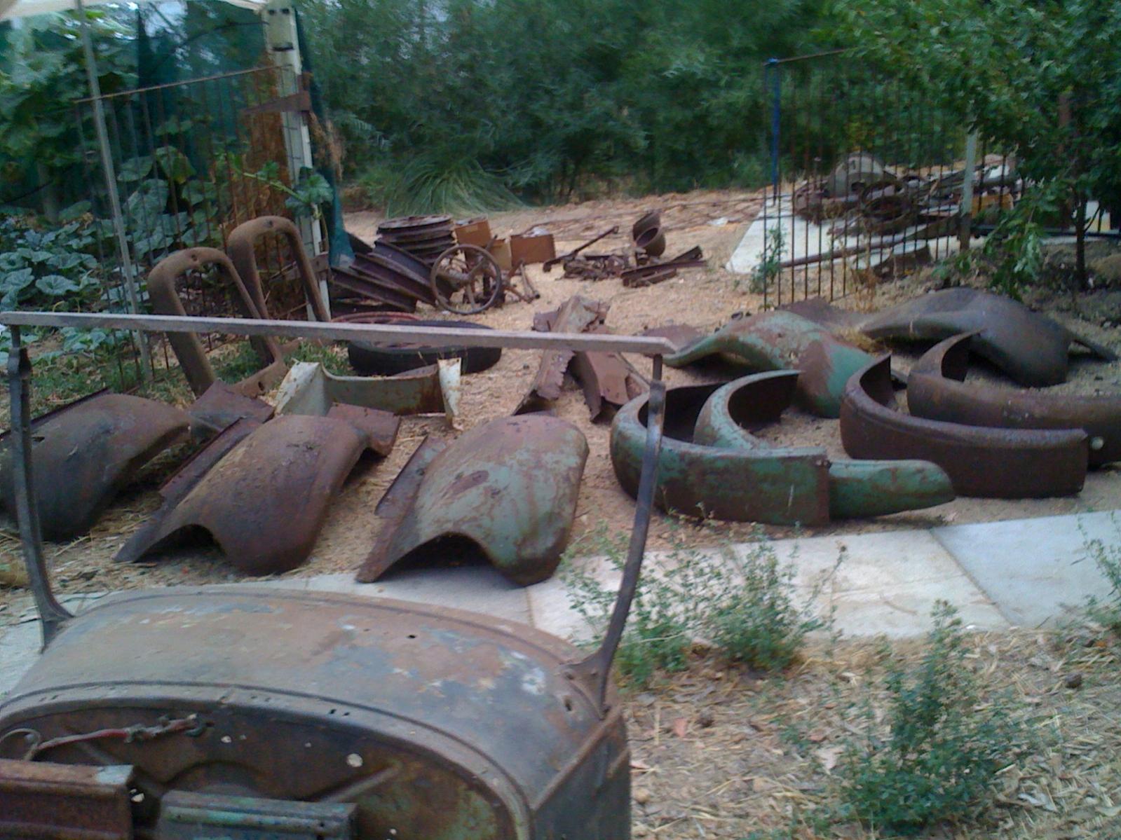

    happy new year from down under have been busy in the shed so not much computer time .my last time was looking for info on water pumps .them many hours figureing it out worked i found a nos water pump in a box at a house sale .with a bit of a nudge it fitted perfect . now i need info on firing order i thought 1342 but looking at those crank pictures im not so sure . do the motor and gear box mounts have any kind of bushes or mounts or metal to metal. also the guy who is making centre steer roadster ive got a brake pedal in 27( tin pressing ) or 28 full cast the clutch pedal would be closer to bellhousing ive got both ienclosed a couple of pics i put an add in the paper wanted chev 4 chassis this guy rang me went to have a look it was indoors in original paint so i paid the money 200 he started laughing and said you gotta take the rest 4 car trailer loads of 90 % chev 4 stuffall under a tarp the roadster is 31 ft axle an rims with aussie holden cowl and home made doors i was told by an old guy in his ninetys that the tub is a super rare chev body any info appreciated thanx

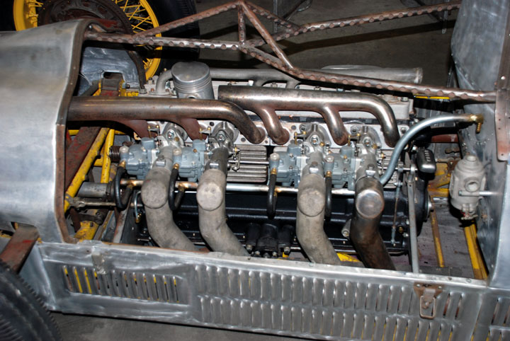

  27. One idea could be to run twin carbs- Stromberg Hs4's should just about fit right on the intake side of the head (John Gerber, who is referenced here many times, ran twin carbs without any problems)?
    volvobrynk likes this.
  28. bct
    Joined: Apr 4, 2005
    Posts: 3,178
    bct
    what do you think about twin tillotsens? the carbs from a model A, updraft.
    are the strombergs side draft?
  29. Yup, SU's are sidedraft- a little finicky, but overall pretty good. Zenith/Tillotsens would probably be a good choice as well.
    I'd like to find a pair of sidedraft Zenith's like these on the Eddie Miller streamliner:
