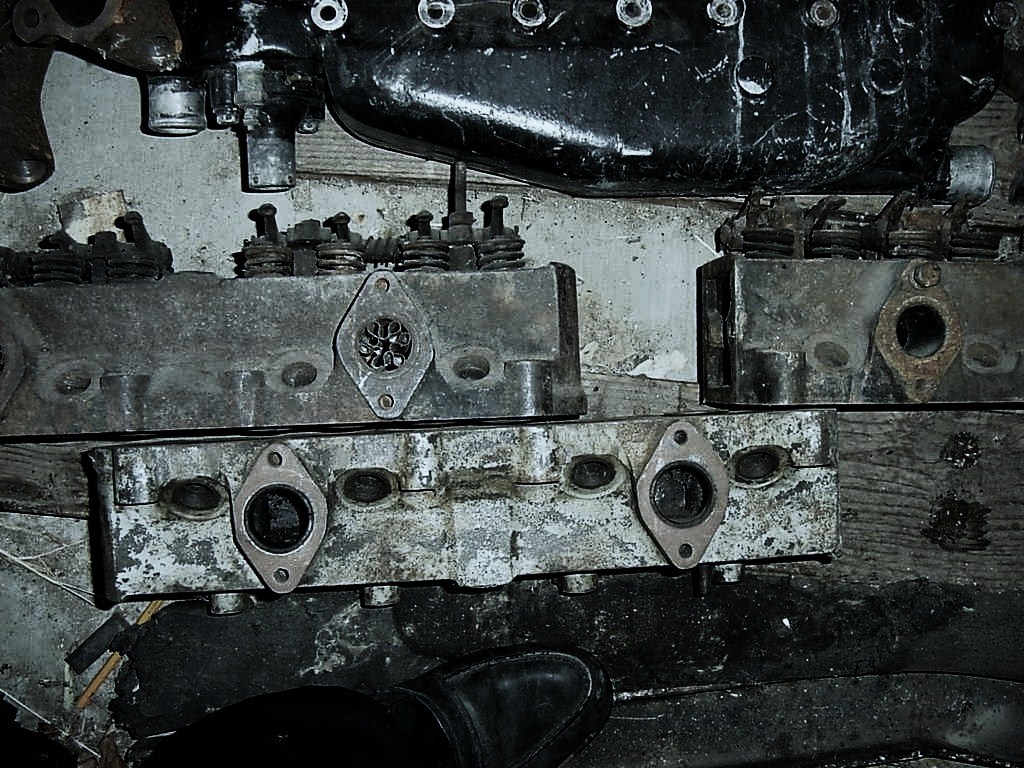

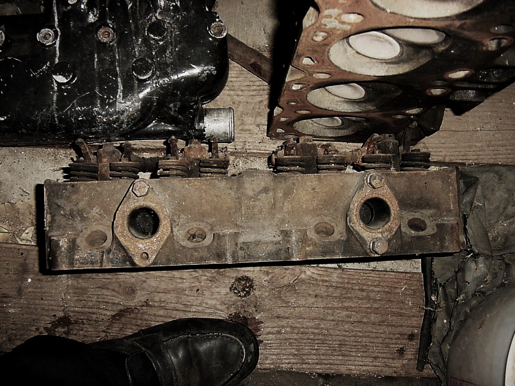

  16. dawford
    Joined: Apr 25, 2010
    Posts: 498
    dawford
    Mac,
    I have 5 early Chevrolet heads 4 2 port and 1 port exhaust and they all had corrugated metal inserts inside metal tubes inserted into the intake ports.
    I have removed both inserts from one of the heads and found that each intake port opens up into a large area around the valves.
    It seems that there is a smooth curve inside the port that opens up toward each valve.
    I haven't cut into the casting of one to see how much cast iron there is around each port but I think that they could be taken out to 1.60" without hitting the water jacket.
    I went out and measured the intake ports and found that the metal insert port measures 1.20", the port without the insert measures 1.31" and if the port were relieved out to the indentation where the insert flange seated they would measure the 1.60" previously mentioned.
    I believe that the inserts were put in to heat the intake mixture to help vaporize it for better combustion.
    When I use one of them I think that I will build an intake manifold that incorporates a Hot water jacket to serve that purpose.
    Below are some pictures of three of the heads.
    Dick :) :) :)
  17. Dick,
    I'll have to take another look at the intake without the ports- if I remember correctly, I felt arounf inside the head after the tubing was removed and found it rather "cavernous" and not particularly good for flow, but there's no reason someone couldn't use larger tubing (maybe even with a bend)?
    Also, check your earlier heads- the single exhaust heads are prone to cracking.

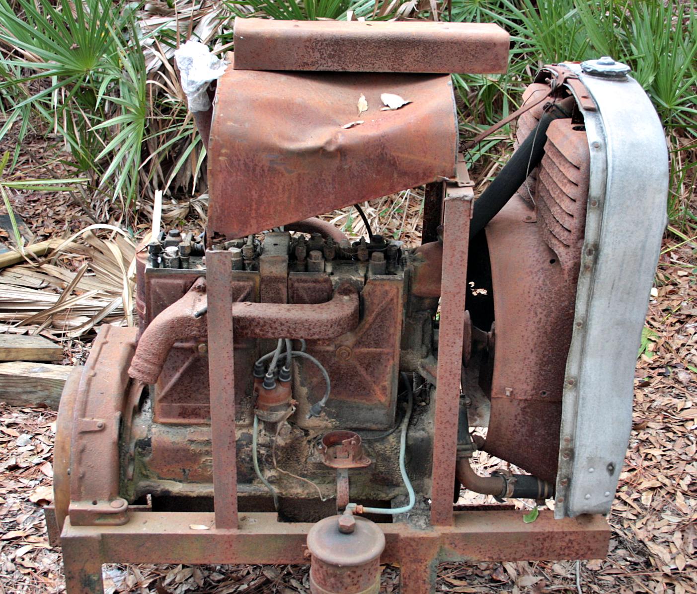

  29. CDM
    Joined: Oct 24, 2010
    Posts: 39
    CDM
    Scored this one on eBay. The owner said it was the third time he had listed it but nobody wanted it. I think because of all the heavy metal around it. Normal shipping would be a fortune. Anyway I found it a cheap ride from NY to FLA so it's now in the Swamp.
    The claim was that it was running a generator up until about 5 years ago when it was retired to storage. I pulled the head yesterday and it looks good. Will see what the magic magnetic powder shows but don't anticipate any problems.
    Always wanted to do a vintage four cyl roadster and this should be the ticket.
    volvobrynk likes this.
  30. ebtm3
    Joined: May 23, 2007
    Posts: 837
    ebtm3
    YeGods---It has the fan shroud for the radiator!!!
    Only used on the '28's because the engine was so far from the radiator--because the engine bay was designed to take a six.
    Rare Rare RARE! never repoped and the only one that I ever saw that was not on a restored car. Surprised that it wasn't snapped up by someone just for that.
    Herb
