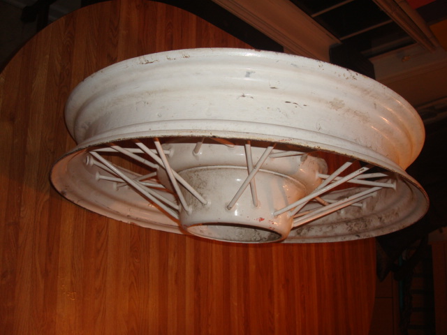

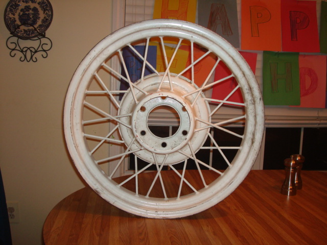

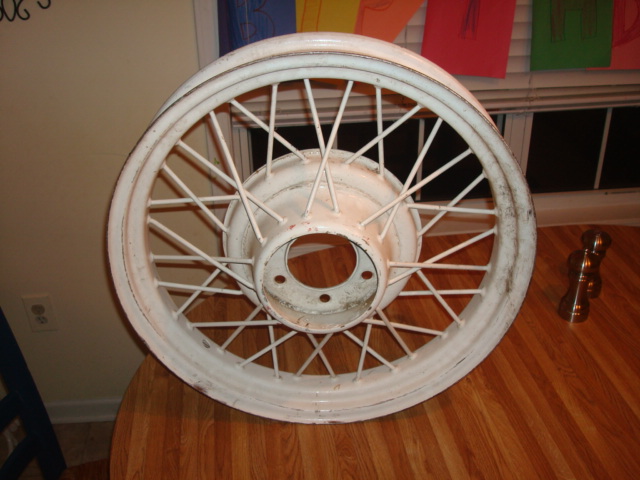

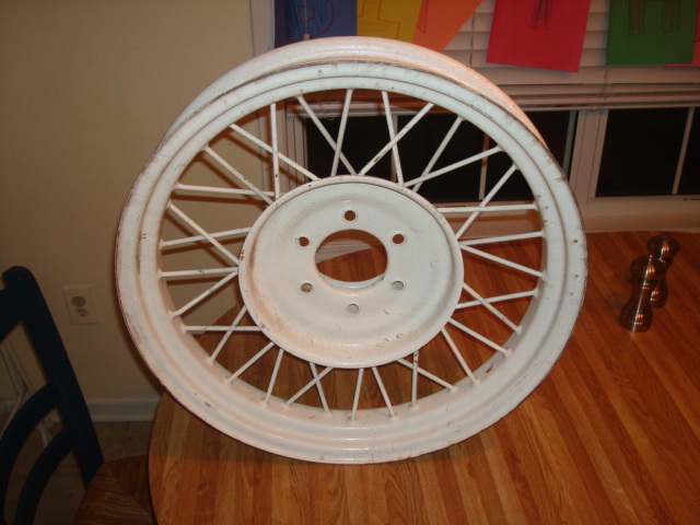

  4. Sorry again for the delay- here are some pics of the wheels:

  5. Six Ball
    Joined: Oct 8, 2007
    Posts: 6,742
    Six Ball
    from Nevada
    I have a pedal question. If any of you are using the stock pedal mount of of the bell housing how do you like it. Does it move around a lot? Is it pretty solid? It looks like an easy solution.
    Mac, thanks for the wheel pics. Very nice.
  6. The mount is pretty solid, Six Ball- do you have a bellhousing?

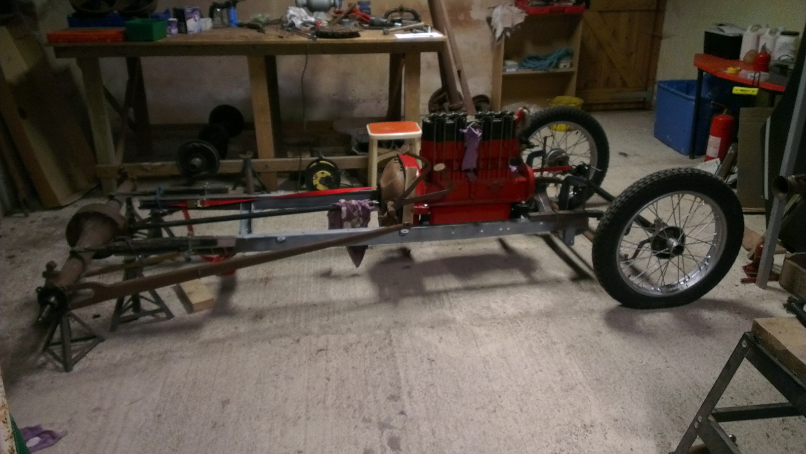

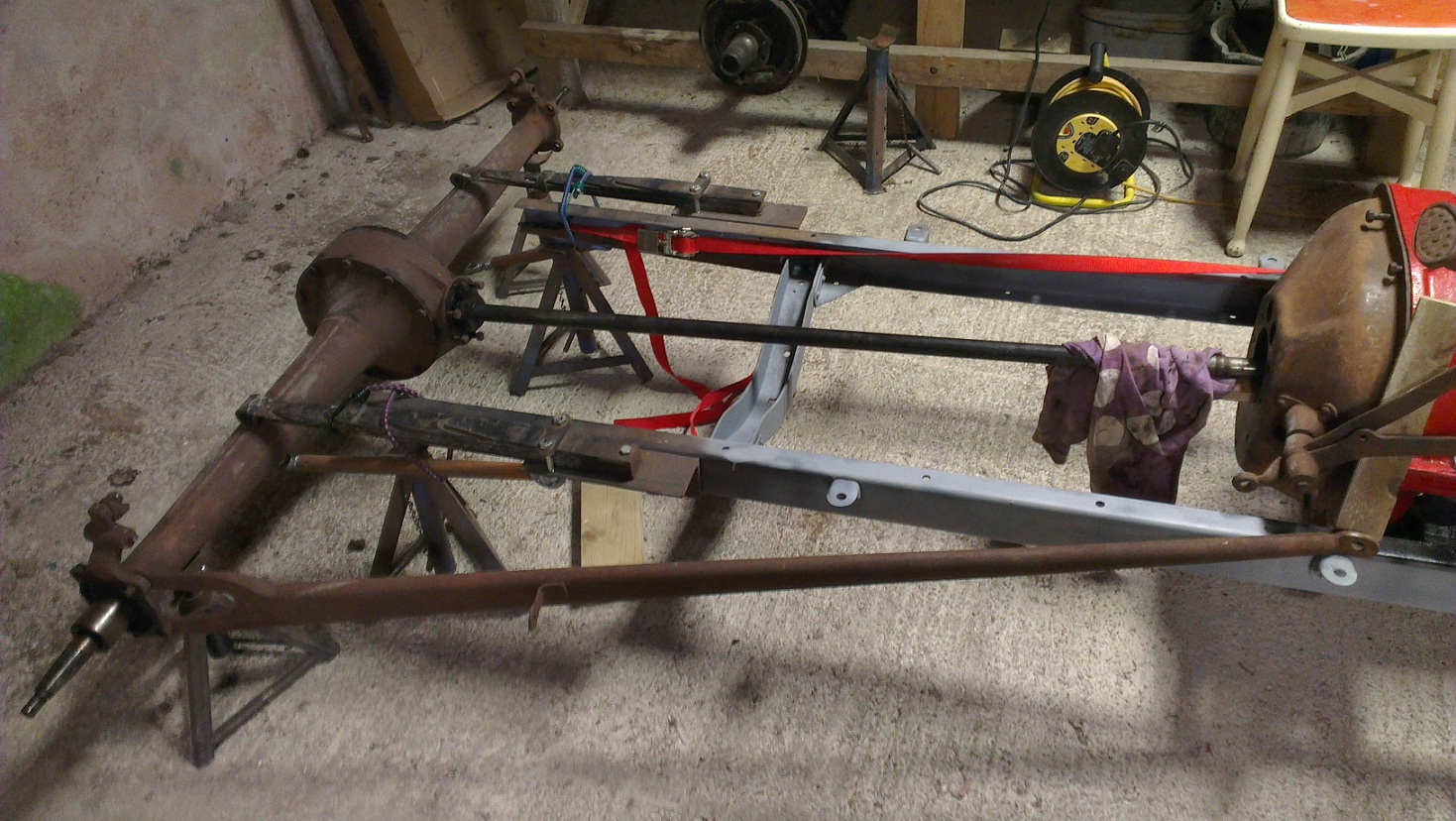

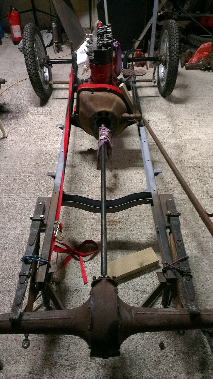

    Fantastic thread! I am based in the UK and am building a two seat trials/hill climb/fun car with a 1928 Chevy engine, so am learning lots from you guys!
    I have several questions:
    1 - I have a fibre gear on the cam shaft. Does anyone sell metal ones or will I need to make one?
    2 - I currently have a 1927 (single exhaust port) head on the engine. I have a couple of 1928 (two exhaust port) heads and was thinking of swapping them over. Is the cam the same for the two heads? The cam I have seems to be badly worn, so I will get it built back up in time, but I want to get the engine running first.
    3 - Are there any modern valves that will fit a 1928 (two exhaust port) head which I can buy off the shelf, i.e. modern ones?
    4 - I have water pump but would like another one as the impellar I have has been repaired. Any ideas where I can get one?
    5 - The water pump I have does not have a pulley and fan on it. I have the spec. for the pulley/fan, but if I can buy an original it would be a bit easier than fabricating one. Any ideas where I can get one please?
    It is almost impossible to buy Chevy bits in the UK, Ford (if i'm allowed to say that word on here) parts are fine, but not Chevy bits, so any companies in the US which sell '28 chevy bits you guys know of would be great!
    Thanks all
    Ben

    Welcome to the forum!!--send us some photos of your car as it is being built.
    Ok--Here we go-
    First off--as good a source as any for good used parts is http://www.20schevyparts.com/ Gary Wallace (std disclaimer)
    1--Use a '27 or earlier cast iron cam gear. '28 cam has different journal diameters than earlier cams, but as I recall the diameter where the gear presses on is the same--even if it isn't you could get your cam turned down to fit. IT MUST be a tight press fit, or the cam will develop end play and cause a noise that you will go crazy trying to pin down. '28 lifters are different diameter also.
    2-- Use the '28 head--larger valves, and 1 1/2-1 rockers VS 1-1. about 5 more HP
    3--Gary Wallace sells modern valves
    4&5--again, If you cant find someone here that can help with these parts, contact Wallace
    If you decide to go with pressure oiling, look back in the pages of this Topic--somewhere back there are the details of what I did to the engine in the car shown in my avatar.
    If you stay below about 2800 RPM, the stock oiling will work just fine. Cut your flywheel down until it is just a disk with a ring gear for the starter (like a modern one) and use a 9" diaphragm clutch --I used one from a B18 Volvo, and a disc that fits the Chevy spline--or use a modern 4 speed. A light wheel, and a synchro 4 (or 5) speed will make all the difference in the world in the drivabliity of the car. Biggest improvement you can make. If you have the crank out of the engine, have a machine shop put hardened "dowel" pins between each of the bolts that hold the flywheel to the crank. Until that time, use modern high tensile bolts there, and toque them.
    Herb Kephart

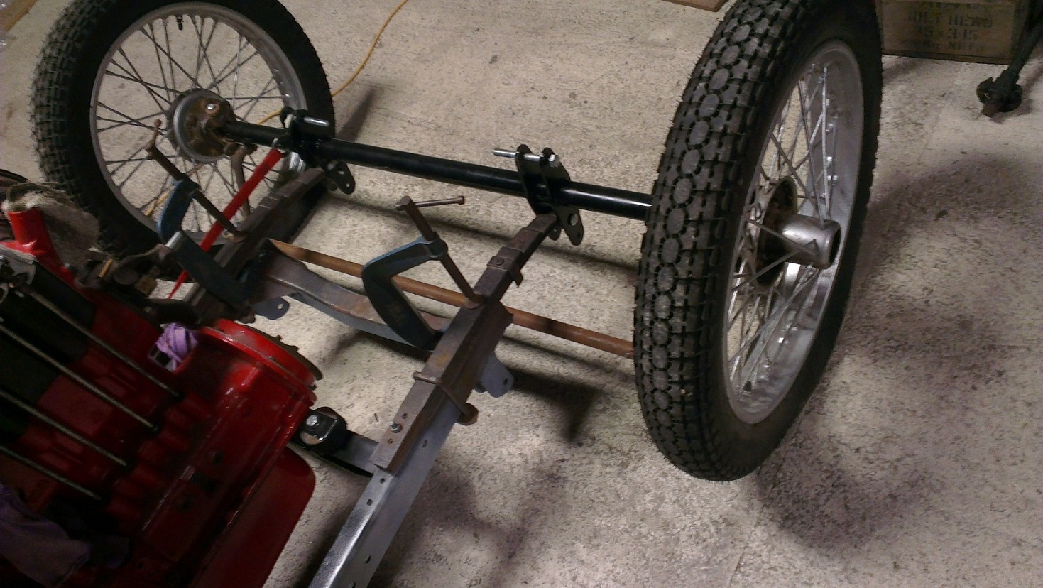

    Attached (hopefully) are some pictures of the car so far.
    Thanks again!
    Ben
    volvobrynk likes this.
  20. ebtm3
    Joined: May 23, 2007
    Posts: 837
    ebtm3
    Ben--
    Thanks for posting the pictures of your car!
    1 "Is the '27 cam the same as the '28 cam, apart from the fibre/metal gear? I guess my current setup is a '28 cam with a '27 head, hopefully that won't cause too many problems."
    I will have to do some research on this, as I have never used a stock cam. I previously wrote that the journals on the '28 are larger diameter, but this is incorrect.
    Will post more on this tomorrow evening, hopefully.
    "Will I really only get 2800rpm with the stock oiling? I was hoping to get a bit more than that. I will re-read the bits on pressure feeding, it does seem like a lot of work! I was wondering about putting in a Model A Ford balanced crank and pressure feeding that, but it will soon become unbalanced if I have to shave bits off to make it fit the crank case."
    Thought that you were building a road car, but from the looks of your chassis, it seems to be more of a hill climb car. Considering that, you can rev the engine more, as you are not particularly looking for longevity. With the '27 head, and it's restrictive single exhaust port, small valves and low valve lift, the engine will probably self limit the RPM's. I would hazard a guess that the first thing to let go if you rev too high for too long will be the rods--either the babbit will fail, or the rod will break (lousy design and material) Use Ford A rods-- they are an eighth of an inch longer (helps compression), don't have the pinch bolt wrist pin, and are vanadium steel, compared to the Chevy's plain carbon steel. Big end diameter is the same, wrist pin is larger, but rod can be bushed down.
    When you say a Model A balanced crank--are you talking counterbalances? The stock A crank has none, although they can be cut from plate and welded on. I did this with a stock Chevy crank
    which I also drilled for pressure oil. I would STRONGLY urge you to have ANY crank and flywheel dynamically balanced after any modification. I machined up rod and main bearings from soft aluminum--I have done this on Ford A and B engines in the past successfully--but shortly after I started using the crank in the photo, I found that the journals were getting scored--even with a full flow oil filter--because the Chevy crank was softer than the Ford ones. I had to pull the engine, take out the crank and have the journals welded up with the material that they weld diesel truck cranks with.
    "I was also thinking of tapping into the current oil pipes coming out of the oil pump and diverting some of the oil to the oil baths above the main bearings to make sure they are always full of oil. I know it is nothing like pressure feeding them, but it has to be better than relying on oil mist and condensing oil running down the walls of the crank case into the main bearing oil wells. This is providing the con rod big ends still get enough lubrication."
    DO NOT DO THIS WITH THE STOCK OIL PUMP. The mains get plenty of oil for a stock engine, primitive as the system is. The stock oil pump is a pathetic thing, and barely pumps enough to keep the rods happy. If converting to pressure, use a late 50's Chevy 6 oil pump.
    "I was thinking of turning down the flywheel (I hurt my back moving a block and flywheel last time!), but is that advisable with an unbalanced crank?"
    Again, assuming you mean un-counterbalanced, I would say definitely yes. Some of the circle track race car builders before WW2 preferred the non-counterbalanced B shaft over the CB'ed one, because, being lighter with less rotating mass the engine would rev quicker coming out of a corner--about the only way that they could stay ahead of the Offenhausers
    "Clutch - the disk to fit the Chevy splines, how easy is it to retrofit that to a new Volvo B18 clutch plate? The pictures I looked at of the clutch look as though it is pressed steel."
    Later 6 cylinder Chevy disks should fit the Chev 4 spline, although they might be too large in diameter for the Volvo pressure plate, in which case use a pressure plate that matches the later disk. Drill the lightened flywheel to suit whatever pressure plate you end up with and have the flywheel balanced WITH the pressure plate installed
    Hope that this is of some help, and if other questions arise, feel free to ask.
    Herb

    Just a comment on 5/6 lug wheels. I bought a Cobbled together utility trailer with a '27 -'28 Chev axle with 16" wire wheels and 7.50 x 16 tires. Took it apart and found that it had 5 lug wheels on it. Checking further I found the wheels were Ford and so were the hubs/drums. Looked like they had been on the trailer at least 20 years and looked like a direct fit. Norm

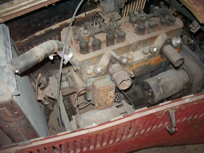

    I finally was able to bring home my other '28 engine today. I'll try to post pictures tomorrow.
  29. From the missing louvers in the hood sides, it looks like someone put it back together wrong. How close are the flanges from Intake to exhaust? Do they say it runs as is?
