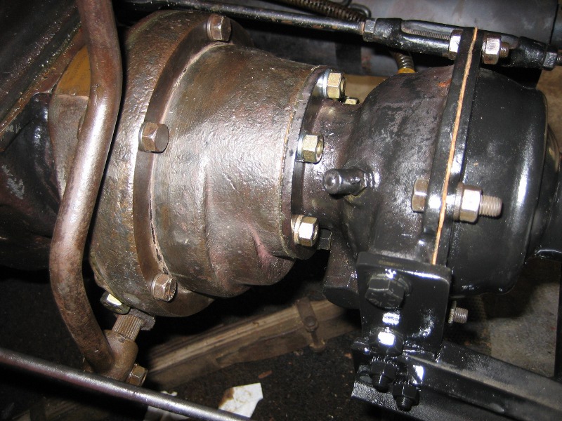

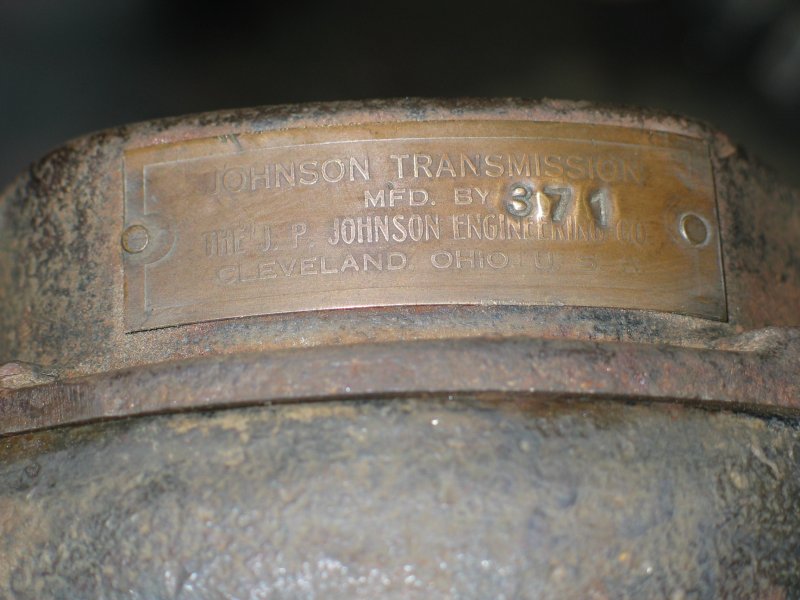

    Johnson overdrive
    does anyone have info on the Johnson overdrive.
    appears to be a good fit for chev 4 and apparently someone was reproducing them in recent times.

    Anyone have a drawing or a photo of the guts of the Johnson?

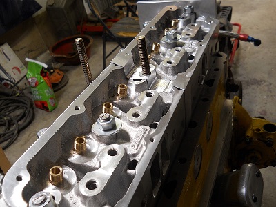

    How do you find that vertex magneto on your A motor
  21. Six Ball
    Joined: Oct 8, 2007
    Posts: 6,692
    Six Ball
    from Nevada
    Are you going to put that head on your A?
  22. No problem! i can whait a few more days :) hehe
    Found it at facebook :) got it in the mail a few weeks later ;) costed me about 300$
    yes, yes i am! :)

    That is real hot roddin'. I was looking into putting a Studebaker V8 head on a Model A. It would be easier if I could find one of the after market aluminum Stude heads.
  24. RichFox
    Joined: Dec 3, 2006
    Posts: 10,020
    RichFox
    What makes you want to put a Stude head on an A block? Will you need to split it to aline the bores with the combustion chambers?
  25. Six Ball
    Joined: Oct 8, 2007
    Posts: 6,692
    Six Ball
    from Nevada
    Yes it would have to be cut like they do with the small block heads used to make a crossflow head for Chevy sixes. Valve spacing is right and in the right order. Some deck work would have to be done. I was thinking about it a couple of years ago when there was a very soft Bonnevelle record in one of the vintage 4 classes. Someone took care of that for me so I'm back in the couch potato mode.:rolleyes:

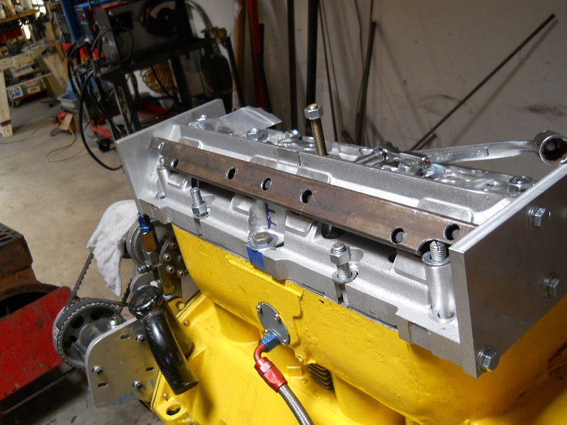

    318 head going on a 26 Dodge Bros. You can kinda see the 1.5 inch spacer in the center.

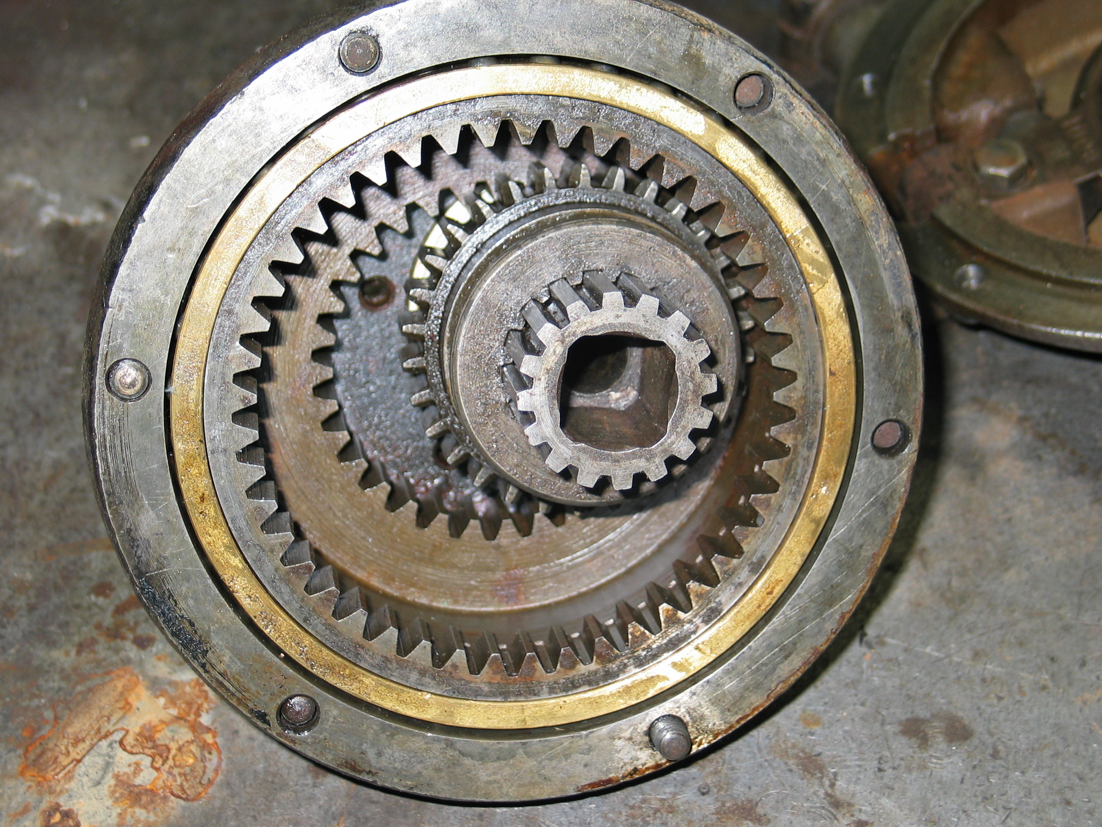

    I do. The pictures above look familiar. They're mine. :)
    Wish I could find someone to reproduce this overdrive in the $1500-2000 range for the good of the Chevy community. The stumbling block always seems to be that small gear with the semi-blind square hole. From what I can tell, it was originally made with a Watts Bros. drill but nobody seems to know what that is. They want to use an EDM sinker.
