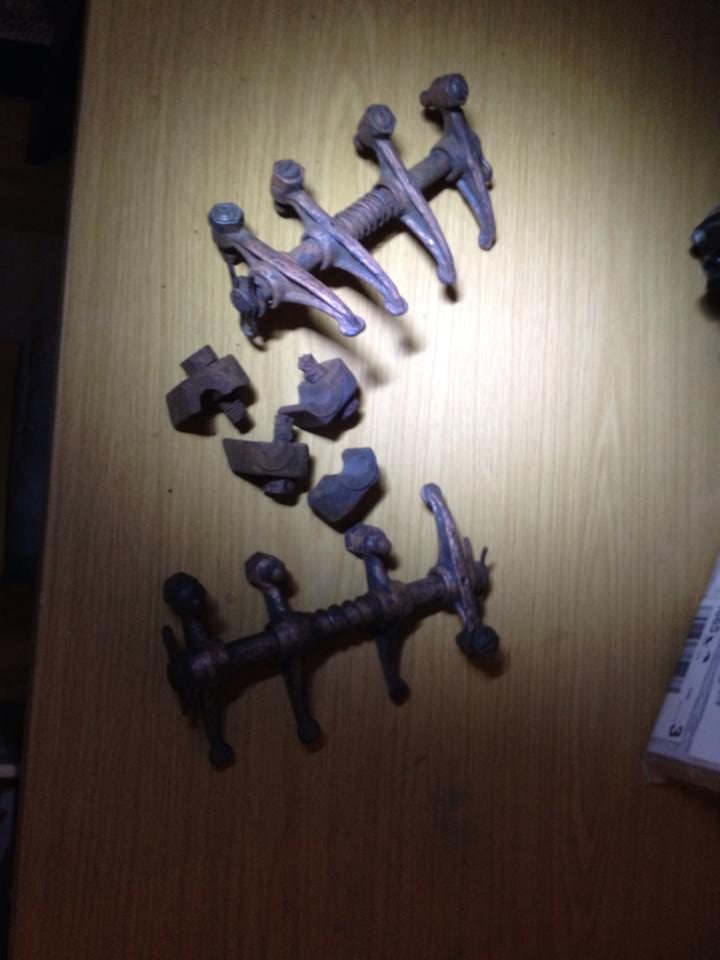

  27. Lovley old junk! :) 10357834_777858588944262_3196188431729672851_n.jpg
    Outback likes this.
