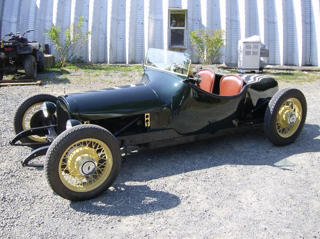

  7. It has a T5 so is likely running a 6 stud Jap pickup diff allowing the rear springs to attach to the side of the chassis rails, the rear spring shackles are inverted so that would drop the rear 5-6".
    Front axle looks to be mounted above springs.

    looks like a later front axle too . deeper drop. not a big fan of some of the details that could have been done easily period correct . the grab bar and foam pipe insulation for instance. just an opinion tho. nice car all and all ,,....and well designed body that looks like its era.

    I wish there was a better picture of the front axle mount. I am thinking of putting my axle on top of the springs. That doesn't leave a lot of room between the axle and frame. The guy told me that he thinks the front wheels are 18" and be rears are 19". The boat tail looks like a hood from a K model International. But I like it.

    Yes the axle over spring is not the best solution - out-rigging the springs gives more travel. The left hand shackle bolt on the rear looks like it is struggling. The multiple curves on that scuttle looks dodge or maybe 490 chev?

    that's a stock 28 front cross . I think he moved the axle forward just enough and he has also cut the bottom out of the cross for the rad . I did the same modification on mine to drop the rad and the axle I am using has a wave in the front to avoid the lowest part of the cross member . I think the first thing to bottom out would be the turned down flange on the bottom of the frame. mine hasn't been on the road yet but this set up makes me think I will be just fine. $_57.jpg

    Yeah, The cowl looks like the one on Lee Chapel's '24 Chevy on page 90 in The American Hot Rod. Jimmy B has posted it here somewhere. It's sure got me thinking about my '26 again. If it could only get me moving.:rolleyes:

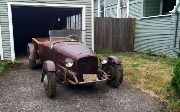

    This went up for auction at Southerby,s in January. Built in 1951 - has some interesting motor mods AZ15_r150_002-700x388.jpg AZ15_r150_003-700x467.jpg AZ15_r150_004-700x467.jpg AZ15_r150_015-700x467.jpg AZ15_r150_017-700x467.jpg

    Out of all the home made wood box vehicles I've seen , this one appeals to me the most.

    There is something really cool about it. Ride height, proportion, and some detail. Some not so much, but I'm glad it survived.

    I agree. those front guards don't do it any favours. I wouldn't mind the spare olds head sitting in the tray. AZ15_r150_001-700x465.jpg Barbecue-Stove-Bolt.jpg The-Barbecue-Stove-Bolt-600x375.jpg

    Great! I wonder what's inside. Even original (?) bricks in the back!

  30. The header is nicely built- and pretty good-sized diameter as well- wonder if the original owner/builder did some porting :)?
    Also didn't notice the Harry Miller tag on the valve cover- anyone know if it's legit?
