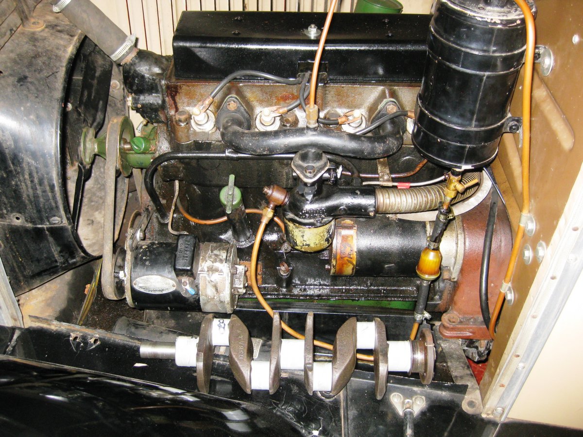

    Being a recent new owner of a '28 Phaeton I've also read this fantastic thread end-to-end.
    It's an interesting idea to search for a European crank to fit in one of these motors, especially for those of us who live in Europe where there aren't the remains Chevy fours and the like just lurking in hedgerows!
    The picture should show an A series crank (refugee from another project) in front of my '28 Chevy motor, it is counterweighted. but unfortunately is way too short end to end to fit in the C4. Even the three bearing B series BMC cranks -MGA early MGB etc. would still be too short I think. The crank from an Austin A90 Atlantic and Austin Healey 100-4 (same motor) might fit though; the problem is (at least in the UK) the're not common anymore either.
    My Phaeton is completely stock at the moment. Based on the really useful information contained in this thread, I will be doing a few modifications to increase the usability/drivability of this fine car.

    Okay, it was just a case of me thinking out of the box. How much to short? and of someone can help doing some measuring of a Chevy 4 aposed to the BMC. Becaused it cant be more rare, or less complicated, then counterweigth the "C" crank with a balacing and everything.
    But could it be elongated between the counterweigth, and just presuricing all the mains and make them lube the the throws. Aposed to run oil all the way true the crank.
    Again this is just me thinking outside the box to give the really skilled people some idear

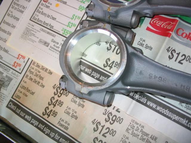

    If you are buying special rods from Crower or somebody like them. They cost a lot. My Chevy uses modified model A rods. My counterweights are welded to the stock crank. It sounds like adapting a more modern European crank would be a bigger can of worms than the way it's always been done. Good idea if you can make it work.

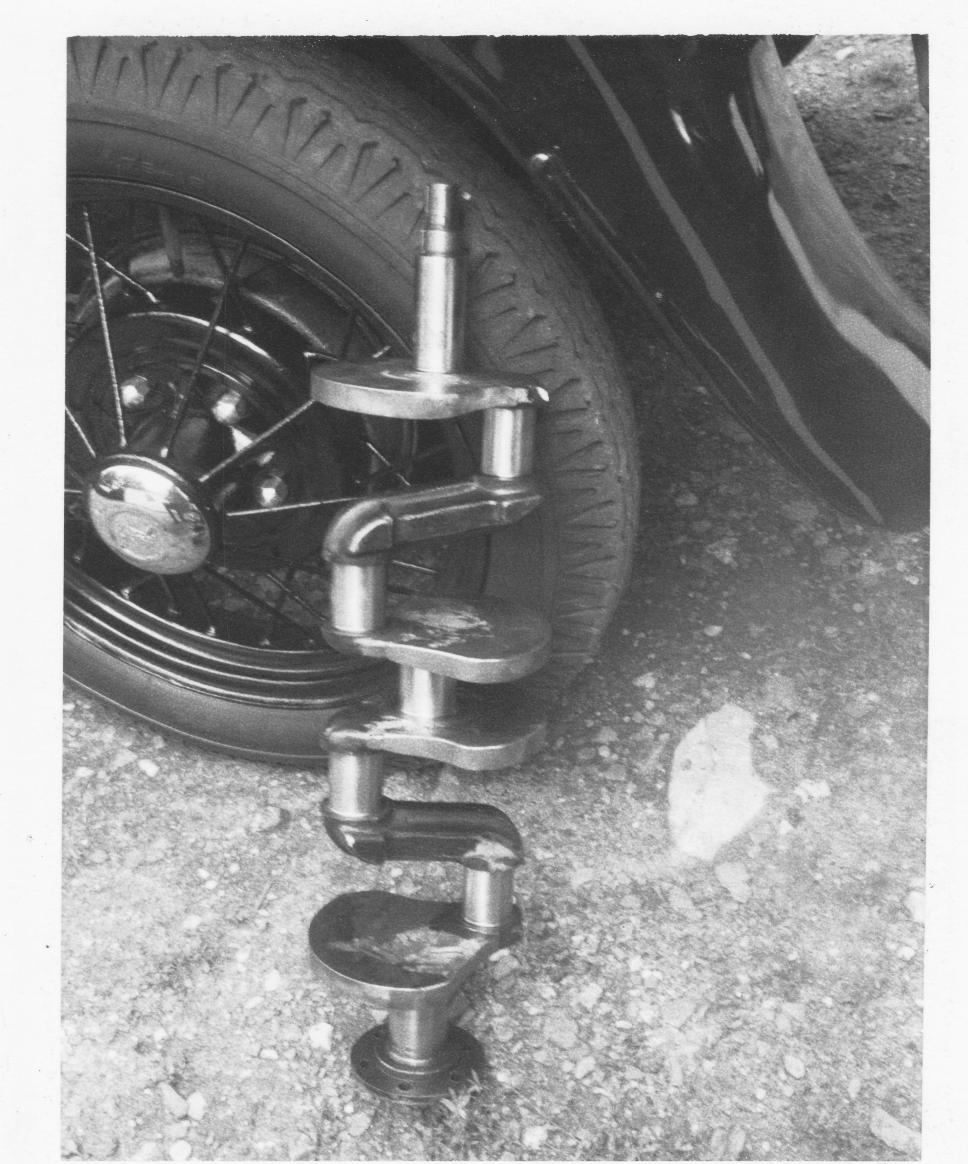

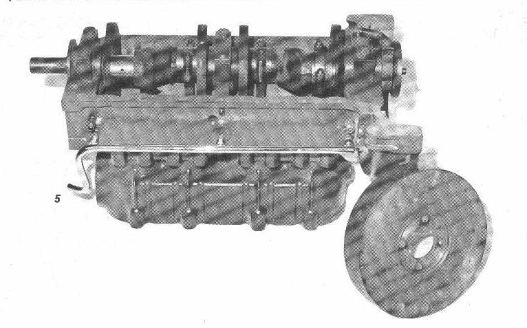

    Bill I looked into this back when I started messing with C4's and there were enough things to make it look like welding c'weights on the the stock crank--as Rich said---was the way to go--so that's what I did. Don't ask what all the problem points are- I don't remember. I don't remember what I had for breakfast.

    OK. As I measure it. Bore centers on 1-2 and 3-4 is 4 inches. Between two and three 5 1/4 inches. I don't think you will find anything built after 1955 with centers like that. CNC dude. You make Wayne heads?

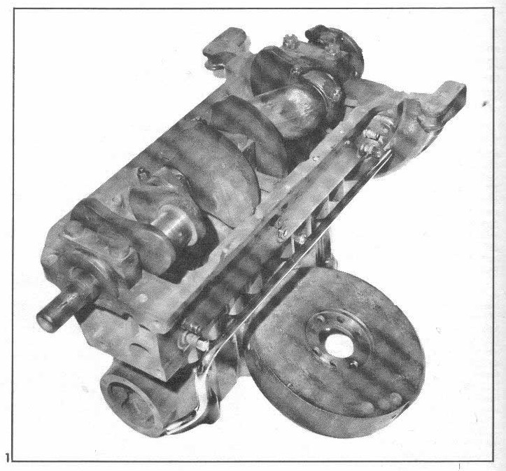

    Now if you want to see how a 1926 crank should look, check this out. Dodge Bros. You can clearly see the difference between 1=2 and 3=4 compared to 2-3. Dodge saw the error of their ways and added two more mains in 26. Didn't have room to make them s wide as the others. mains.jpg 001.JPG

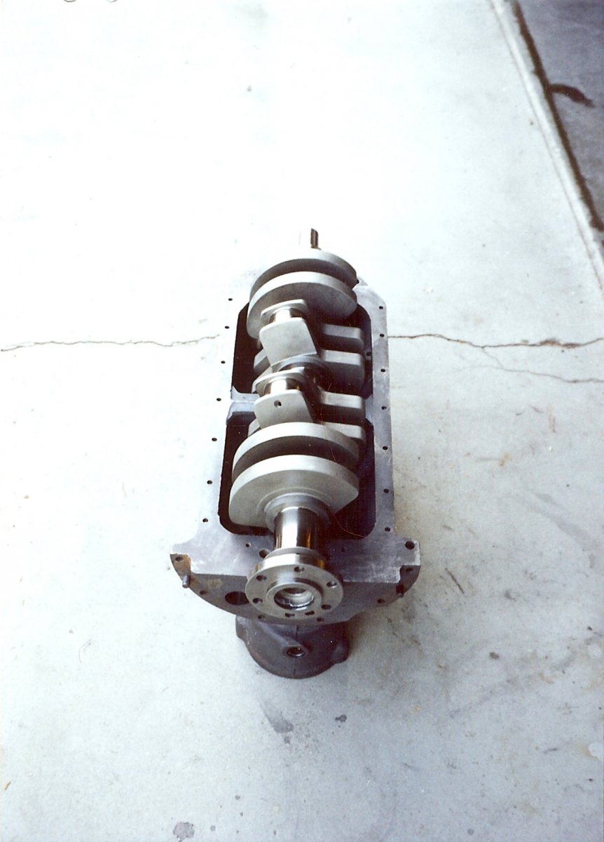

  24. Here is the billet 5 main crank Curt Giovanine had Scat crankshafts make. It is possible and has been done.

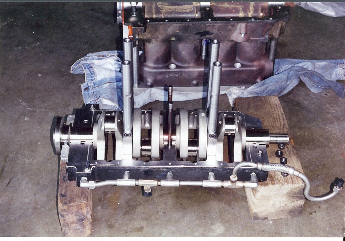

  28. The German 4 banger would be the closes thing in Europe to what the guys in the US were using in the 30s and 40s. They are rare and $$ but an avenue to explore.
    Ford cranks do fit the Chevy block with mods, the block mains need to be line bored to the Ford dimensions the mains bolt holes need to be filled and tapped out further or do like they did in the 40s and fill the bolt holes and drill thru to the flat area between 2 & 3 cylinder (I will find a pic to illustrate).
    No 2 & 3 rods needs around 1/4 cut off one side and welded to the other side to centre the rod in the bore. The block needs to be notched/relieved where the rods rotate, that is basically what they did. You have to remember these engines were pumping out 110-150hp in that period the Chevy crank was too weak to handle that kinda power anything under 90hp would likely be ok to build a counterbalanced Chev crank.
