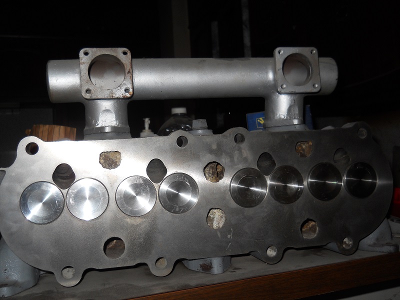

    M&B Dodge Bros..jpg chevy 003.JPG This is the intake that came with the Olds head on my 28 Chevy. It's steel and pretty heavy for a race car. I know it's upside down for the picture. The yellow stuff is my take on mechanical FI. Throttle bodies are available cheap. Sealed ball bearings on the shaft. Many sizes on different cars and bikes. You might cast up the rest of it.
    Jimmy B likes this.
  22. CNC-Dude
    Joined: Nov 23, 2007
    Posts: 1,040
    CNC-Dude
    Thanks Rich, I think this will give a lot of guys some different options to toy around with. I also wouldn't be opposed to casting some one off intakes either. This is a pretty simple engine and design, so it wouldn't be hard to create several different patterns.
  24. CNC-Dude
    Posts: 1,040
    CNC-Dude
    That's a great pic! What size TB's are they.That setup is still mechanical FI with the TB's being used as basic air valves, correct.
  25. RichFox
    Joined: Dec 3, 2006
    Posts: 10,020
    RichFox
    They are off of a 4.6 SOHC Ford engine and are about 2.550 Diameter. But there are several sizes and types. Yes I am just using them as air valves. You can see where I put the Hilborn fuel nozzles in the above pic. Here is yet another I did using Suzuki 750 TBs.
