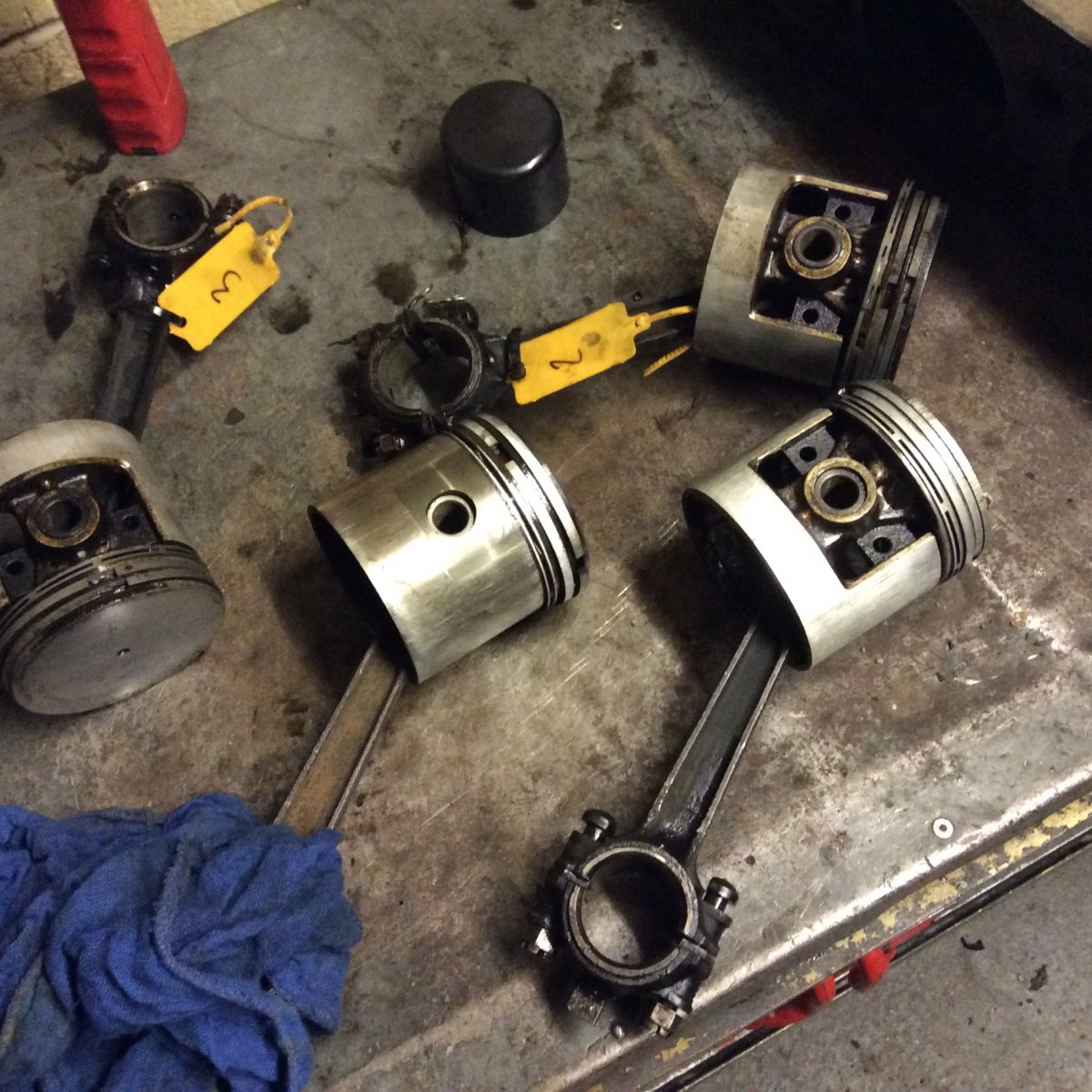

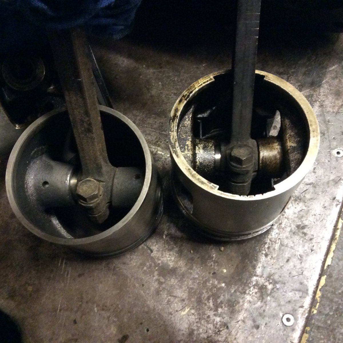

  7. Andrew Mccann
    Joined: Aug 2, 2016
    Posts: 257
    Andrew Mccann
    from Bristol UK
    I have a question if anyone can help?
    Trying to ID my Pistons.
    The matching 3 measure 3.72"
    The odd one measures 3.68. Someone seems to have lost concentration while rebuilding....
    I would like to try and find a matching one if its possible?
    Thanks in advance. Andy

  8. ebtm3
    Joined: May 23, 2007
    Posts: 837
    ebtm3
    Andy
    The three larger ones with cut-away skirts look like .040 over 1928 pistons--the only year that Chevy used aluminum pistons in the fours.
    The oddball one is a std size. Hard to tell from the pix if it is cast iron, or aluminum-- but it looks to me like someone threw together that engine with whatever stuff that they had around, just to get rid of it. IF it ran---and that's a big IF--it would make one heck of a racket. oil the plug in that cylinder (I'm assuming that all the cylinders are bored .040 over) and burn oil like the devil. Best option is to check the cylinder sizes, give them a light hone and find another +'040 stock '28 type aluminum piston. Match the weights of all the pistons in the set to as close as you have means to measure, removing metal from the heaviest by shortening the skirt or removing metal from the inside. You might have more luck finding a used set of cast iron ones, they tend to not wear as much as the aluminum ones, but still match the weights. Last resort is a set of new ones--expensive, and the last time I checked, Egge, the most prolific US manufacturer's cast aluminum piston were as heavy as cast iron ones.
    Any more questions, don't be bashful.
    Herb
  9. Andrew Mccann
    Joined: Aug 2, 2016
    Posts: 257
    Andrew Mccann
    from Bristol UK
    Pulled the last piston and it seems to be a tad oversize....
    Thanks Herb. Yes the odd one is ally. I've been thinking about Kumes thoughts, re boring for Model A Pistons. Really because they are readily available and cheap in the UK.
    But I can't remember reading in this thread weather anyone has gone that far with the cylinders. Is it pushing it too far? 261 Pistons are much more expensive and all the stock is over your side which adds more to the bill.
    I'm not planning on over stressing the engine. Could A rods and Pistons be the way to go?
    Apologies if the piston thing has been done to death on this thread.....
    Andy[​IMG]
  10. Kume
    Joined: Jan 23, 2010
    Posts: 997
    Kume
    The filling station sell sets for $260 US. Herb do you think they are Egge pistons? Just looking at the illustration I cant imagine them being lighter than a stock 28.
    Andy I have bored out a 25 block for A pistons with no problems but I think it is a gamble as the old castings may vary in side wall thickness. One of us may have a spare 20 piston - I will check my stash.
    I remember pulling down an old 27 truck motor which was a runner (truck was used on a farm up until the 1970s for bringing in hay). I found two ali pistons and two cast iron pistons! It also had a distributor rotor made out of a piece of wood and a leather repair on the radiator. Real bush mechanic stuff, quite common down here.
