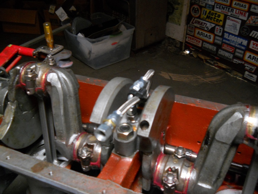

    Can we talk a little about crank counterbalancing (again)
    Is it worth it worth it for 'now and again' use engine?
    Is it worth the effort in an engine that won't have pressure oiling and won't see much action over 3000rpm?
    I get it that the real benefit will be longevity
    Herb, I know you have done this previously, is there serious mods to be done to the block. Will those mods further weaken the already weaker (by probably not much) '28 block?
    I have my motor in pieces. If I'm gonna do it I guess it's now or never.
    If so are there any rough dimensions of the weights stored in anyone's memory?
    Herb, I'm posting up your crank photo again 1 because it's relevant and 2, more people should see it ....

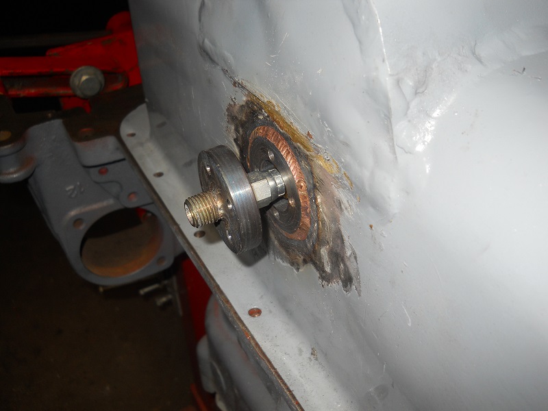

    This is going to seem a little strange. But my 28 Chevy had been modified for pressure oil in around '48. It was OK then. But by now I wanted to update it some. This is my method. It may seam strange to you. First I changer to JIC fittings and Teflon inner hose
    gas pumper likes this.
  28. RichFox
    Joined: Dec 3, 2006
    Posts: 10,020
    RichFox

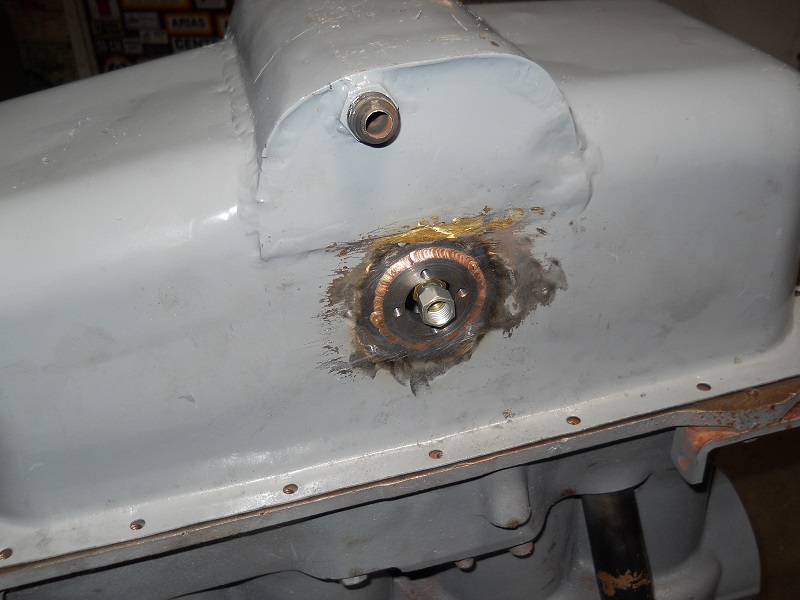

    The hose stuck out through the side of the pan. So I welded a NPT to AN fitting to a cap I made and welded the seat for the cap to the pan
    Outback and gas pumper like this.
  29. RichFox
    Joined: Dec 3, 2006
    Posts: 10,020

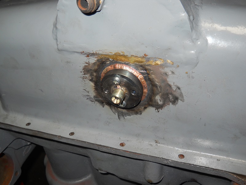

    RichFox
    Now this is OK. But you are wondering "What if the hose moves over and rubes the crank" I knew I would not be able to sleep worrying about that. So, a port hole in the other side so I could look in and verify all was as it should be. Who do you know that has a port hole in their pan? A four way fitting will be made from aluminum for the oil in side. NPT threads to screw on to the new inlet. a -8 fitting for oil in and two -4 fittings for oil to the front and rear mains. I'll tap the port hole center hole for a plug.

    Now if you stick a little camera through the port hole and put a monitor on the dash you can have true piece of mind. Those are some very nice welds by the way.
