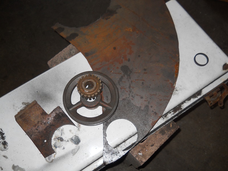

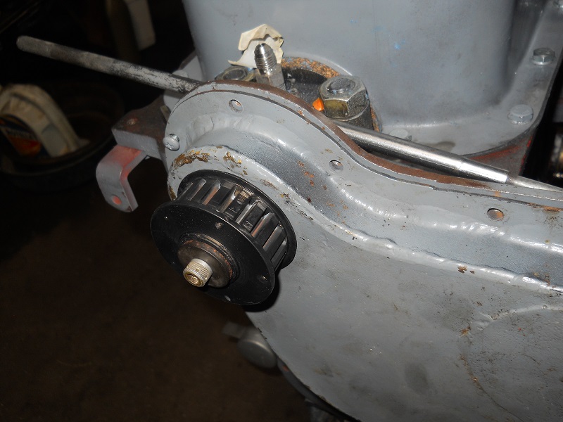

    DSCN0154.JPG DSCN0155.JPG So with all the new places to pump oil, I will need an oil pump. And a drive for the pump. I decided to go with a belt driven external pump because that is what I have used in the past. I started with the original pulley and some Gold Wing cam drive parts. Turned the pulley to 1 1/4 OD and bored the Gold Wing pulley the same. Slid them together and brazed them . I wanted some flanges to keep the belt from walking off. And neglected to notice that the Honda flanges were in with the parts I already had. So I found some s**** and cut rings from that. I brazed them to the now 1 1/4 iron shaft and drilled 5 holes in each next to the Honda teeth and brazed them there also. I used 1/6th for the rear because that's what was around and it's plenty for this. I used 1/8 for the front as I may want to drill and tap it later to install a V belt pulley to drive the water pump and maybe an alternator. Here is before (sort of) and after pictures. The Honda parts were very reasonable on the Bay.
    ebtm3 and bct like this.

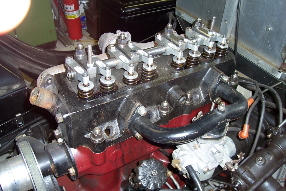

    Looking through the posts in 1349 you say you made some billet aluminium rockers . Do you happen to have a drawing kicking about . Sort of cheeky to ask but why invent a wheel when someone has already done the hard work!. Looking on the VW sites there are standard tappets or ball types available which did you end up using . I have already bought a plate of 7075 ally 1 inch thick and was going to get some waterjet cut out. I am also looking at PUSHRODS" 4140 Chromoly 3/8" x .035" Wall with some inserts in the ends
  6. ebtm3
    Joined: May 23, 2007
    Posts: 837
    ebtm3
    Hi Mosquit0-
    On something like that I am unlikely to make a drawing, just ''design'' by eye--but I will look in the archives of the cave,
    You are correct as to pushrods. Thin wall 3/8" 4130 tube/ aircooled VW ends.. as to the rockers, this pix might give yo an idea as to the shape. the channel on the top of the valve end sloped downward, to oil the center bronze bushing-- Done with a 1/2''ball ended endmill. I know that I have top and bottom views also--but can't find them. Material was 3/4 2024 alum. sorry about this duplication of part of the msg. The ''new improved'' HAMB system and I just do not get along! Herb 100_0965.JPG give you a pretty good idea as to the shape.the channel on the top of the valve end sloped downward, and exited into the bronze center bushing-- . Done with a 1/2''ball ended endmill. Sorry about the duplication of this, the ''new, improved''HAMB system and I just plain do not get along. Herb

    [Thanks Herb
    I think from the picture I should be able to work it out from here . Am I right in thinking that you have used the VW adjusters on the valve heads and the original chevy adjusters for the pushrod side.
  9. ebtm3
    Posts: 837
    ebtm3
    VW adjusters at the valve end-yes, but no valve adjusters any where else. Send us a photo when you are finished !

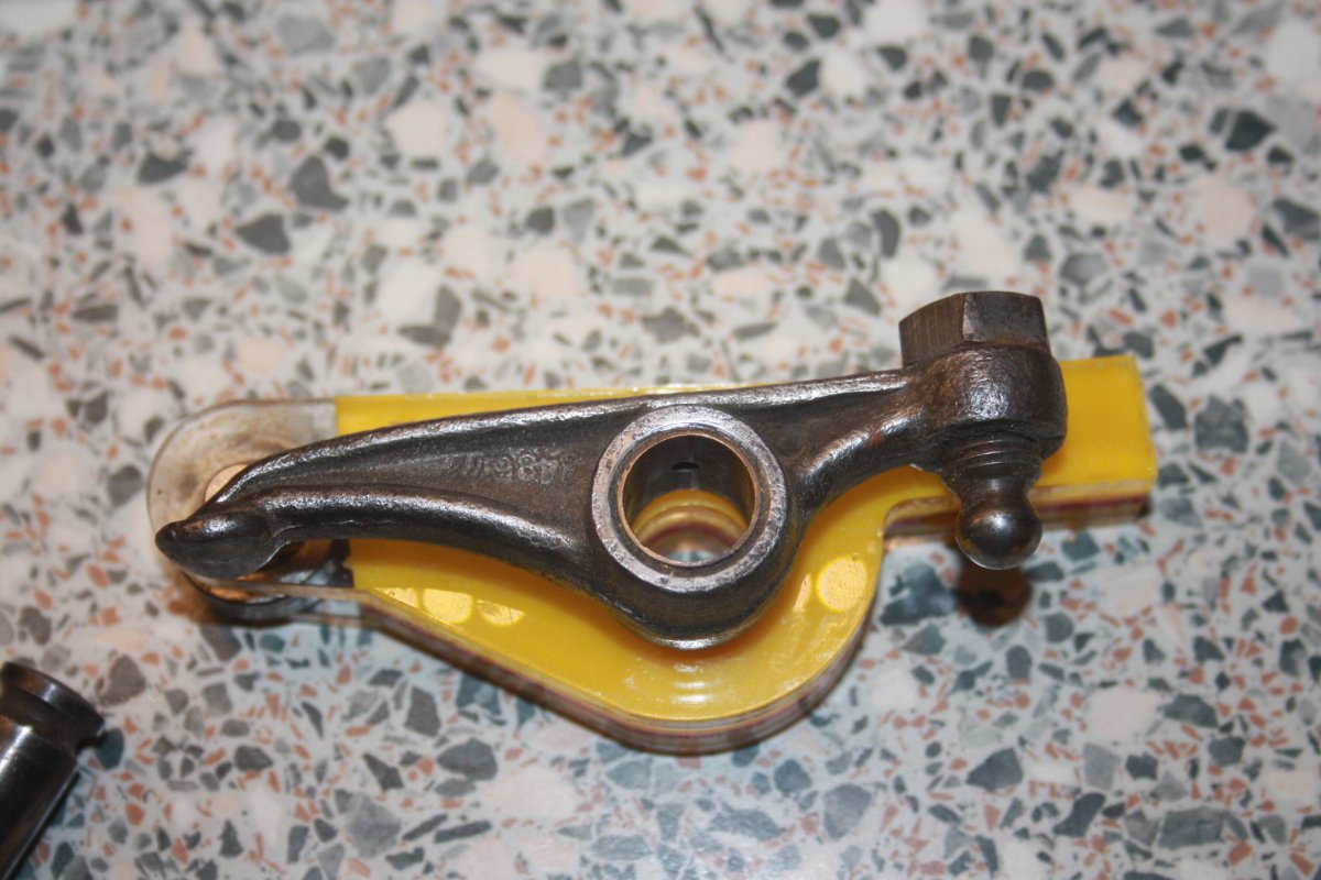

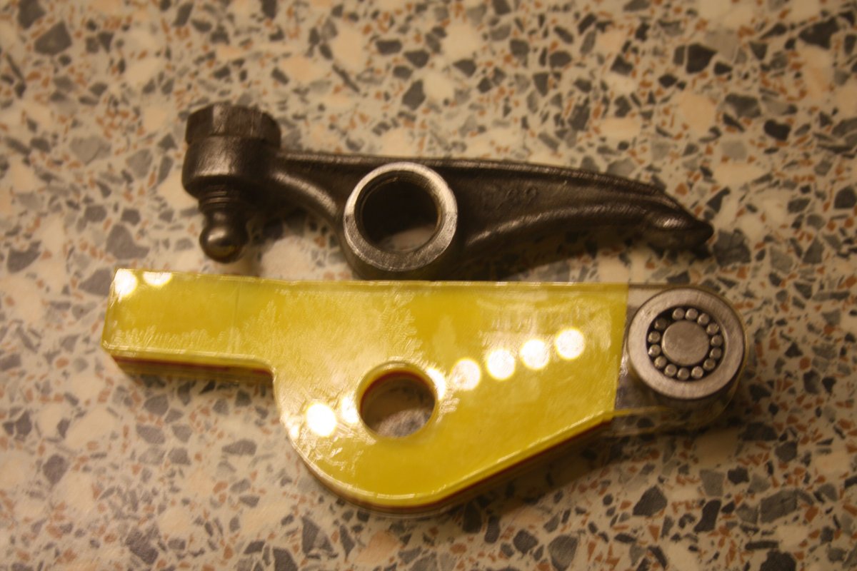

    So the current thinking might be to make a set of roller rockers . Played about with the lazer cutter and knocked up the following item in plastic. I did this some 12 months ago I bought a set of Ford transit rockers to provide the rollers. Not at all sure its worth the effort of rollers but what the hell. I have got them so do you think its worth a go?
    Alternative is to make a set much as yours.
    This is only for a moderate engine and at the moment I do not anticipate high revs.
    In a very early post you suggested NOT to pressure feed the bottom end . about 246 ish post for a moderately hopped up engine May I ask why not? Rather carelessly I have already cross drilled the crank and got a bit of the way with the oil pipes. I have yet to do the pump decision making . Suggestions appear to be a mid 50-60s chevy 6 pump Does this give enough capacity and or pressure. I am using the babbit mains and will be fitting Model a rods again babbit'd. This is all placed into a 28 block .
    I have been also looking at the idea of replacing the standard followers with a phosphor bronze bush and replacing the cam follower with a VW item. I read the idea of Model B followers but no one appears to make them , Mac sell A followers for B motors but they have the smaller head. VW do them in 30 and 31mm diameter. I will order one up and have a look see if its do-able fix. VW bits are easily obtainable over here and not expensive

    I forgot about the roller rocker question. I don't think that they are necessary on an old, low RPM build. don't forget that they make the fastest moving end of the rocker heavier, and that means more load on the cam/lifter oil film.
