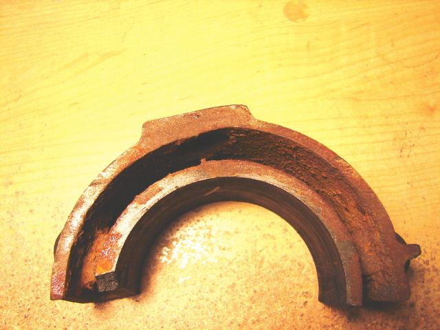

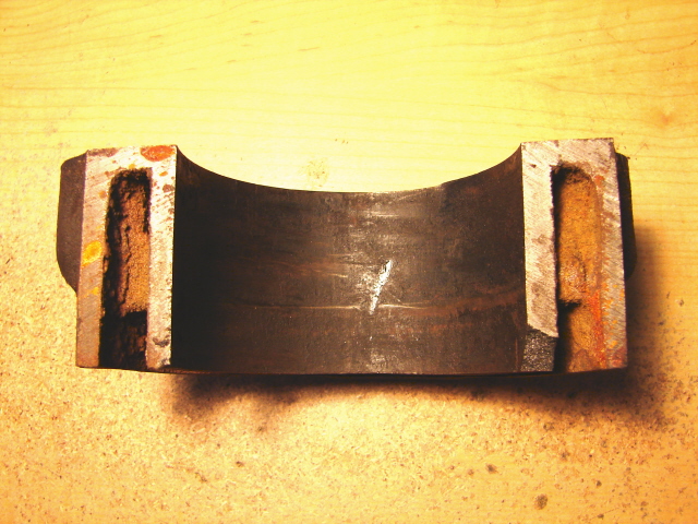

    Here is what you are contending with as far as cylinder wall thickness. Of course YOUR BLOCK MAY VARY-- and if you hit water-------
    Herb
    Egor, 282doorUK, bct and 1 other person like this.
  2. Stueeee
    Joined: Oct 21, 2015
    Posts: 312
    Stueeee
    from Kent, UK
    Herb,
    Two really useful photos there; thanks for posting. I feel much more confident of boring up for 261 Chevy pistons now. Do you have any photos of a '28 head sectioned? It would be good to know how much work I could do on the inlet valve throat 'short side radius' which looks like the biggest restriction in those ports.

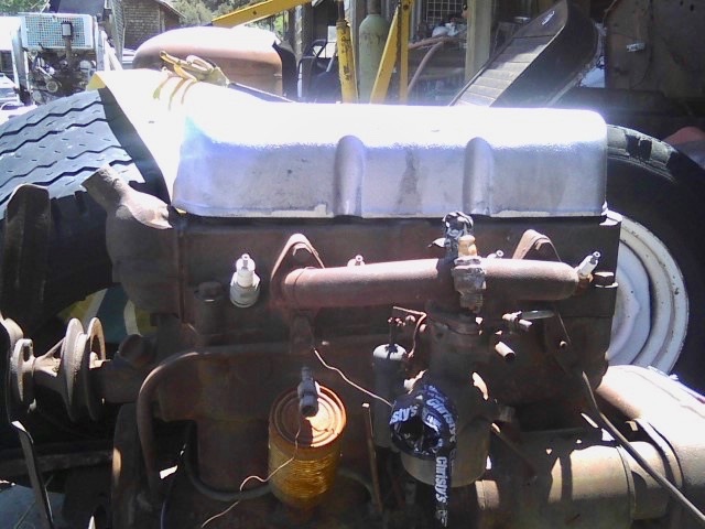

    This is an idea of how the Olds head looks with a BBC valve cover. The adapter plate will attach to the head with countersunk 8-32 screws. The plate is drilled and tapped 14/20 for the cover to bolt on. I will make a two piece side cover. The top will reach the aluminum plate and the exhaust will pass through it. If I step up I will get a thick enough piece to cut fins on the lower plate which will have a lip that helps clamp the upper cover plate

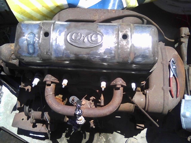

    Rich, That looks good. Here are some shots of the Fronty repo I got and a GMC I cut down. The GMC fits and looks better I think but I didn't spend enough time fitting before welding. I might try another one. They are thin and not nearly as straight as they look. The indents on the Fronty get in the way but it could work.

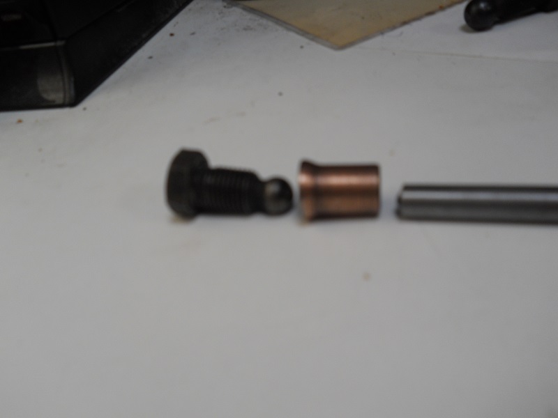

    Still fooling with the Olds head on the Chevy. It looks like I will use the Chevy pushrods. Which have the copper socket on top. But I am missing one socket. Anyone here want to sell one or know of a source? DSCN0054.JPG
  15. Kume
    Joined: Jan 23, 2010
    Posts: 1,003
    Kume
    Doesn't Billy Possum supply new ones?
  16. RichFox
    Joined: Dec 3, 2006
    Posts: 10,020
    RichFox
    Well I don't know. But I'll find out. Thanks for the info, OK. I looked up Billy Possum from the links I found. Lots of Possum traps. And cook books. How do I find the Chevy parts?
