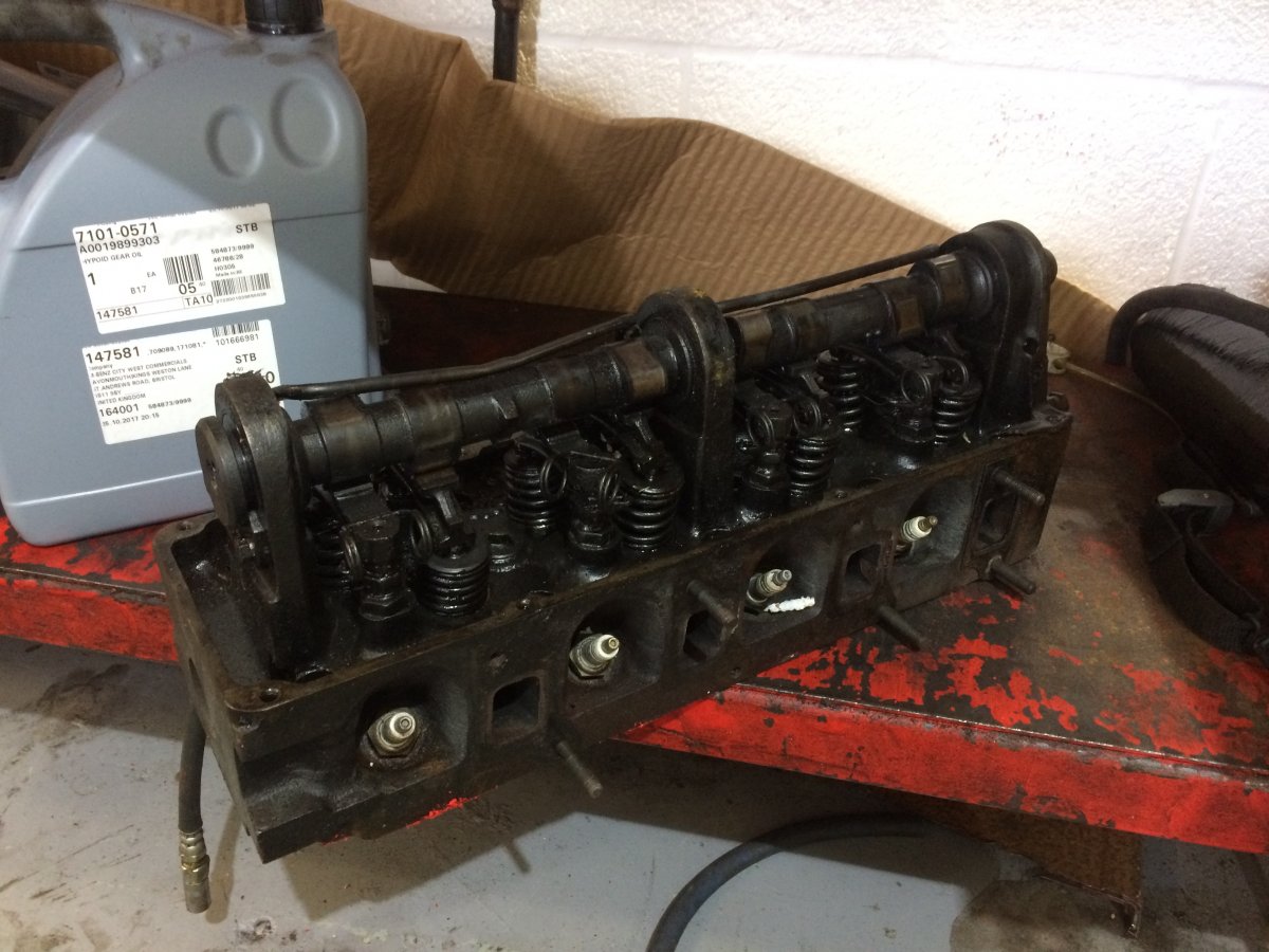

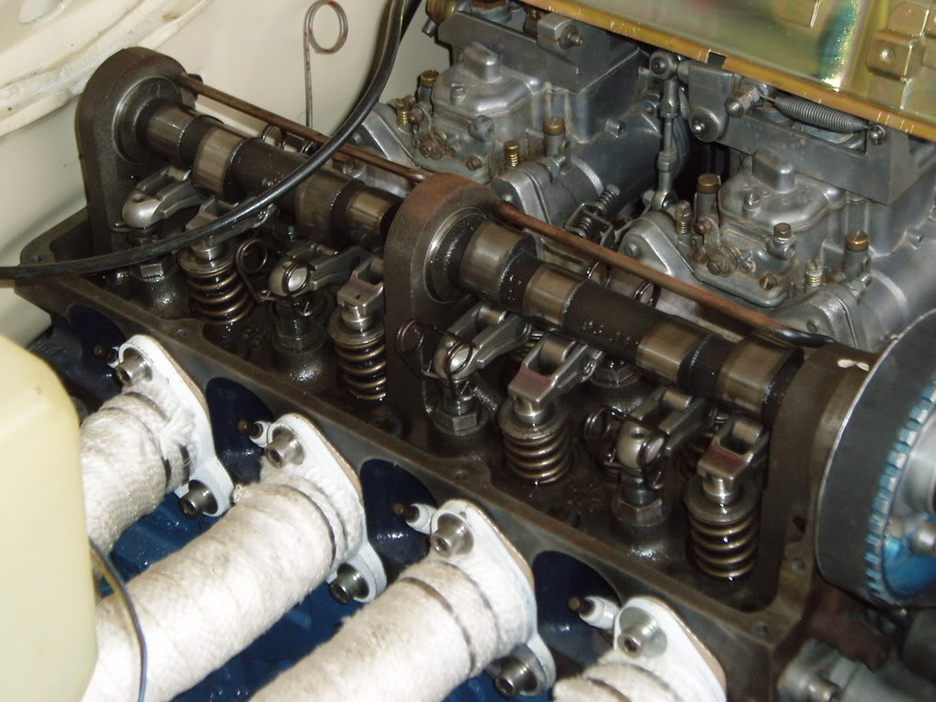

    Rich. Do you mean this Pinto engine? (I’m not familiar with the US Pinto)

    Yes. I had one like that, without the fancy roller rockers and Webers. It went 128 at El Mirage several years ago. Which was good for a 2 liter single cam roadster. But the cl*** had moved on to twin cam four valve engines, So I got a Lotus 907 and ran 141 mph. I liked the Pinto. I would need a billet cam, of course. But since the head is already milled off flat on top, you could cut out a plate to mount three or four cam bearings and the adjusters. I already have the tooth belt drive on the crank and oil pump. i also ran a Nissan E30 SOHC three liter V6, in Jack Costellas car. That engine had rocker shafts with the valve on one end and the cam follower on the other. Went 195 on gas and 231 on fuel. Never had any rocker issues. Liked that motor also. To bad i never saved any of these.

    So you think that can could be adapted for the chev/olds head? With a bit of cut and shut for the valve spacing?
  11. RichFox
    Joined: Dec 3, 2006
    Posts: 10,020
    RichFox
    I believe that the rocker arms and adjusters along with the drive pulley would be good to investigate for the Chevy/Olds head. There may be other parts that would be better. But the Pinto parts are well serviced in the after market and seem like they should work. I ran the heck out of mine for 4 years or so. I broke one stock rocker arm. Not bad. The Nissan never broke any, but I only ran it one year. The actual cam would be a one off part. But Joe Panak would be happy for the work on the blank. I think Dema Elgin has retired. If so a grinder would have to be found who was interested in this whole thing. But I don't know why you couldn't do it. And then you might go for some longer valves and build in a killer lift.

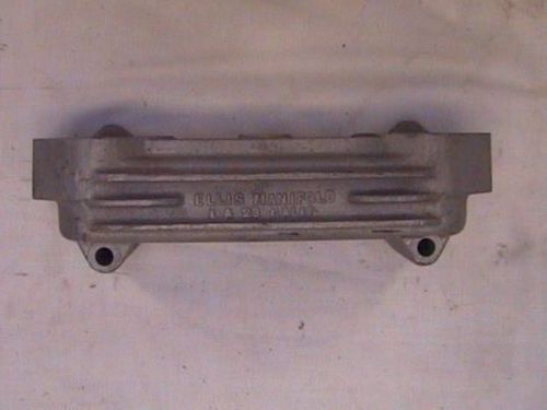

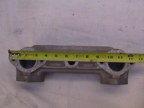

    I found this on eBay. It won't be hard to make it fit a Chevy or Olds head, if I find one to those. It's very close and just needs a little work on the head side.

    Nice find. Model A original fitment?
    I may chase Rich’s Pinto OHC idea. I have a surplus of heads to play with
    The head cost essentially nothing so not much to loose
    Jiminy likes this.
  14. Six Ball
    Joined: Oct 8, 2007
    Posts: 6,975
    Six Ball
    from Nevada
    Now that does look interesting, not real easy but interesting.
    The Ellis intake is not Model A. It's closer to a 153 Chevy but not quite. The upper mounting holes are threaded
    so the bolts come from the engine side. Ellis made a lot of stuff. It may have bolted to a truck blower or an intake adapter of some kind. Any way it would look cool on a '28 Chevy. s-l500-7.jpg s-l500-8.jpg s-l500-10.jpg

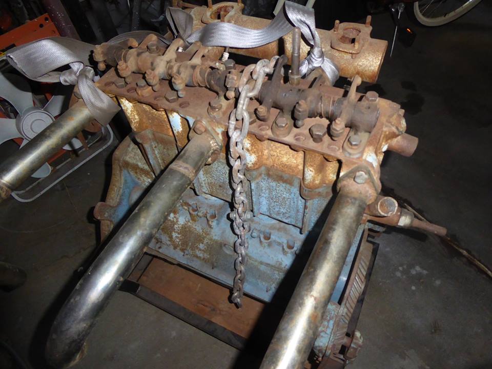

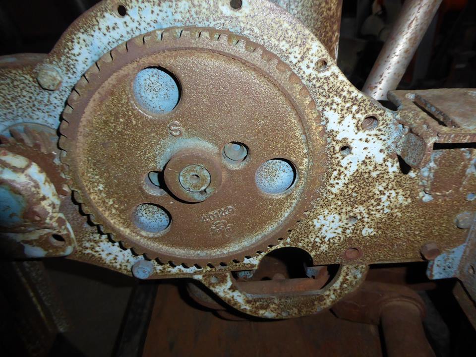

  29. I purchased this engine a few months back, hopefully I can crate it up and send it home when I am in LA in January.
    It is a 224" variant.
    19367661_1731951993764530_7808312554865819648_n.jpg 19849268_1367761496648795_827325699_n.jpg 19866477_1367761519982126_1317445772_n.jpg 19866561_1367762873315324_409475093_n.jpg 19873983_1367762906648654_2049578794_n.jpg 20031028_1373460432745568_2136011827_n.jpg 20067923_1373460419412236_387495313_n.jpg 20068059_1373460436078901_1120104223_n.jpg
