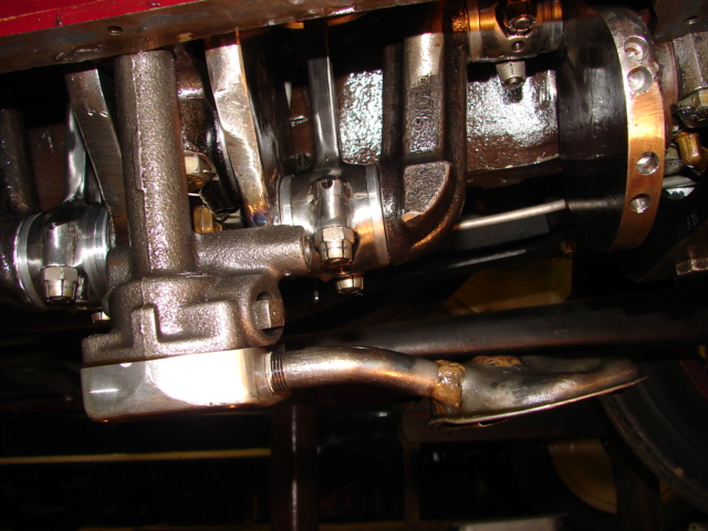

    Pics & some more info on my build.
    The chap doing the engineering work for me has successfully raced a 1923 chev for many years so am following what he has done and am drawing on his experience.
    • 1926 block
    • Flywheel skirt machined off, holes drilled & for Holden HQ clutch pressure plate, taper head bolts with cone friction washers 60lb torque & threaded crank shaft mounting holes.
    • Strengthened centre main cap.
    • Mushroom cam followers - still trying to find out original application for these.
    • 1928 cam grind.
    • High compression pistons.
    • Chev 6 cyl oil pump. Some grinding required to fit beside new centre main cap & new drive peg for distributor. May fit 1925 front engine plate to run a magneto as an option.
    • 3 port Oldsmobile head with twin SU's as per earlier posting. Tappet fulcrum still to be moved.
    • Everything balanced.
    The motor is going into a 1926 Model T Roadster for which I started a build thread for a million years ago. Using 1928 chev gearbox. Have fitted 1927 chev rear end with 1928 chev brake drums and modified hubs to take 1928 Ford Model A 21 inch wheels.

  6. Stueeee
    Joined: Oct 21, 2015
    Posts: 312
    Stueeee
    from Kent, UK
    Great work there. Do you know which Chevy six oil pump you're using? The 216, splash and pressure lubed 235 variants seem to have three different oil pumps.

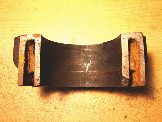

  9. Herb Kephart
    Joined: Jan 9, 2017
    Posts: 99
    Herb Kephart
    Kume--I would recommend that you put at least 2 dowel pins opposite each other, and between the flywheel/crank screws. Don't bother asking how I know. One between each pair of screws is better, but don't go over ¼" diameter on any.
    Stueee- I used 235 Chevy oil pumps from the mid '50's Notice that I made a new bottom plate

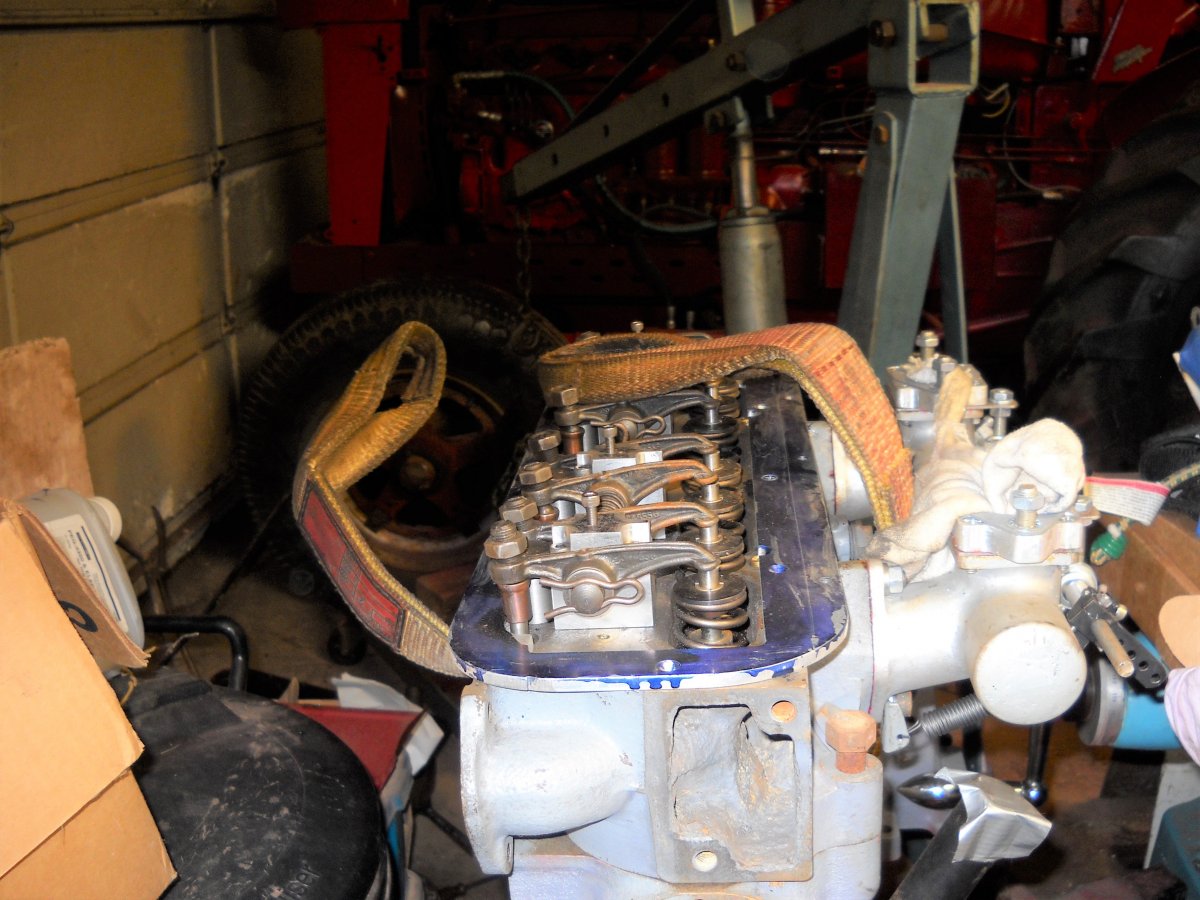

    I'm going to try putting up a picture we'll see how this goes!
    I think it worked! I finally made it down to San Mateo to Rich Fox's and brought back the midget 28 . The first pic. is partially unloaded, second is where it's going to call home until I can open up better digs for it.
    I did not notice the surface rust on the rockers until I looked at my own post! (pic is highlighted) Was a very wet trip! Need to get to shop today and 'NIX'
