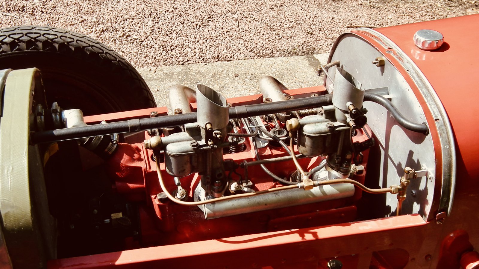

    Well, finally got tired with trying to get the twin Zeniths set right to get this thing to run better, after messing with varying combinations of them and a few disappointing test runs I finally gave up spent some money bought a brand new Stromberg 81!
    Made up a new manifold to fit, it ran very cold and rough with lots of condensation, most likely cos of the small venturis. So I added a water heated bit underneath and I'm pleased to say it now runs very well now, revs up clean and smartish.
    Need to get it out for another run, but I think it'll be pretty good out of the box.
    I might even re-make the manifold in ally sometime, or maybe wait till I get the motor rebuilt and make a second one for a pair of Stromberg 81s on it!

    282door Nice looking manifold! I agree about the water heater! I built a log manifold with two strombergs - but just didn't work the best until I added heat. Runs great!

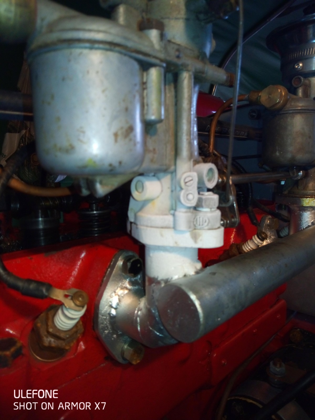

    These old things, I got a bunch free, reckoned they looked vintage enough, so it was worth a try...
    With added ice!

    It would be interesting to somehow know how many people who don't run heat never see the ice under their hoods. :eek:

    So would I, most factory setups have some form of intake heat, with hot rods it's not seen so much, if ever.

    I was experimenting by running it on one carb in that pic, and yes there were icebergs in the carb, the butterfly spindle froze and wouldn't turn.
    I never heard that about the the waffles warming the charge, or any other plausible explanation for having them in there, so maybe that's it.
