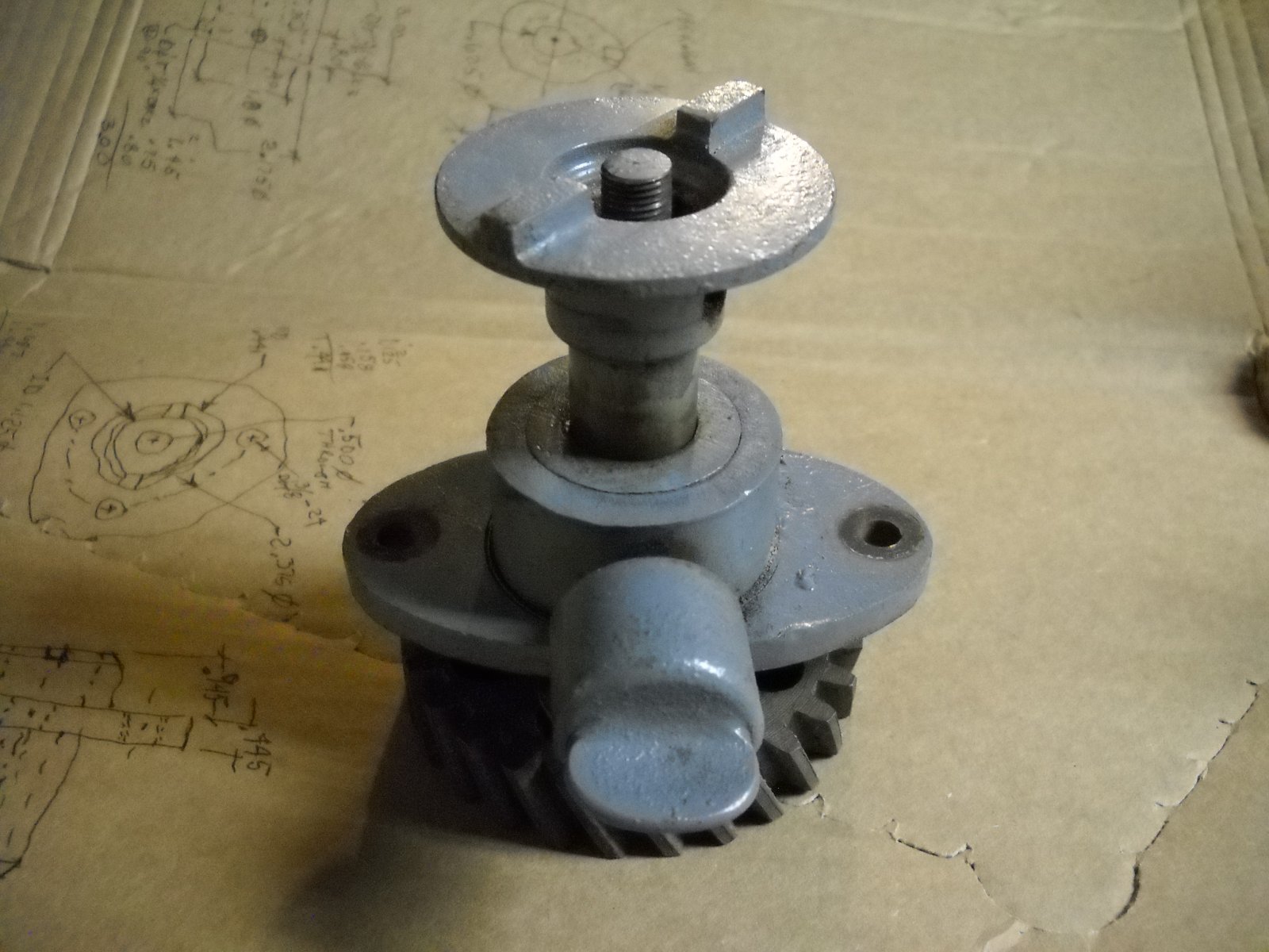

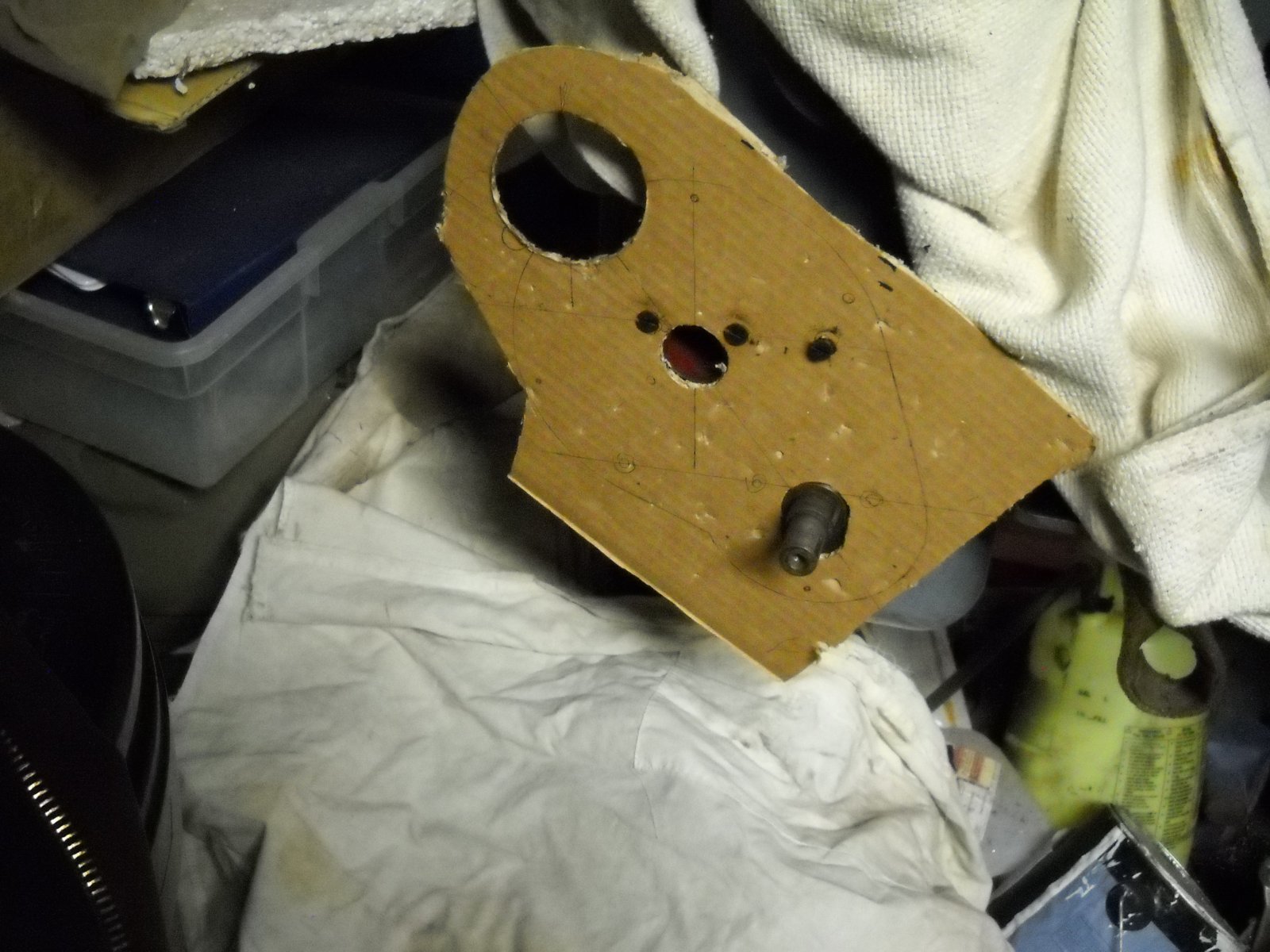

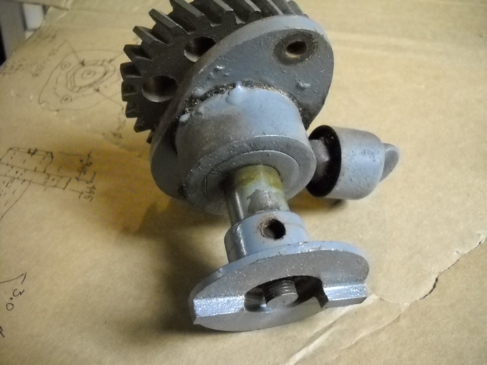

    Worked on the timing cover back plate. Think that I've got it to fit. The original racing engine had a side drive for a magneto. Rich did not like the way the drive was built nor using a mag. I can understand Rich's concerns.
    I think one bushing, (brass??) no seal, lubed with grease cup. I like the looks of a side drive, so am going to ad one back, but not for a magneto. To get into the narrow frame everything has to be sucked in to get the engine to set as low as possible.
    Dan Morrison and Six Ball like this.

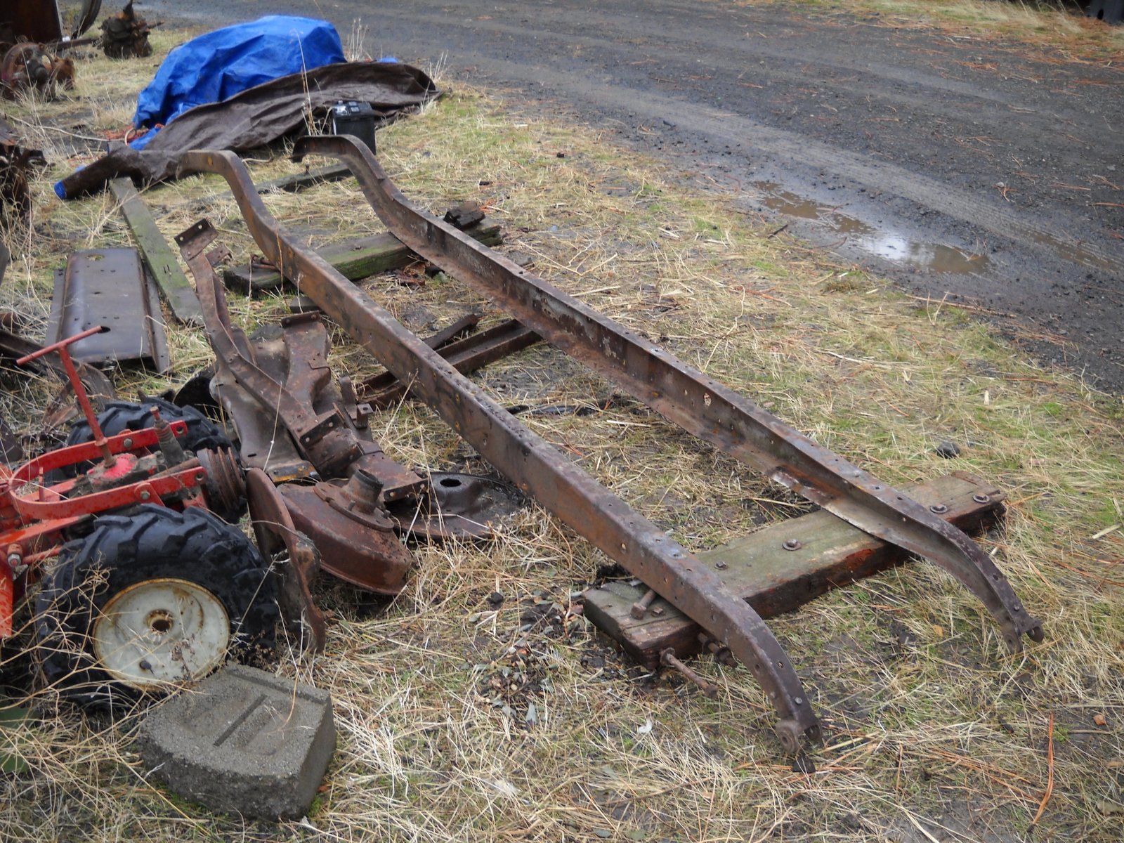

    The width of the frame rails as seen are already two inches farther apart than suggested for the 1935 pore man's dirt track racer. SO, SUCK IT IN!!

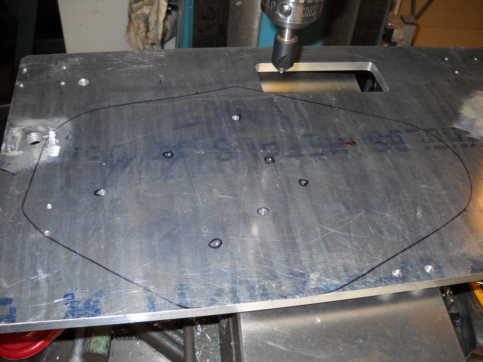

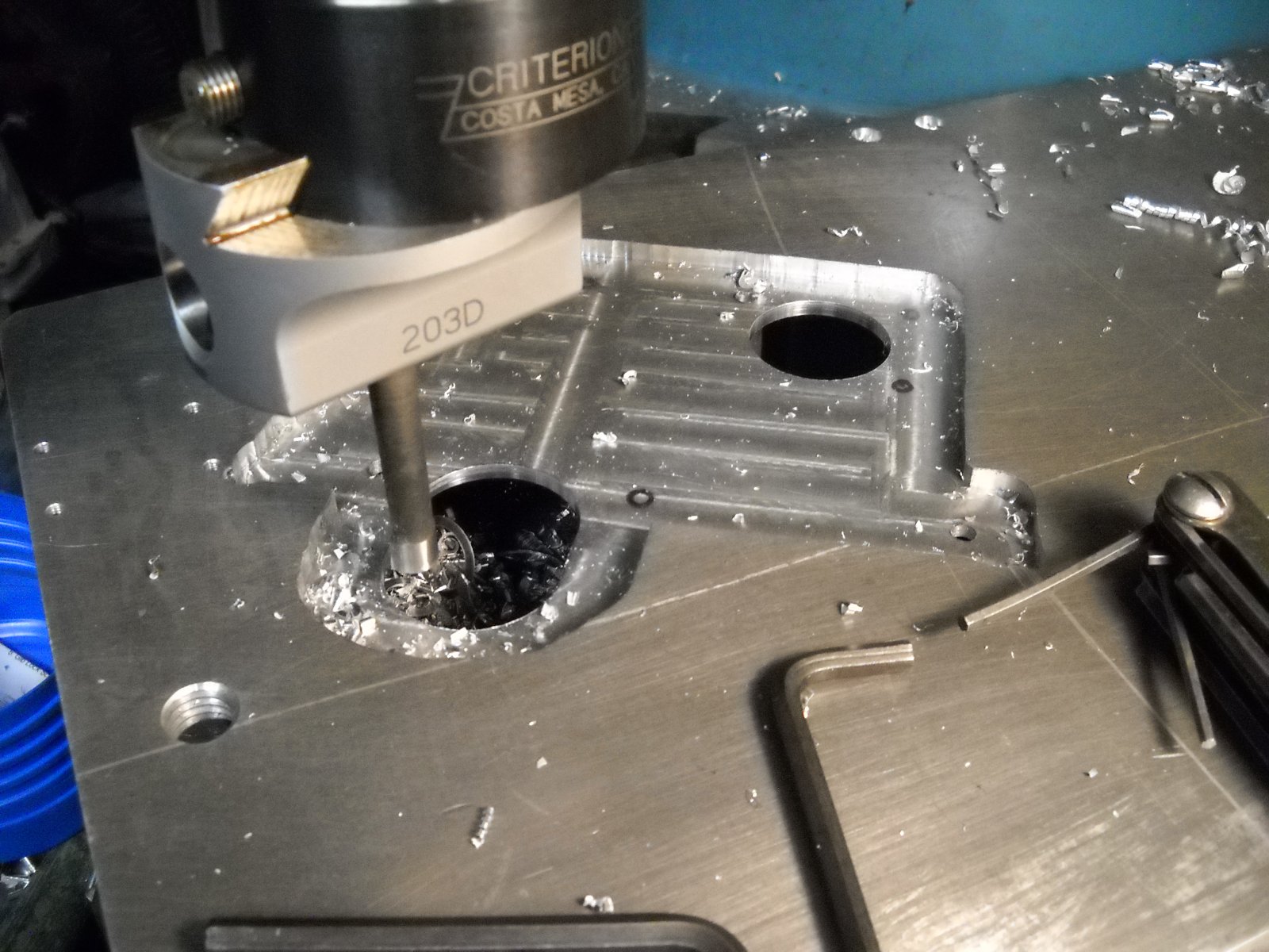

    Try it again! I think that the back plate fits the engine block pretty good now. It was a little hard working with previously used materials. Have two holes to plug. To be able to support the side drive, I used thicker plate (the boys did the same thing but forgot about moving the cam endo. I machined out a section to retain the original thickness for the cam and crank. This was done somewhat free hand... I do not recommend doing it this way unless you can rub your tommy and pat your head REAL well for an extended time. Find someone with a cad cam program and a CNC!!!!

    That is a great piece.

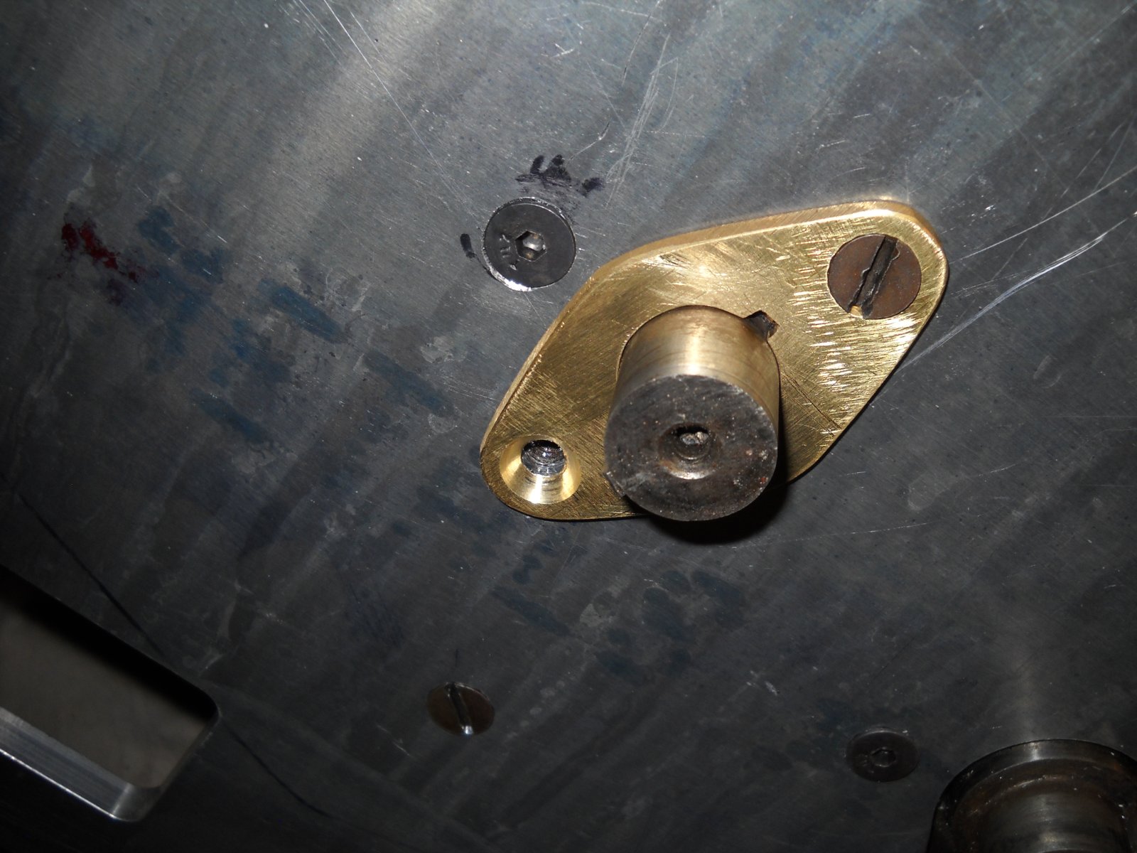

    I got my brass in the mail this morning, so made the plate. I almost ruined it by stepping drill bit sizes in too big of jumps. I had forgotten how grabby brass was. Pulled it clear out of my mill vise. (Should have been using my boring bar after making a pilot hole.)
    Wanted to try it on for size before putting on the gear. I could not get the key out of the shaft, tried everything that I could think of. Was afraid of damaging the cam, so I just filed a "keyway assembly groove"! Pulled the screws up tight and still ha good rotation. The cam went into the freezer and the gear will be put on a light bulb in the morning. Get my feeler gauge set for .002 and be ready with the dead blow hammer.

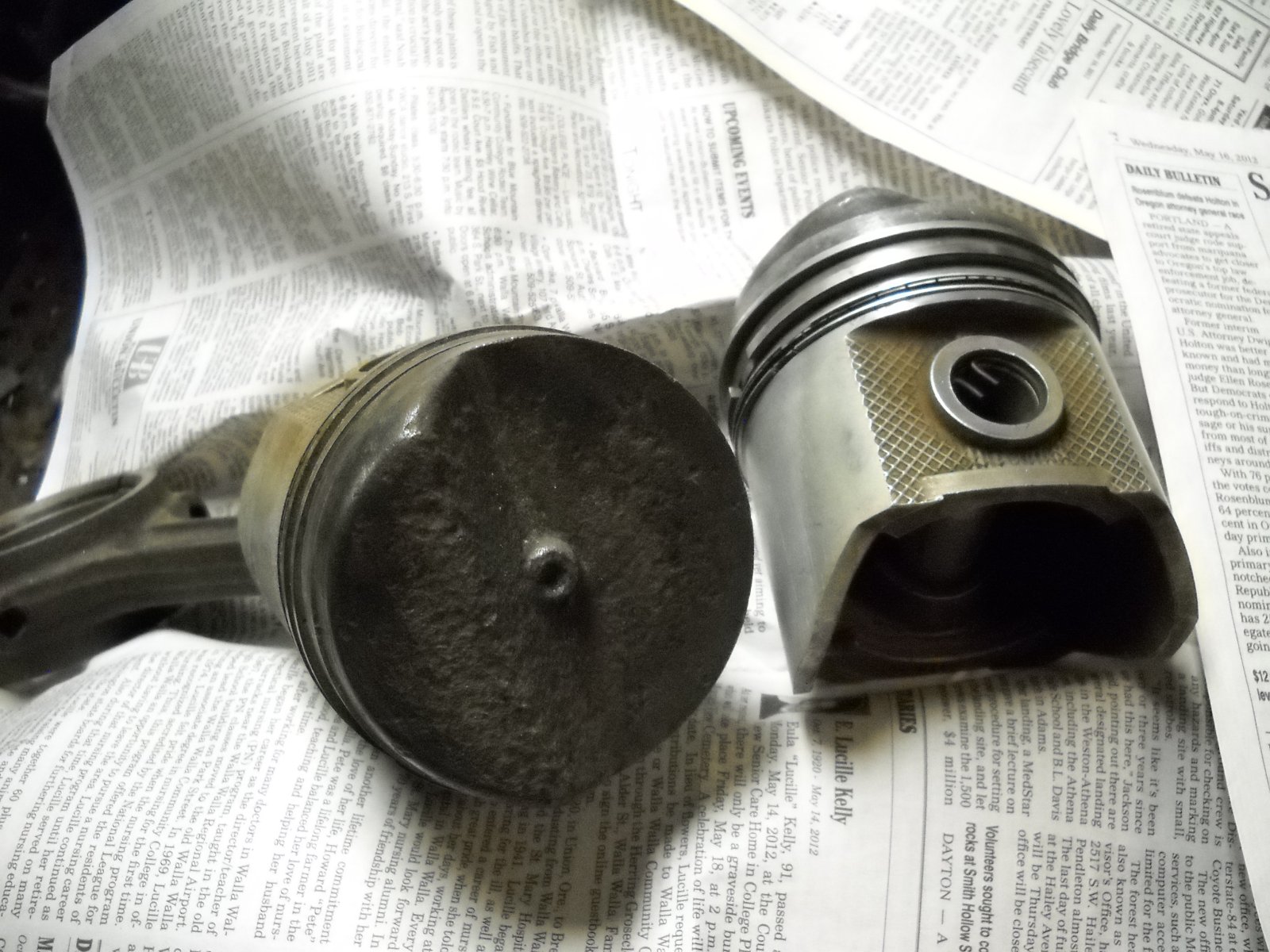

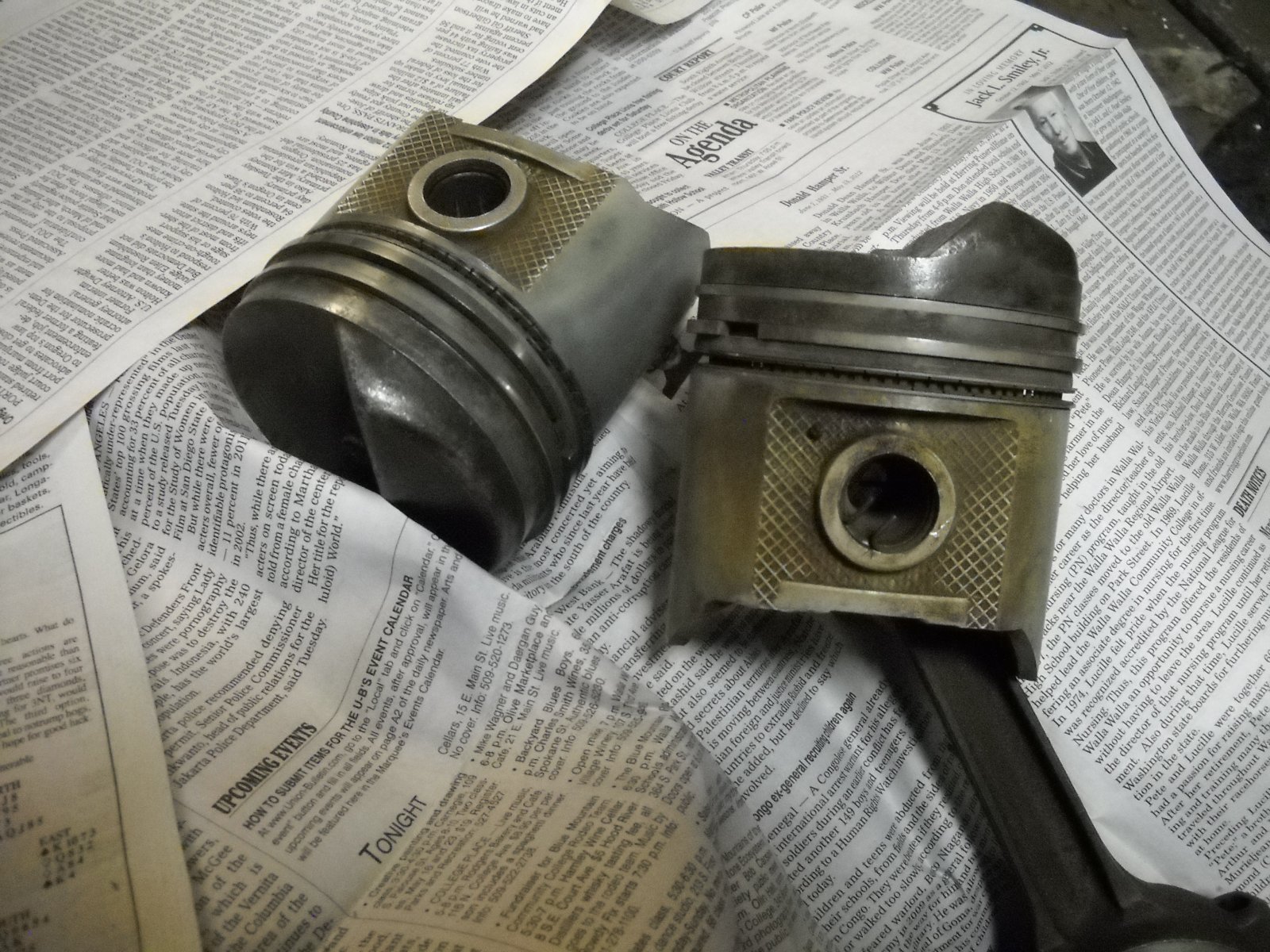

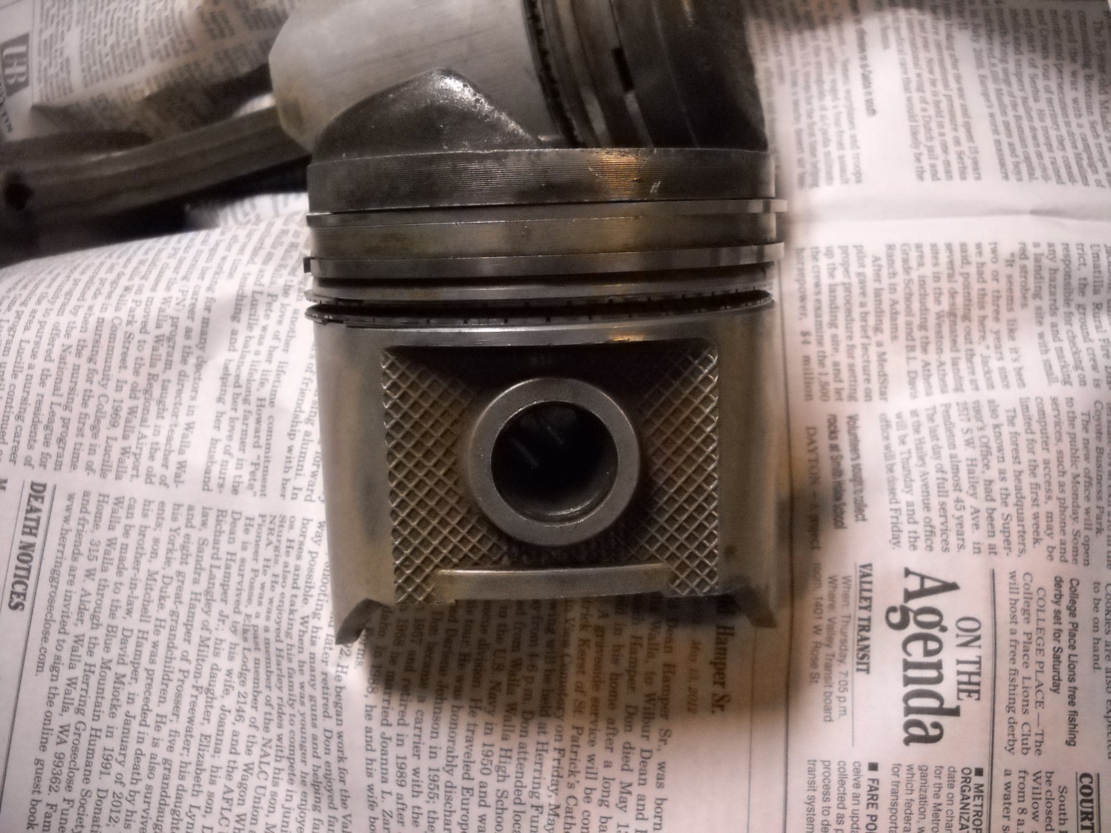

    I found some pistons on eBay last fall, and they have been in solvent all this time. I think that I can salvage four of them. They are possibly the same as what Little Skeet put in his dragster in 1959. (page ten and eleven this thread) They are out of a International truck engine BD (Black Diamond)264 6-cylinder. (IH made at least three 264 engines, this one and two 4-cylinder tractor engines) Unfortunately, they are like hens' teeth to find. International only built this engine for two years, I believe 1955 to 1956, but they did put in multiple farm machines, such as the 151 combines. There were two heads. One vertical valve, the other a canted valve. I believe these are out of a canted valve engine. Standard bore is 3 11/16 like our C4's, but what I can find out so far, is they only went to .040 over bore.
    I have not gotten good measurements on them yet, but I do remember that I could use the stock C4 rod length. I will put up several pictures and also a picture of what the 151 combine engine looks like from the outside.

    Interesting pistons! We had one of those combines when I was a kid in Texas. My dad & uncle cut a LOT of wheat with it in the Texas Panhandle & Eastern New Mexico. But they had to drive it from job to job. Lots of stories.
