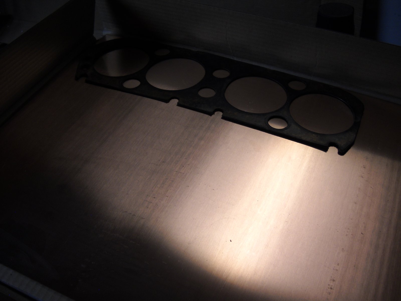

    My copper for the head gasket came today. Rich had said that he usually used .0431 thick half hard copper, cut out the gasket, smoked it, and burnt off the smoke from the opposite side with a broad flame. Didn't have time to work on this. Think that I better learn how to work copper before I start. I am guessing maybe put it on a piece of plywood and clamp it down in a lot of places.

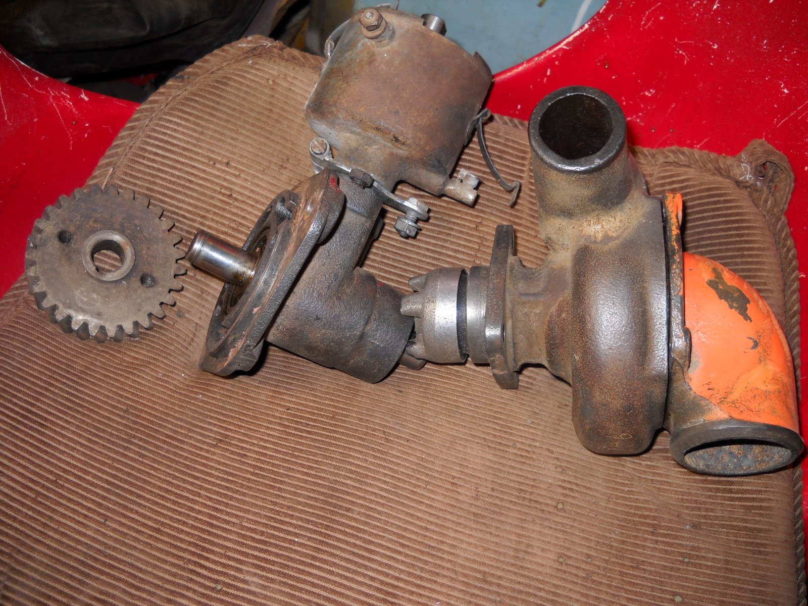

    I guess that it is time to let the cat out of the bag! This is what I will be running on my side drive.

    You've already done the hard part, paying for that sheet of copper! I’ve always waterjet or laser cut my solid gaskets, but the .04” seems to be the best for the job. I’ve had no luck with .06” or .08” gaskets when trying to lower compression. The ol acetylene soot trick works well, but takes some practice to keep the soot from getting thick. Can also use sharpie marker as this is applies much more predictably, and a MAP/propane gas plumbing torch will heat more evenly with its cooler flame. The BBQ grill works great when annealing as it holds the gasket flat, doesn’t absorb much heat, and you can quench with water right in place. That ****** will be really soft when hot, if you have to move it to quench it’ll never fit the same. Look into getting a can of aerosol Hylomar, was the only thing that worked for me…

    Thanks Kevin! I have never done this, so need all the help that I can get. I will have to look up Hylomar.

    I have found that copper (and br***) will remain soft just fine without quenching with water.

    The Hylomar goes on like spraying honey, but never fully dries and was the only thing I could find that would hold back the water. Of course, I was running a T with an aluminum flathead, the chebby may seal better as the cast iron O/H valve head is likely to be much less flexible under the head bolts.
    Yur absolutely right, quenching in still air is softening the material, but you may find that the faster cooling rate of a water quench gets the material closer to a fully annealed state. The small difference in hardness may or may not matter depending upon the application

    I don't know what I'm looking at with the side drive. I recognize the distributer but the rest?

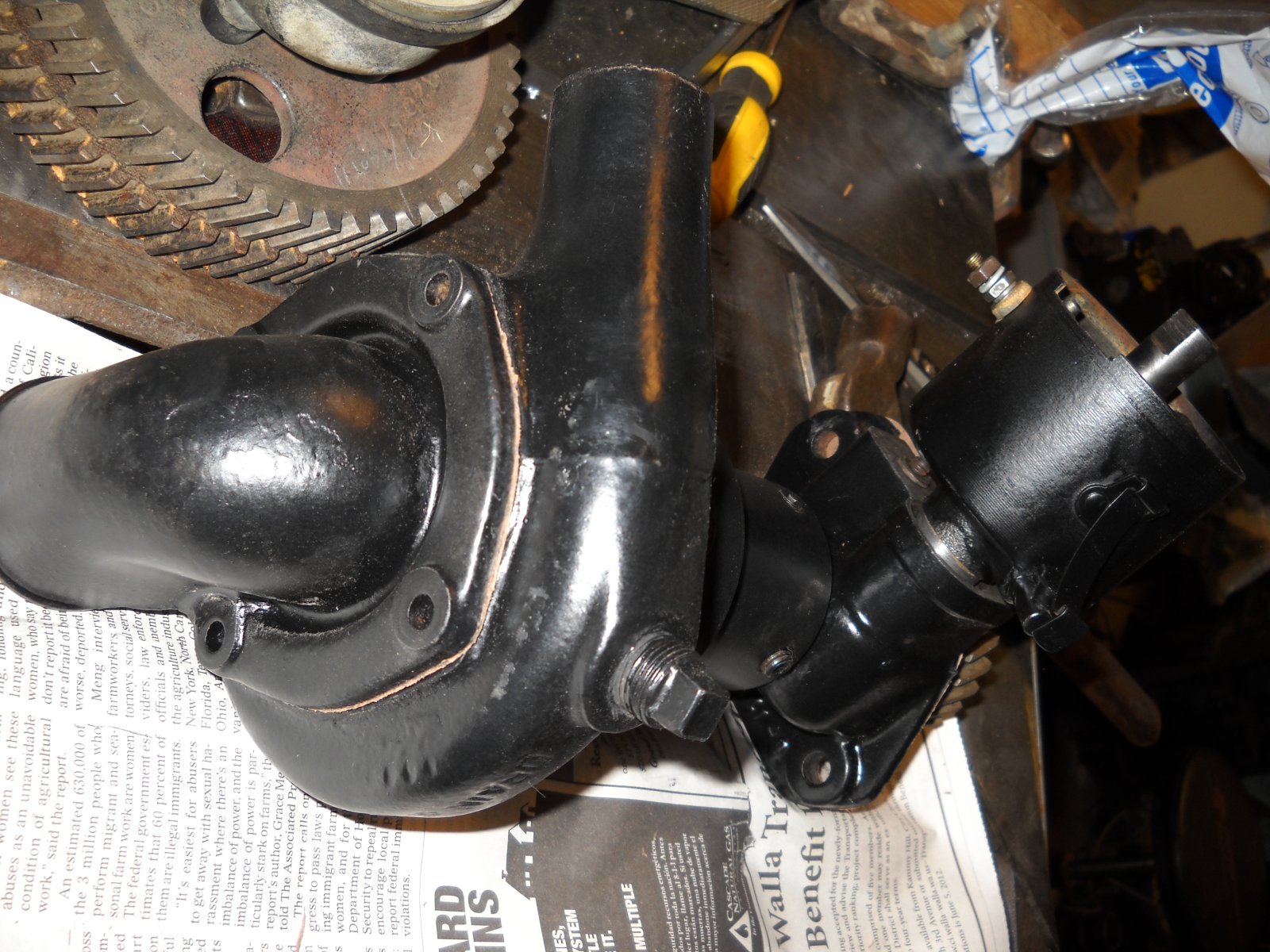

    It is a distributer and water pump. I tried to find a through shaft water pump to add a third item, but came up blank. I'll put some earlier pics. I did not get a picture of my GG2 solid connector. The last picture is how the original was configured.

    OK, I was wondering if the water pump was a blower. Good machine work. There is a good lathe and a mill buried in my shop under the peg board project along with my roadster build.

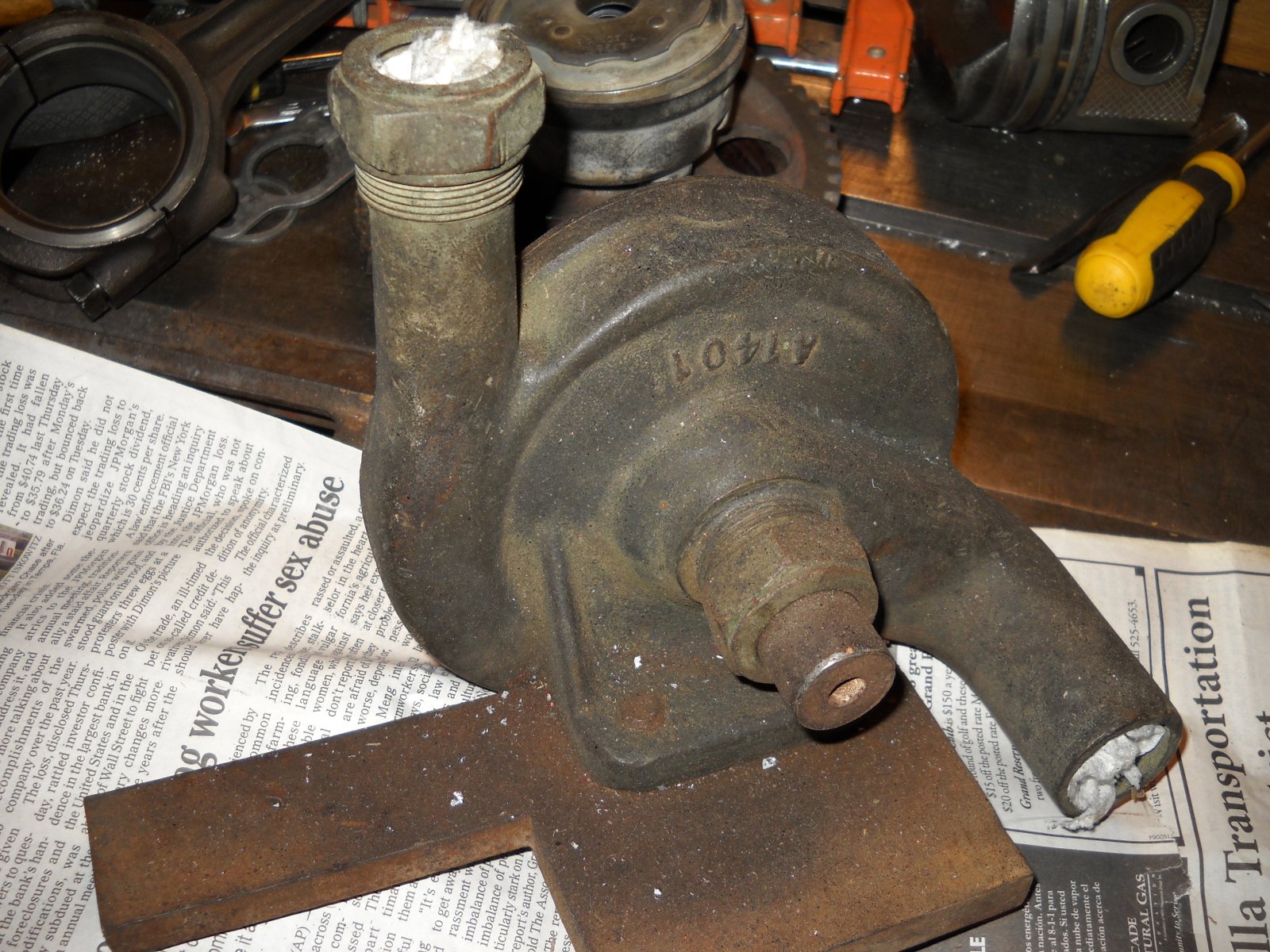

    Rich did not like the oil pump running off of the cam, so moved it. After seeing the cam in person, I did not want anything running off of it. I would rather add a little spring pressure back on the valves. Right now they are less than stock on the seat.
    Here is another water pump that has the through shaft, but does not have any bearings of any type. Also the impeller is shot. If it had been usable, I had an oil pump that I could use say for a dry sump!?!..... I am so over my head now that I better try to get what I've got done correctly. With the cost of that copper sheet, I am afraid that I will ruin it. I do not know of anyone close that has a laser or water jet. Also I have never poured aluminum and that is what I want to make the timing cover out of. Got some really steep learning curves ahead of this old "fart"!

  14. grumpy gaby 2
    Joined: Aug 10, 2019
    Posts: 466
    grumpy gaby 2
    Forgot to add the pics.

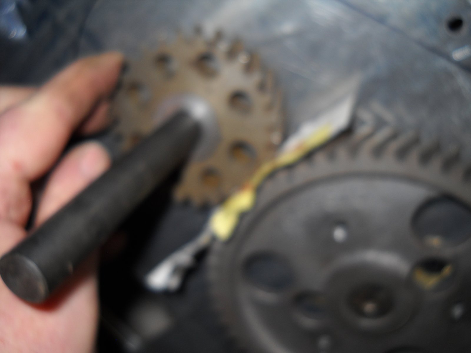

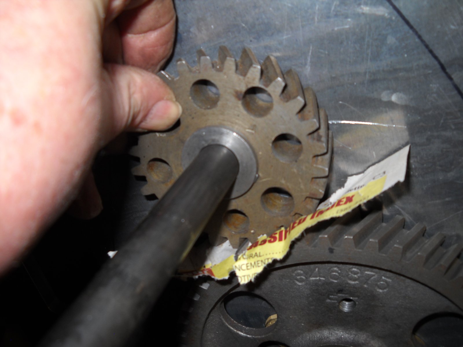

    I have been boning up on pattern making. Not getting much time in shop but got the cam gear on day before yesterday. Yesterday marked an arc for the side drive location. (Now let's see if I can load this!) DSCN1164.JPG DSCN1165.JPG
    Many years ago, I was told to use one thickness of newsprint to get clearances. I pushed the gear in very tight and used transfer punch to scribe the arc. The old Motors manual says for the 6 cylinders to be from .002 to .005. My newsprint miked at .0025, but I think that it will be multiplied by 2 because it is on both sides of the tooth. But still in spec.

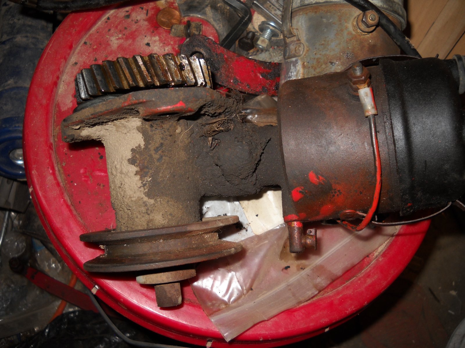

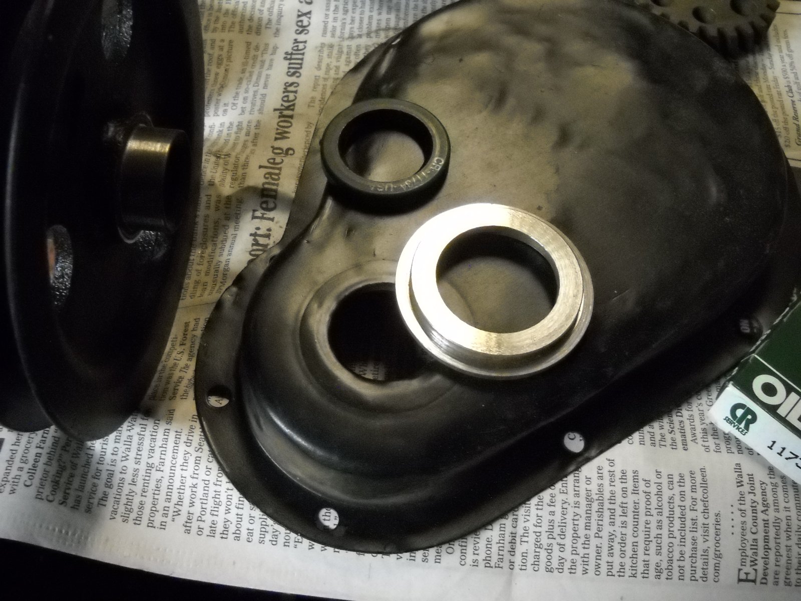

    What I had found was a box with a seal gland that I had gotten my dad to machine for me. Along as cleaning and making the sheave concentric. (If I remember right, dad said there was very little meat over the keyway. Dad has been gone for 10 to12 years, so it is fuzzy.) I just never got it welded into the stock timing cover and put on an engine. Dan, this is another way of sealing the front of the crank. DSCN1169.JPG DSCN1170.JPG

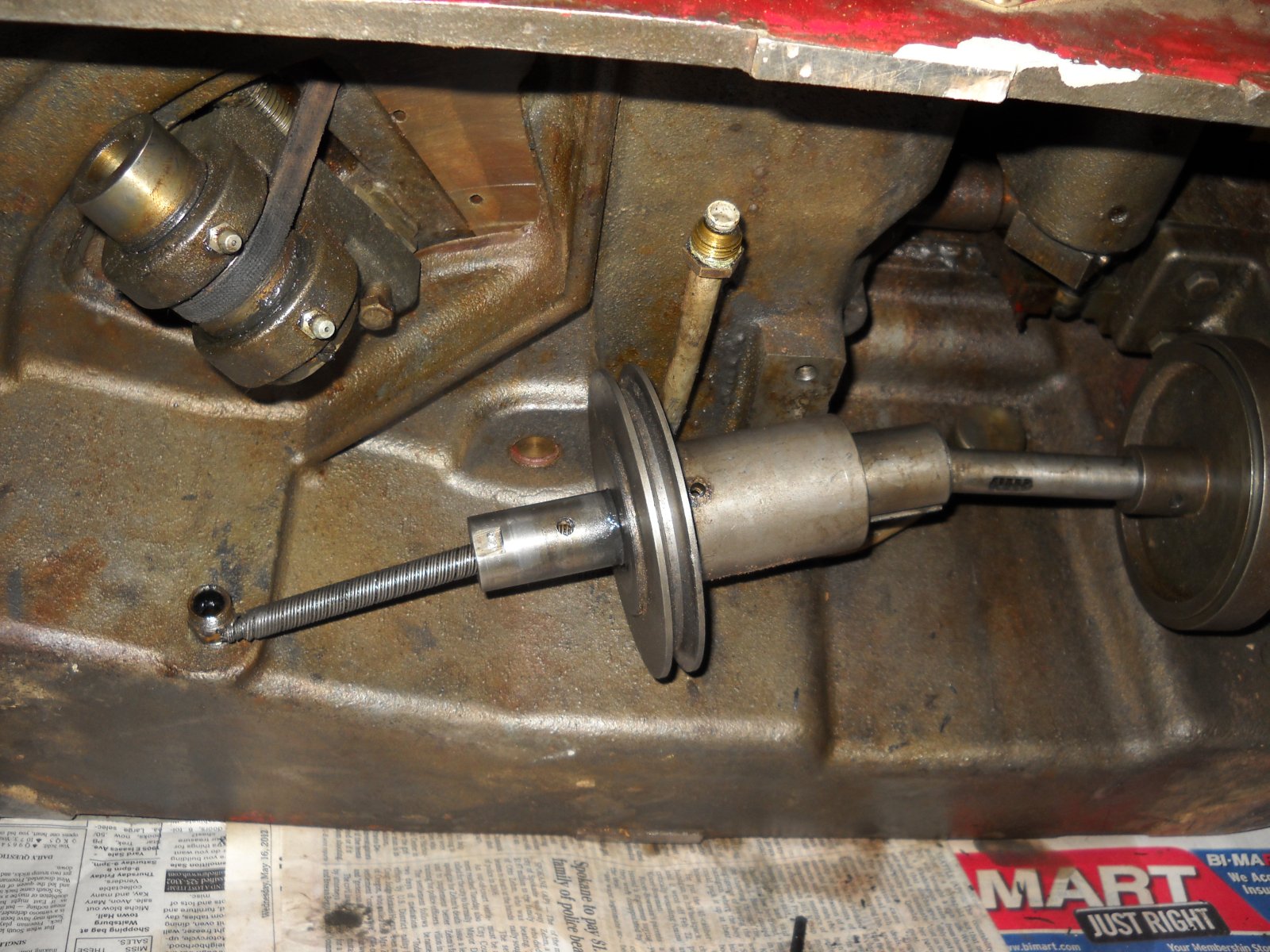

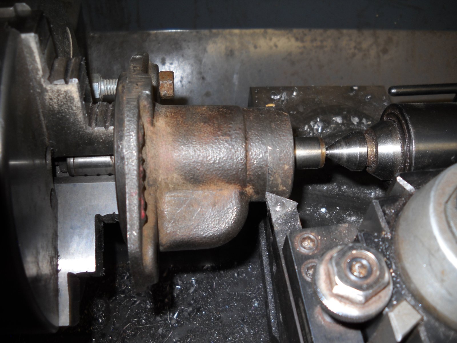

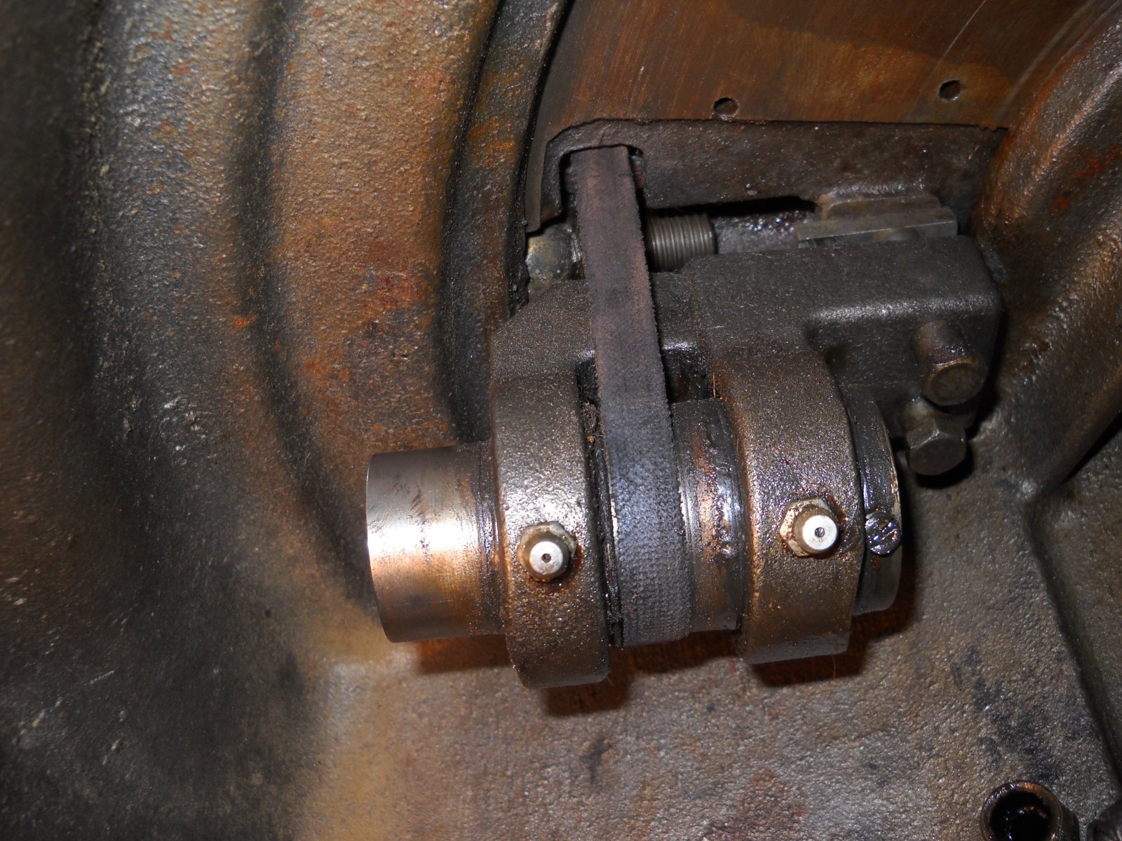

    Well, do not have any engine pictures, but have some engine machine pictures. About 15 years ago I had a model T model A guy in Walla Walla rebabitt a 28 chevy engine for me. He had an old Kwik Way valve grinding machine that he was trying to sell for a friend. He said that the flex cable to drive the chuck broke and they could not find a replacement that was wound the right direction. Anyway, he was down to 25 dollars and was not going any lower. He and I barely got it loaded into the back of my pickup.
    It has the rocker arm grinding attachment and I have ground two sets of rockers for my 28's. So, I guess that it has paid for itself. I have been going to turn it over and see about replacing the cable. I found some cheap flex extensions for sockets, so thought I'd try that.

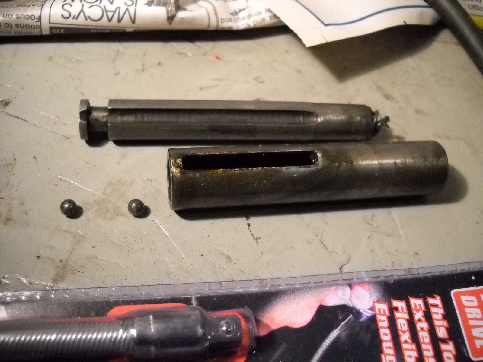

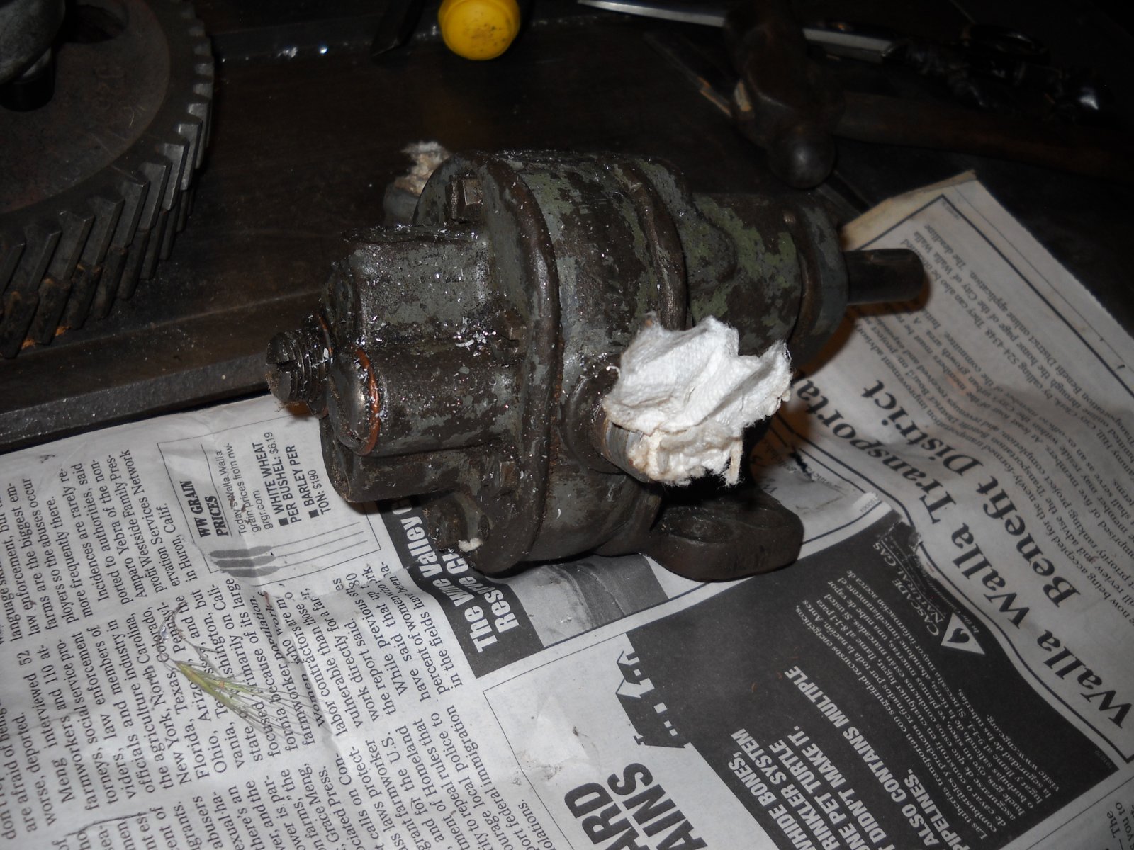

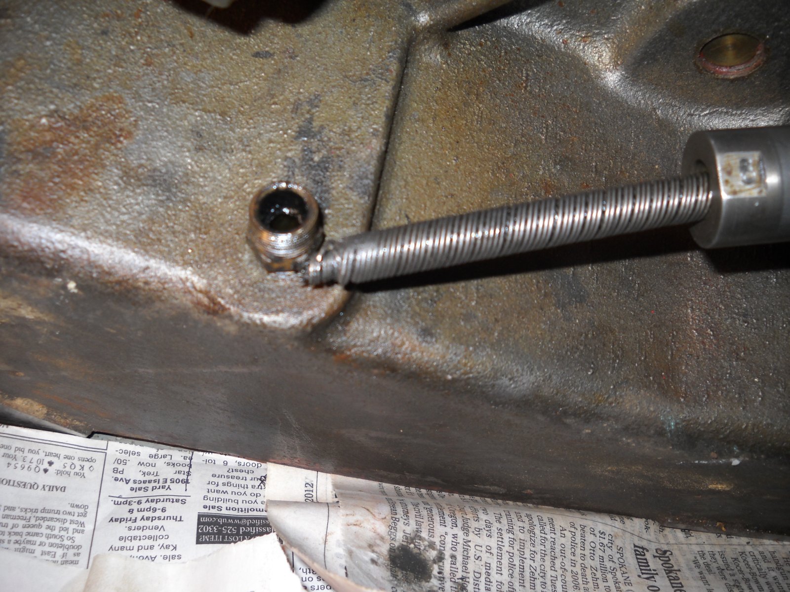

    I found the broken cable and the place where it should go. The second picture is of the sliding mechanism for the attachment to the chuck head. The channel that the two balls run in is pretty rough in places.
    (This has moved down to the last pic.) This is a picture of the drive. It is driven on the right by the motor on a carriage. as the carriage is moved to the left, It engages a cone clutch. There is a short flex shaft to let the guide balls stay inline as the carriage continues to move left to grind the valve face. With the clutch engaged, the second sheave (to drive the oil pump) and the longer flex shaft are powered. The longer flex shaft is required to allow the chuck to swivel for different valve grind angles.
    The ****on in the far-right end of the shaft pushes against the housing to create a positive disengagement to the clutch when the carriage is moved fully to the right.
    A whole lot of monkey motion! I wonder if it wasn't designed by Rub Goldburgs cousin.
    This is as far as I can get it apart. I need cv-121 3/4 to slide out.
    What I did find out was that whoever had it apart last, decided to do away with two flex shafts and make it one continues shaft. Once that the clutch was engaged, it probably lasted about a half second with no give.
    I am now thinking of getting the end of the flex shaft cut off, put the first part back together with the pump. Moving the rest of the drive up on top of the chuck, driven with a small electric drill.

    When I have made solid copper head gaskets I have clamped the copper between two sheets of 1/4" plywood. The clamping is done by countersunk machine screws going through all three layers ; the screws going through outside the edge of the gasket and in also in the bore area. The gasket shape was traced onto the top layer of plywood which also is the side with the screws and nuts protuding leaving the underside dead flat. Drill a pilot hole through the combustion chamber area for each bore. Now you can p*** the scrollsaw blade through and cut the holes. The plywood pretty much eliminates the bucking and edge distortion you would be pretty much certain to get otherwise.
