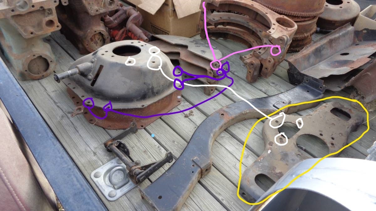

    The chevy 4 three bolt mount was solid. Your front mount bolt went through the cross member with a washer and castellated nut and carter pin. The two rear mounts were also solid with same mounting.

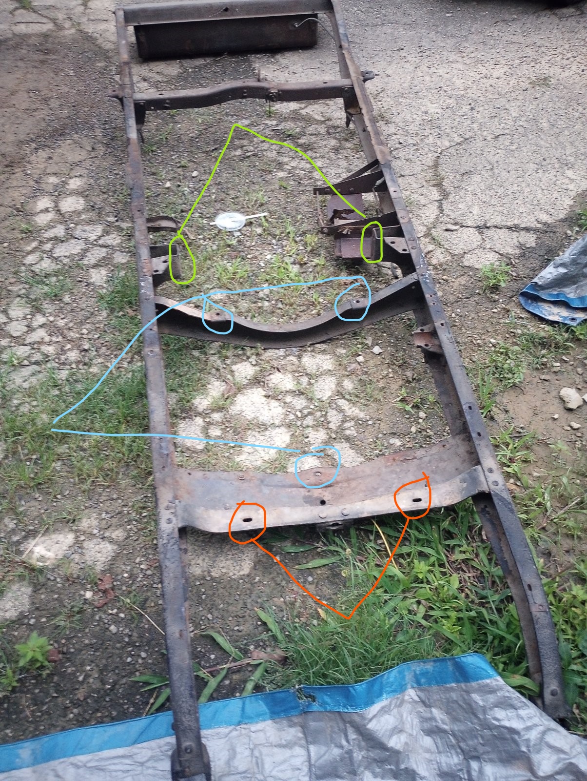

    Myself, I would use the 26 car frame basically as is for engine, trans., and radiator. Especially if you have a 26 steel shell.
    If you notice your frame has the hand crank going through the cross member. The 27 and 28 the crank hole is above the cross member. The 26 car frame has the lowest engine placement of the three.
    I have circled the radiator mounting holes in red. The engine mounting in light blue. The trans. mount in pea grean.
    Another pic of parts. Upper right is the cast iron rear motor mount / starter mount / front of bell housing. All three years will fit the same (plus 25) If you do not have this, look for a 28 (maybe 27 also) They have a window with pointer in the front right side for seeing timing marks on the fly wheel. This mounts directly to the back of the engine with bolts and lock washers. Yust above the lavender circle you can see the hole for the rear motor mount. The lavender circles show how the lower half mounts to the cast top. (if the bottom was rotated 180 degrees.
    The cast top and pressed steel bottom end up being flush with the back. Then the pressed steel rear bell housing mounts to that with bolts, locks, and nuts.
    The pressed steel crossmember circled in yellow is the transmission mount. it bolts to the back of the rear bell housing using shoulder bolts to keep them aligned. The cross member is flipped over (180 degrees) and is mounted. The original trans fits between the flanges and is bolted through the front of the bell housing.
    Now since the engine in a 26 sets lower than a 28, there are at east 2 different crossmembers. (not sure if 27 is different yet) Here again, in my opinion, I would use this cross member on a speedster with a hopped up engine.
    The ends of the cross member is bolted to the frame stirrups with bolts, flats, locks, and nuts. Also there is a shim that goes in each end to take up the gap. (gap to help make assembly and dis. easier) I will have to look for some of mine, but I think that they are of a horseshoe shape. (starters fom all three years will work) (25?)

    That info is helpful. Are all of the front motor mounts the same? I think The front mount I have is off of a 28. I don't have a rear transmission crossmember. There is a local guy that has some Chevy stuff, I will see if he has one. Are all of the transmission rear crossmembers the same, or is 26 different? I am thinking about cleaning all the parts, put a coat of paint on them the way they are and see if I can assemble the chassis and work out brake rods etc. That way I will get a better idea of what I need and be looking for it. The guy I got stuff from this week probably had a crossmember but I didn't think or know to ask. As many 26-28 Chevys were made, there has to be some parts here local. Here are some pics of my steering column. Are all the columns the same length?

    1. You have a mid to late 26 frame
    2. I can confirm your spring sizes, except that I thought that I came up with 52 in the back. will recheck. front shakles about 2 1/4 eye to eye, rear about 3 1/4
    3. the 26 trans cross member is different height than 28 (meaning the trans setts lower in frame) do not know about 27, will have to do some (a lot of black berry cutting to check one)(I will need to find a 26 member that I can get some good measurements on)
    4. steering columns will all fit. difference is spark and throttle location 25 just below the steering wheel similar to model T, early 26 just above the dash, late 26/27/28 on top of steering wheel. 27/28 have a lock in the column at dash. 27 has aluminum rap in the center like late 26, 28 the rap is larger with a ridge running around it. You have a VERY nice steering wheel!
    5. 26/27/28 front motor mounts all the same. 25 had a separate cast steel cross member for the front mount. (as far as I know was used one year only)
    Six Ball and Dan Morrison like this.

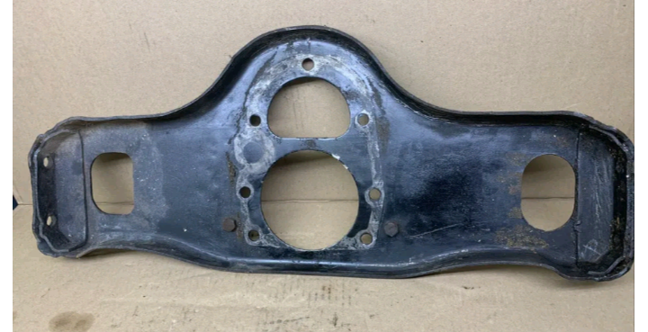

    This is the pic for one advertised on ebay. He lists it for 25-28. Which I don't think is correct. Is there an easy way to tell what year is what on these?

    This is what I measured for a 26 (cl of top mount to the frame hole to the cl of the hole just off of the trans )
    I believe the one shown is a 28

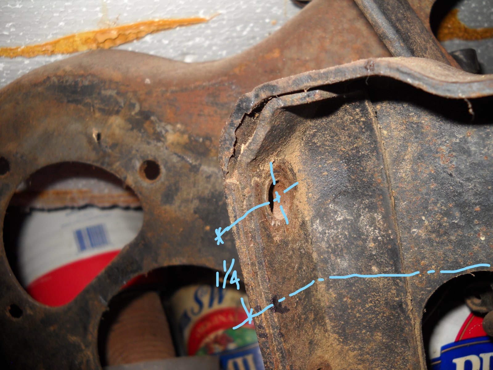

    Here is the 26 bad pic I took. This is my first 26 and it is still mounted to the bell and trans. also right side up.

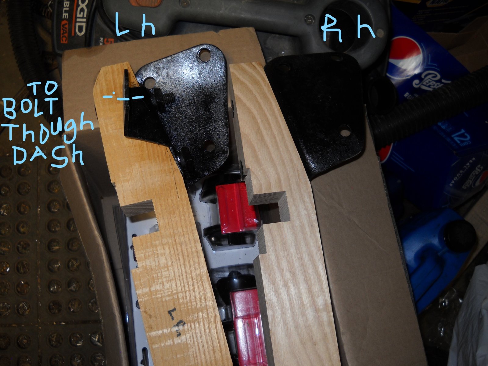

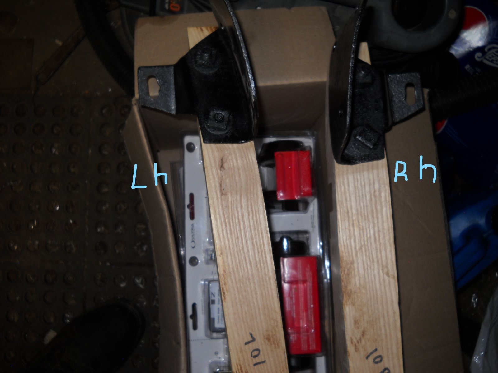

    Got pics of cowl/windshield/ "A" pillar/ dash brackets. These will fit 25 and 26 and possibly 23* and 24* open cowls. (* was 27 28)

    Thanks for the pics of the brackets. With regards to the transmission crossmember. As that bolts between the trans and bell housing, does the 26 and later trans have a slightly longer input shaft? Or is it enough to matter (maybe 3/16?). I looked at my windshield assembly yesterday. I didn't think to take a pic, however it was never drilled for a windshield wiper, just found that interesting. Does anyone know what years the roadster windshield assemblies will interchange?

    Cross member is closer to 1/8 thick, don't know of change in trans input shaft. I believe that a windshield wiper was a dealer or owner addition. Found in the 28 parts book that the 23/24* used the same top frame as the 25. Did not confirm about uprights. (did not find the brackets for any year- parts book is very hard to find what you looking for plus, if the paint color changed so did the part number and what it was used on)

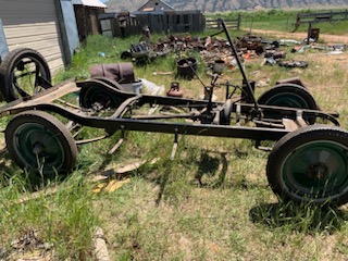

    Look what you started! I found this locally in Utah that came with a 28 headed engine that needs assembly. Everything was rebuilt to the 9s by the former engineer who has passed. It odd because I had 3 Chevy wire wheels and a Franklin front axle in my shop before I saw the add. I am thinking early 30s Speedster or late 30s Roadster Lakester. IMG_2300.jpg

    Hay! The more the Marier! The picture gets grainy before I can zoom in enough, but I'm guessing that you have a very good start to a 27 speedster! (With rims and tires even!)

    Man that is a clean chassis you found! From the eBay pictures I think I would seriously think about running those wheels & maybe tires. In the other hand you may make enough to pay for a lot of the project.

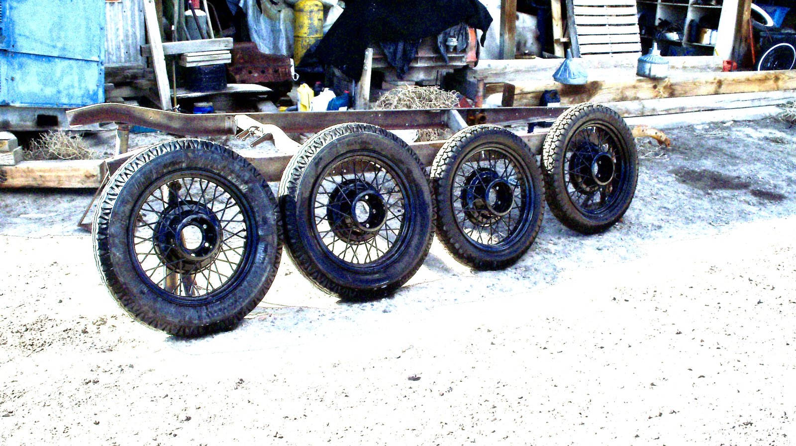

    I aways loved early 30s chevy wires with cycle tires. I will probably use 32 Ford wheel in back. I like the look of 19" and 18" wheels together. Paul the previous owner of the project put a lot of work putting together than set of disk wheels. I am sure they will find a nice home and help another guy's project to be finished. up.

    100_0338.JPG I like them too. Here is my set of 19". I will probably just run the wires on the front with 15" or 16" six lug solids on the back.
