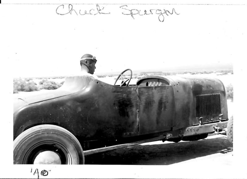

    I have a Franklin axle in my shop? Was Spurgin car a chopped coupe? Or an earlier roadster? SCAN0056.jpg SCAN0047 (1).jpg s-l1600.jpg SCAN0056.jpg SCAN0047 (1).jpg s-l1600.jpg

    Craig, that is a roadster body. You can tell because of 1. Mounting hole for the top pivot. 2. The open car dash and holes for the windshield stanchions. Also, the coup had a shorter trunk.

    Yes, a '25 and the early version still had Chevy front suspension. That top picture of #87B is one of my favorite cars. The Ford reared and spring mad it a 3 springer. There were a lot of them in the early days.

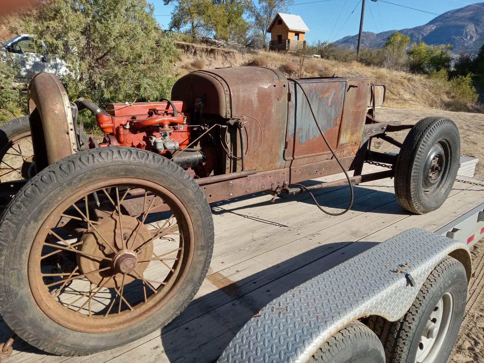

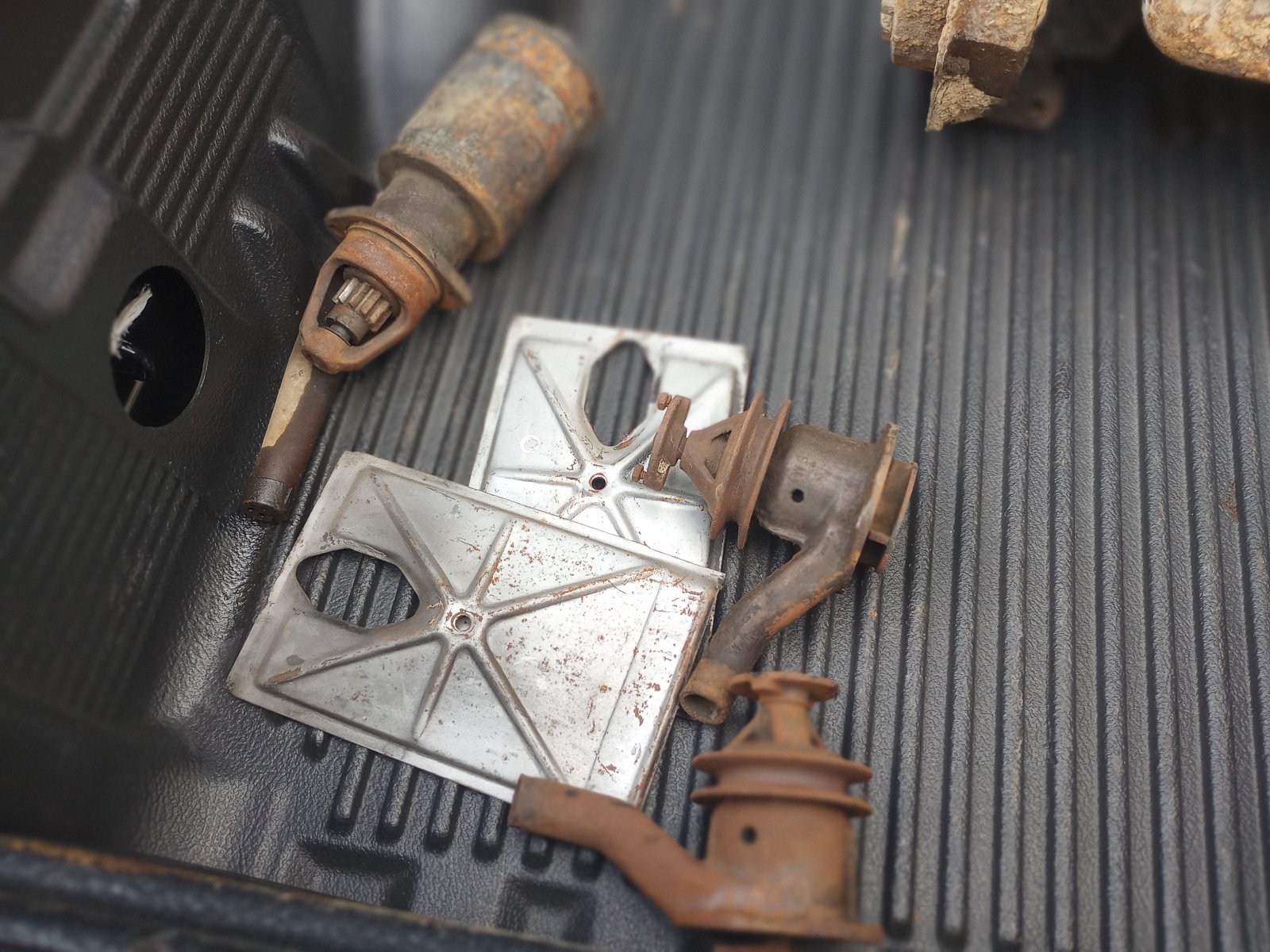

    Drove a little ways and went to see a 25 touring sitting in a barn. Came home with a partial body, seat springs, hood, rear fenders, vacuum tank, speedometer, gauges, e-brake handle, another gas tank and windshield ***embly. I have started a list of what I don't have so I can start tracking things down. The wood in the body is bad but I think there is enough there for patterns. Not building a touring, but all the bits, pieces, brackets and patterns will come in handy. Still building a speedster ... I know Chevy didn't make a 4 cylinder roadster pickup ... But building one has crossed my mind. The gentleman had a restored 1925 touring that had been in his family since the early 60s. He purchased the unrestored touring to get the correct engine for his restored car.

    Good score! Did you get that cowl? Looks like a nice one!

    Yes, along with the remains of the touring body, two back doors, sides, seat springs etc. Front doors were missing. Gonna look at converting the rear doors to front doors, or try to make some front doors the same way the rear doors are made. I did Not get the ch***is as I don't need it and no matter what he was keeping the engine. The 3 hour drive home was really hard on the body, broke about every joint in it.

    Today I found the phone number and info where I bought wheels and axles 10-12 years ago. I need a better flywheel and a generator and some other items so I tried the number, it was still good. When I bought the wheels and axles, he had given the engine and transmission to his neighbor and at the time it wasn't for sale. I went over today and bought the complete engine (27) with starter and generator. An extra flywheel housing, two more water pump cores, carb, and a couple of 28 side covers. I am supposed to get the transmission as part of the deal, but he has to move some things to get to it. I didn't need the engine, but I wanted the parts. Is there any advantage to a 27 camshaft and lifters over a 28?

    The primered flywheel housing is a 28 with the slot and pointer for timing off of the flywheel. (Make sure you index the flywheel correctly to your crank. It can go on 6 different ways!) I do not know of any advantage to the 27 cam and lifters------If using a 28 block, they will not fit! Just side note, the 26/27 water pump and the 28 truck water pump are the same. 28 car is what your cores are. two piece pully/fan mount. If using 28 head there are two different thermostat housings. (28 first to have thermostat) Car, outlet not as vertical as truck. Using the truck housing and water pump, the engine will fit the earlier frames and radiators.
