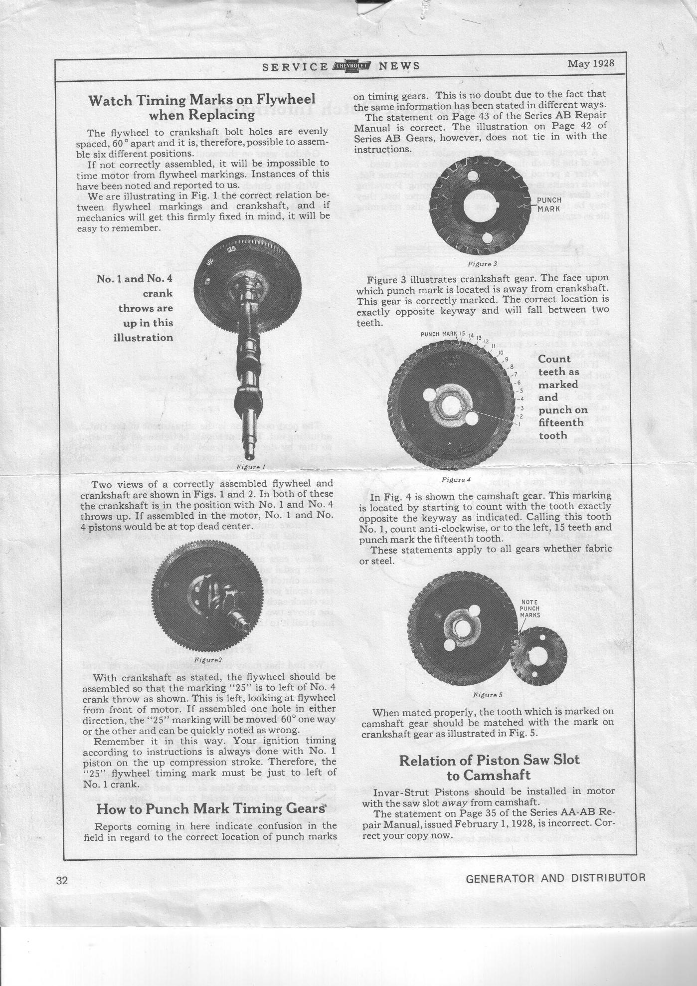

  6. ebtm3
    Joined: May 23, 2007
    Posts: 837
    ebtm3
    Farcus- UC with the line between the two letters is Upper Center or TDC. What year is your flywheel? Mine, a '27, has degrees marked for a distance before and after TDC. Cant read the shop manual page in the thumbnail.
    Mac- Believe it or not, 490 Chevy and T Ford rear ring and pinions are one and the same. Gerber probably took advantage of the various aftermarket ratios for the T rear. Don't know if he adapted T axles, but doubt that he would have gotten far with the Chevy ones.
    There has been mention of recommendations for a street engine, without the expenses involved in an all out racing engine---My 2 cents---
    261 Chev pistons, Ford A rods, stock crank, counterweighted, but NOT drilled. Flywheel cut to about 35 pounds including modern pressure plate (stock F/W and P/P=70 lbs.). All rotating and reciprocating parts balanced-this is important, not just for smoothness, but also for engine life. Stock oiling system with modern oil filter in place of '28 filter. Larger intake valves by 1/8", modern exhaust valves, same size as stock (better material- getting tired of hearing this?) washers under stock valve springs to get seated pressure to about 60 lbs. Adapters for spark plug holes to take long reach 14MM plugs-get the electrodes as far into the chamber as possible. Stock distributor ('27-'28) fine. Cam with B Ford grind, and lift, flat tappets (Ford B), 1 1/2-1 rockerarms. Too many engines of this type are over carburetored- a single carb with a 1 1/8" venturi is more than enough for the speeds that this engine is going to turn, and will give much better low end response. I have a manifold setup with two 1 1/8 SU carbs, and while it pulls better at 4500 rpm on my full pressure engine than my one carb setup, it is inferior at low speeds---and the described engine should be kept at under 2800rpm cruising, with OCCASIONAL 3500 rpm bursts. 15-40 oil
    This (in my estimation) will give 60-65 HP, as opposed to 36 for a stock '28.
    Herb K
    Outback likes this.
  7. farcus1
    Joined: Mar 4, 2008
    Posts: 56
    farcus1
    Same here on the thumbnail. Thanks for the clarification on the UlC. I used it as TDC and timed the motor accordingly. This motor is stock except the customer complained about low oil pressure, DUH. I fixed this by installing a Billy Possom oil pump which has a pressure relief valve that releases at 60#, should have plenty of oil pressure now. The oiling system is a cross between a 26/7 Model T and a Model A, sort of. Hope it runs good, it is all new, pistons, rings, valves (modern V8), reground seats, mains and ,rods (pour and cut my own babbitt). It should run like a new motor which, will still be a snail.

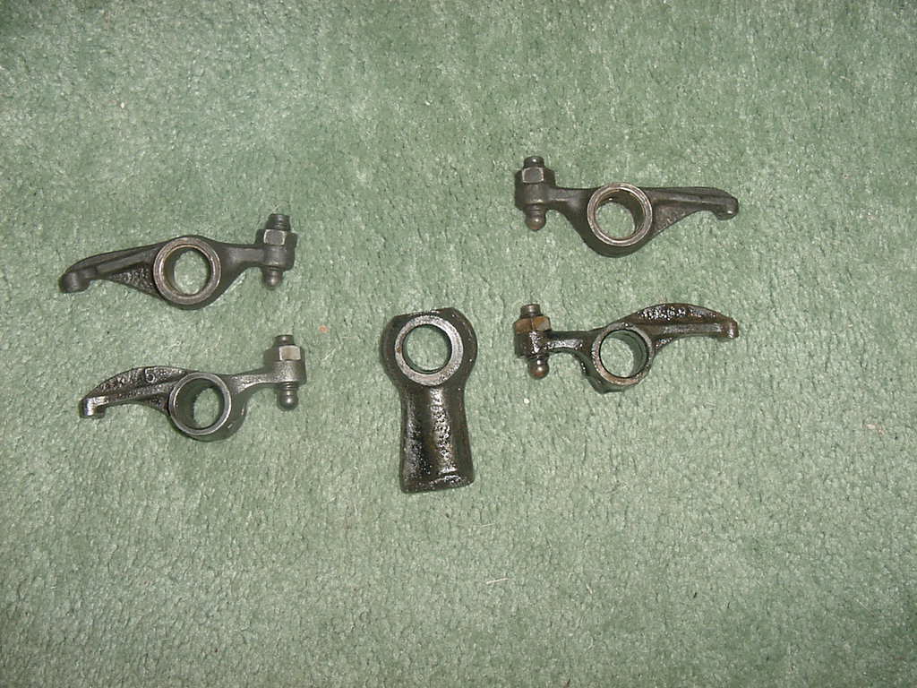

    Hi Chevy guys,
    I am putting a 28 chevy head on my model a block. About a month ago I was buying some model A parts from a man who had bought out an old junkyard.
    As we were looking thru the junk on the ground he pointed out a 28 Chevy head. Back in the recesses of my memory I recalled that someone told me that these heads could be made to work on Model T's and model A's.
    Being a horse trader at heart I immediately asked how much as we looked the head over we noticed 3 more that were in way better shape and I ended up buying all 4 of them.
    At the time I figured that I would use them as trading fodder to get things that I really needed.
    After doing some reseach I decided to buy one of Neal Jerns conversion kits to adapt the Chevy head to my model A Ford.
    Since that time I have found out how that I am going to procede with my conversion.
    Some of these Ideas may be helpful to you guys in regards to making the head work better.
    I am going to use Chevy 6 Rocker arms and shafts. I will cut the Chevy 6 rocker shaft standoffs down just below the shaft. Then I will machine the standoffs on the 28 heads just enough to remove the 1/2" channel that the original rocker shaft fit in.
    I will then drill and tap a new hole slightly offset towards the exhaust side of the head. This hole cannot be more than 3/4" deep to avoid going into the water jacket.
    A bolt will go thru the cut down 6 cyl. standoff and thru the shortened 6 cyl. rocker shaft and into this threaded hole to secure the rocker shaft. This will of course be repeated on the other 3 original standoffs.
    This will give me hollow shafts that can be oiled easily. It will also replace the original rocker arms with stronger ones.
    The other modifications will include Stainless Steel Ford small block valves, VW springs and bronze valve guides. The Ford exhaust valves are the same size as the Chevy's but the intakes are larger than 1 3/4"
    I have removed the restrictive intake port inserts and plan to port the intakes as much as is safe.
    With the Model A conversion I will get the added benifit of the model a cam lift of aproximatly .3" times the 1.5 rocker arm giving me about .45 valve lift.
    I have a stock 28 exhaust manifold that I intend to use. I also have a 28 intake that someone blob welded a 3 bolt 97 type flange and tubes to but it is very restricted by the small diameter of the original manifold tubes.
    I will cut off the top and the bottom flanges and fabricate a proper intake manifold for a 97 type carb. The Model A can easily use that much carburation as it displaces 200ci.
    I hope some of what I have shared with you guys will help you with your Chevy bangers.
    Outback likes this.

    Dawford-
    What year Chevy six rockers? Are you using all intake rockers, or all exhaust rockers from Chevy six's?
    I remember looking at six cylinder rockers years ago, for use on three port heads, and for some reason deciding that they weren't suitable. I seem to remember that the arm was at an angle other than 90* to the shaft-----but it's been a long time--
    Herb
  26. HEATHEN
    Joined: Nov 22, 2005
    Posts: 8,977
    HEATHEN
    from SIDNEY, NY
    235s used three each of four different part number rocker arms--LH intake, RH intake, LH exhaust, and RH exhaust. I'm not sure how any of them work out lining up with the inline valve arrangement on the four.

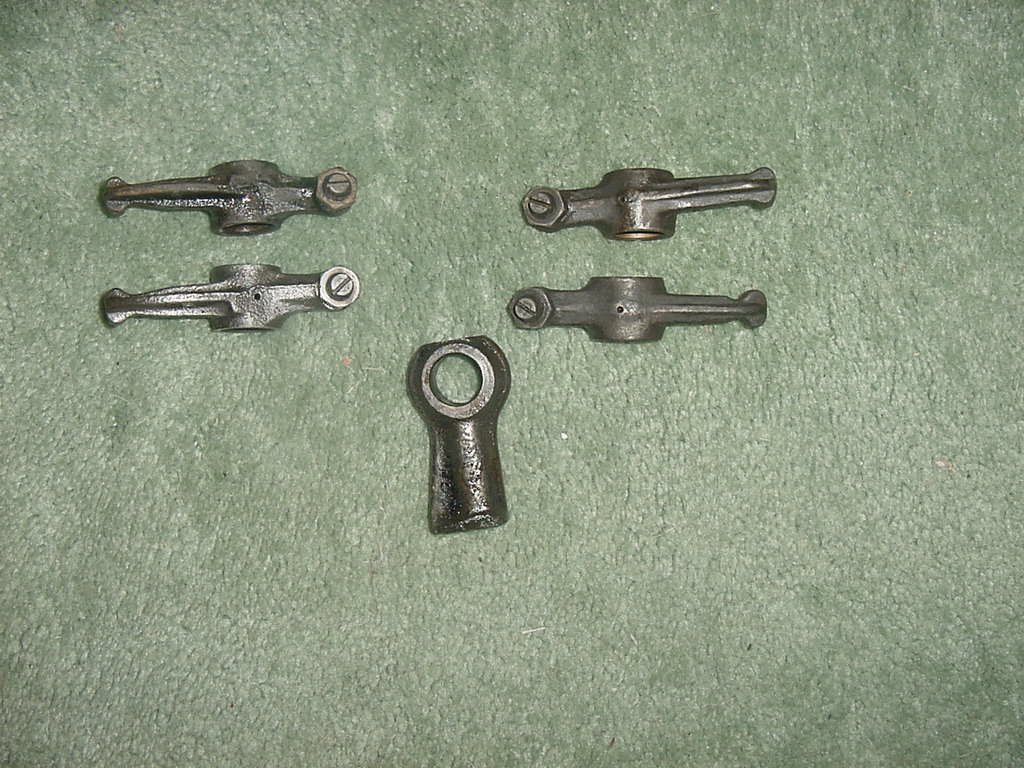

    Joined: Apr 25, 2010
    Posts: 498
    dawford
    Hi Chevy guys,
    I'm not sure what years the rocker arms are that have the big hump on the top because the guy that I bought the heads from gave it to me. I suspect that they are off a 235 6.
    The other set are off a 40's vintage 216 6. The 216's seem to have bronze bushings so I will probably use them. The 216s are probably easier to find anyway because a lot of earley Chevys are getting the more reliable late 235 engines and the earley 216s are often worn so bad that they are not much good anyway,
    Yes there are innies and outies just like belly buttons but that is good. I have set them on top of the head to see if they will line up and they seem to line up well.
    If they were a fraction off a little grinding on the side of the shaft hole would take care of that. But I don't think that will be necessary.
    On a Model A Ford, (there I go with the F word again :)) , the cam followers on the F--- don't line up with the Chevy anyway but the long push rods take care of the problem as the angles are so slight that they don't propogate any appreciatable side thrust on the rocker arms anyway.
    I will have the machine work, Installing the valves, guides and taking off the top 1/4" of the 28 Chevy standoffs done before cutting off the Chevy 6 standoffs because the modern valve stems are about .40" longer.
    I will put washers under the valve springs to adjust the valve spring seat pressure.
    The VW valve springs work well with the F--- conversion because they don't put an unrealistic pressure on the cam that is not designed for the 1.5 ratio that the rocker arms exert. I imagine that they would work well with the Chevy engine also as long as you weren't trying for a high RPM engine.
    The Model A engines with this conversion work well at 3500 rpm. A friend had this conversion in a Model A he used to have and he said that he drove it at 70 mph 30 miles each way to work for a long time with the stock 28 size valves.
    I am also going to put a Chevy S10 T5 5 speed overdrive transmission behind it so that I will be able to drive freeway speeds at much lower RPM. And I will modernize the chassis because any stock Model A or Chevy is a handfull at 70 mph and they stop like a freight train.
    :) :) :) Dick :) :) :)

  29. HEATHEN
    Posts: 8,977
    HEATHEN
    from SIDNEY, NY
    They look like the earlier, 216 style rockers. When you get it buttoned up, you should do an in depth how to article on the conversion---it's definitely information worth having.
