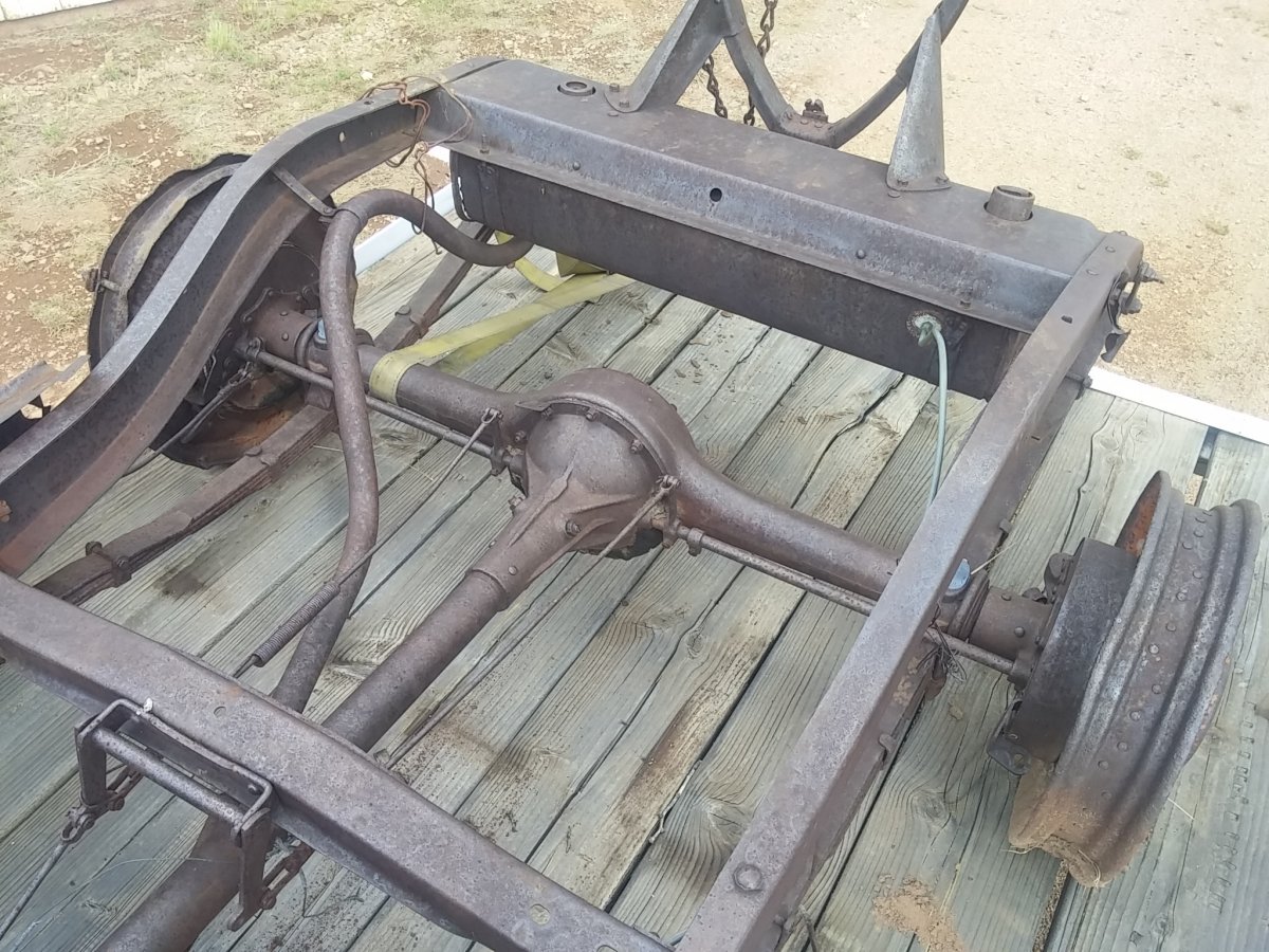

    I hauled this home today. I have not yet figured out what I want do to with it. I would like to play with all the old stuff and see what I can get working, and generally take things apart because I like taking things apart and playing with them.

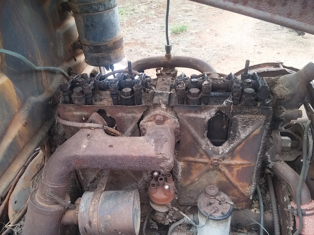

    The engine is pretty much complete. There is some funkiness with the exhaust manifold, but a little research shows they went from one, to three, exhaust ports in 1928, so my guess is that it just has an earlier head, and someone blocked off the two (now) extra ports on the manifold.
    I can think of lots of possibilities, what do you think?

    i believe they went from one to two exhaust ports in 28. The Olds head that fits the Chevy has three ports. But the end two are quite outside of the normal head perimeter. If that makes sense. I can send pictures of a 28 head and an Olds head if you want. trucks may be different. I don't know. Well here are pictures of the header flange I made for the three port head. Find s**** piece big enough. Cut off everything that does not look like a header flange. Install.

    Looks like someone retro fitted an earlier head with single port and modified the dual to suit.

    Yes, it does. I found the casting number on the block, it's from 1928. And only one day different than the casting number on the transmission. Haven't got the head number yet, the rockers make it kind of hard to see the numbers.
    I did check the oil, looks good! :)

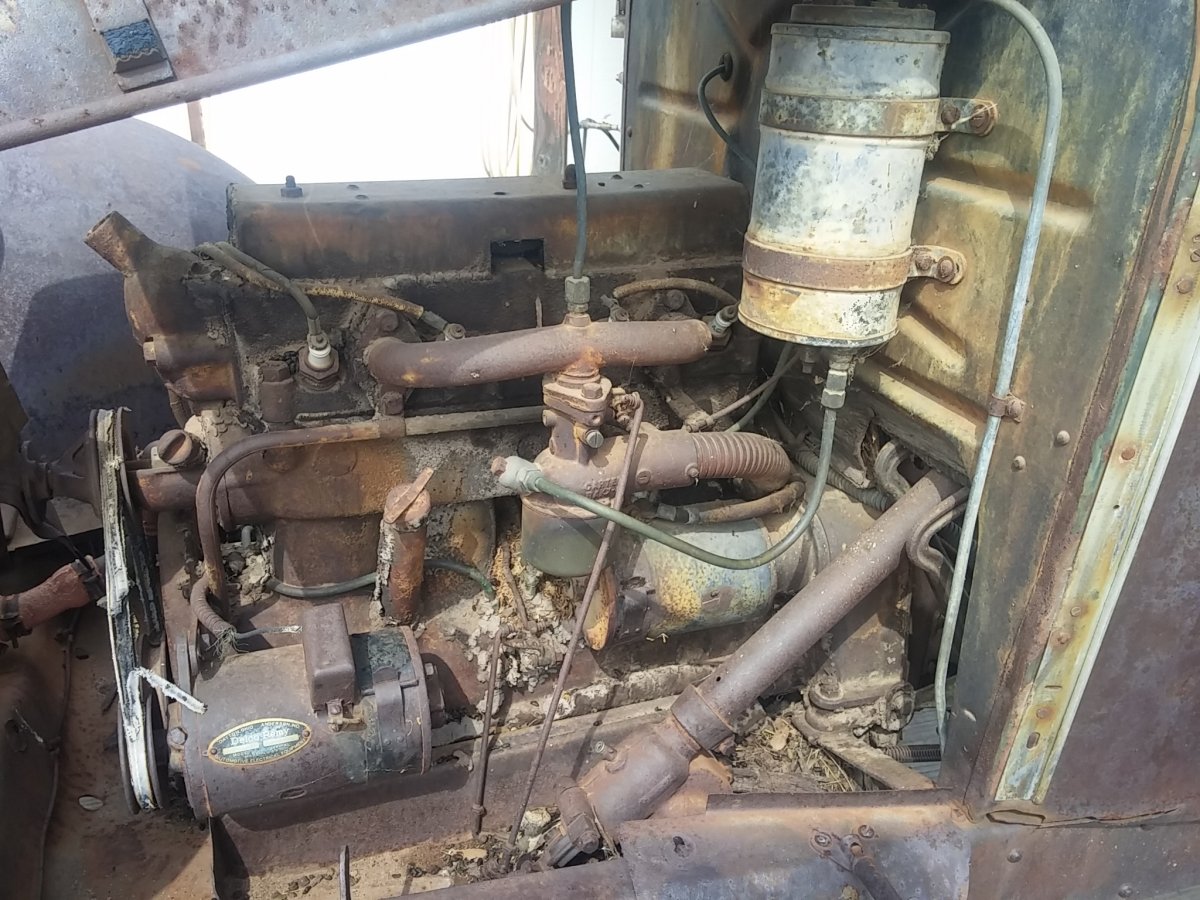

    a few more pics.

    I picked up a 27 National a while back and the previous owner had the motor rebuilt with the 28 head. The post mentioned earlier is packed with good info. Sorry, only pic I have right now is a shot of the spare motor IMG_1597.JPG that came with it.

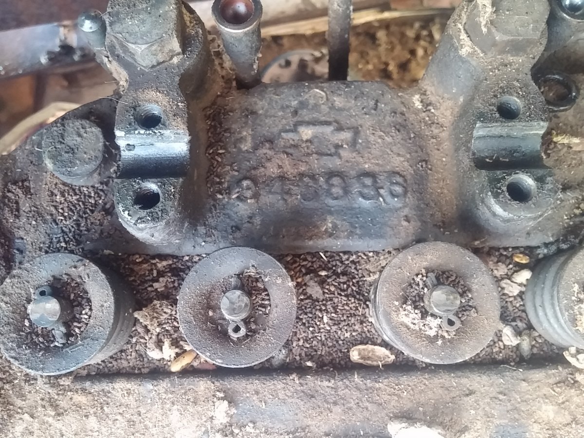

    I pulled a spark plug, and looked in the hole, didn't see any rust. The transmission seems to be rusted up, it was uncovered for a long time, water would sneak down the shifter and into the top cover, I guess. The head looks like it has a 1928 date code, there's still a lot I need to learn about these things.

    What ratio are the rockers?

    I'll have to measure the rockers, they might be one to one, but I really didn't pay attention. I've been thinking about the speedster idea. Being a coupe body means it would take some work for the windshield, or I could just cobble something together in the traditional 1930s way.
