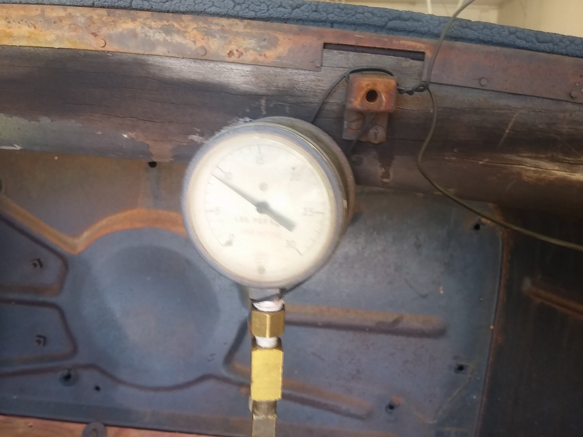

    I started in on the wiring today, which meant taking out the dashboard. It's a rusty mess. But I did find enough br*** fittings to install an old pressure gauge to see how the oil system works. 9 psi idling cold, not bad!
